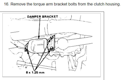

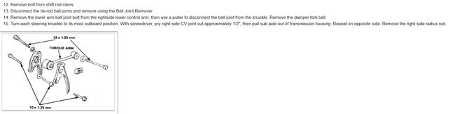

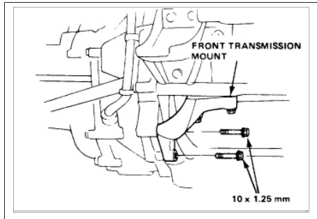

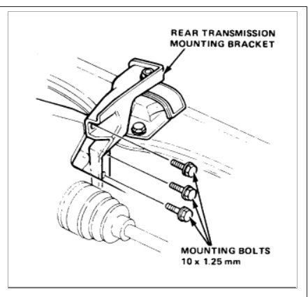

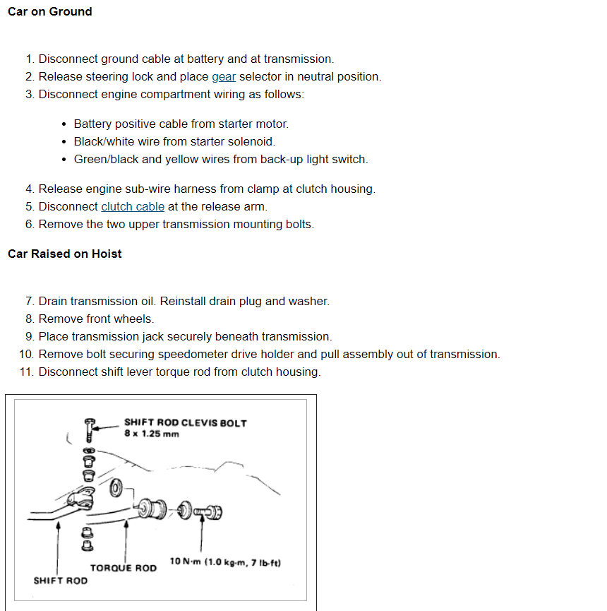

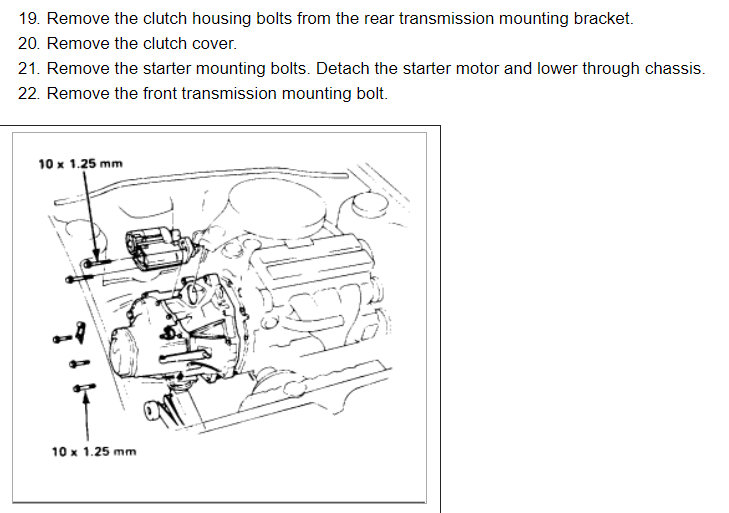

What is the easiest way to remove a Transmission?
Tuesday, July 7th, 2020 AT 2:59 PM (Merged)
KHLOW2008
  • 41,814 POSTS

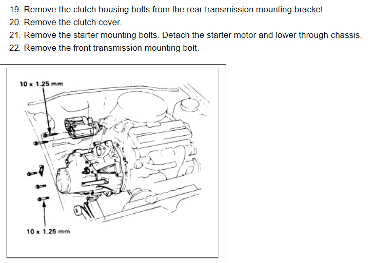

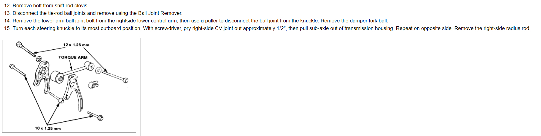

Hi Accord,
Here is a guide to help you see what you are in for when doing the job.
https://www.2carpros.com/articles/transmission-replacement-removal-manual
and for the clutch replacement
https://www.2carpros.com/articles/how-to-replace-a-clutch
Yours is FWD but the same idea here are diagrams to help you see what it will be like for you car.
Cheers
ACCORD
Thank you so much got the job done only cost me 134.00 for the clutch kit car works like new again.
