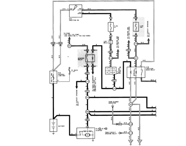

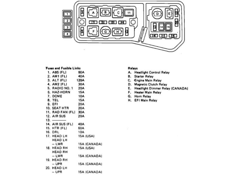

No, that is just to the solenoid. The issue is you have no power to that wire with the key in the start position.

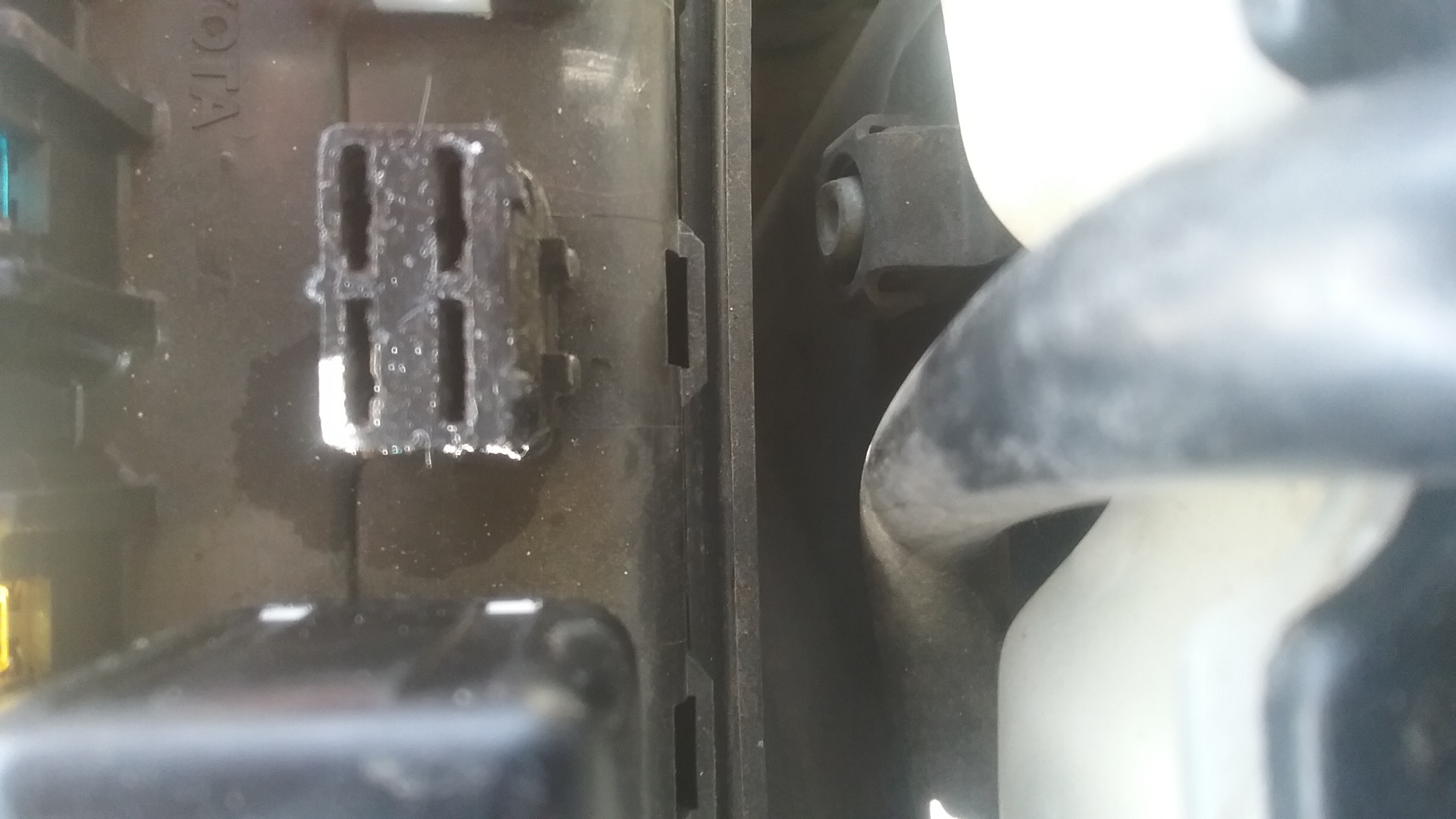

What is this and it it suppose to have power?
Apr 30, 2018 at 8:34 AM
Looks like it plugs into the connector next to it.

Did you remove that connector when you removed the upper manifold??
Let me check the wiring diagram.

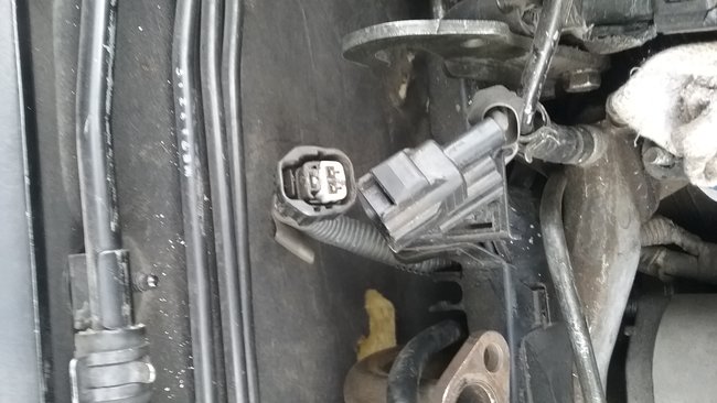

The picture you sent me with the open connector.
May 1, 2018 at 7:44 AM
TIMMAHANEY
  • 65 POSTS
No, pretty sure I did not.
May 1, 2018 at 8:00 AM
TIMMAHANEY
  • 65 POSTS
But I cannot say anything because I am not one hundred percent. why is it important?
May 1, 2018 at 8:02 AM
Can you recheck that connector? I am very curious about that. it looks like it needs to be connected somewhere.
I got one picture. and it looks like they are both female connectors. that means there are two connectors that go in there from the upper intake you have off.
May 1, 2018 at 8:21 AM
TIMMAHANEY
  • 65 POSTS
I pulled them apart.
May 1, 2018 at 8:26 AM
what did they hook up to?
May 1, 2018 at 8:29 AM
TIMMAHANEY
  • 65 POSTS
I just connected them.
TIMMAHANEY
  • 65 POSTS
The closet one to the fire wall is female.
May 1, 2018 at 8:31 AM
TIMMAHANEY
  • 65 POSTS
Each other.

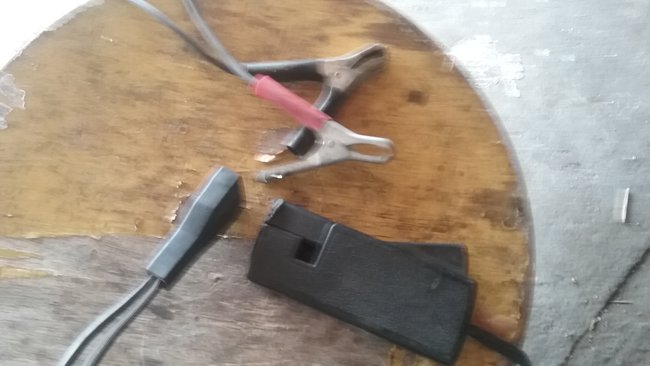

Hey, it is me again. I still have not gotten my car started. Can you please tell me what this is?
