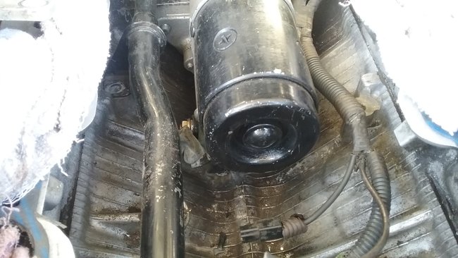

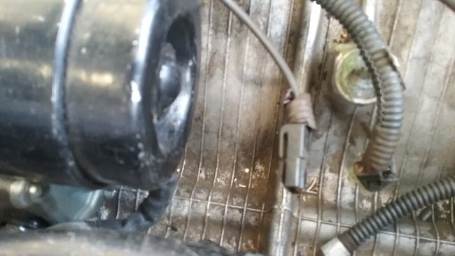

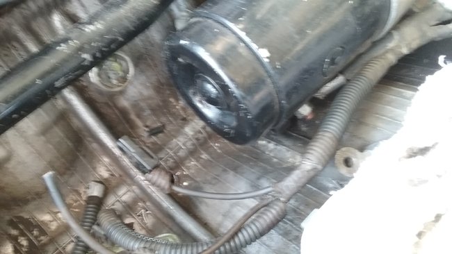

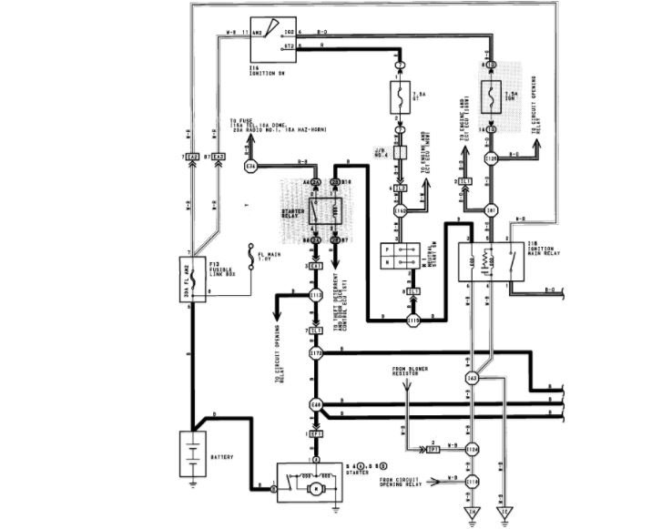

I have recently purchased a new starter and put it in, put it all back together and when I went to start it it started to start before I got the key to the start position. so now I have recently checked the battery and it is good, I also checked the big wire that goes to the starter it had power. so I checked the little wire's and neither had power. i hope you will help me with my car. Sincerely, Tim Newton

Good morning.
When you say two little wires, I am concerned as I only remember one wire.
Also, you said there was no power to the little wire but it started anyway. Have you made sure the wires are not touching each other?
I also suspect the ignition switch.

I tested the fuse box where the starter relay switch is and I used a test light the big wire had power but the one that plugs in did not. The one on the solenoid does not either.

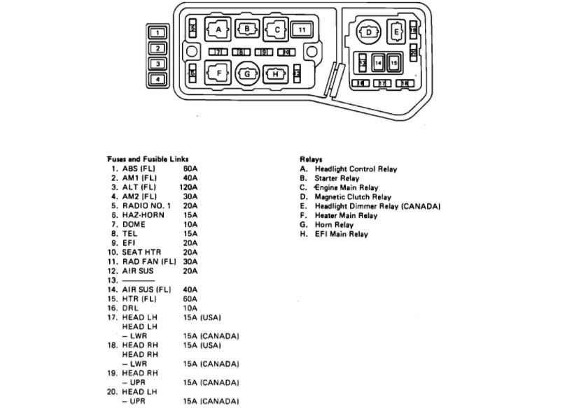

Well I just found a blown 20 amp fuse ECU.
Apr 24, 2018 at 4:28 PM
TIMMAHANEY
  • 65 POSTS
I am sorry EFI fuse 20 amp.
Apr 24, 2018 at 4:32 PM
Okay, did you replace it and retest?
Apr 24, 2018 at 9:13 PM
TIMMAHANEY

Okay, sorry I thought you meant it was fixed.
I attached a wire diagram for you to view.
Do you know where the starter relay is located?
Apr 26, 2018 at 9:03 AM
TIMMAHANEY
  • 65 POSTS
Yes, in the fuse box on driver's side under the hood.
Apr 26, 2018 at 9:12 AM

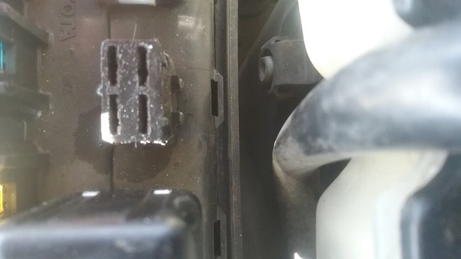

Okay, can you check for power to the relay with the key on? remove the relay and test. Leave the little wire for the starter off.
Apr 26, 2018 at 9:18 AM
TIMMAHANEY
  • 65 POSTS
I tested and there is power in one hole bottom right.
Apr 26, 2018 at 9:25 AM
TIMMAHANEY
  • 65 POSTS
Tested power bottom right hole.
Apr 26, 2018 at 9:29 AM

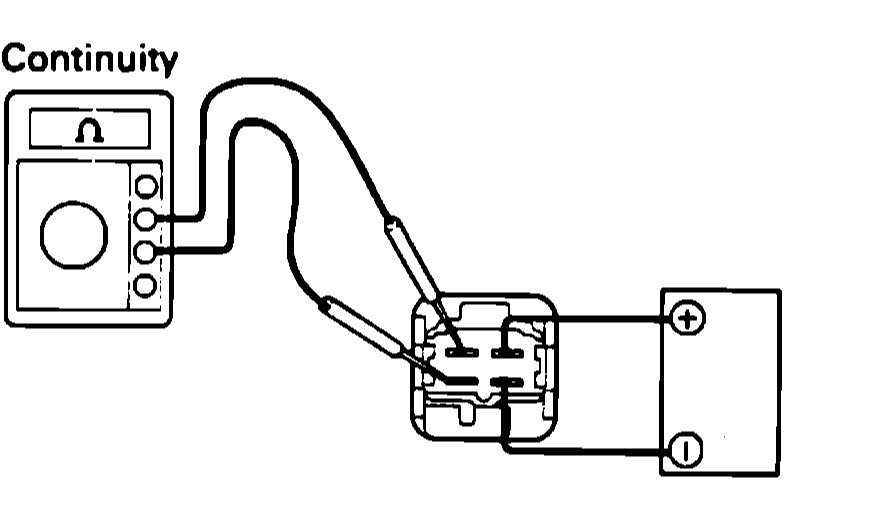

Relay test:
1. Apply battery voltage across terminals 1 and 3, Fig 6.
2. Using an ohmmeter, ensure there is continuity across terminals 2 and 4.
3. If no continuity exists, replace relay.
Apr 26, 2018 at 9:36 AM

Do I set the fluke on ohms?
Apr 26, 2018 at 10:24 AM
correct. the test is ohms.
Apr 26, 2018 at 10:36 AM
TIMMAHANEY
  • 65 POSTS
Without the key on there is power bottom right hole.
Apr 26, 2018 at 11:00 AM
No, the test for the relay is done with the relay out of the fuse block. You need to apply power and ground to the relay terminals as shown in the diagram I sent you, then you measure the ohms on the other two terminals.
Apr 26, 2018 at 11:08 AM
TIMMAHANEY
  • 65 POSTS
And tell me inside the fuse box where the starter relay is. there are four pins. One always hot correct and that would be pin number two and I have to turn the key to the crank position right?
Apr 26, 2018 at 9:25 PM
How did the relay test turn out before we go to the fuse block?
Apr 27, 2018 at 5:35 AM
TIMMAHANEY
  • 65 POSTS
Relay was good.
Apr 27, 2018 at 6:55 AM
Okay.
Now, at the fuse block.
You have one power and now you need a power with the key in the start position. have someone turn the key to start.
Be very careful. Do you have the fuel rail off? Fuel may spray for the pump when you turn on the key.
Apr 27, 2018 at 6:58 AM
TIMMAHANEY
  • 65 POSTS
I already have done that a couple of days ago and I used a test light and I did have one that stayed hot and nothing else lit up. I will try again though.
Apr 27, 2018 at 7:32 AM
You need a signal from the ignition switch to the relay.
