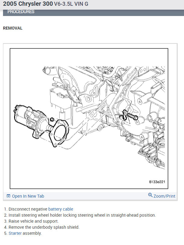

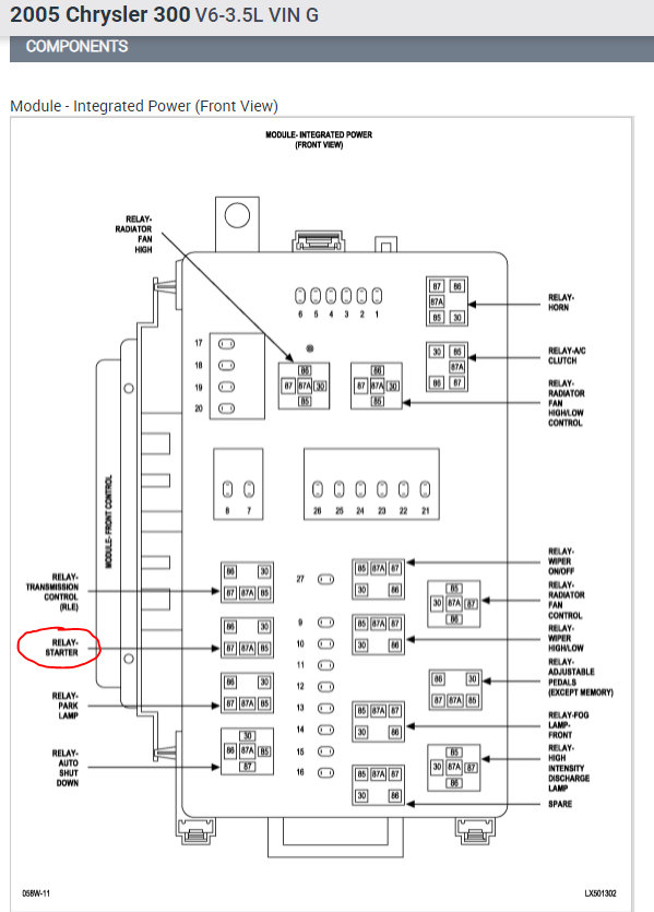

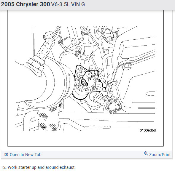

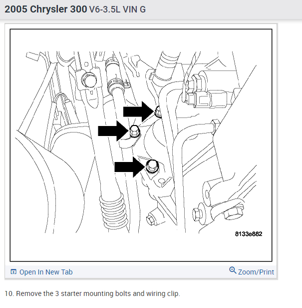

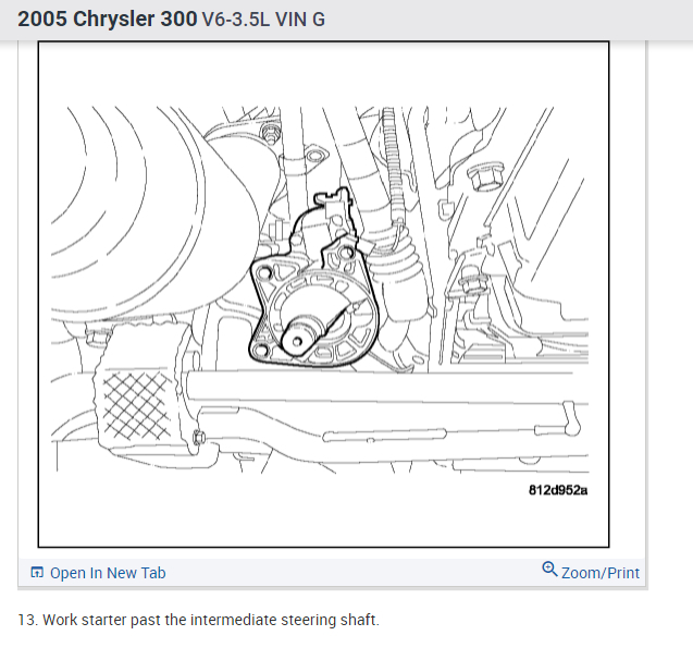

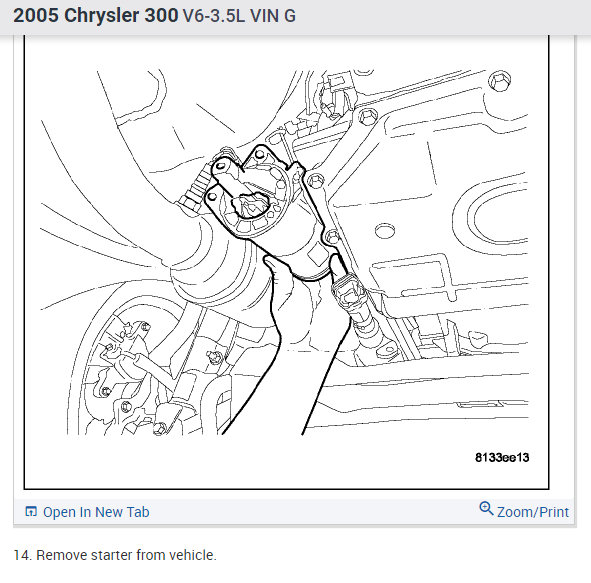

So all the gauges and dash lights come on as usual. But when you turn the key it just clicks, right?
The clicking sound can be either the starter relay or the starter.
First check the starter relay. The relay is located under the hood in the main fuse box (see diagram below).
Pull out the relay and do a visual inspection. See if there is any burnt pin or corrosion on the connector.
You can also test the relay as well.
Here is a guide on how to do that:
Next item needs to be checked is the starter. Many times the starter will have this type of intermittent issue when the main wire that goes from the battery to the starter is loose or has corroded terminal. With a corroded terminal the power from the battery does not got to the starter as it should and it will just click. Then as you are trying to start it for few more time it can all of a sudden get enough power to crank the engine and start.
Please let me know what you find.
