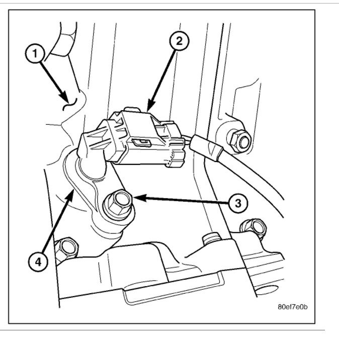

Hello I want to update you on car. I had car on scanner at two auto parts stores. One showed ign coils and crankshaft positioning sensor and random misfires. I took to another a week later and it showed all ABS sensors to check. Plus Crankshaft positioning sensor again. The check engine light is off. Today I made left and hand turn and car stalled--this never happened before. While car started again when i put it in gear initially it wouldnt shift into drive. I put it back into park then drive again and it moved. Then after 100 ft it stalled again and started up but would not shift when i put it in drive, until i put in park and back into Drive. I am thinking to replace the crankshaft positioning sensor 1st. Can you tell where this sensor is on the 2005 300C 5.7 HEMI? thank you very much for your reply:)
Jun 6, 2017 at 6:54 AM
  • 55,433 POSTS
The Crankshaft Position sensor is located at the right-rear side of the engine cylinder block. Here is a diagram (below).
