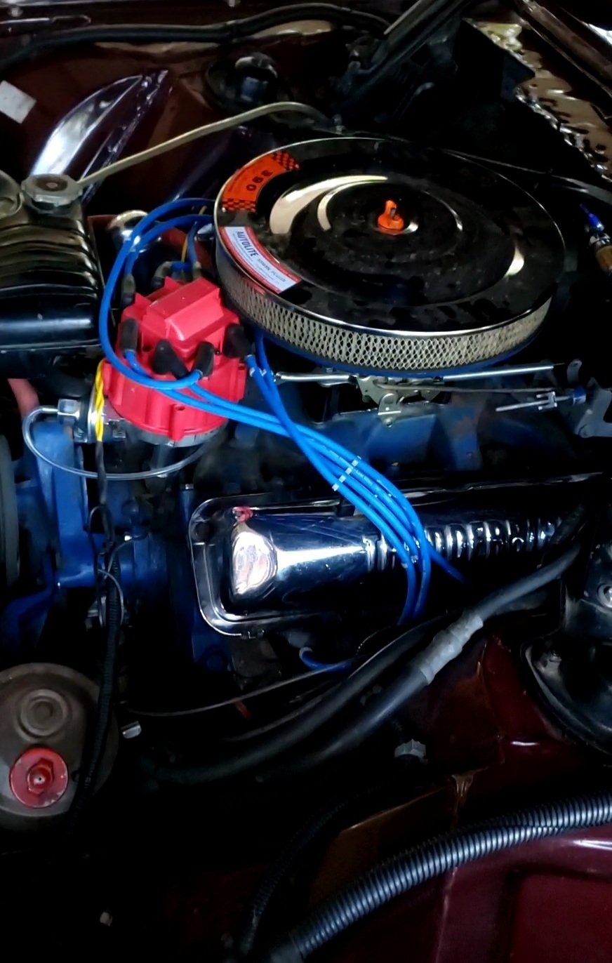

It is inspected and had even had time to hit the DMV for registration before I took a scenic drive though Cameron Park here in Waco. So, to check the box of a solid reason for "Stall out and Hard to restart when warm"
Technically- A brand New electronic ignition system was installed to replace the Mech points distributor. From the box the new part had a faulty component that when it reached a "Temp" of who knows it would not keep the right fire or break the circuit all together. When cooled component would act as if it was good. Even show fire to plugs while trying to diagnose the cause.
Man to Man- that piece of. Sheet, was trash from day 1 and I had the mind set of "can't be, it's new" while I continued to replace, change, cuss and dream of firebombs in the car. Parts!
So moral here is new don't mean good. Lol
Where do we go from here, so we need to start a new thread, maybe pass me off to a different pro, block my name due to weird, long and sometimes confusing or misdirected rabbit hole thoughts.
What do you know about vacuum line insanity? Or as manufacturers called it engineering marvels. Sorry brake lights and vacuum switches on a 64 Thunderbird?

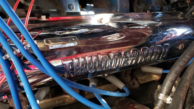

Back of the intake. Seen illustrations of PCVs from here maybe.
Friday, September 23rd, 2022 AT 8:07 PM
  • 109,932 POSTS
Okay, I needed a good laugh, and thank you for it. Waco. Are you in Tx? If so, I hope all is well. I've been bothered by what I am seeing and hearing and can only imagine what people are going through. Regardless, I better shut up.

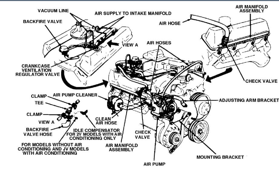

As far as the PCV, take it from a valve cover to the intake. The hose you have in the pic looks like it would work. In the first pic, the engine looks new. LOL You do good work.
Now, my manual only goes back to 1966. Believe it or not, I did find a vacuum schematic, but it is for the 1966, 390ci. I attached it. I'm hoping it is somewhat helpful.
See pic below. Note: In 1966 it had a PCV. It appears to attach exactly where your last pic shows.

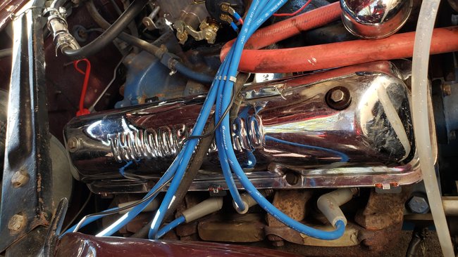

Yes, Waco Texas is where I rein from. Thanks for the help and your encouragement and to be honest the only thing that keeps me from NASA type exploration and modification is cash. Honestly if I would have bought the $250.00 part and not that $80.00 we probably never would have had conversation. Lol but as far as this PVC question, I'm going to shoot you a couple better pics of the covers you can see the screws with O-rings that I honestly believe someone tried to install some type of vent system because I haven't seen them before and they're not symmetrical or the same on either one and it's kind of weird. But I did download the shop slash manufacturers manual for the car it's like 600 pages mostly writing no pictures for a ding dong like me. That means I got to read. Well, I got it in there is collecting this maybe I'll look at the vacuum diagram.

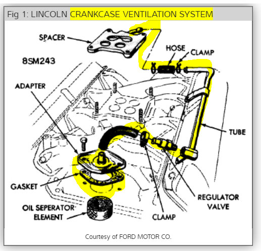

  • 109,932 POSTS
Just for curiosity, is the vacuum schematic I sent similar to the one in your manual?
I was able to find the schematic for a "Lincoln" with the same engine. It is running from the front of the engine back to the carburetor base.
See pic below.

You may need to get a different base plate for under the carb. Were you able to locate anything on the engine where the crankcase vent would have been located?

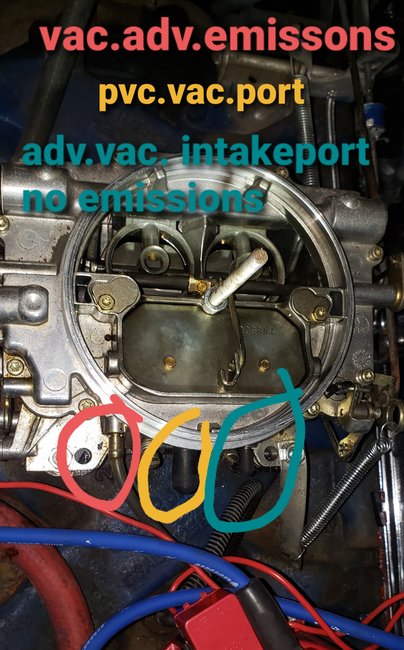

If I am comprehending correctly the 1406 Edelbrock carburetor that is on it has a PCV port on the front. As well as a port at the rear that is blocked with a large set screw. I will have to go back through the rebuild kit instructions to identify the rear 1 correctly.
Sunday, September 25th, 2022 AT 9:19 PM

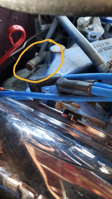

SUPERDAVE254
  • 43 POSTS
See pic, lol.
Sunday, September 25th, 2022 AT 9:26 PM
  • 109,932 POSTS
The one you circled in yellow seems to be the one needed. That just looks like a rubber boot/plug. If that is at the base of the carb, it should take care of your needs.
Were you able to find anything that would connect to the engine? The pic I sent appears to be at front center.

Front of this one is the fill/breather tube. The rear is where I believe it to be.
Tuesday, September 27th, 2022 AT 4:15 PM
  • 109,932 POSTS
Is the fill/breather tube where it releases crankcase pressure? That would make sense.

Yes, that is the release point. Just not 100% on the rest of it. Heck, I guess all there is to do is take the bolt/plug from the hose in the rear and see if it has vacuum or water, lol.
Tuesday, September 27th, 2022 AT 7:56 PM
  • 109,932 POSTS
The plug on the rear shouldn't have coolant in it. Remove it and take a look. I suspect you are going to run a hose between both places.
