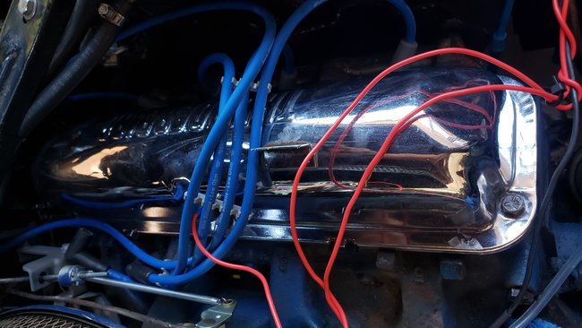

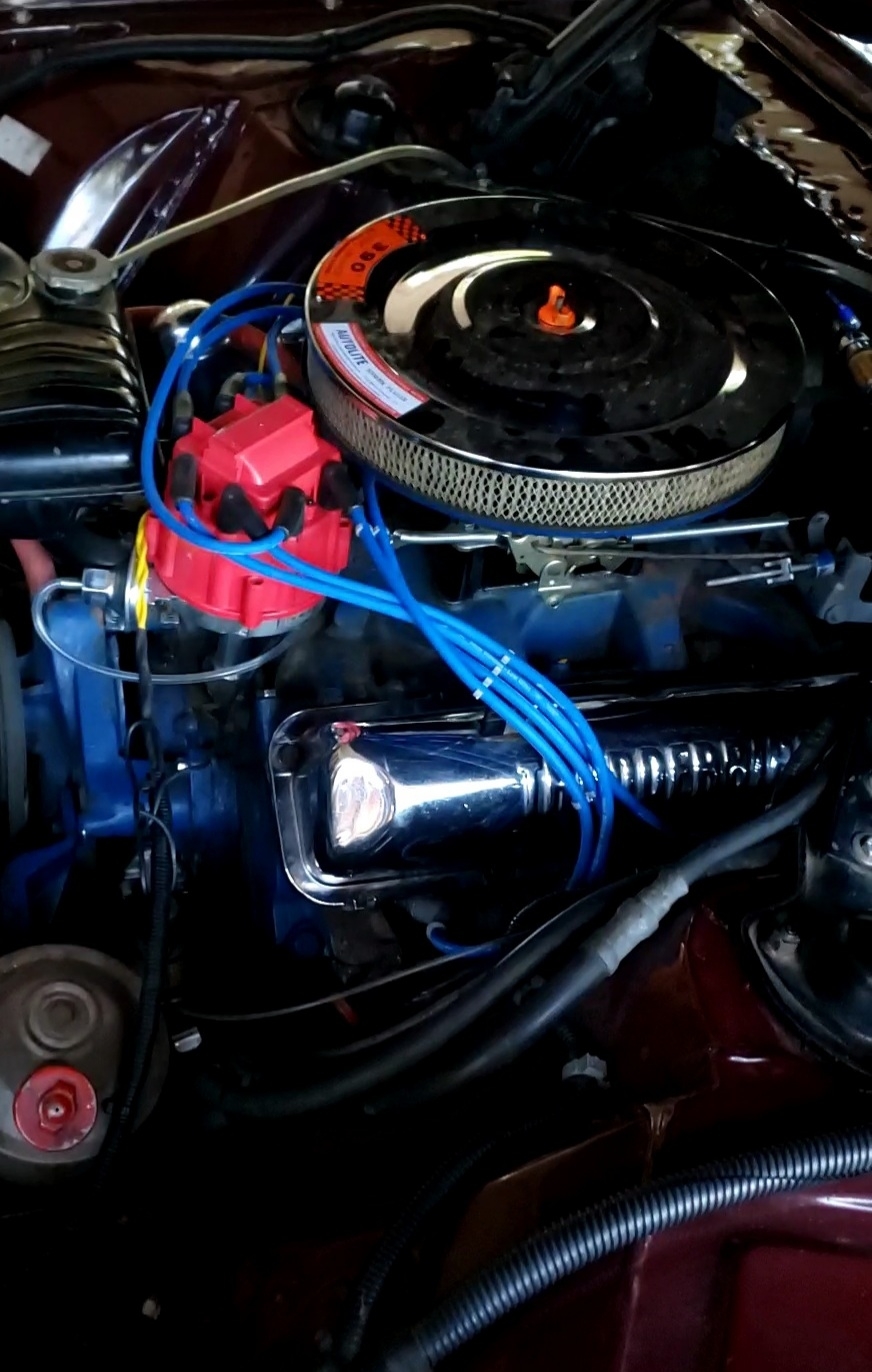

Back of the intake. Seen illustrations of PCVs from here maybe.
Sep 23, 2022 at 1:07 PM
  • 110,244 POSTS
Okay, I needed a good laugh, and thank you for it. Waco... are you in Tx? If so, I hope all is well. I've been bothered by what I am seeing and hearing and can only imagine what people are going through. Regardless, I better shut up.
As far as the PCV, take it from a valve cover to the intake. The hose you have in the pic looks like it would work. In the first pic, the engine looks new. LOL You do good work.

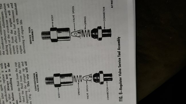

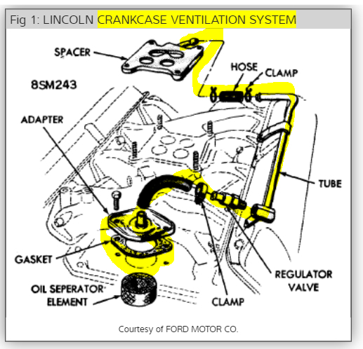

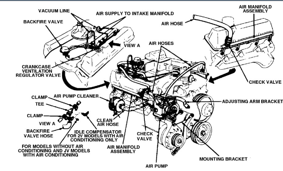

Now, my manual only goes back to 1966. Believe it or not, I did find a vacuum schematic, but it is for the 1966, 390ci. I attached it. I'm hoping it is somewhat helpful.
See pic below. Note: In 1966 it had a PCV. It appears to attach exactly where your last pic shows.

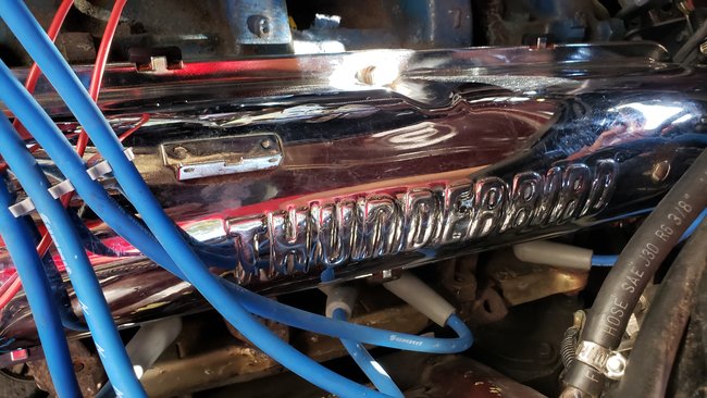

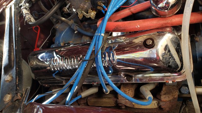

Yes, Waco Texas is where I rein from. Thanks for the help and your encouragement and to be honest the only thing that keeps me from NASA type exploration and modification is cash. Honestly if I would have bought the $250.00 part and not that $80.00 we probably never would have had conversation. Lol but as far as this PVC question, I'm going to shoot you a couple better pics of the covers you can see the screws with O-rings that I honestly believe someone tried to install some type of vent system because I haven't seen them before and they're not symmetrical or the same on either one and it's kind of weird. But I did download the shop slash manufacturers manual for the car it's like 600 pages mostly writing no pictures for a ding dong like me. that means I got to read.. Well, I got it in there is collecting this maybe I'll look at the vacuum diagram.

Just for curiosity, is the vacuum schematic I sent similar to the one in your manual?
I was able to find the schematic for a "Lincoln" with the same engine. It is running from the front of the engine back to the carburetor base.
See pic below.

From what I can tell... Yes, it looks like what I would vision if I put several pics from the book together. There is not an actual positive crankcase ventilation system picture. But for the hell of it let's see if you get this file... Well, it is not allowed. Maybe it is too big or because it is a PDF. On my style intake which I think there was many that were used even from factory. The port is in the rear, and it would have hooked to the throttle plate or maybe the radiator (radiator is what someone told a different guy) anyway touch reading for me. No vented covers, valve in the rear of intake...which in turns or it reads the exhaust to the carb or plate...

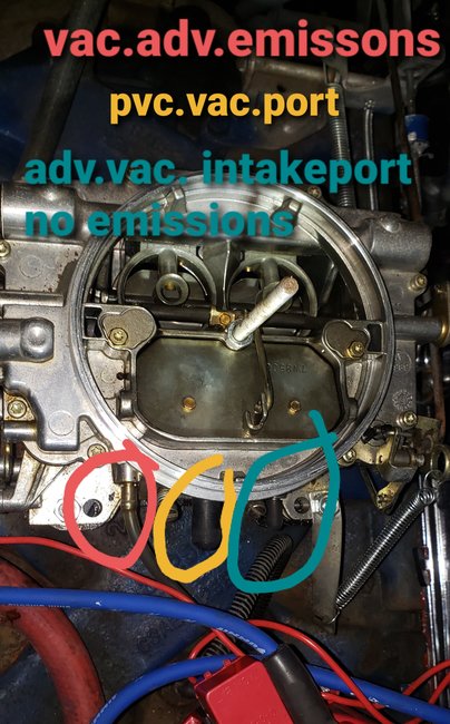

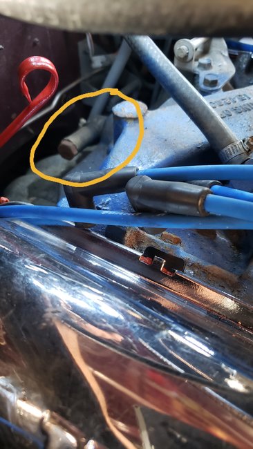

If I am comprehending correctly the 1406 Edelbrock carburetor that is on it has a PCV port on the front. As well as a port at the rear that is blocked with a large set screw. I will have to go back through the rebuild kit instructions to identify the rear 1 correctly.
Sep 25, 2022 at 2:19 PM
SUPERDAVE254
  • 43 POSTS
See pic, lol.
Sep 25, 2022 at 2:26 PM
  • 110,244 POSTS
The one you circled in yellow seems to be the one needed. That just looks like a rubber boot/plug. If that is at the base of the carb, it should take care of your needs.
Were you able to find anything that would connect to the engine? The pic I sent appears to be at front center.
