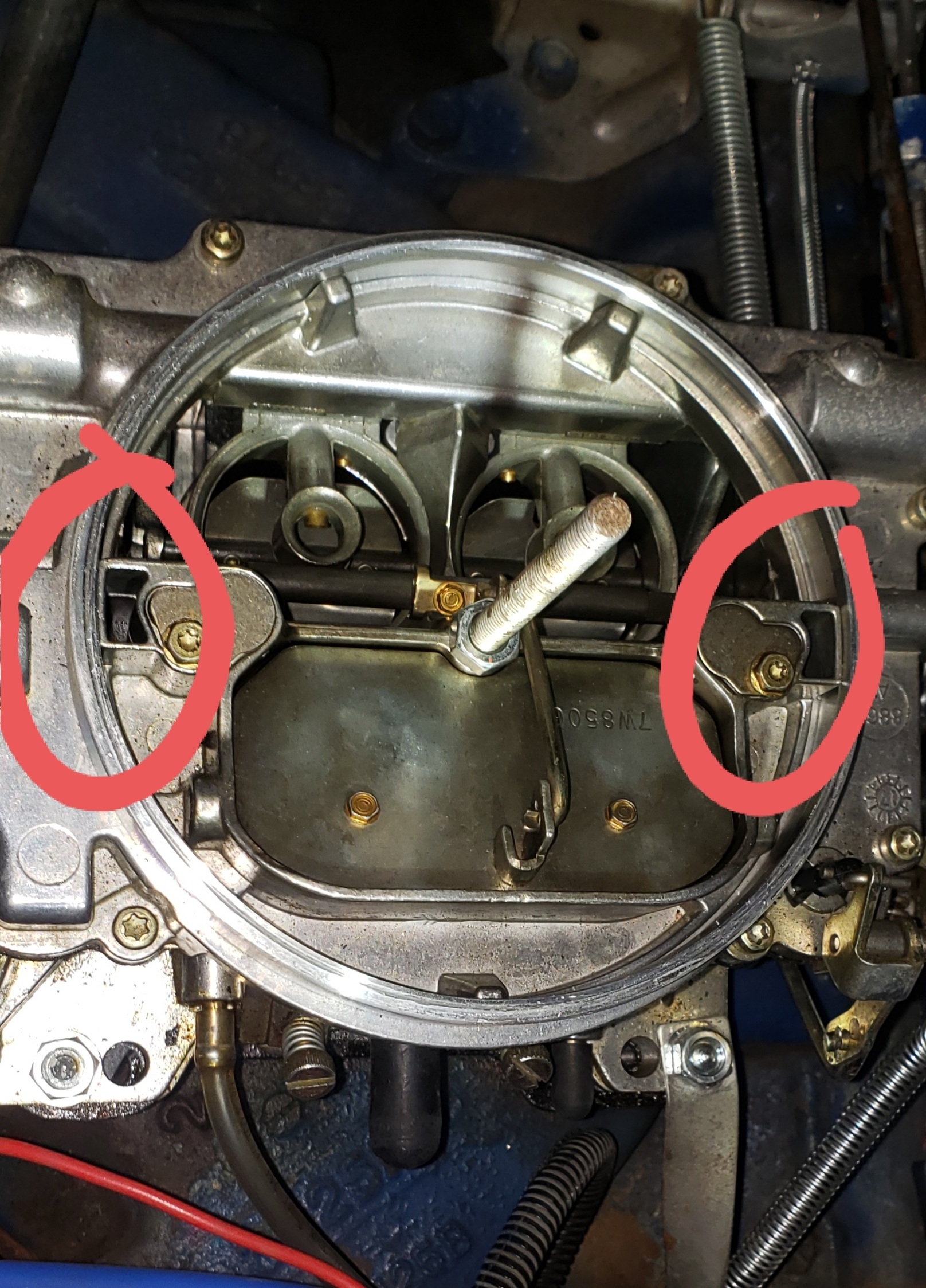

Take the carburetor off and check the float drop and the needle and seat. Make sure the needle and seat are sealing fuel off when needed. Also, make sure the float drop is correct. It's getting too much fuel. Think about it. If it ran good with the fuel disconnected until it ran out of fuel, that leads me to say if fuel was available, it would have pumped too much.

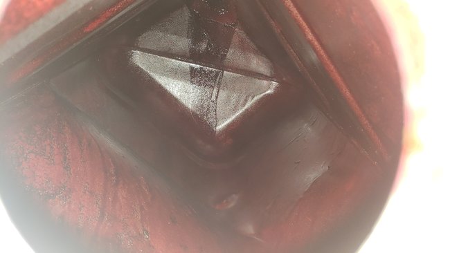

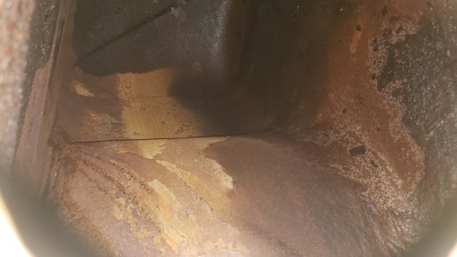

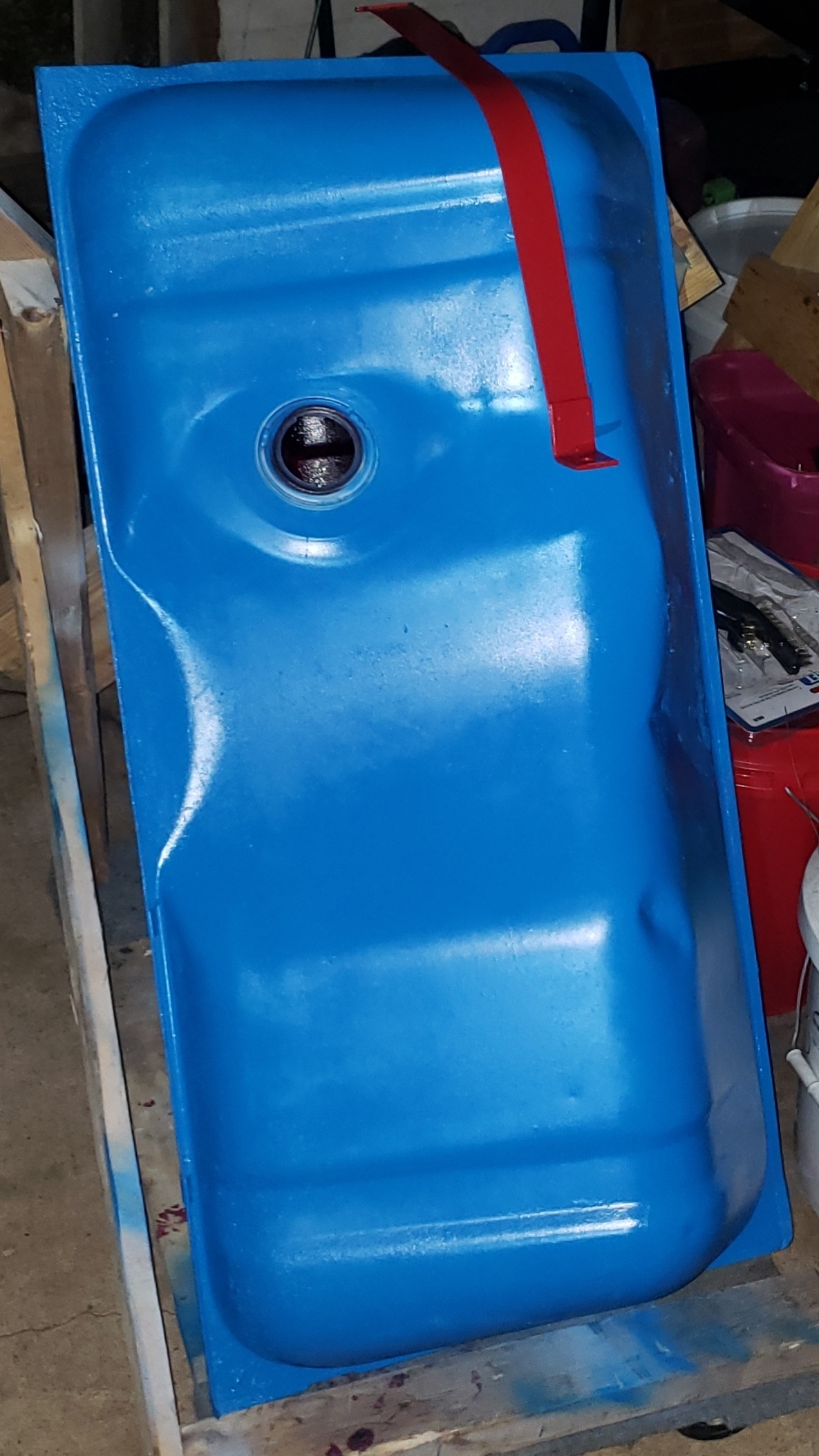

Okay, so to update I guess so that we can continue the conversation I'm not a goober head lol! I'm pretty knowledgeable in the mechanics field although you probably get that a lot anyway. I just got done with coating the inside of my gas tank and I was listening to a random YouTube video that came on after one I was watching. And it was talking about vapor fuel separator filters and then I realized my engine and system ran dead. So, I decided to not install my gas tank instead I am running a return line with the vapor separator after the fuel pump before the carburetor. Maybe I'll be done by Sunday evening. And with any luck and a little grace from the Lord that's going to help wait not help That's going to solve the issue keep your fingers crossed and I won't stop this conversation until it's done thank you for your help!
Sep 9, 2022 at 8:58 AM
SUPERDAVE254
  • 43 POSTS
In the pictures we have I believe if I picked it right a picture of the old rusted inside, one of after I electricized and coated it, and one of the paint job (with spray paint) lol.
Sep 9, 2022 at 9:03 AM
SUPERDAVE254
  • 43 POSTS
Red kotes.
Sep 9, 2022 at 9:05 AM
SUPERDAVE254
  • 43 POSTS
Redneck paint job... But if we ever have to hide from pterodactyls laying under there somebody's going to be like, darn that's a cool tank.
Sep 9, 2022 at 9:07 AM
  • 110,251 POSTS
Pterodactyls? Good lord, I hope that never happens. LOL And you're right about the questions I ask. I have had a lot of people that have no idea what is what which is why they ask for help. My favorite was the heading saying, "My Hooter Fell Off and I can't get it to stay on." LOL I was nearly in tears. I was going to suggest a doctor but wasn't sure if the hooter was OEM. LOL It was actually the horn button.
Regardless, the tank looks great.

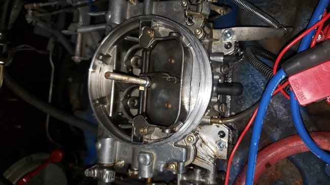

Okay, so, she left me sitting on the side of the road yesterday afternoon. I pulled the plugs evidence of way rich fuel mix. Today I returned the carburetor and hooked up to vacuum gauge. While I was playing with it, I was also listening to a video I heard something that made me curious so a little more research.... The port on the left which everyone says is vacuum advance, is vacuum advance for admission control cars. Be port on the right or driver side is vacuum advance to distributor for non-admissions. I tune it I swap my vacuum line and now listen to the video.

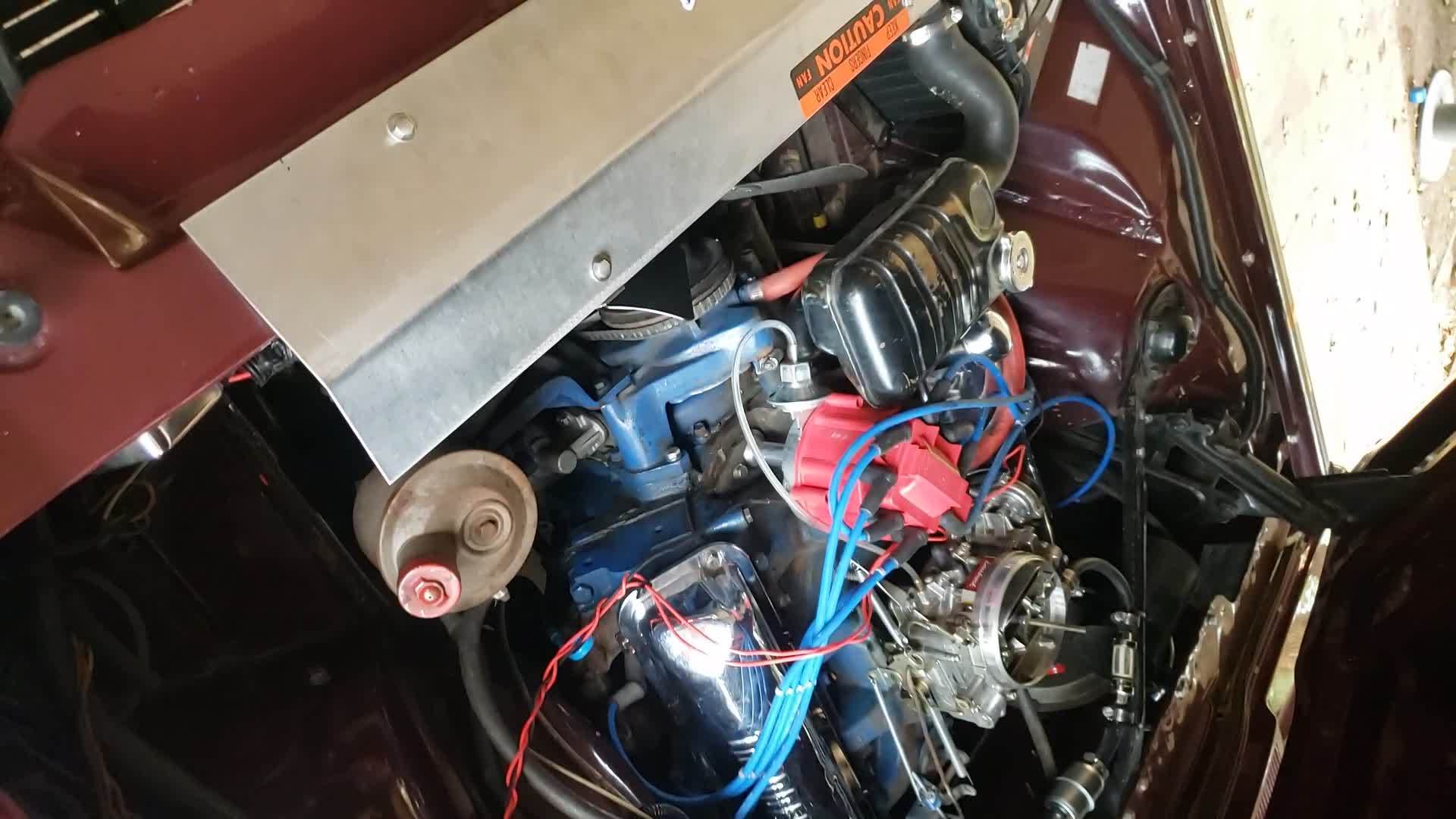

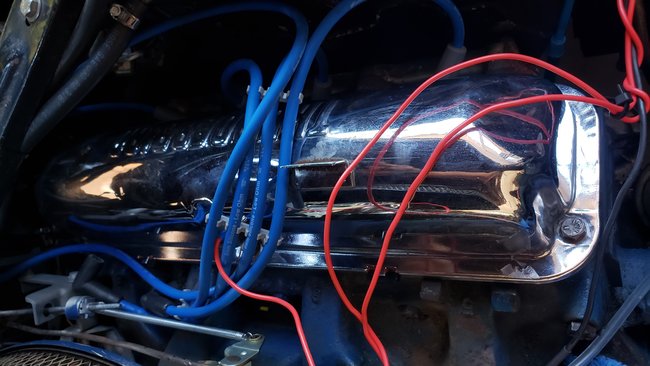

Well, how about this question Mr Joe, where would the PVC be on a 1964 390 FE Thunderbird? Every other vehicle I've ever played with has it coming out of the valve cover. These valve covers have nothing. Is there a different spot where the PVC is?
Sep 14, 2022 at 7:33 AM
  • 110,251 POSTS
Wow, that's a tough one. In 1964, I don't believe they used a traditional PCV valve. Instead, I believe they had a breather cap at the front of each valve cover. Could you take a pic and upload it for me to see the valve covers?

That is great news. Hopefully, the Walmart trip goes as well. As far as the valve is concerned, they don't look factory. I believe the OEM covers had breathers.
Did you replace the covers or were they like this when you got the vehicle?

I'm glad to hear it is running good. As far as the valve covers, there should be a breather at some point.
It sounds like you have the same luck as me. It has been a rough week. LOL
Regardless, for some reason, the pics didn't upload. If you have a chance, send the pics again. I would like to see them.
