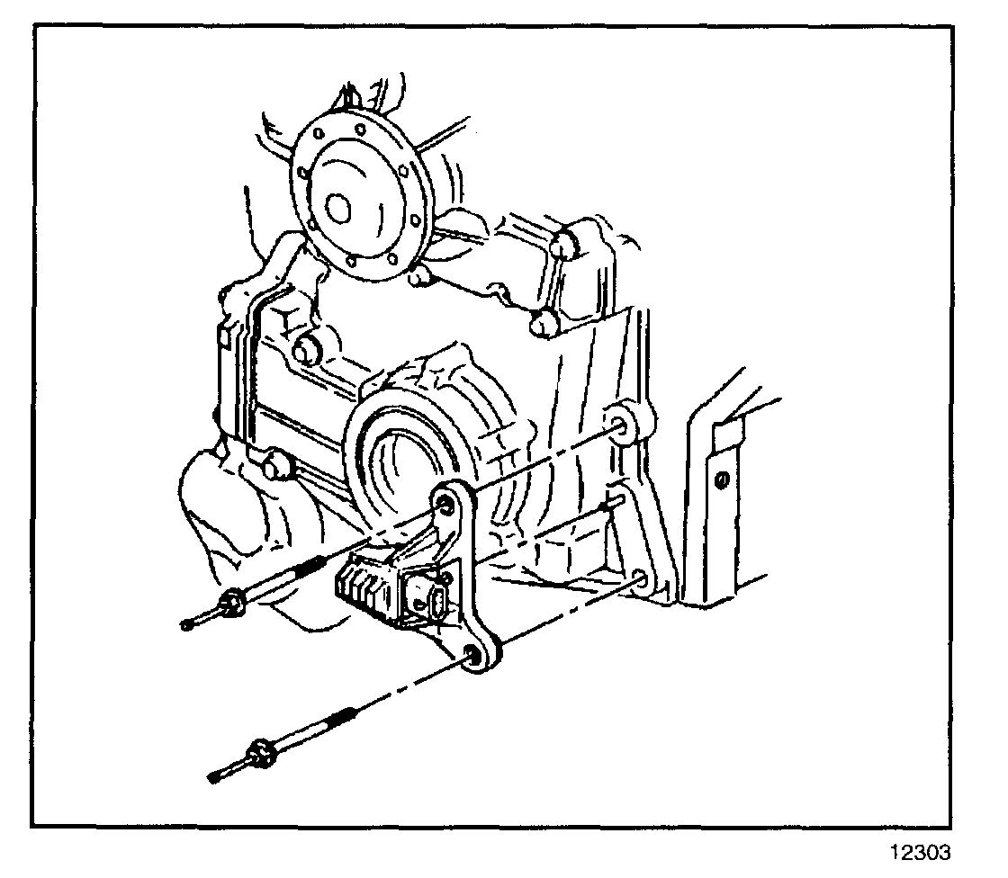

I'm going to add the directions for replacing the crankshaft position sensor in case you decide to change it. At least you will have the directions. The attached pics correlate with the directions.
___________________________________________

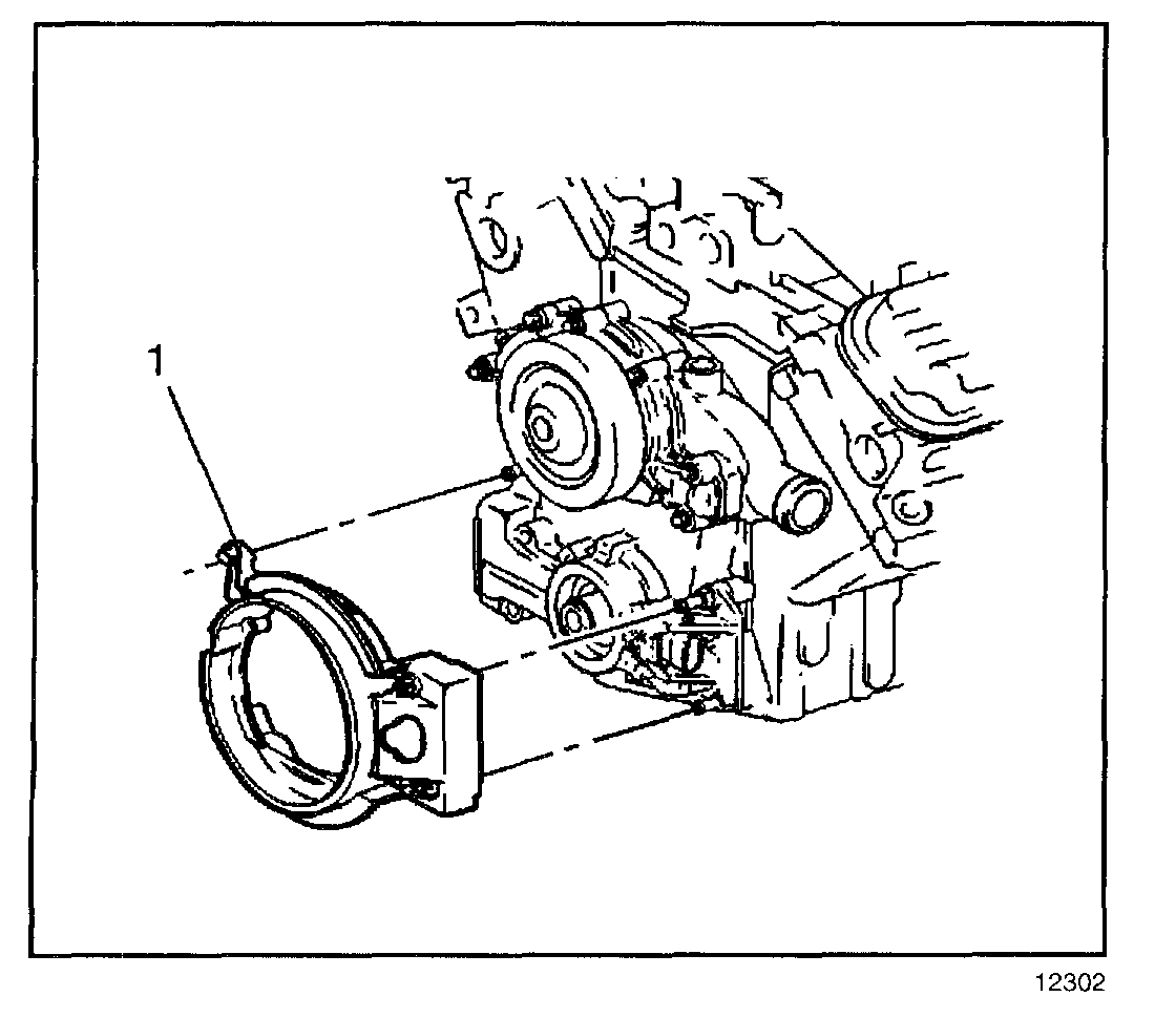

2002 Chevrolet Impala V6-3.8L VIN K
Crankshaft Position (CKP) Sensor Replacement
Vehicle Powertrain Management Sensors and Switches - Powertrain Management Sensors and Switches - Computers and Control Systems Crankshaft Position Sensor Service and Repair Procedures Crankshaft Position (CKP) Sensor Replacement
CRANKSHAFT POSITION (CKP) SENSOR REPLACEMENT
REMOVAL PROCEDURE
pic 1
1. Disconnect the negative battery cable.
2. Raise and support the vehicle. Refer to Lifting and Jacking the Vehicle.
3. Remove the right splash shield cover.
4. Remove the crankshaft harmonic balancer.
5. Disconnect the sensor electrical connector.
6. Remove the crankshaft position sensor (CKP) shield (1).
pic 2
7. Remove the CKP sensor bolts.
8. Remove the CKP sensor.
INSTALLATION PROCEDURE
pic 3
1. Position the CKP sensor to the block.
NOTE: Refer to Fastener Notice in Service Precautions.
2. Install the CKP sensor bolts.
Tighten
Tighten the bolts to 30 N.m (22 lb ft).
pic 4
3. Install the CKP sensor shield (1).
4. Connect the CKP sensor electrical connector.
5. Install the crankshaft balancer.
6. Install the right splash shield cover.
7. Lower the vehicle.
8. Connect the negative battery cable.
9. Perform the Crankshaft Variation Learn Procedure. See: Vehicle > Programming and Relearning

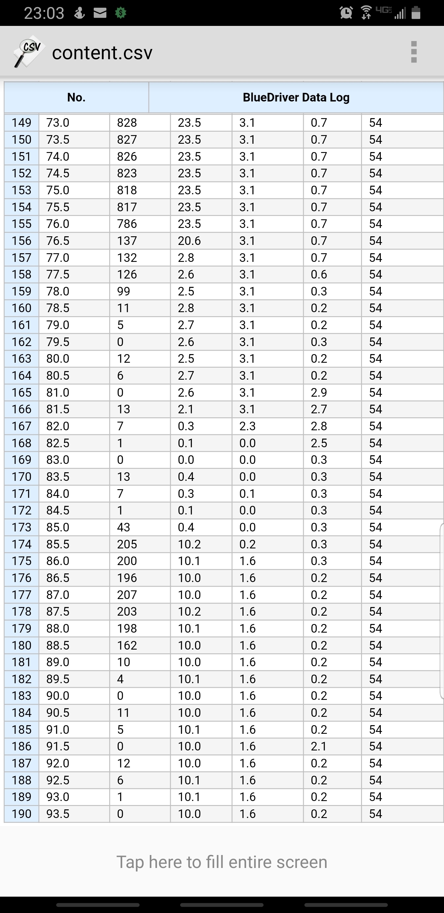

I have a couple other questions. When the engine starts and runs, does it just shut down as if you turn the key off or does it slowly die as if it is a fuel related issue? I wonder if you have a fuel pump relay that is failing.
Jan 12, 2020 at 7:57 AM
TRUCKER88

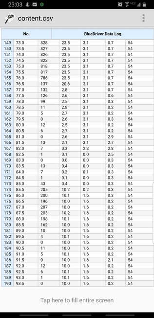

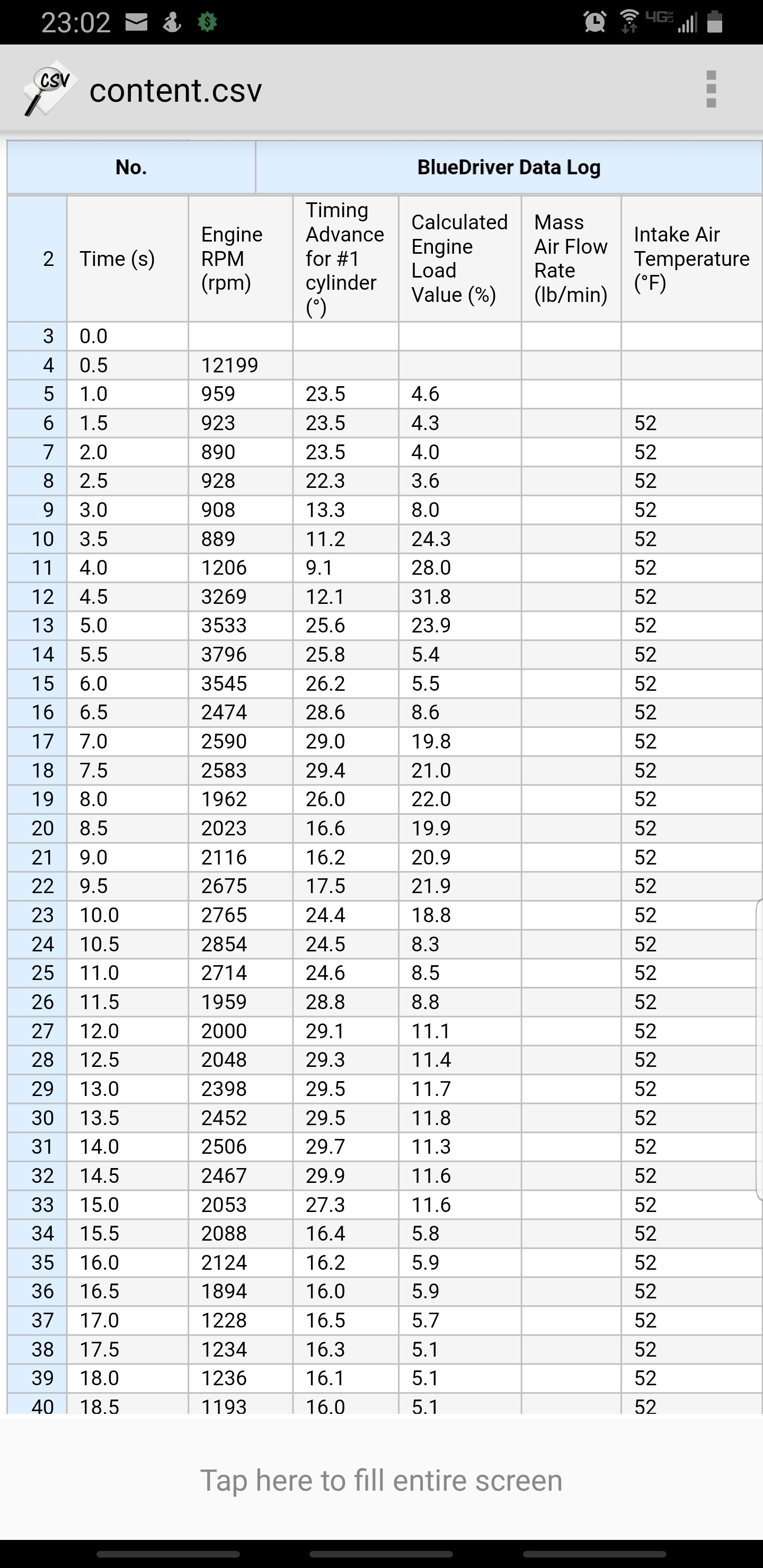

When it stalls, it's as if I turned the ignition off. It doesn't sound like it's being starved of fuel.
Like i explained in my original post I did the fuel pressure testing, but I'm unaware of what the exact fuel pressure should be because I'm getting different numbers from different places on the internet.
These are screen shots form live data off of a blue driver that I borrowed a few days ago. Does it tell you anything? And thank you so much for your help!!

Here are the fuel specs right from alldata:
Fuel pressure
Fuel Pump Pressure
Vehicle Power-train Management Fuel Delivery and Air Induction Fuel Pump Fuel Pressure Specifications Pressure, Vacuum and Temperature Fuel Pump Pressure
FUEL PUMP PRESSURE
Fuel System Pressure
Key On Engine Off (KOEO) 53-59 psi
You are within spec. The info isn't helping.
I have to be honest, since it shuts down like you turn the key off, it sounds like an electrical issue. I suspect it is the crankshaft position sensor.
Jan 12, 2020 at 2:24 PM
TRUCKER88
So I did some research on testing the crankshaft sensor, and I came across this article:
https://troubleshootmyvehicle.com/gm/3.8L/how-to-test-the-crank-sensor-1
Did the testing, and finally no problem. It must of been a loose wire or something like that.
Thank you for your help!!!

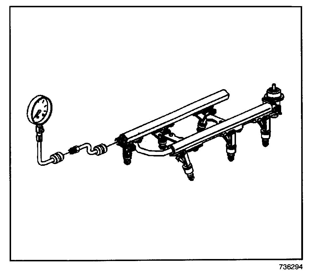

Now, I need you to check two things. First, we need to confirm fuel pressure is where it needs to be. Here is a link that shows how to check pressure:
Here are directions for connecting the pressure gauge on your vehicle:

picture 3
1. Install J 34730-1A with J 34730-262 to the fuel pressure service connection, located on the fuel rail.

Here are the manufacturer's specs for pressure:
Key On Engine Off 52-59 psi

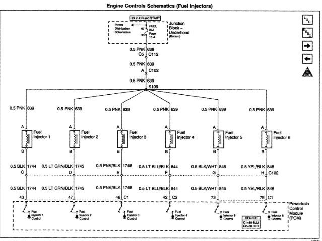

If you have spark and fuel pressure is correct, I need you to check for an injector pulse. Here is a link showing how that is done:
https://www.2carpros.com/articles/how-to-test-a-fuel-injector
______________

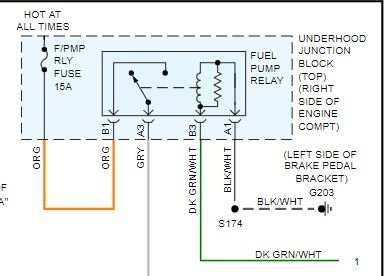

I also attached two pictures showing fuel injection fuse and the fuse for the fuel pump relay. Check them to make sure there are no problems, but wait till you see if the pressure is good.
Let me know what you find or if you have questions and what you find.

Hi larr283,
I had a similar problem with my 2000 Chevy Impala.
The engine would shut off at the most inopportune times (on the freeway at 65 mph, pulling away from a stop sign, in the parking lot at Home Depot, etc.).
Also, it usually happened about 20 minutes after the first start-up of the day.
Always, after a few minutes wait, it could be restarted and driven with no problems. The only indication on the instruments was the red battery indication that you normally get when you start the car. There was no check engine light or trouble codes.
After living with the problem for 6 months because the mechanics at the dealer could not find anything wrong with it, I found a mechanic who would do some actual troubleshooting.
The problem was the Crankshaft Position Sensor. It was interupting the power to the ignition module and causing the engine to shut down.
After it was replaced, all the problems went away. That was in October 2005 and there's no problem with the engine to this date.
TakeChargeSarge

TAKECHARGESARGE
  • 92 POSTS
Hello cassie2007,
If your engine stopped running while driving and the check engine light didn't come on and you were able to start it again within a few minutes and drive, then you should have someone check out the crankshaft position sensor. If it is going bad, the amount of current it passes will vary outside the limits and the engine computer will shut off power to the ignition module.
Almost any mechanic you take this problem to will tell you that they can't find anything wrong with it unless it happens while they are working on it, so you'll have to tell them what you want them to check.
Good luck,
TakeSargeSarge

TAKECHARGESARGE
  • 92 POSTS
Had this same problem with my 2000 Impala. It drove me nuts, but it always seemed to start again.
The problem was the Crankshaft Position Sensor. It's been 3 years since and no problems.
TakeChargeSarge
Jan 20, 2021 at 2:46 AM (Merged)
  • 110,248 POSTS
What he said could be correct. It is part of the ignition system and can shut down spark to the engine.
