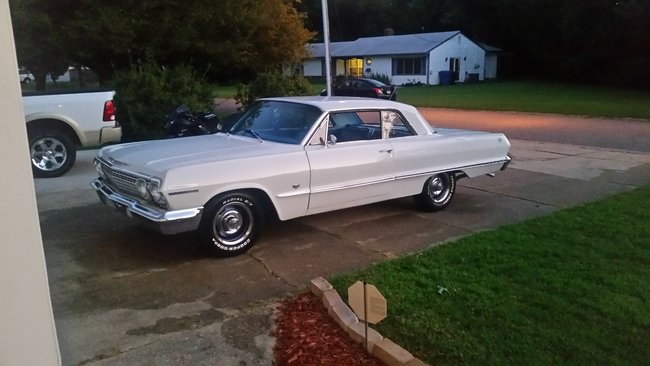

JAMES SMITH2
1963 SS IMPALA
Sunday, August 28th, 2016 AT 10:07 AM
CJ MEDEVAC
  • 11,005 POSTS
Let me know if the info makes it run better.
That looks really sharp and cared for.
I'd say you might could swap it for a Jeep, I doubt the Jeep guy would turn his loose! LOL!
