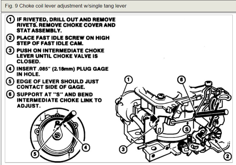

When I try to start it the choke light does not come on but just flickers with each rotation of the engine and I hear something under the dash clicking. I am hoping it is something easy, but I thank you in advance.

It sounds like the choke stove is shorting out. Remove the choke wire and see if the noise stops.
