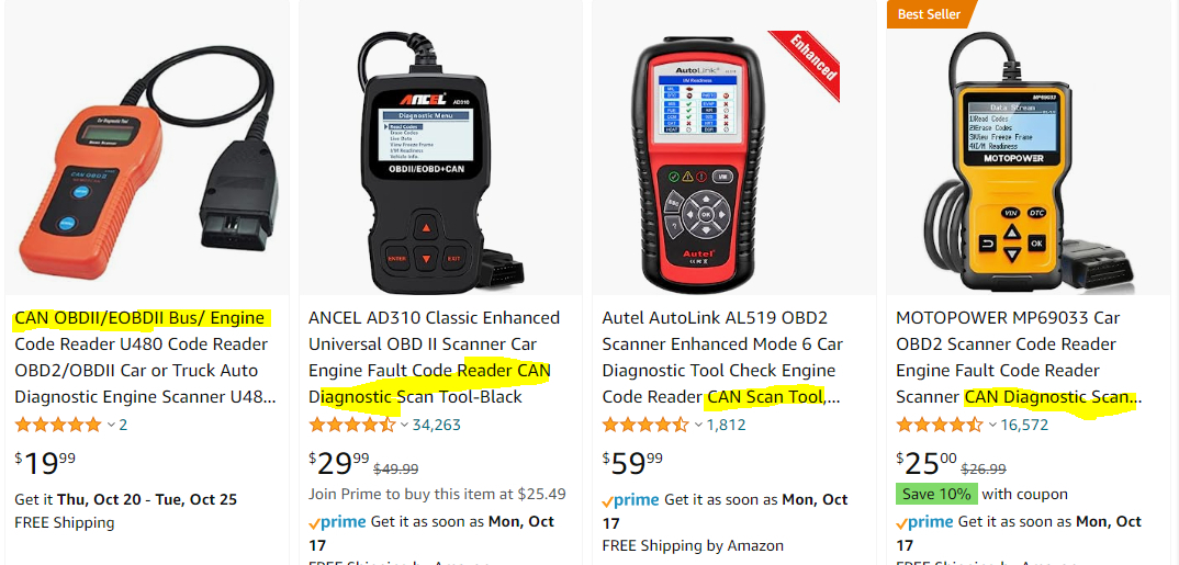

I was going to buy this Autel ML629 scanner.
But I don't see any mention of CAN.
Does it have an alternate name?
Here is the link:
https://www.amazon.com/gp/aw/d/B07M66RH77?ref=ppx_pt2_mob_b_prod_image
Oct 15, 2022 at 3:31 AM
  • 110,244 POSTS
That one can read more codes, but I don't see anything about reading the system. I attached a pic below from Amazon showing what to look for.
Please keep in mind, I am not recommending the scanners in the picture. I am not familiar with any of them.
