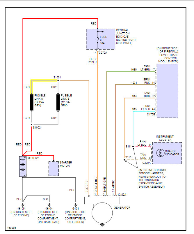

Here is a guide and some diagrams to help us find the problem:
and
and
Cheers,

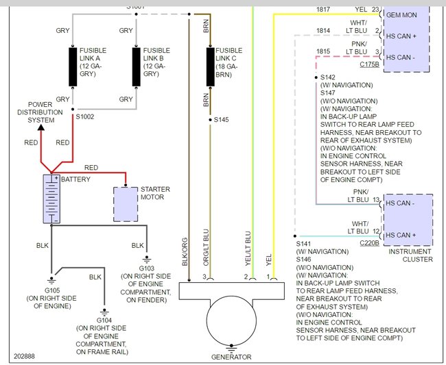

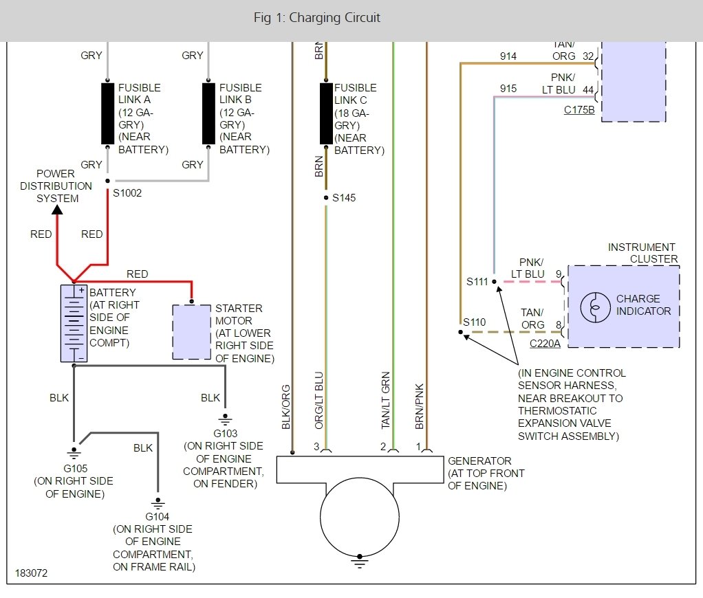

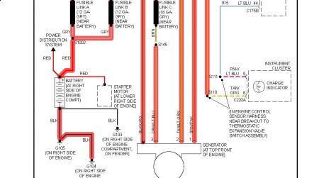

I found this wiring diagram for you, look at the connector at the alternator to see if they have been over heated which will cause a bad connection. Also, check the fusible links,
Below is a wiring diagram that will help.
Please let us know what you guys find so it will help others.
Best, Ken

Hello Dk78kk,
It looks like the problem is the PCM or you have high resistance or a broken fusible link, here is a diagram below.
Please let us know what you find so it will help others.
Best, Ken

There are some defects that can be detected by the voltage regulator, which turns on the "battery" warning light, even though charging voltage is within the acceptable range of 13.75 to 14.75 volts. The most common defect is one failed diode of the six inside the generator. The regulator detects that momentary dropout of one the three output phases. It responds to the lower voltage during that time by bumping the charging voltage up a little. You see the correct charging voltage. The regulator sees around eleven to twelve volts.
To add to the misery, Ford regulators can also turn the warning light on for an over-charge condition. When the regulator raises charging voltage in response to the dropout of the missing phase, it does that instantly, but when the two good phases come along, it takes some time before it brings the target voltage back down. That is why it might see something over 14.75 volts and turn the warning light on, while you measure a proper 13.75 to 14.75 volts.
Failed diodes are a permanent failure. That is found by performing a full-current load test with a professional load tester. It will show up as high "ripple' voltage, and the most current you'll be able to get is exactly one third of the generator's rated current. That is 30 amps from the common 90-amp generator, and that is not enough to run the entire electrical system under all conditions.
Another common failure is worn brushes, and those almost always are intermittent, at least at first. The mistake here is the testing has to be done while the problem is occurring. When the brushes make good enough contact to work, there is no defect to be found, so of course the system will test good. The testing has to be done while the problem is occurring.
The second consideration, after reading through the multiple posts here, is everyone did the obvious and replaced the generator, but the engineers unnecessarily complicated the circuit by involving the engine computer in what used to be a real simple system. It is very likely the computer set a diagnostic fault code, and that is triggering the warning message that is the common symptom here. Even when a wiring problem was found, and obviously affected system performance, the message did not go away when the system resumed working. It is likely necessary to erase the fault code after the repair has been completed, and that will turn off the message.
What no one ever listed here was the test results. "Full-load output current" and "ripple voltage" are just as important as charging voltage. Most testers just show ripple voltage between "low" and "high" on a relative bar graph, but that is a major clue in this story.

Normally changing to a different current rating does not cause a problem, but with the addition of all the unnecessary computer controls, it is hard to know what will cause an issue. Just because the plugs and wires might be the same, there could be some other differences we do not know about.
The key points to understand is an AC generator, ("alternator" is a term copyrighted by Chrysler, but it is the same thing), is physically and electrically incapable of developing more current than it was designed to deliver. I can impress you with the theory if you want me to, but it is not relevant to my wondrous story. The next important point is the generator will only develop the amount of current needed by the electrical system, and no more. It is similar to running a lawn sprinkler on a garden hose. No more water volume is going to come out if the city installs a water pump with double the capacity. What you gain by going to the 130-amp generator is the ability to get 130 amps, but only if that becomes necessary. If the vehicle needs 53 amps right now, you could have a 500-amp generator, but it is only going to produce 53 amps.
Where the potential problem comes in is when your mechanic performs a full-load output current test. That is designed to make the generator produce its maximum current for only a few seconds. Related to my previous reply where I discussed a failed diode and getting only one third of the rated current, under this test, you are either going to get very close to the generator's maximum rating, one third of it, or 0 amps. There is no such thing as a "weak" generator that can only deliver some value in between those three values.
To continue with this potential problem, as far back as 1960 when Chrysler first used an alternator, there has been a fusible link in the output wire between the alternator and the battery's positive post. There are two sets of three diodes in every AC generator, and if one in each set were to short, you would have a direct short to ground, and a melted wire. The fuse link, or fuse link wire, is a short section spliced in that is a smaller gauge, so it is the weak link in the chain. It is insulation is designed to not melt or burn. These fuse devices also protect you if you bump the output terminal with a wrench while it is in contact with the engine. Fuse link wires take some time to burn open, so they will not respond instantly like a regular fuse will. Almost every car was available with a standard generator, or a larger one if it had air conditioning, and an even larger one for police vehicles. The fuse link was sized according to the generator that was installed at the factory. If the car came with a 55-amp generator, the fuse link was probably good for around 65 amps, but remember, you would never need that much current except during the full-load output test. The problem I'm finally getting to is if you came along and installed a 75-amp generator, it still would deliver only the amount of current the car needed, until someone performed the full-load output test. That is when it would produce 75 amps, and if you did that long enough, the fuse link would melt.
To make matters worse, in almost all vehicles since the early to mid 1990's, the fuse link wire has been replaced with a regular fuse that's bolted into the fuse box. Those do not have the time delay feature a fuse link wire has. The instant you start the full-load test, the fuse will blow if the generator is able to develop more than what the circuit was designed for. When the wiring harness is manufactured, the output wire is large enough to handle whichever generator gets installed on that vehicle. Only the fuse link wire is different, per the application. That means if you wanted to switch to a larger generator, you could replace the fuse link wire with a larger one, and the rest of the circuitry could handle it. That is not always true when the vehicle uses a bolted-in fuse. It is easy enough to bolt in a larger fuse, but there can still be differences in the buss bar under those fuses that connects their common points together. There is always a small amount of resistance in an electrical connection. (Resistance in the water sprinkler analogy would be partially crushing the hose with your foot, which would make water volume go down). Electrical current flowing through resistance generates heat. Heat in an electrical connection tends to increase the resistance, and that generates more heat, and pretty soon you're one of the half dozen people who post a photo here each year of a melted area in their fuse box. That happened on its own, but if a generator was installed that had a higher capacity, then add some modification or accessory that needs that additional current, and you have the potential to stress parts of the circuit that cannot be upgraded.
Another factor is the car manufacturers have become really good at down-sizing electrical switches and connector terminals to the point they're just good enough, with almost no margin for error. In the 1970's, Ford figured out they could save twenty cents per car by leaving off four grease fittings. The suspension and steering parts sometimes lasted long enough to get the car out of the warranty period, then it was the owners' problems. While that sounds like saving a pittance and costing a lot in customer satisfaction, they argued they would save twenty million cents when they built a million cars, and they were willing to do that for short-term profits. When you ask for a replacement fuse box today at the dealer's parts department, why is it they usually ask for the engine size, generator size, and date of production? It is possible they traced too many garage fires to a melted fuse box, so they beefed them up a little, but only for the larger generators or some other optional equipment. It could be you do not have some optional equipment, and to save a few cents, they left off some terminals in the fuse box. Look in yours and you will see some empty sockets. Each terminal not installed saves a little money. To say that another way, a smaller terminal might be sufficient for use with the smaller generator, but when you switch to the generator with a higher capacity, and then you add the "hard-of-hearing" stereo systems to play "music" for me, or you add a pile of lights, or even convert a van to a camper package, you risk stressing parts of the electrical system that cannot be or were not upgraded.
Now that you have all this exciting information, it still boils down to your warning message that appears to be related to using the non-original size generator. Since around 2000, Ford's most "intelligent", meaning complicated, computer is the instrument cluster. It is one of two computers involved in blowing the horn, and it sticks its nose into almost every other circuit and system. We do not know what it is looking at to determine when to display the warning message, but when I read the message goes away after switching back to the original generator, it does not surprise me too much.

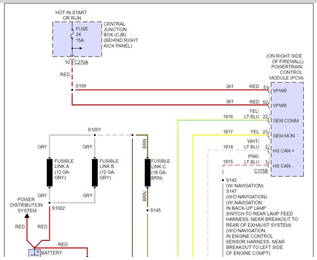

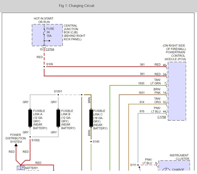

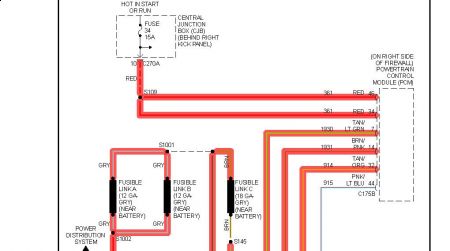

  • 75,992 POSTS
Check fuse no.34 15amp again it has a computer also called powertrain control module and see below
https://images.2carpros.com/forum/automotive_pictures/12900_alty1_20.jpg
https://images.2carpros.com/forum/automotive_pictures/12900_alty2_13.jpg
