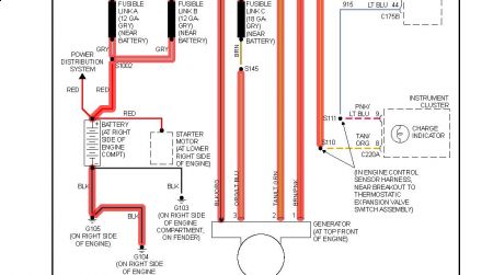

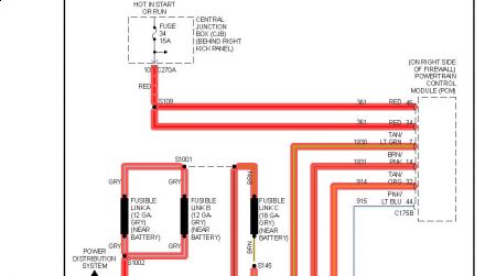

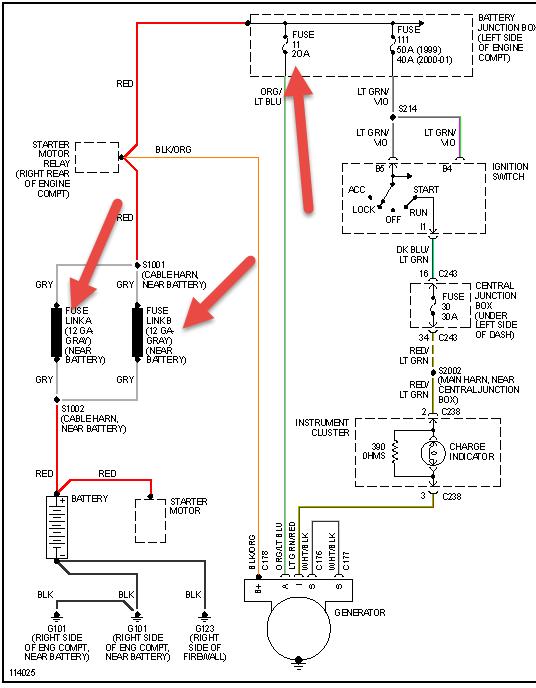

belt and tensioners have a lifespan of 60K so if original it's pretty wel shot. you might want to check the items in pic for corrosion as it may make it work harder but without looking at it it's kin dof hard to give a good diagnosis. What is the rating on the alternator and what power equiptment do you have on your vehicle. Is the battery the correct size? all of this makes a difference.
Nov 2, 2018 at 4:54 AM (Merged)
HEMPSTER
Replaced both battery and the alt. And the alt still won't charge the battery. Battery light is on in the dash. Both the battery and alt are new and both have been tested and are good.
HMAC300
  • 48,601 POSTS
check items in pic fusible link or fuse may be bad on these as well as starter relay not makin ggood contact

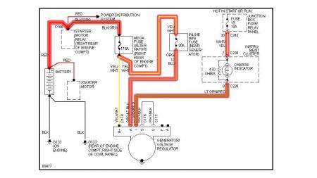

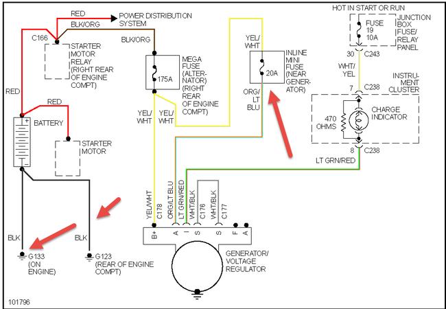

i have a 97 ford expedition, the alternator is not charging the battery. I have checked the battery and replaced the alternator twice and still not working. Sometimes it does charge and sometimes it will start off not charging and then something will click and then it starts charging while i am driving. checked the fuses on the firewall and under the hood/under dash and they are good.
May 4, 2020 at 6:43 AM (Merged)
  • 75,992 POSTS
Double check the connections and also see charging system EWD below
https://images.2carpros.com/forum/automotive_pictures/12900_charge_4.jpg
