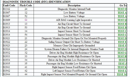

air bag light flash 5 times then 2 times why how do I fixed

My airbag light flashes the 52 code and then stays on. This is following problems with the radio, locks, and power windows. a mechanic replaced the windshield because it was leaking (seems to be a problem with this model) and all was fixed but the airbag light. Is it easy to identify and repair the problem or must I pay $85.00 just to have it diagnosed?

I don't see 52 on the flash codes list, You will need a scanner that reads "B" codes...
https://images.2carpros.com/forum/automotive_pictures/62217_Air_Bag_Codes_1.jpg
