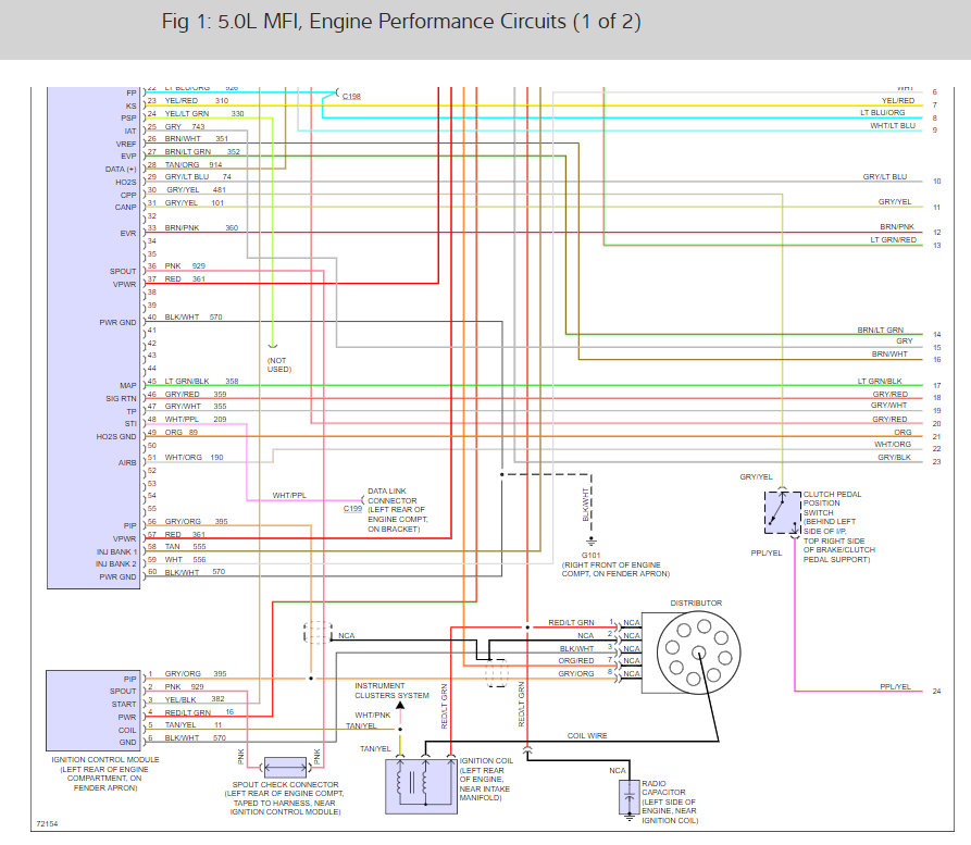

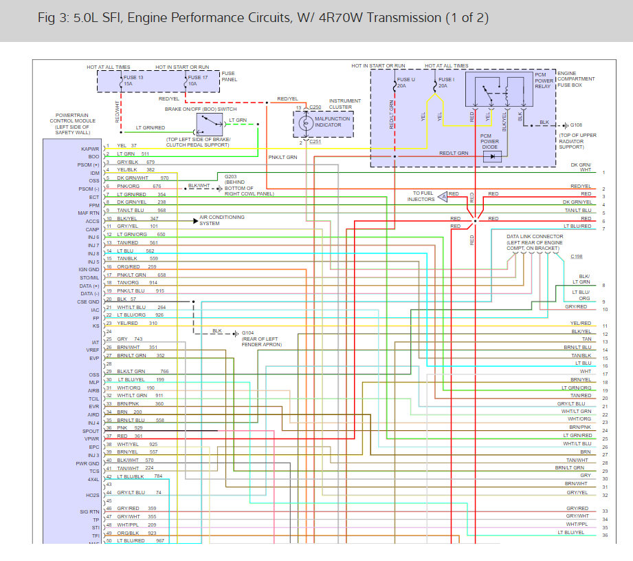

Speedometer, odometer do not work, overdrive light on shifter flashes after 20 mph, hard shift only when downshifting out of overdrive, ABS light on. Checked all fuses they were good, changed VSS and pig tail still not fixed. Any ideas?
Nov 17, 2018 at 9:56 PM
  • 55,721 POSTS

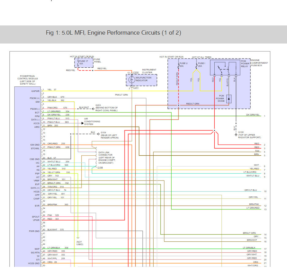

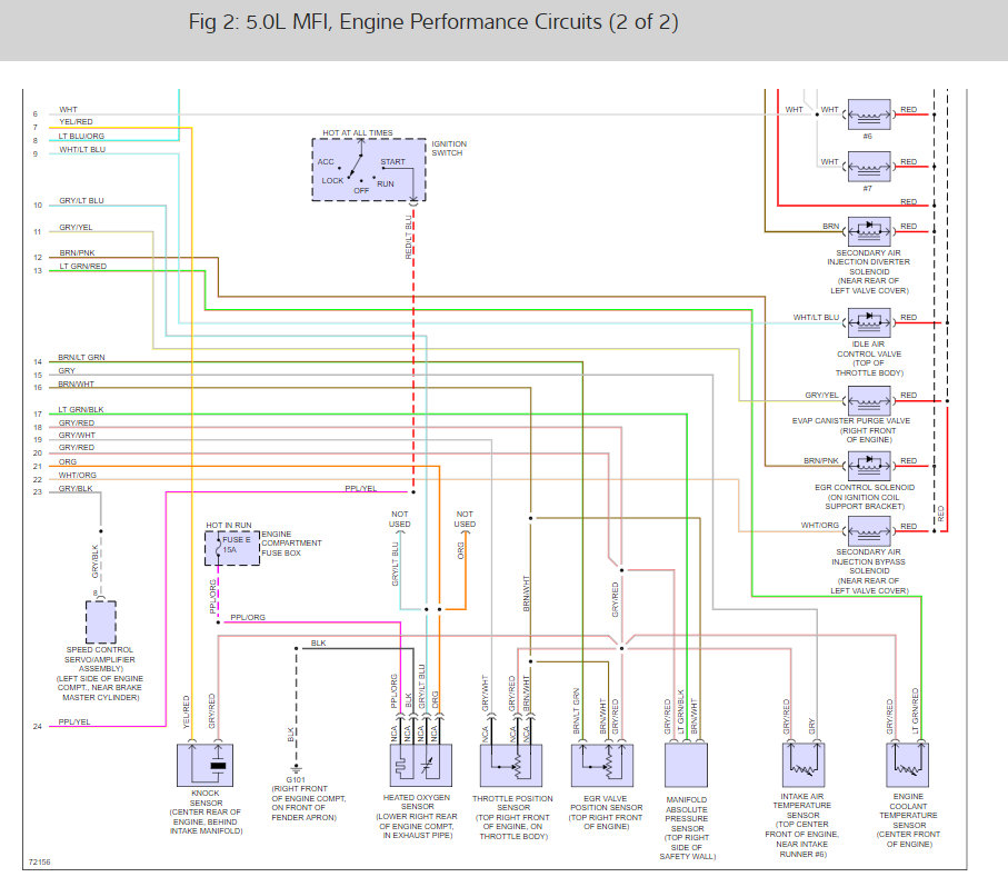

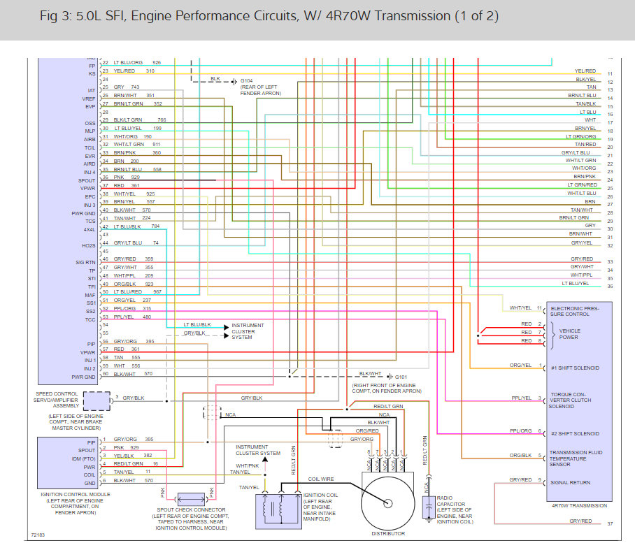

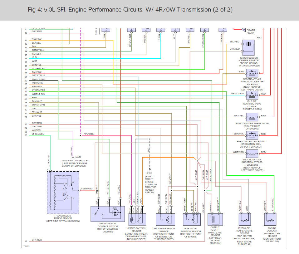

It sounds like the PCM went bad but to be sure lets do a wiring check between the VSS and the PCM. Here is a guide to help us and the engine and transmission wiring diagrams so you can see how ti works and which wires to test. Check all fuses as well.
If the fuses and wiring checks out I would try a used/rebuilt PCM. Check out the diagrams (below). Please let us know what you find. We are interested to see what it is.

Did a recheck on wires and found the wires to the ABS sensor on the rear differential broke. I fixed them and the ABS light overdrive light both went off but the speedometer works fine until you reach 50 mph then starts bouncing around like crazy. Gas gauge still does not work. Thinking sending unit, needle moves from full to well overfull when I turn the key on transmission still has a pretty firm shift and shutter from time to time on the highway.

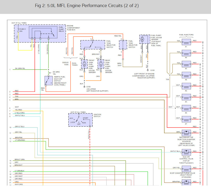

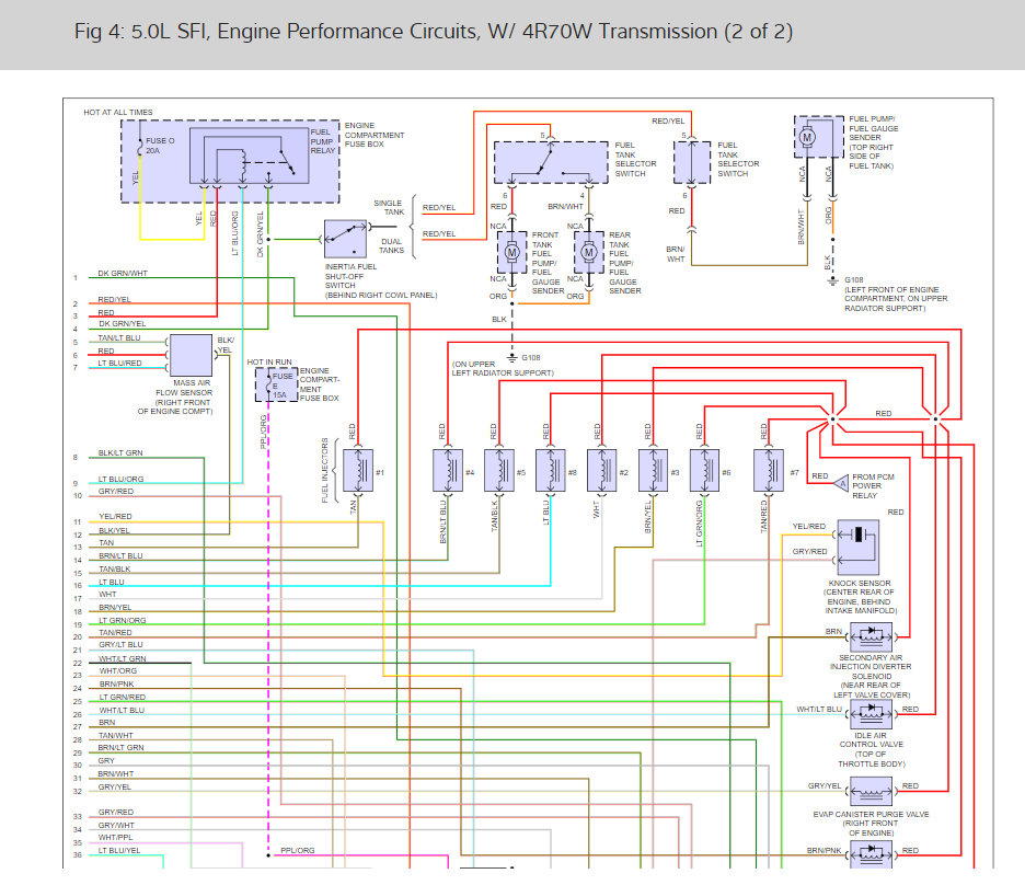

Is the VSS sensor OEM? I would install the old one if not. Cheap sensors can make the needle bounce. It does sound like the fuel level sensor for the fuel gauge issue. To confirm the issue remove the fuel gauge wires and ground it, (yellow and white wire).
Nov 23, 2018 at 4:22 AM
WALTER WOOD
  • 24 POSTS
I cannot find a yellow and white I have a brown and white and yellow and green. Then an redish orange and thick black. I assume those are fuel pump, the other two wires give no signal on my meter, and gauge does not react when they are grounded.
Nov 24, 2018 at 4:37 AM
WALTER WOOD
  • 24 POSTS
Oh, put the original VSS back in and all other problems fixed. Speedometer and odometer work fine. ABS light is off and she shifts normal. Thank you for the help. All that is left is gas gauge.
Nov 24, 2018 at 4:51 AM
WALTER WOOD
  • 24 POSTS
Gas gauge repaired, I bypassed the yellow and green wire and the gauge started working. Every issue I had was faulty wiring.

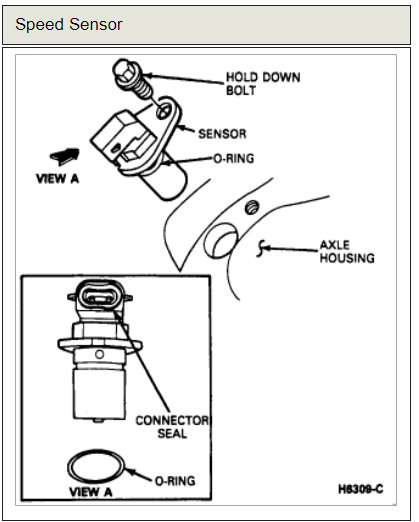

while driving the other day, was going downhill and noticed my speedometer and electronic odometer quit working then tranny down shifted with a jolt, when sped up transmission now shift at 2500 rpm but with a hard jolt , any ideas
Apr 6, 2021 at 11:10 AM (Merged)

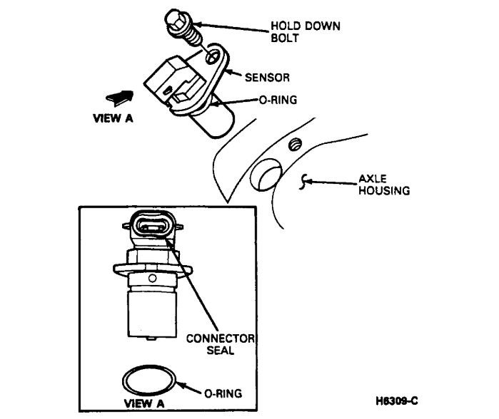

JAMES W.
  • 2,394 POSTS
The vehicle speed sensor is located on the differential housing in the middle of the third member. Here is a guide to help you see what I am talking about.
Cheers
CHUCKVIC
Yep that did the trick I got a new sensor for 34.99 and it fixed the problem thanks for the tip this site is great.
