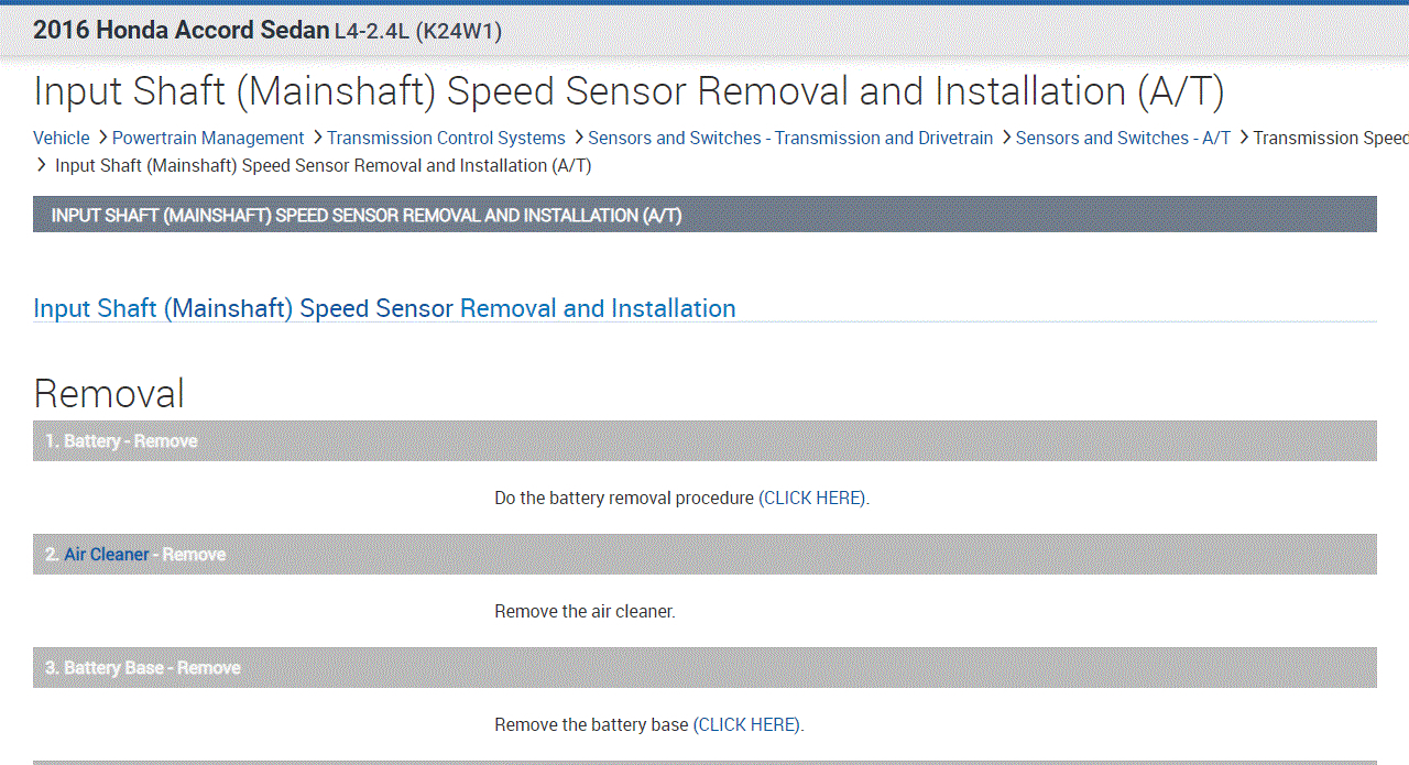

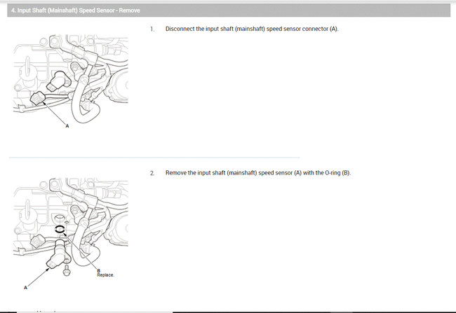

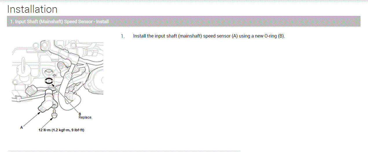

where is the speed sensor located on the transmission?
i'm getting code po0717.
Jul 27, 2021 at 2:21 AM
  • 110,244 POSTS

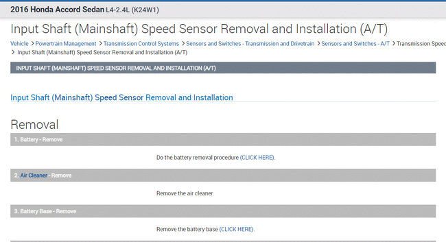

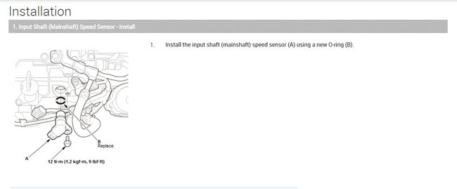

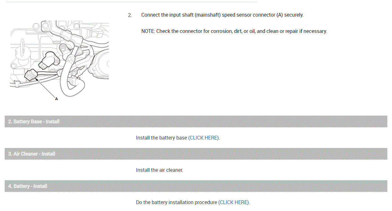

The code you have indicates a problem with the input speed sensor. To access this sensor, you will need to remove the battery and battery box, and then the sensor will be on the side of the transmission.

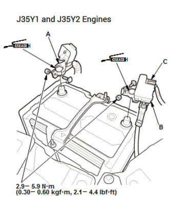

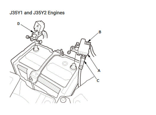

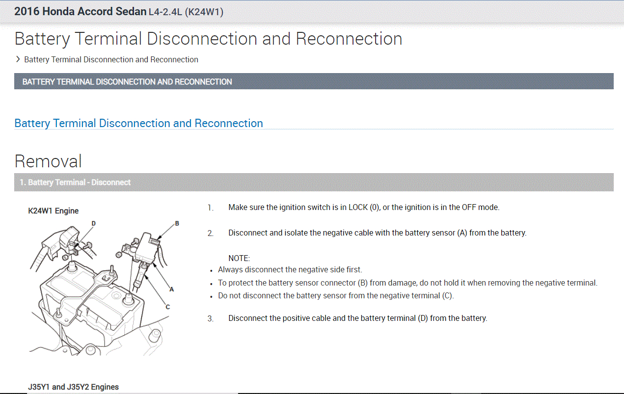

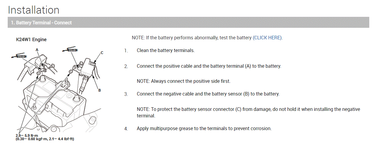

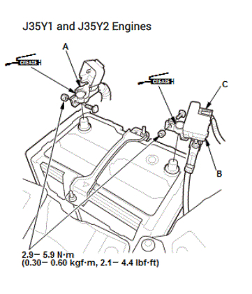

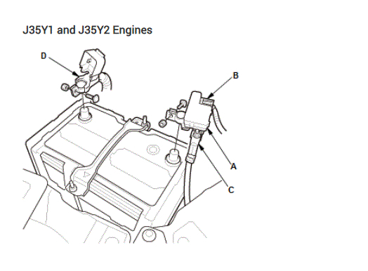

If you look at the pics below, I included directions for replacing this sensor. Note: Honda has a specific way they want the battery disconnected and then reconnected. I attached those directions as well.
