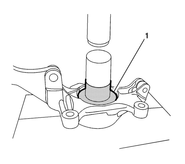

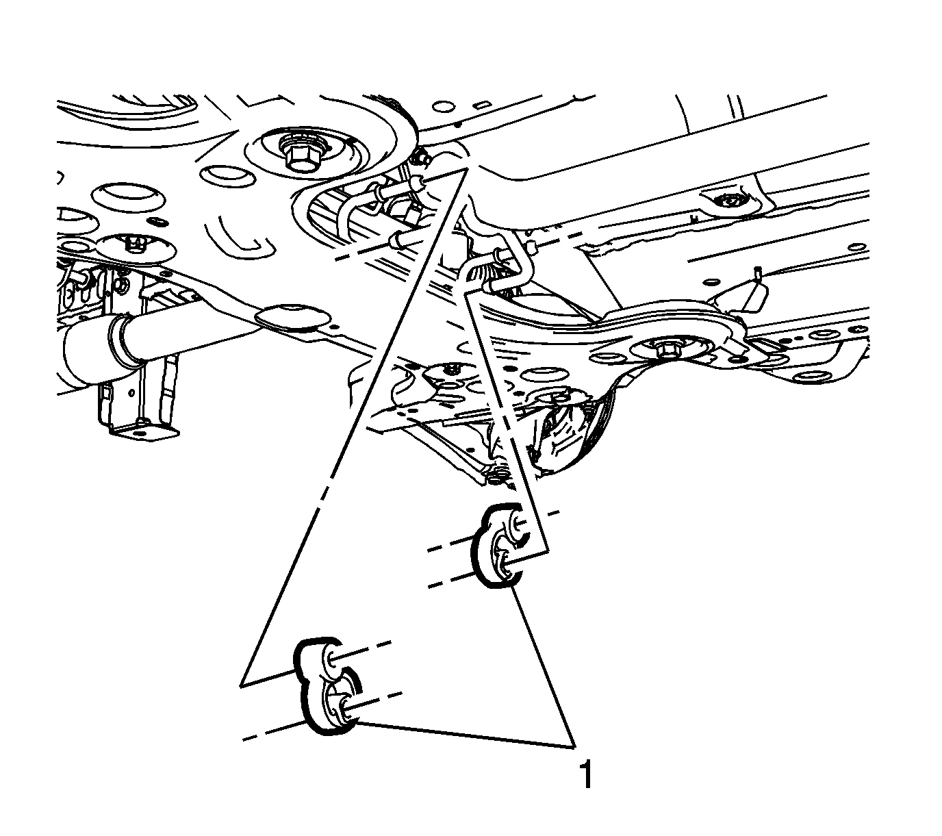

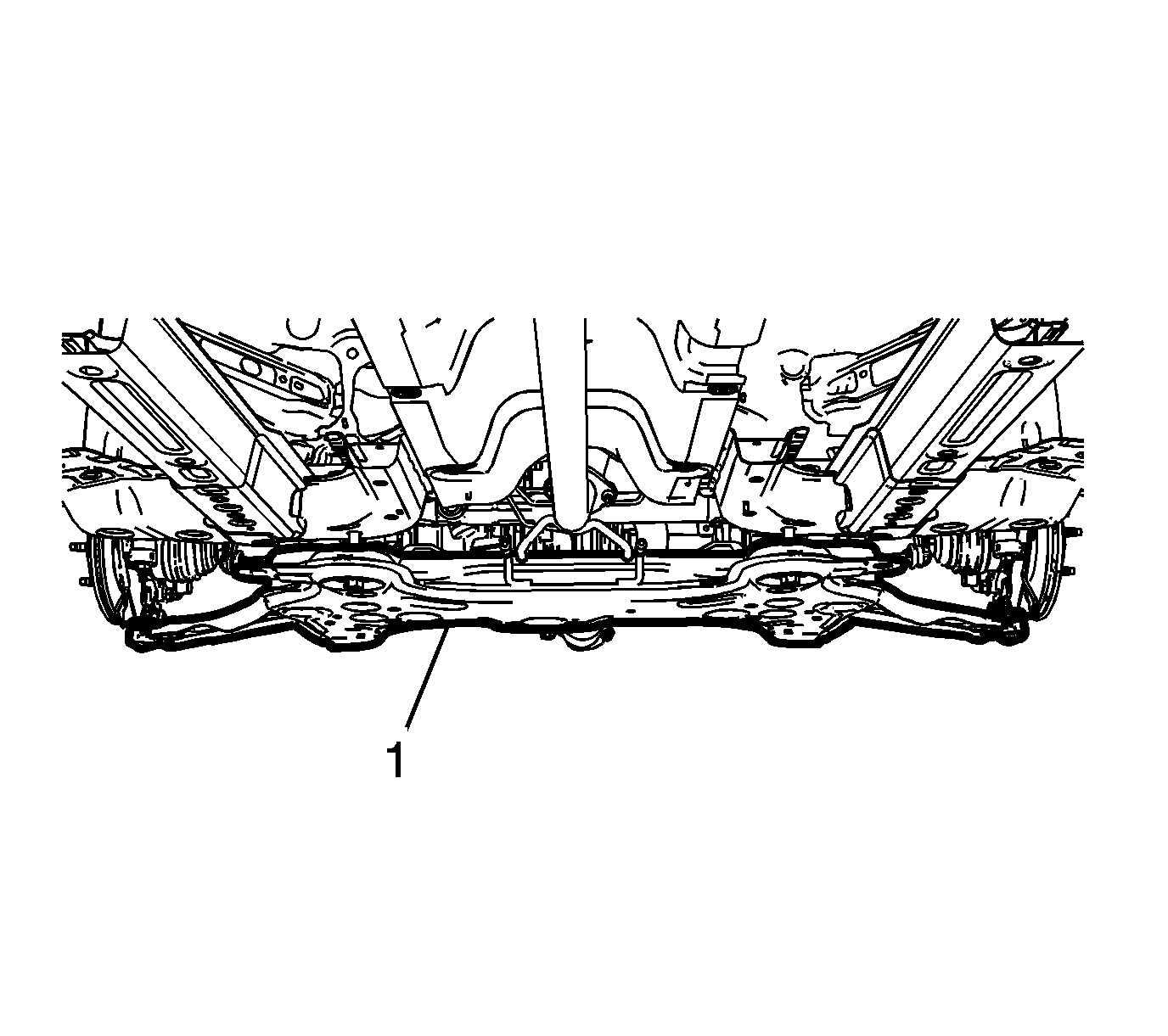

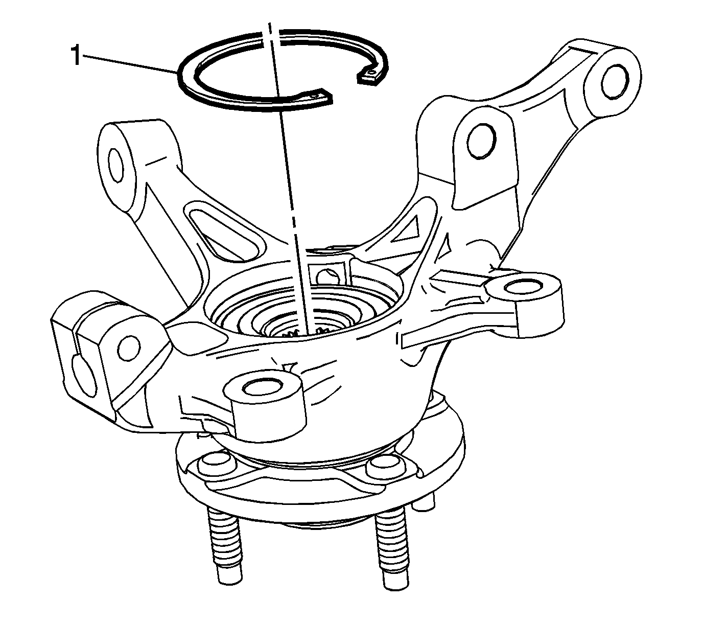

I'm not sure where you are located, but often times, cold temperatures will cause creaking sounds from bushings on the front of the vehicle. Often times they can be control arm bushings or sway bar bushings.
If you look at picture 1, it shows the sway bar bushings that I am referring to. If you bounce the front of the vehicle and hear the noise, check them first. Please keep in mind that the cold temperatures can cause the rubber to contract and this sound may go away once it warms back up.
Picture 2 shows the control arm and bushings. Again, these can be the problem.
Inspect them and let me know what you find. I can provide directions for component replacement if needed.

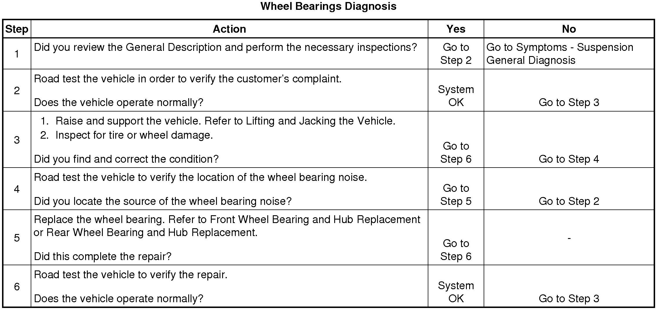

Thank you for the information. In addition to doing this, how do I determine/troubleshoot the front wheel bearings?
Feb 2, 2019 at 9:41 AM
  • 110,194 POSTS
Welcome back:
Most often, a wheel bearing will make a howling noise which changes pitch relative to speed. When you hear that noise, in a safe area, turn left and right to see if the sound changes. If it does, it's a bearing. What happens is this. When you turn right, the vehicle's weight increases on the left side. So, if it gets louder when turning right, the left bearing is bad. If the sound gets quieter, the right wheel bearing is bad. It will get quieter because you take weight off it.
Now, if you safely lift the wheels off the ground, place your hands at 6 and 12 o'clock and try to wiggle the wheel. If you find play, that can also be a bearing issue.
I hope that makes sense.
Also, I attached a picture (picture 1) which is the diagnostic flow chart for determining wheel bearing issues. Take a look at that too.

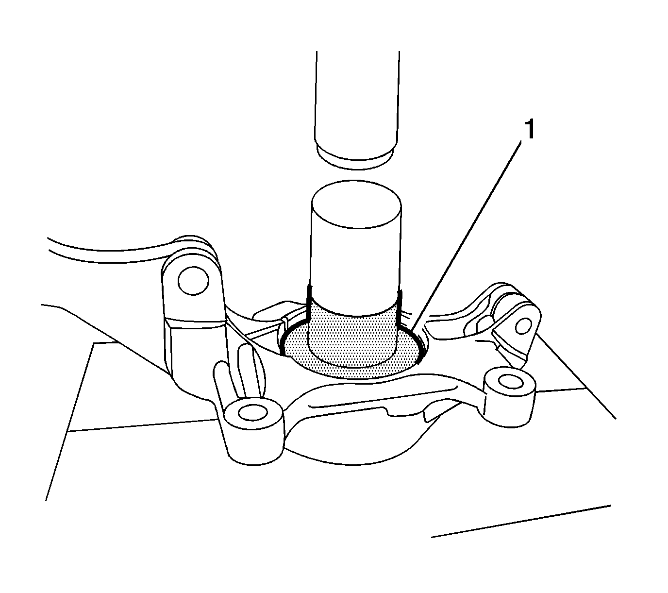

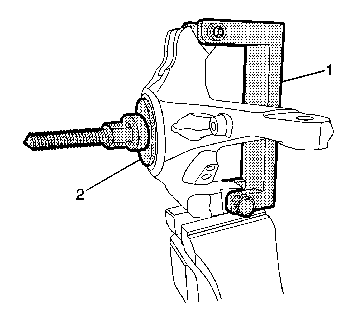

If you determine a bearing needs replaced, here are the directions. The first set of directions are for the front wheels and the second are the rear. All attached pictures starting with number 2 correlate with these directions.

Removal Procedure
1. Raise and support the vehicle. Refer to Lifting and Jacking the Vehicle See: Vehicle Lifting > Procedures > Lifting and Jacking the Vehicle.
2. Remove the steering knuckle assembly from the vehicle. Refer to Steering Knuckle Replacement See: Front Steering Knuckle > Removal and Replacement > Steering Knuckle Replacement.

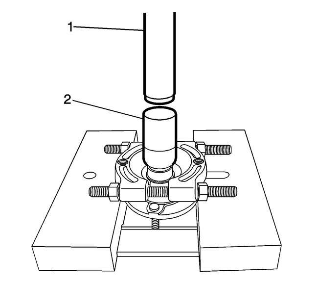

Picture 2

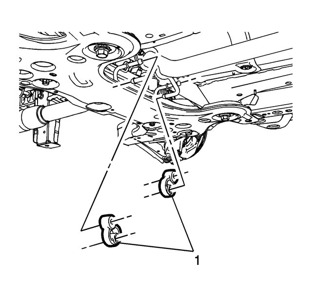

3. Position the steering knuckle assembly (1) in a suitable vise.
4. Position the CH-50059-1 wheel hub/bearing removal/installation bridge assembly (1) and the CH-50559-2 wheel hub/bearing removal/installation adapter (2) on the wheel bearing inner hub.
5. Using the CH-50059-1 and the CH-50559-2 , remove the wheel hub from the wheel bearing.

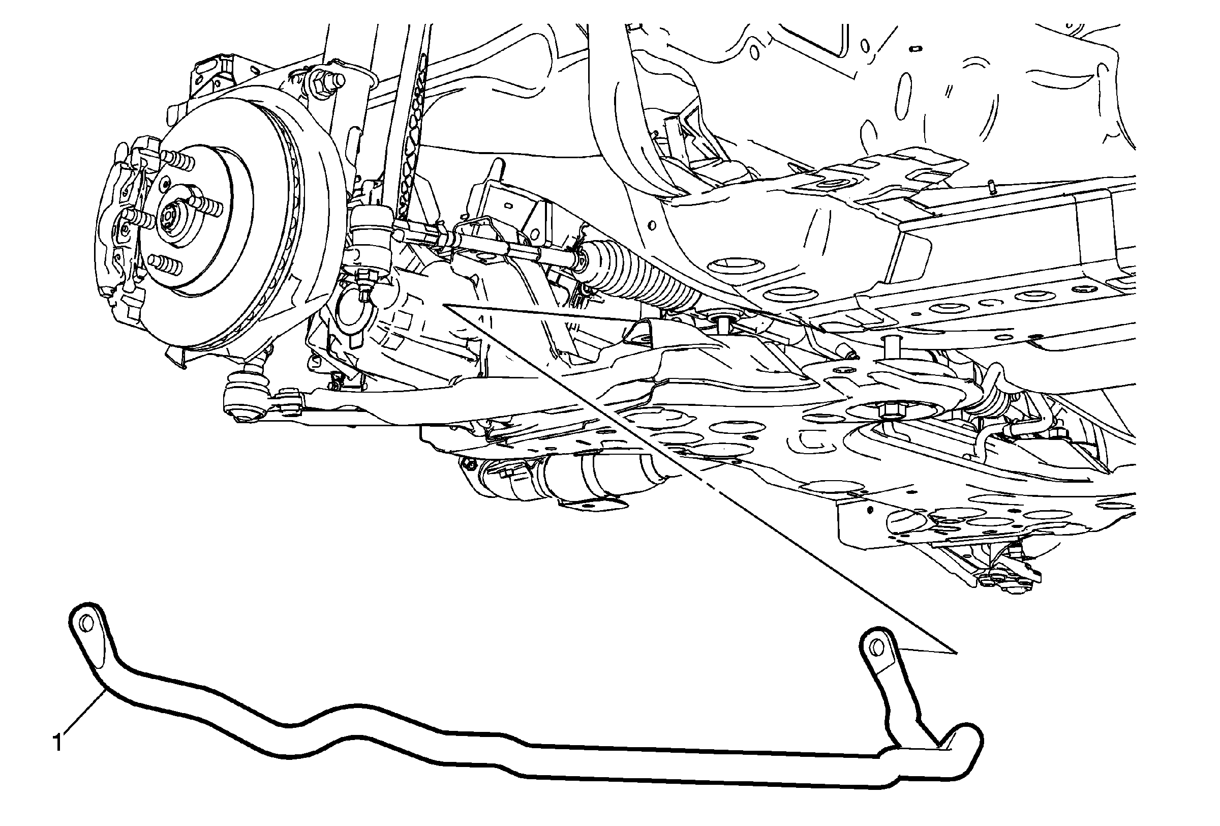

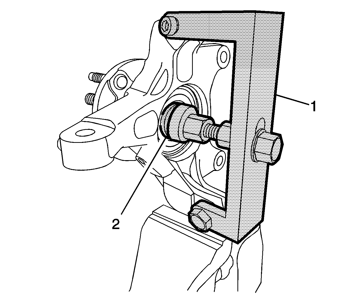

Picture 3
6. If the inner race of the bearing is pulled out with the hub, remove the inner race from the using the appropriate tools.

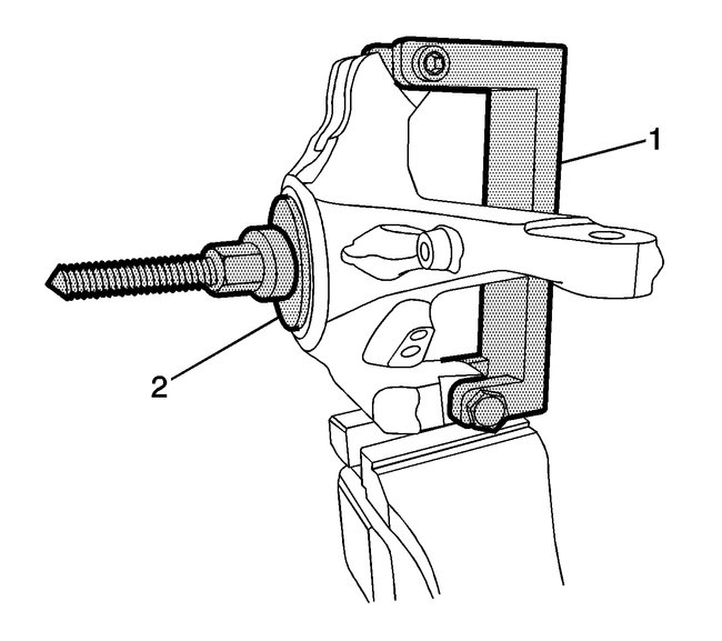

Picture 4
7. Using the appropriate tool, remove the retaining ring (1) from the steering knuckle.

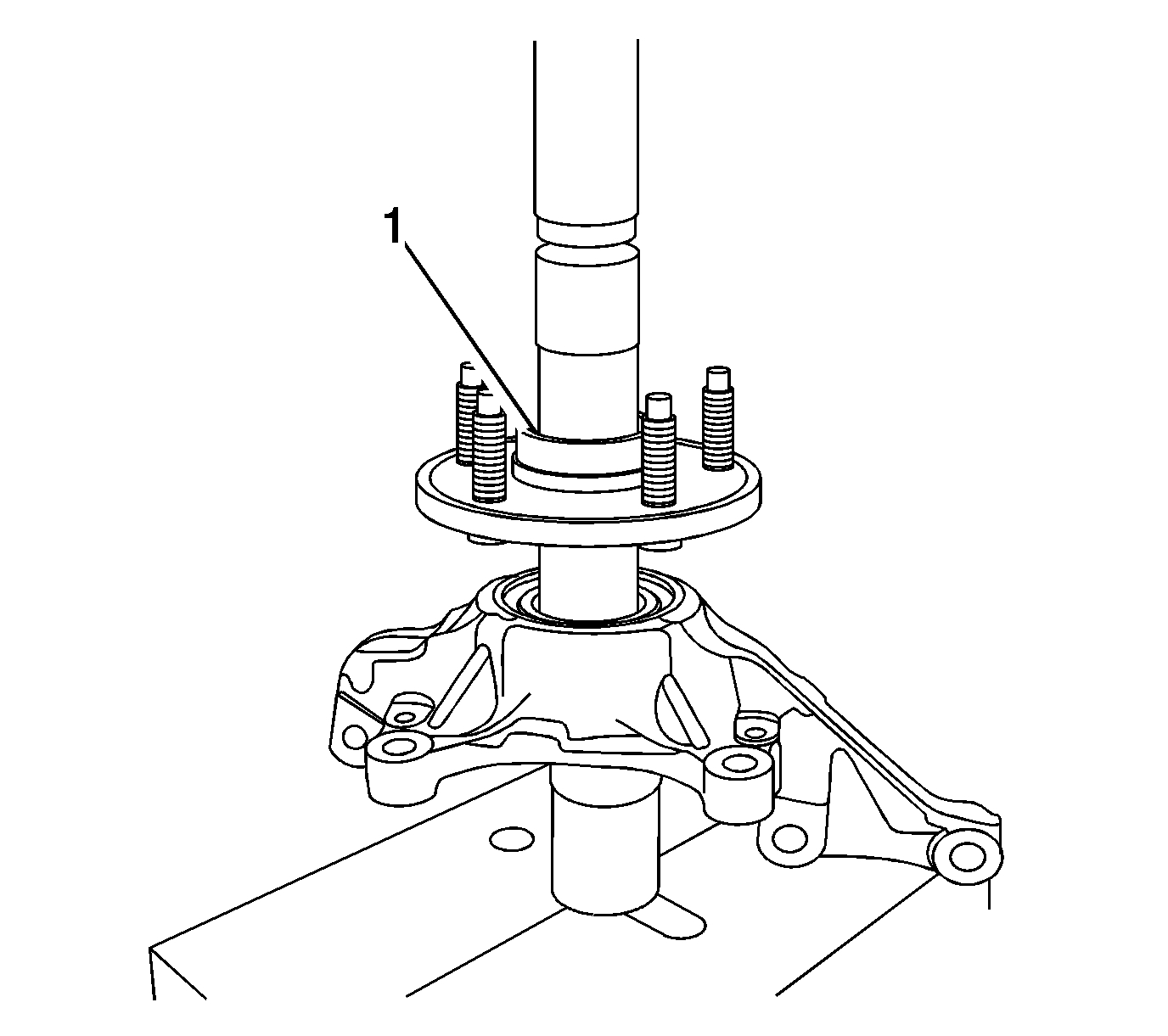

Picture 5
8. Position the CH-50559-1 wheel hub/bearing removal/installation bridge assembly (1) and the CH-50559-3 wheel bearing removal adapter (2) on the steering knuckle.
9. Remove the wheel bearing from the steering knuckle and discard it. Inspect the bore of the of the steering knuckle for pitting, scoring wear, or corrosion. If damage cannot be easily cleaned up with light sanding, replace the steering knuckle.
Installation Procedure
Picture 6
Note:
Ensure that the wheel bearing is evenly seated in the steering knuckle.
1. Using the CH-50559-4 wheel hub/bearing installation adapter (1) and the appropriate extension and press, install the new bearing into the steering knuckle until it is correctly seated.
Picture 7
2. Position the CH-50559-4 (1) wheel hub/bearing installation adapter and the appropriate extension to the inside of the bearing and position the CH-50559-2 wheel hub removal/installation adapter and the appropriate extension on the wheel hub.
3. Press in the hub until it is correctly seated.

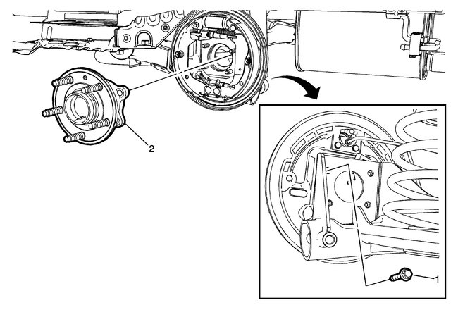

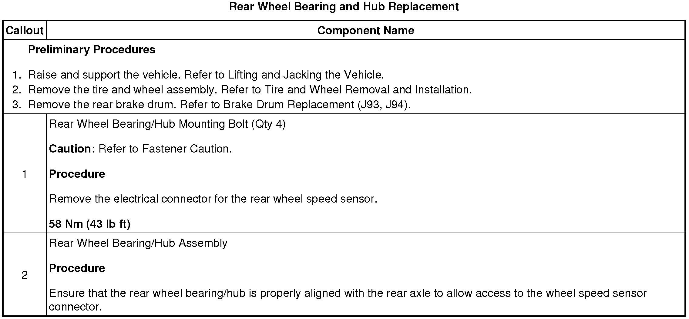

For rear wheel bearing replacement, see pictures 9 and 10.

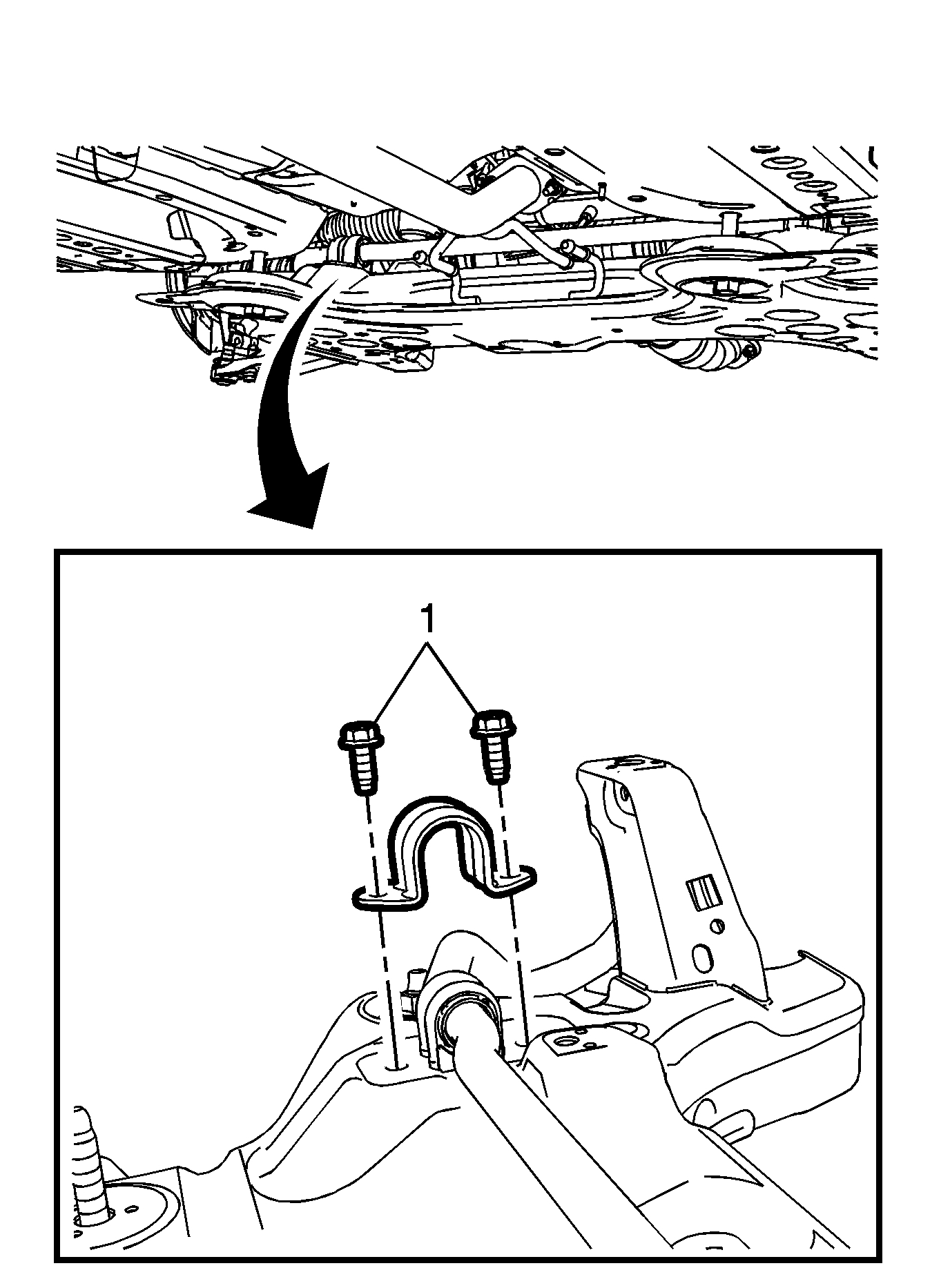

Honestly, I live in PA and it is a common occurrence. The bushings aren't really bad. The cold temperature caused them to contract and if they are a bit dry, they make a creaking noise. If you checked them and the sway bar has little to no movement, I would leave them alone. If, however, you want to replace them, here are the directions.
____________________________________________________________________
Here are the directions for replacing the stabilizer bar itself. This process is extensive, but you should be able to eliminate many of the procedures because you don't have to remove the entire bar. Just remove the mount, then the bushing has a slice on one end so you can twist it off and the new one on without taking the entire bar out. The pics correlate with these directions.

Picture 1
10. Remove the exhaust pipe insulators (1).
Picture 2
11. Release the front suspension frame front bolts about 10 mm.
12. Usingf a suitable support, support the crossmember area of the cradle.
Note:
It is not necessary to remove the front bumper facia in this procedure.
13. Using a suitable support, lower the front suspension frame (1) about 500 mm enough to gain access to the stabilizer shaft insulator bolts and to remove the stabilizer shaft. Refer to Drivetrain and Front Suspension Frame Replacement
Picture 3
14. Remove the stabilizer shaft insulator bolts (1).
Picture 4
Note:
It maybe necessary to maneuver the front stabilizer shaft in such away as to remove it from the front suspension frame.
15. Remove the front stabilizer shaft (1) from the front suspension frame.

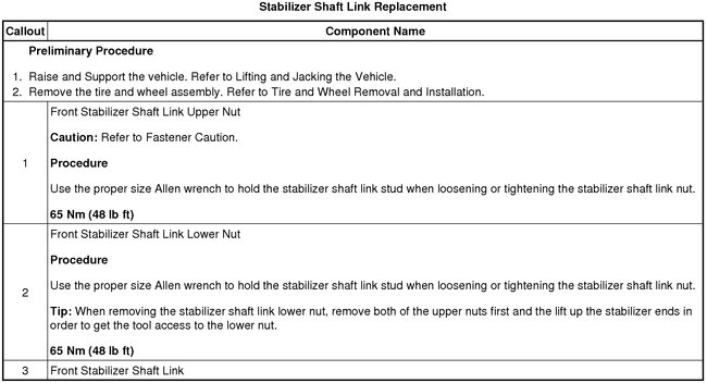

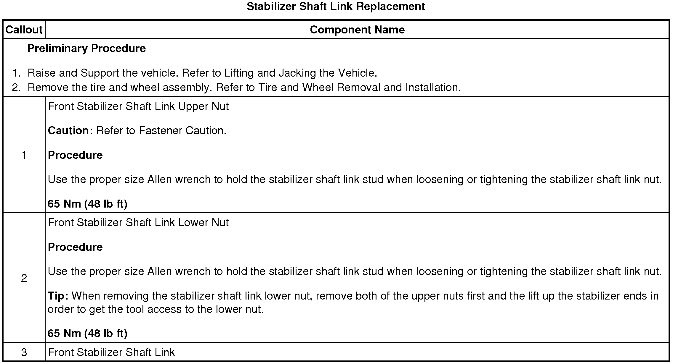

For the stabilizer link (vertical) the directions are pictures 9 and 10.

Would you be able to describe how I check the stabilizer links and/or sway bar rubber mounts?
Jun 24, 2019 at 3:54 AM
SIRJR
  • 86 POSTS
And thank you very much for the quick reply.
Jun 24, 2019 at 2:28 PM
  • 110,194 POSTS
Welcome back:

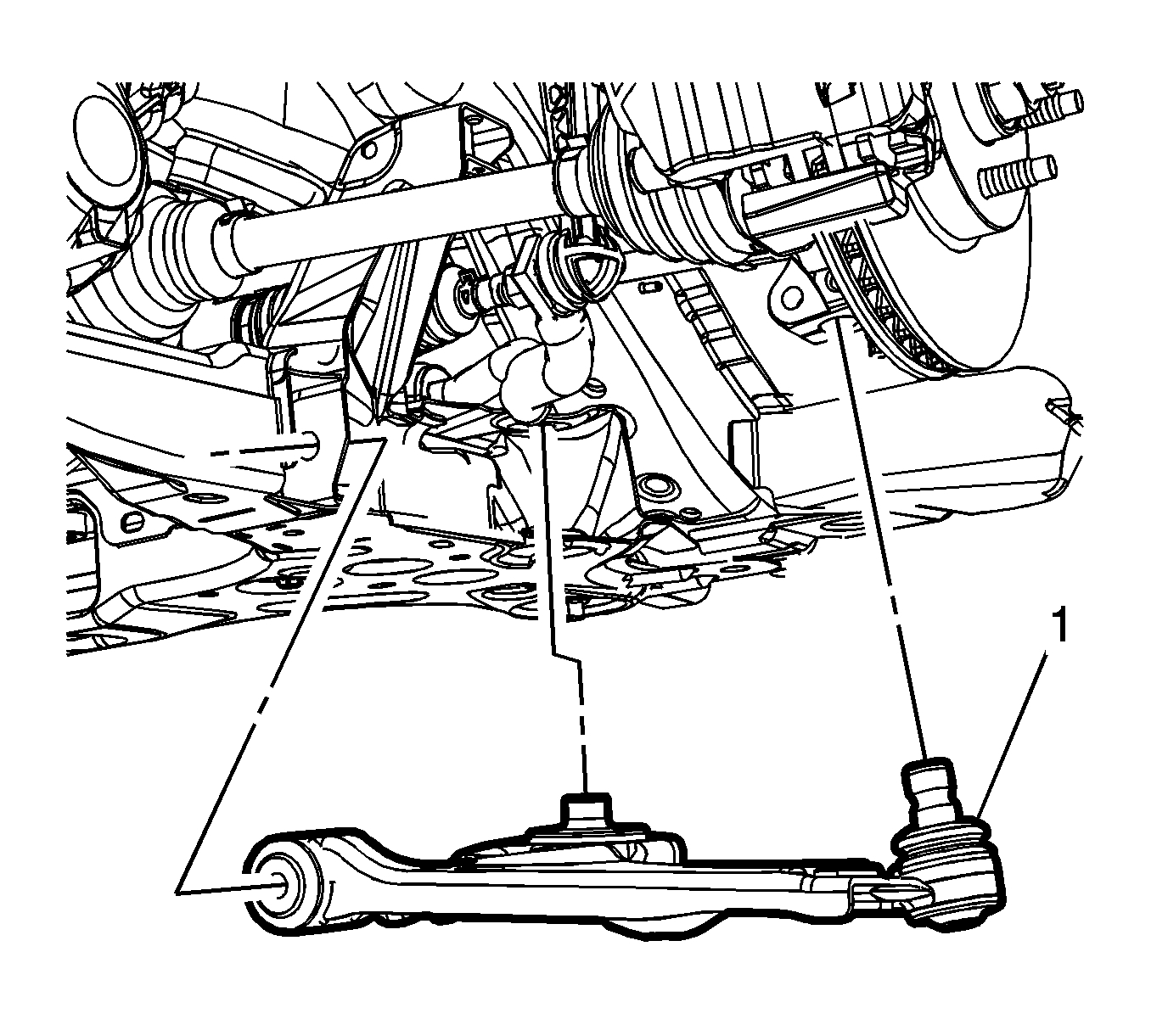

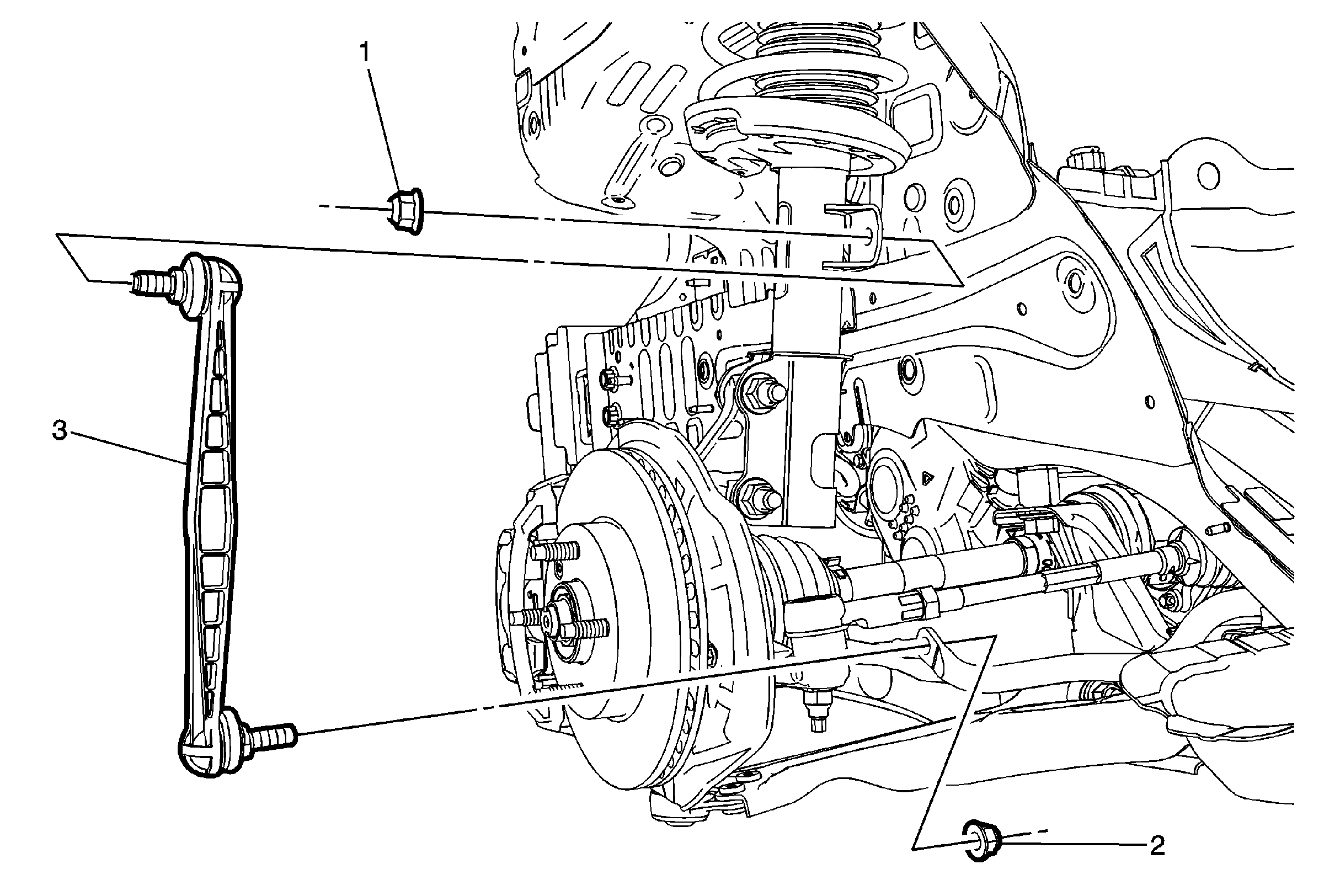

Basically you are just checking to see if there is excessive play in them, if the rubber mounts are worn or missing, and often times a link will actually break. However, they too can just have excessive play.
Don't laugh, but I just grab onto them and with aggression, see if I can move anything. If everything is tight, then I suspect it could be strut plate.
Jun 24, 2019 at 6:00 PM
SIRJR
  • 86 POSTS
Replaced the sway bar stabilizer links and clicking sounds gone! The lower connections, the ones that connect into away bar, were very loose. I can't thank you enough for your expertise in helping me resolve this issue with my daughter's Sonic.

Update on the sway bar stabilizer links. After a couple of weeks the noise started to return. The issue I had with the stabilizer links that I installed was that I couldn't apply a torque wrench because in order to tighten the nut on the stud, you had to hold the stud with a torx socket to prevent the stud from turning. I decided to purchase the Moog stabilizer links that have a nut on the stud to hold with a box wrench to prevent the stud from turning while I was able to torque the nut on the distal end to the correct torque specifications. In almost a month, no more issues! Also, the Moog product was much more substantial in quality; therefore, worth the additional cost. I'm now quite the expert in removing and installing sway bar stabilizer links!
Hope this will help other people that have to replace this part.
Steve
Sep 4, 2019 at 8:11 AM
  • 110,194 POSTS
Welcome back:
That's good news. And yes, two wrenches are needed to tighten them. Anything to make things more difficult.
