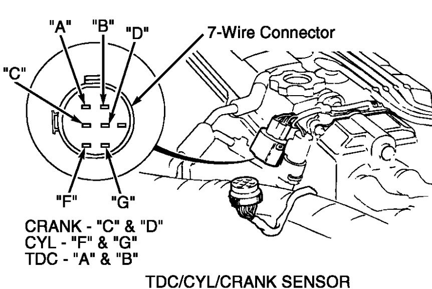

My car starting having this issue about a month ago where it randomly decided not to start then a day or so later it will. The s3 light will flash and the check engine light stays on. It cranks but will not start. I decided to check the codes and its throwing codes: 1,2,3,7,8. I looked them up and it is saying ho2,tdc,ckp, map and tp. Where do I start?

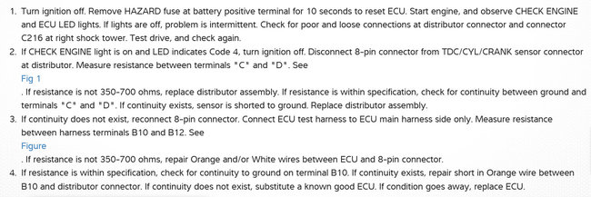

Correction the ckp is a code 4. I do not know what else could cause it to be so fickle.

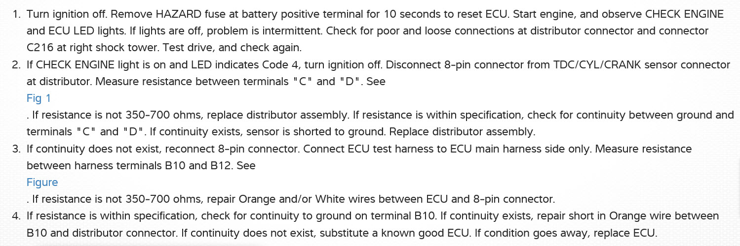

follow instruction on what i am sending for crank sensor. it may also be a harness problem. then check all your vacuum hoses for cracks/broken or soft. if any of conditions with vacuum hoses replace them. then If problem persists check by putting vacuum pump to map sensor if it does not hold replace it if holds then it is okay.
