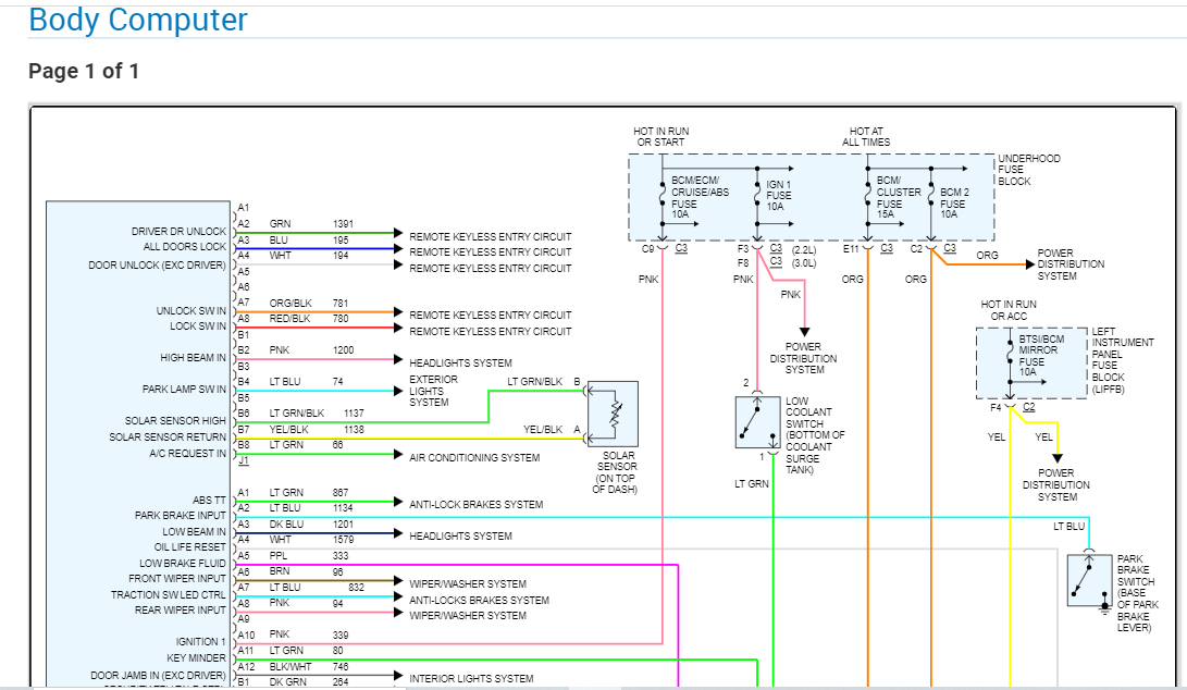

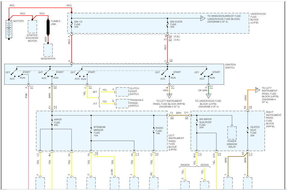

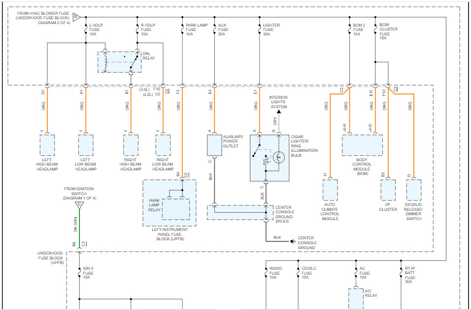

I've been looking at the BCM diagrams you sent, I see nothing that looks like it controls the gas gauge or spark (ignition). It appears that IGN 1 is what powers up the BCM (or some of its functions in Start or Run), IGN 2 is hot at all times.
Would you be able to send me a copy of the under-hood fuse block wiring diagram? That might help me locate the circuits that the trouble is related to.

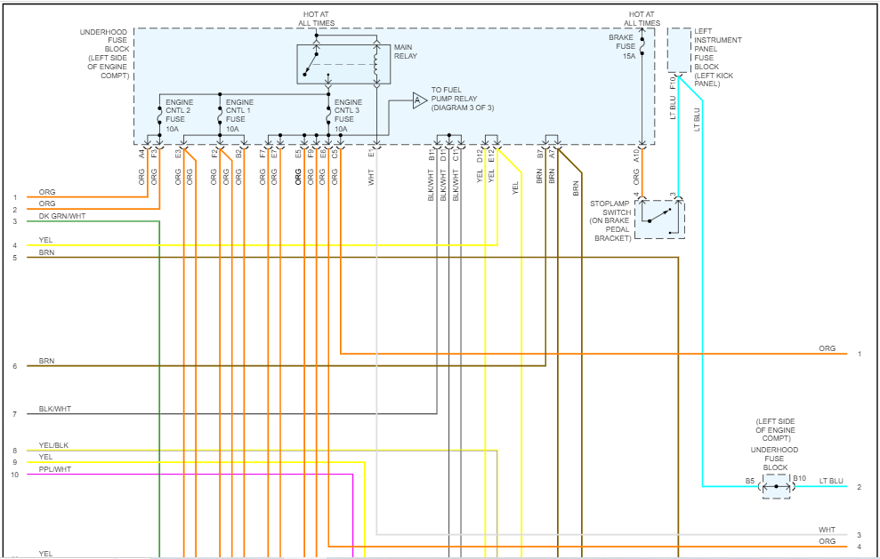

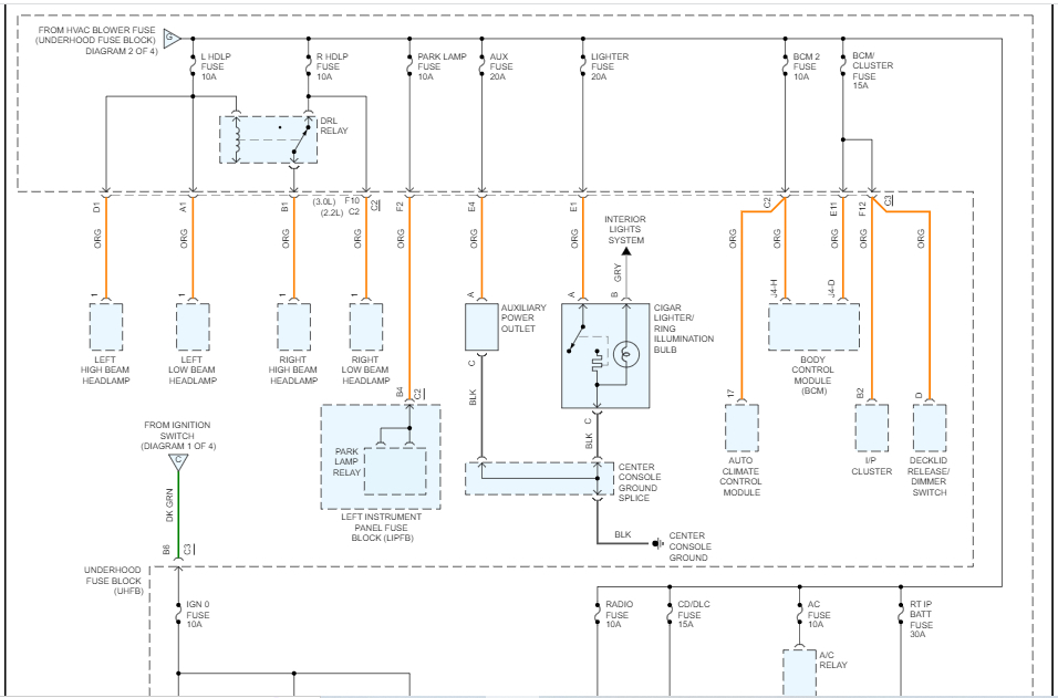

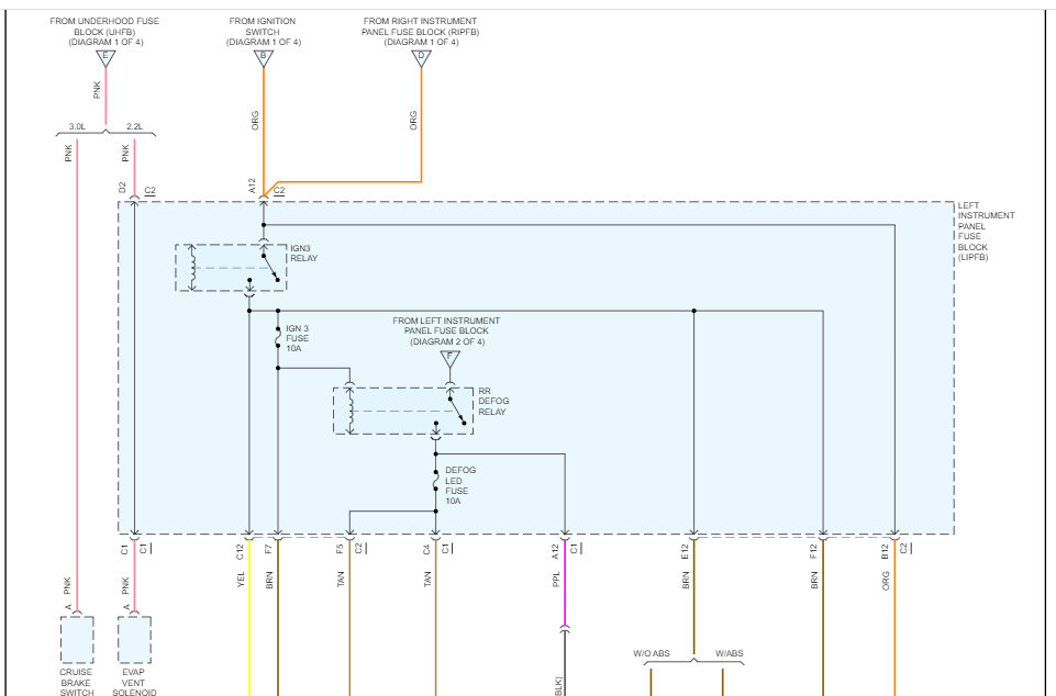

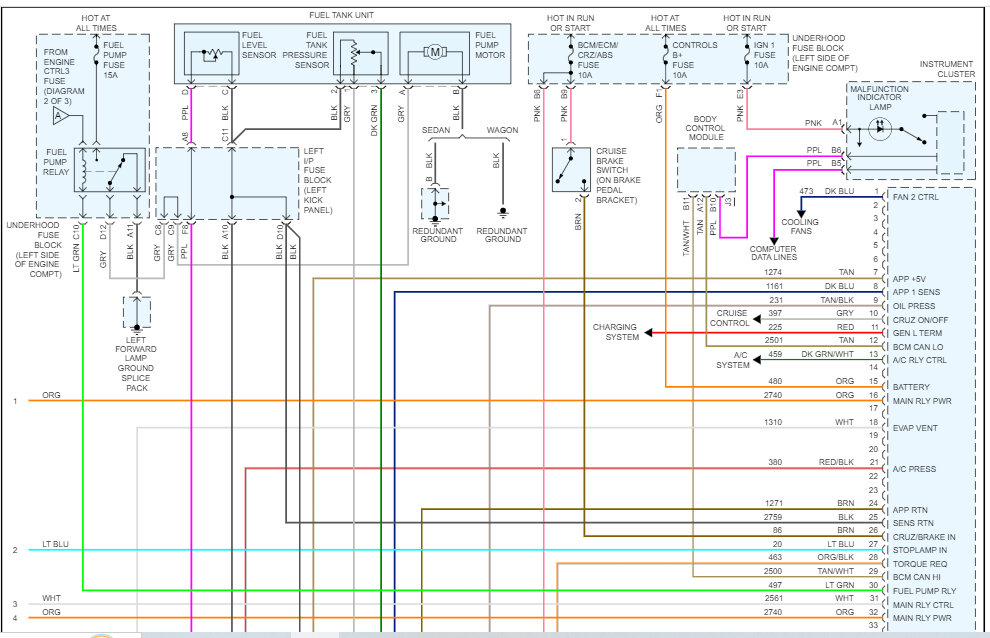

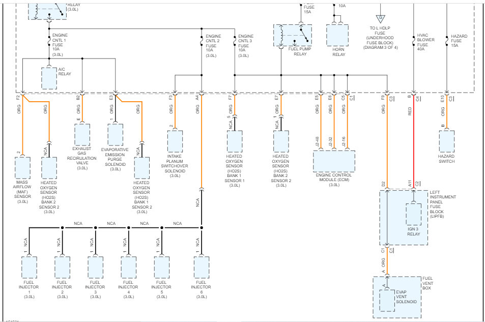

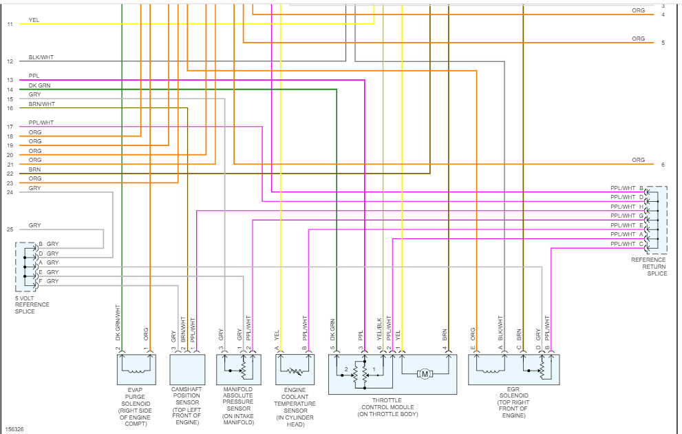

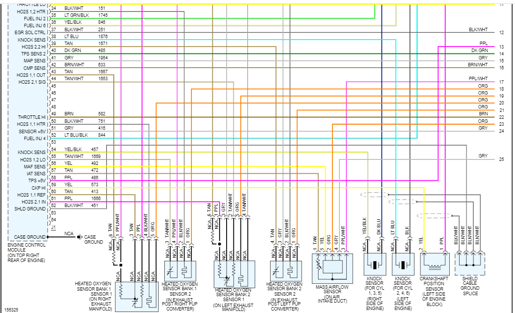

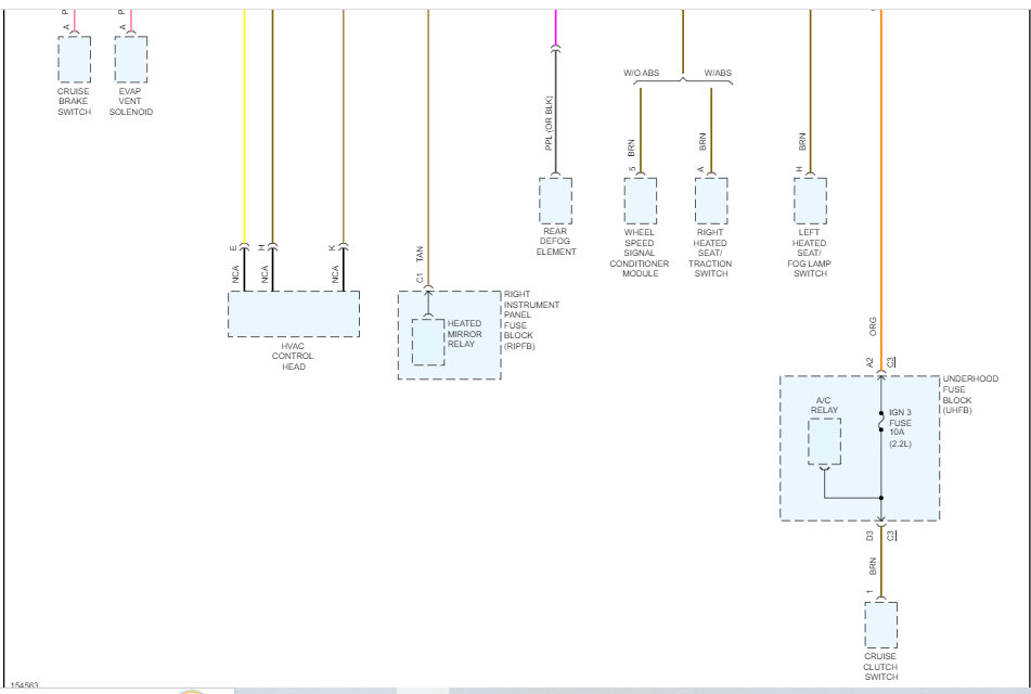

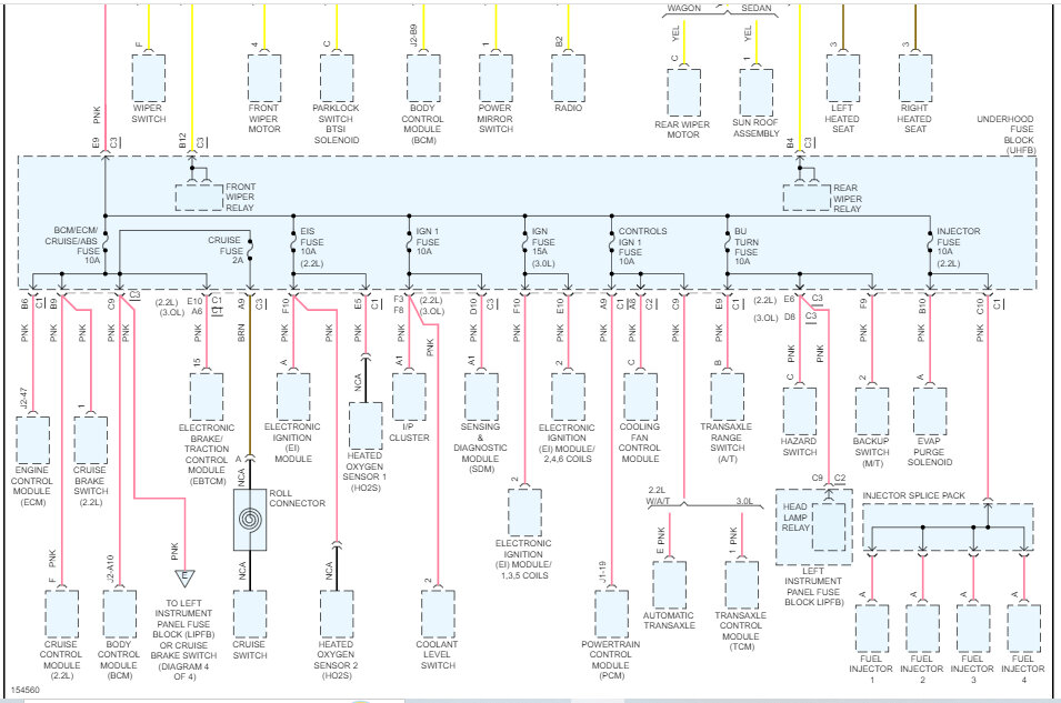

Dec 20, 2022 at 12:29 AM
I don't have a schematic just for the fuse boxes. Would a power distribution schematic help or would you rather have the powertrain management schematics, or both? LOL

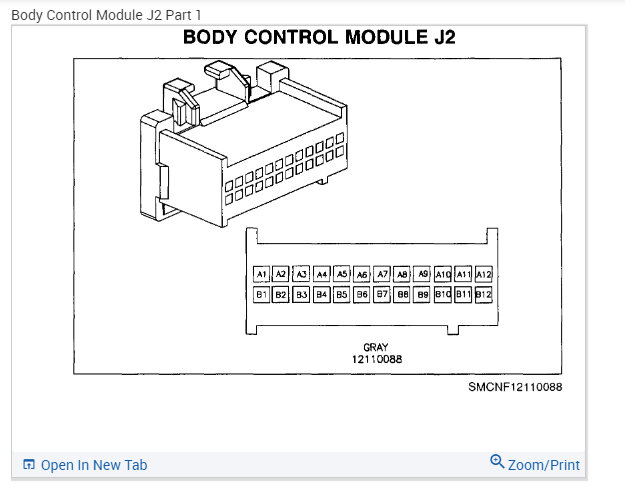

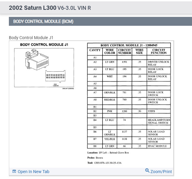

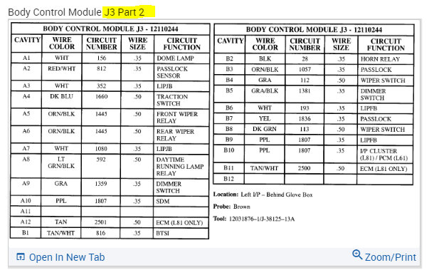

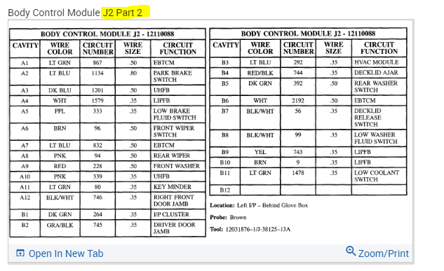

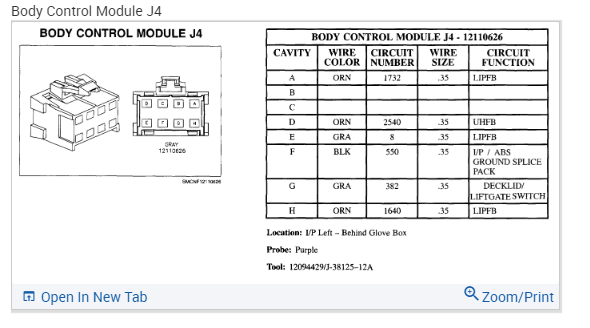

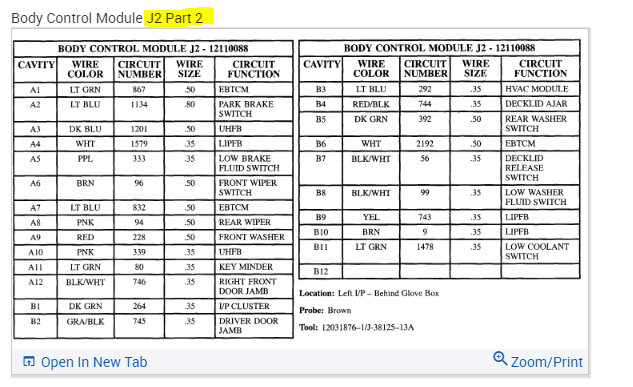

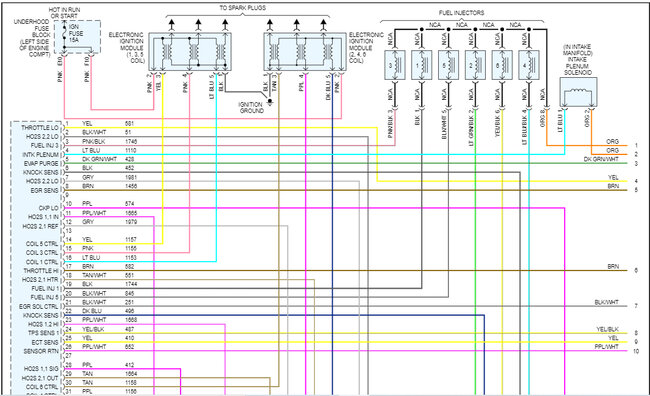

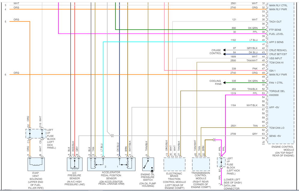

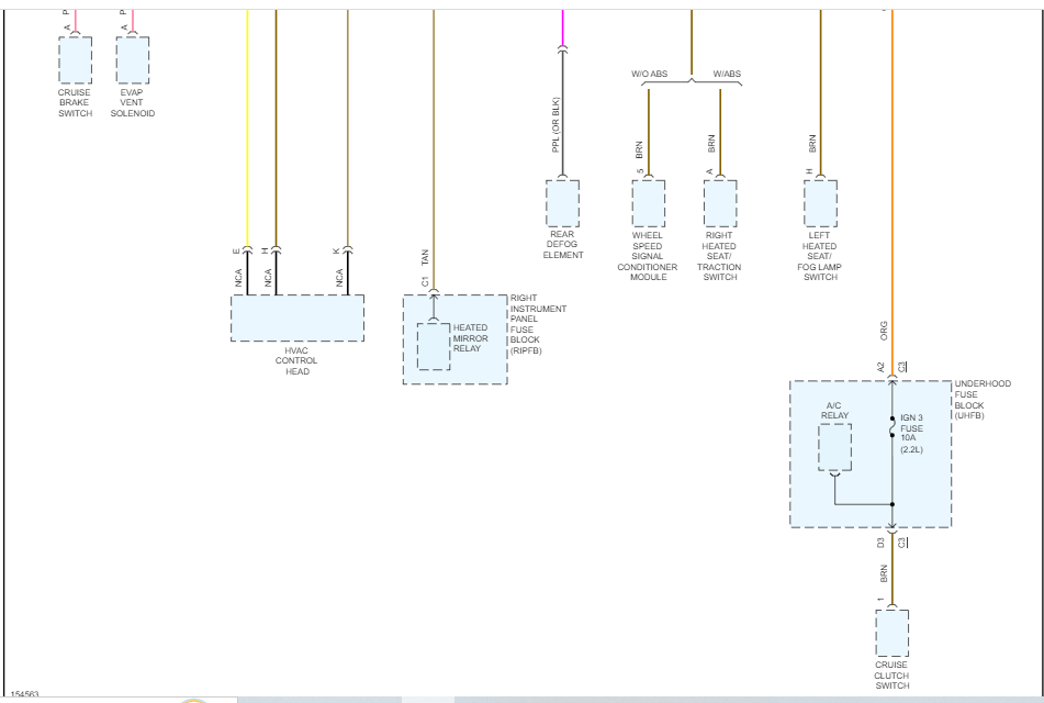

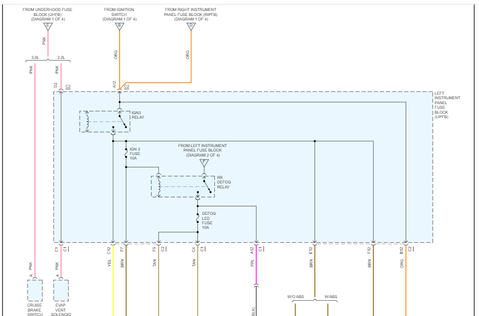

Dec 20, 2022 at 9:04 AM
Looks like I might need both. I want to see what I can learn before I send the BCM back to G7.
Dec 20, 2022 at 11:26 AM

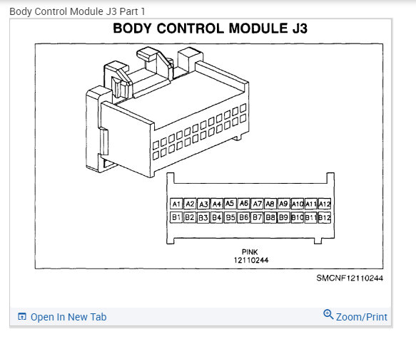

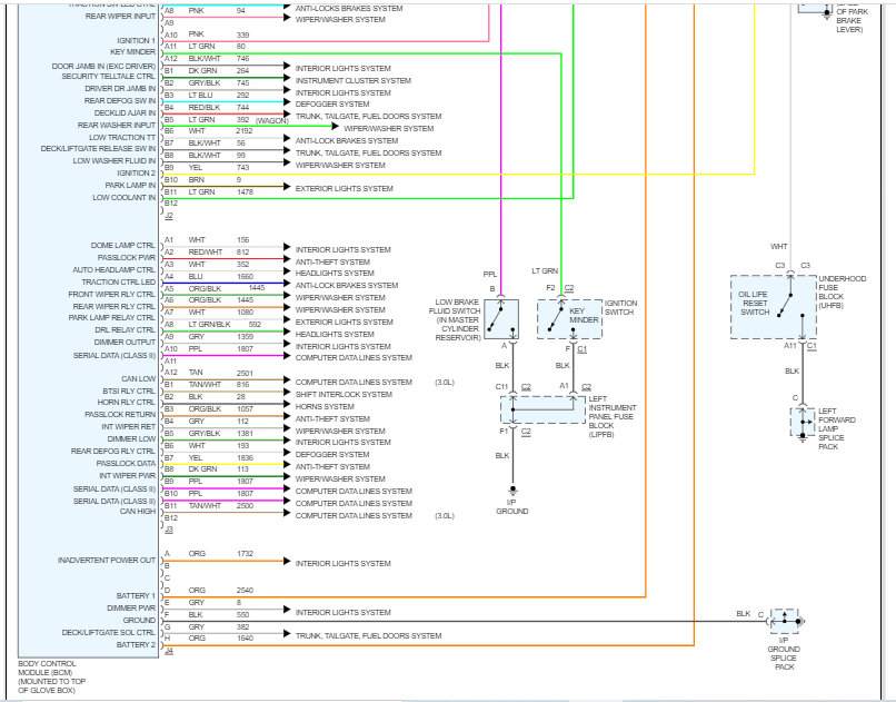

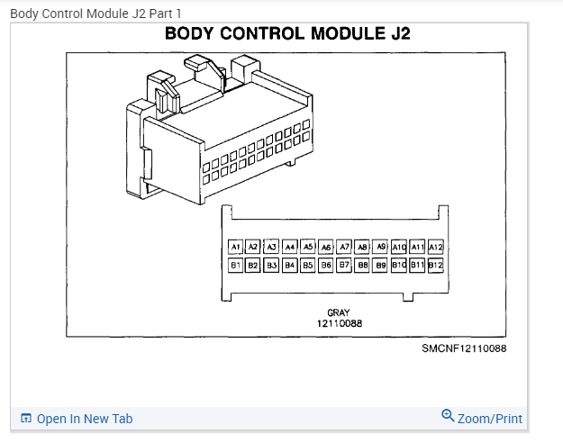

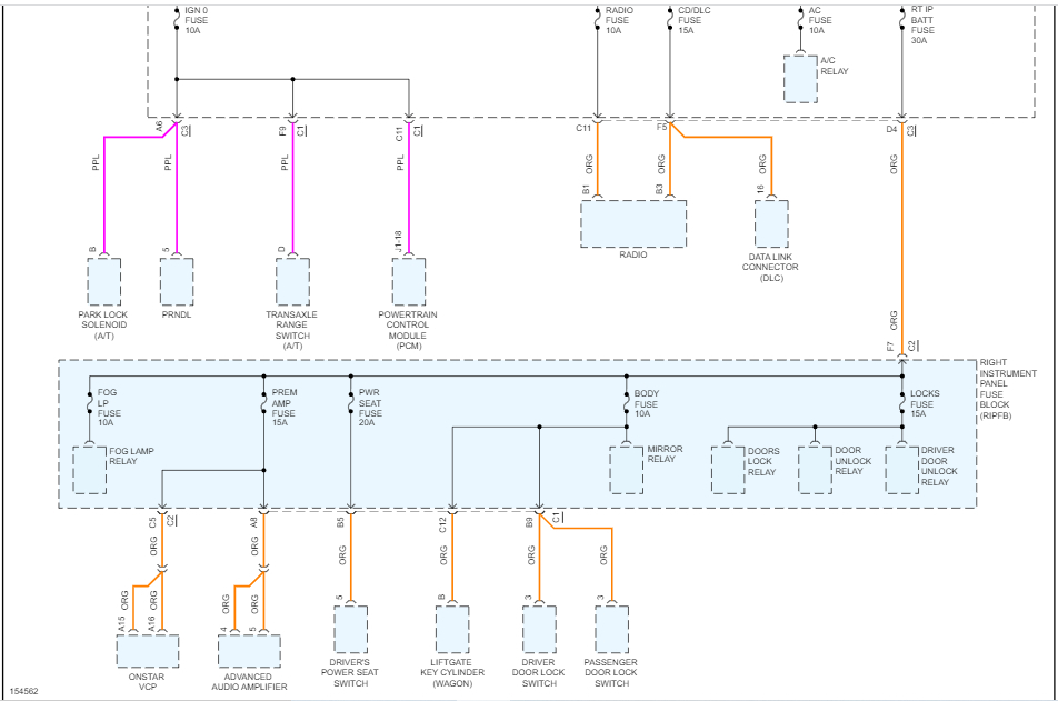

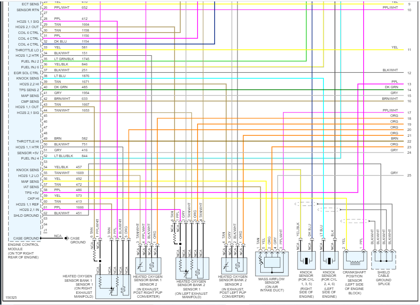

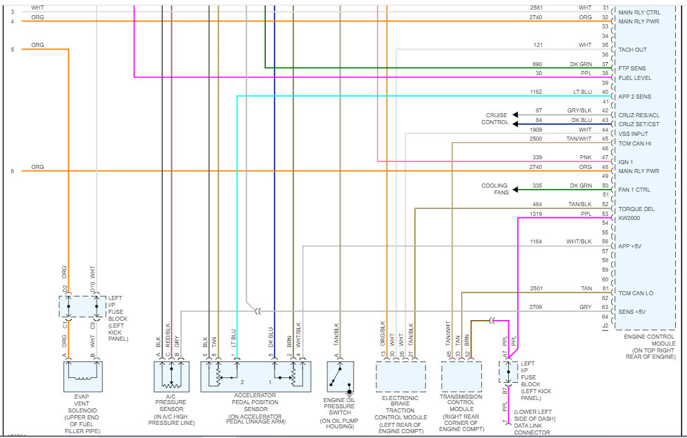

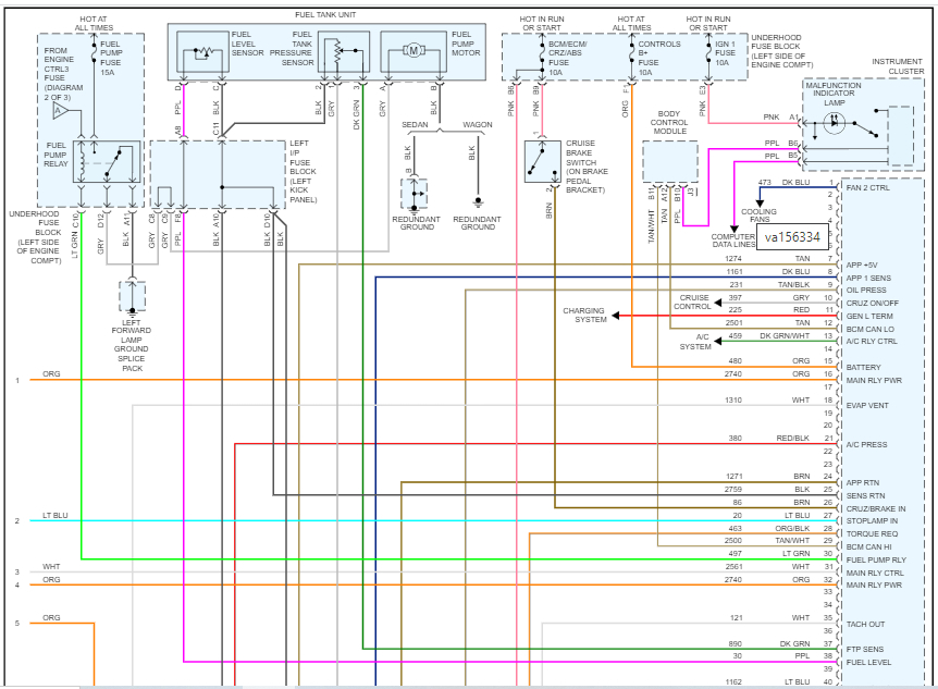

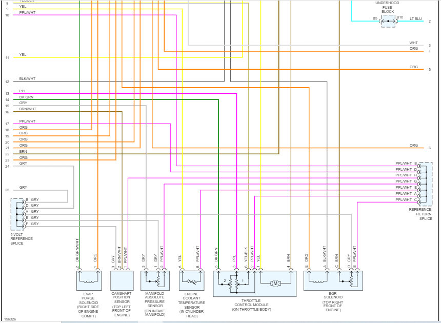

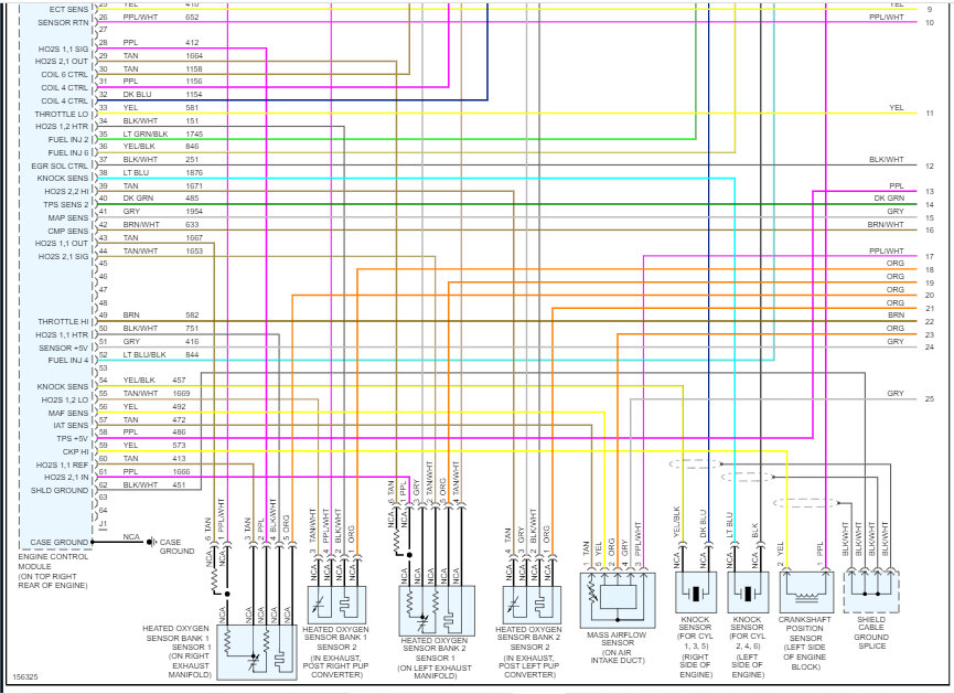

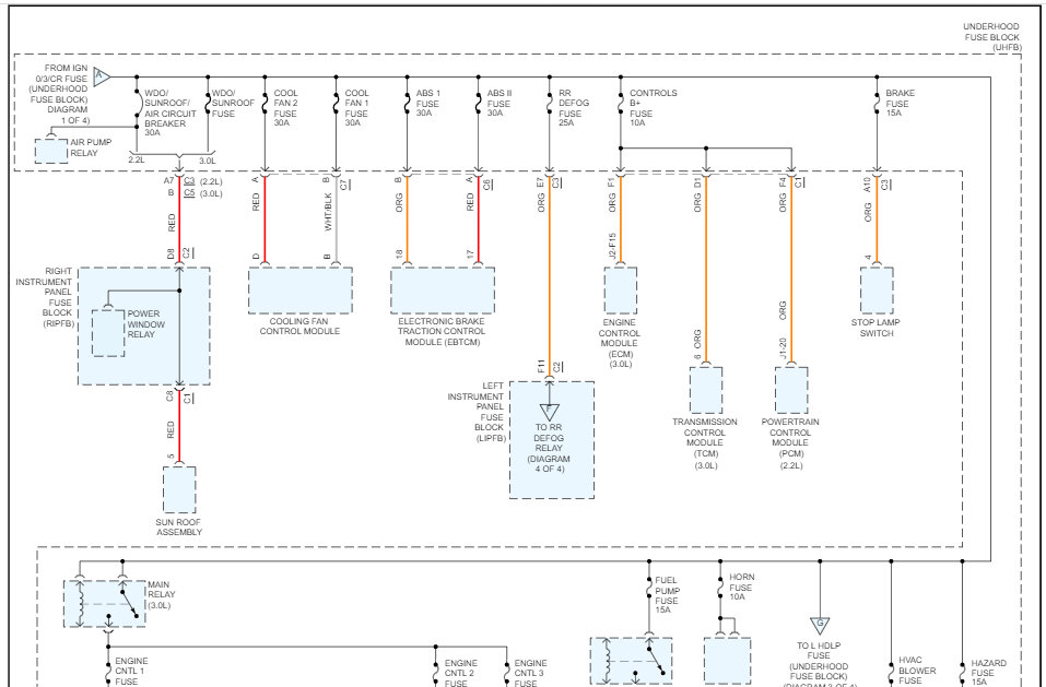

No problem. If you look at the first 8 pics below, they provide the wiring schematic for the power distribution system. Note that there were 4 pages of schematics. I had to cut each in half to make it readable. I did overlap them. So, starting at pic 1, every two pics was one page.

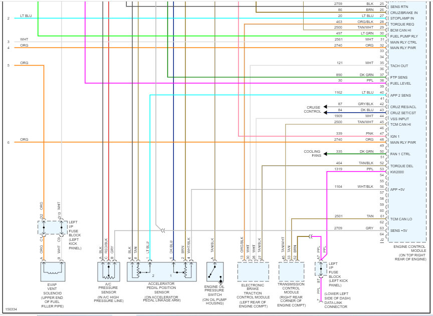

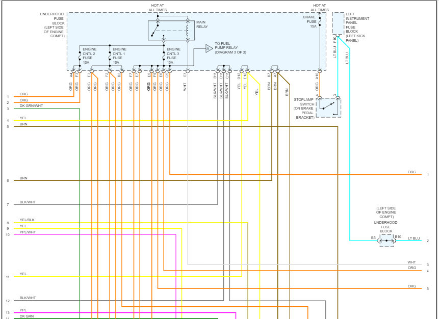

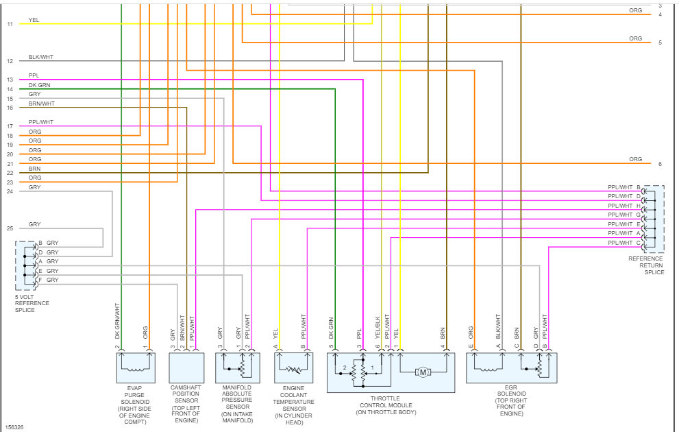

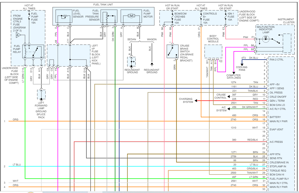

The remaining pics are for the powertrain management circuits. I did the same thing as far as cutting each page in half.
Let me know if this helps or if you have other questions. Note that the power schematics indicate the fuse box, the fuse number, and the wiring colors.

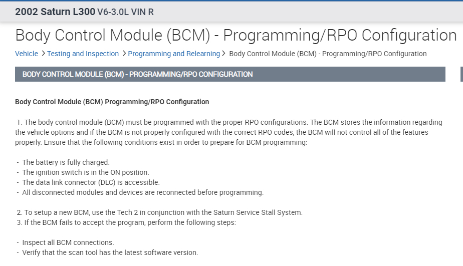

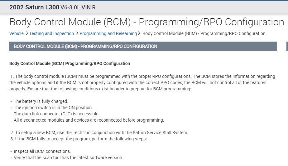

Hi guys, here's the latest: I returned the BCM to G7 on their offer to re-check it, when it was returned, there was no communication included and I still have the same problem. I discovered I can get a new GM replacement from Rock Auto for less than the price of repair, it will however require re-programing. What will I have to do to re-program the new BCM?
Feb 1, 2023 at 1:14 AM

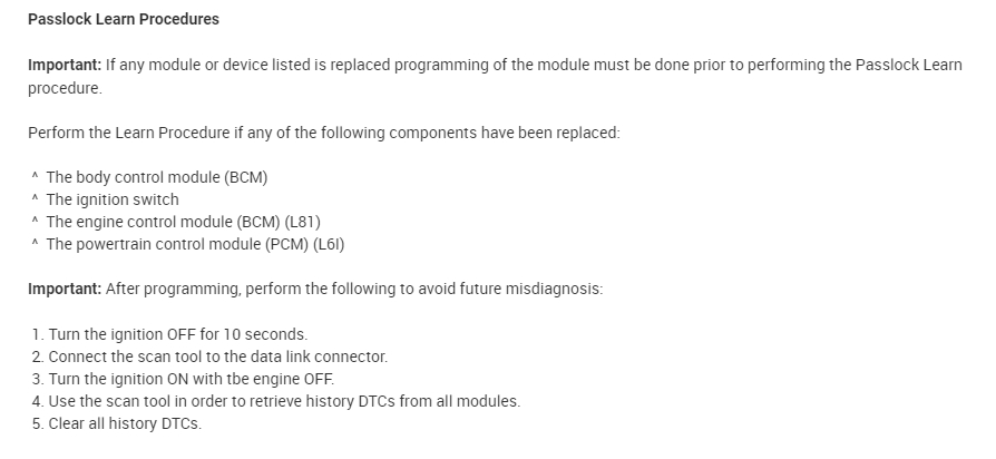

When the BCM is programmed, it will need to be configured using all the correct manufacturer RPO codes (regular production options). This will require a scan tool that can communicate with the BCM and the use of the Saturn Service Stall System (SSS).
This may get difficult finding a place that can do it. I would contact different GM dealerships to see if one has the tools needed.
I attached the directions below.

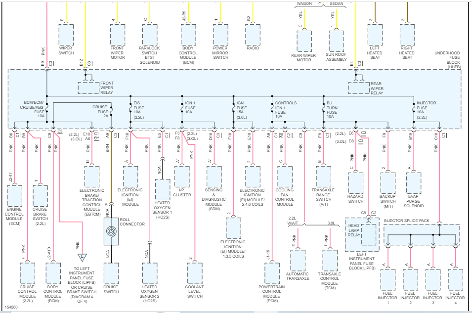

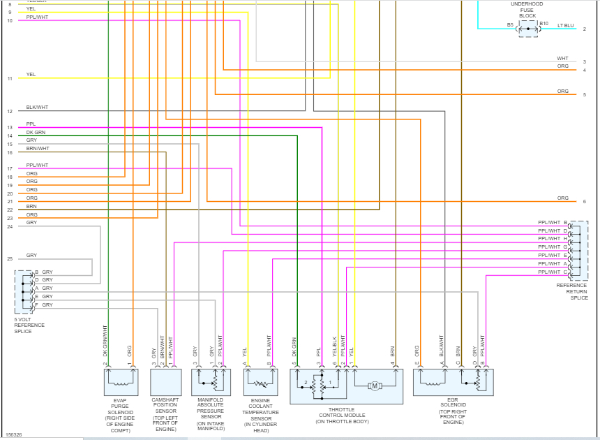

Hi Joe,
I contacted my closest GM dealer and the service manager said they could do the re-programming. He said to bring the car in, and they would diagnose the problem and fix it, only cost me between $300 to $1200, depending on what they found.
Some months ago, I took the Saturn to a non-dealer shop for an estimate to replace the water pump, they said they detected hydrocarbons in the coolant and would need to replace the engine with a used one and had the estimate for repair over $4,000.00. I took the car home and replaced the water pump myself and never had a problem of losing a drop of coolant. While there may have been hydrocarbons in the coolant, it didn't make a bit of difference.

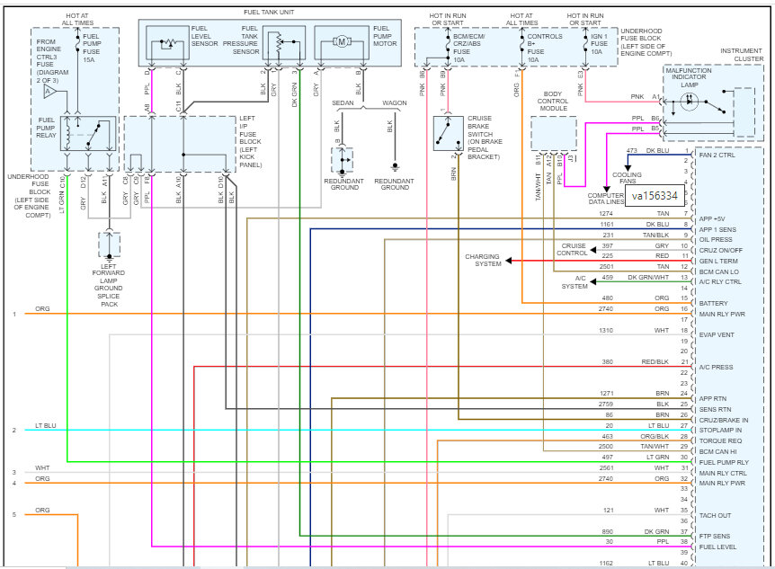

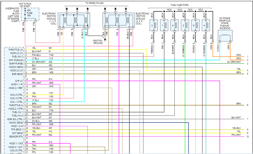

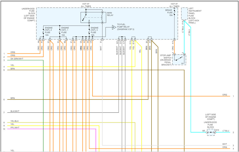

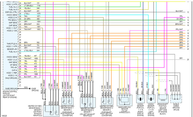

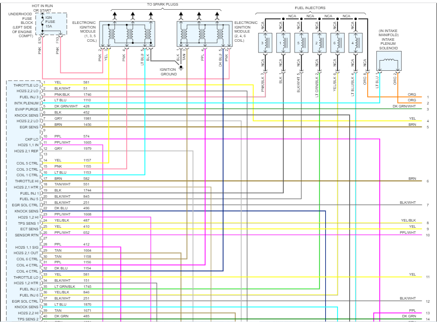

What I'd like to ask is if there are more wiring diagrams that could help me locate what actually powers the ignition. The diagrams you did provide were very helpful, but I haven't been able to find what powers the fuel gauge or ignition. I want to see if I can bypass the fault.
Thanks, Bob
Thanks, Bob
Mar 3, 2023 at 12:56 AM
Bob,
If they were honest and there were hydrocarbons in the coolant, that indicates a head gasket leak.

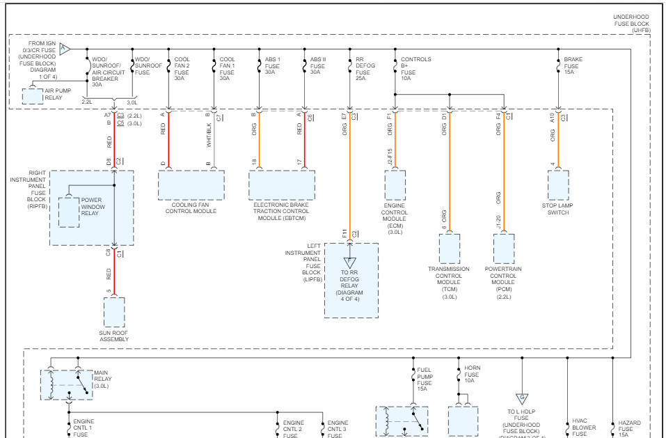

As far as the schematics, I attached the entire powertrain management circuit schematic below.
The schematic includes everything you are looking for. It was a total of three pages long, but I had to cut each one in half to make them readable. I did overlap them.
Let me know if this helps.
