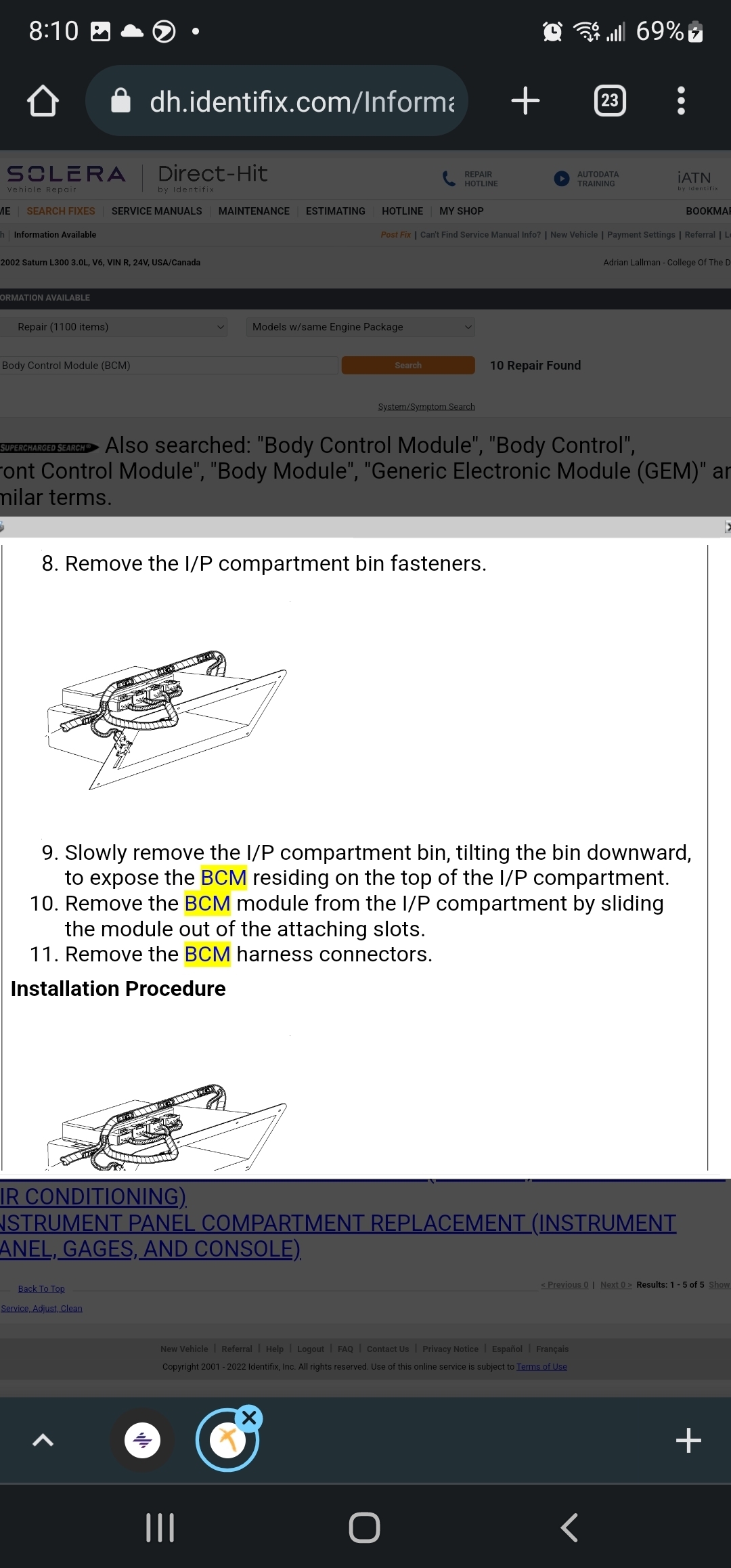

  • 33 POSTS
My BCM was repaired by G7 computers and is in transit to me. G7 emailed me the following note:
"The computer you sent here has been repaired. There was a hardware failure on the board. Usually when the computer fails, so does another part on the vehicle, and if all the damaged parts on the vehicle are not replaced at the same time, then the original problem may still exist, or even cause damage again to the computer and/ or vehicle. Anything electrically related to the symptoms with the vehicle should be checked. It could not be determined if the fault was a result of a short circuit in the vehicle or a manufacturer's defect because the vehicle was not here for inspection."
My next question is going to be: "How do I check for anything that could have caused damage to the BCM?" Hopefully, G7 will include more info with the BCM....

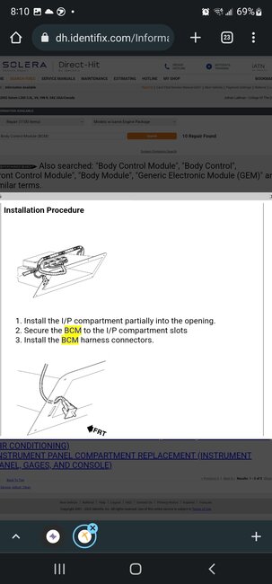

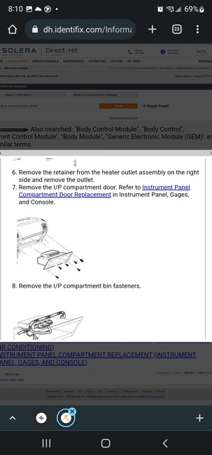

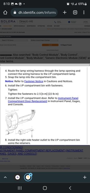

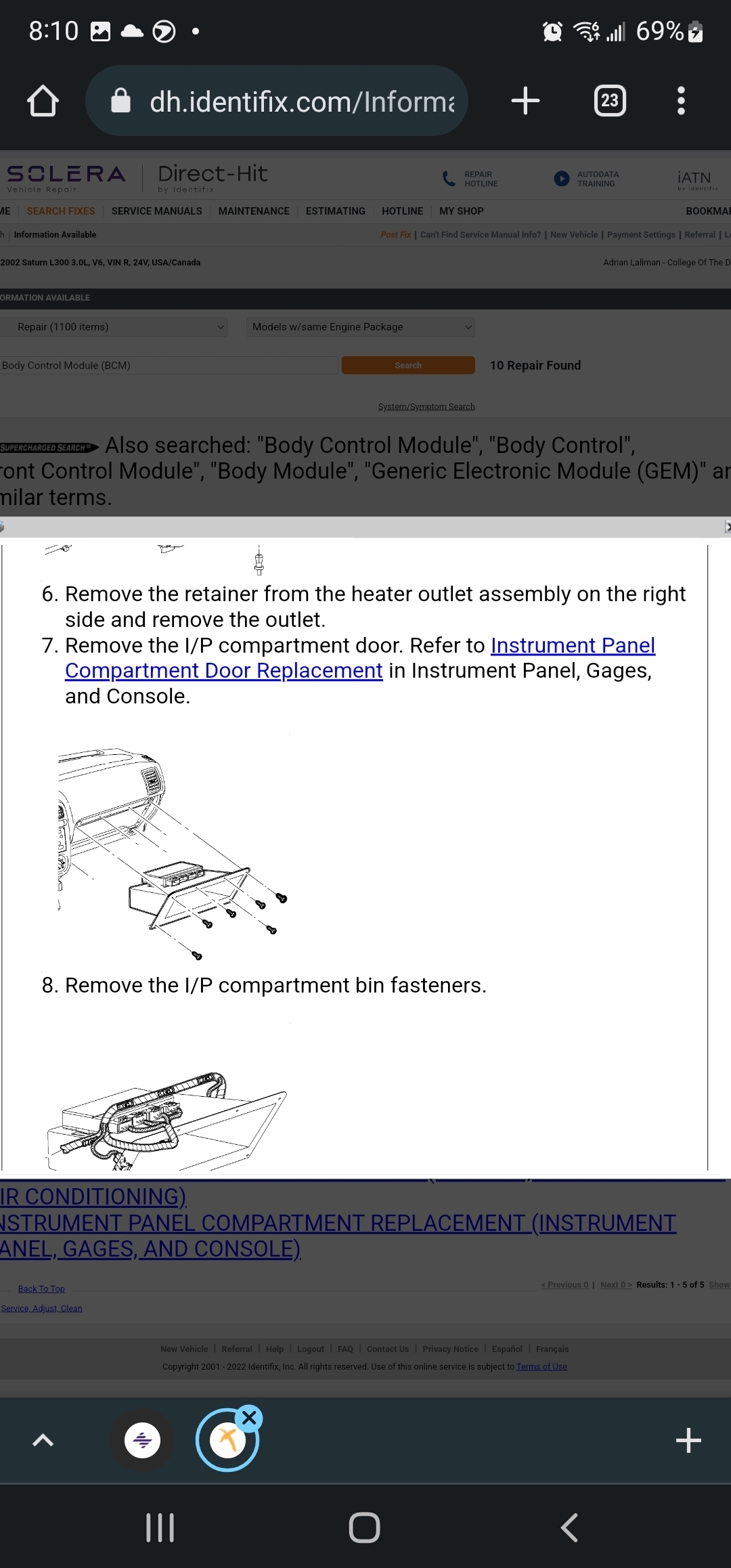

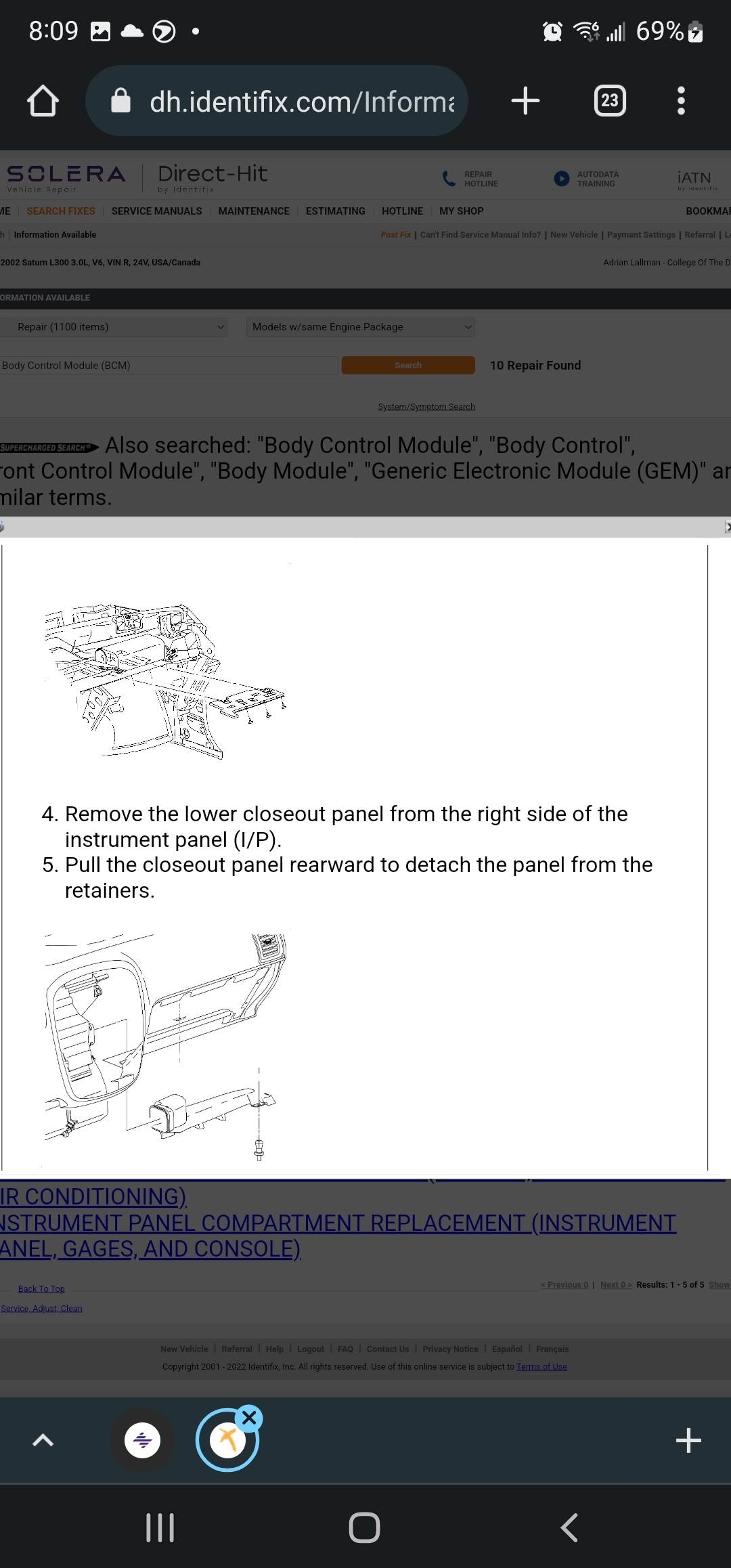

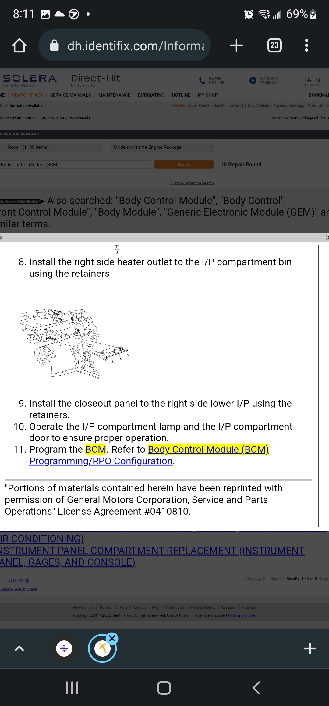

SUBWAT
  • 33 POSTS

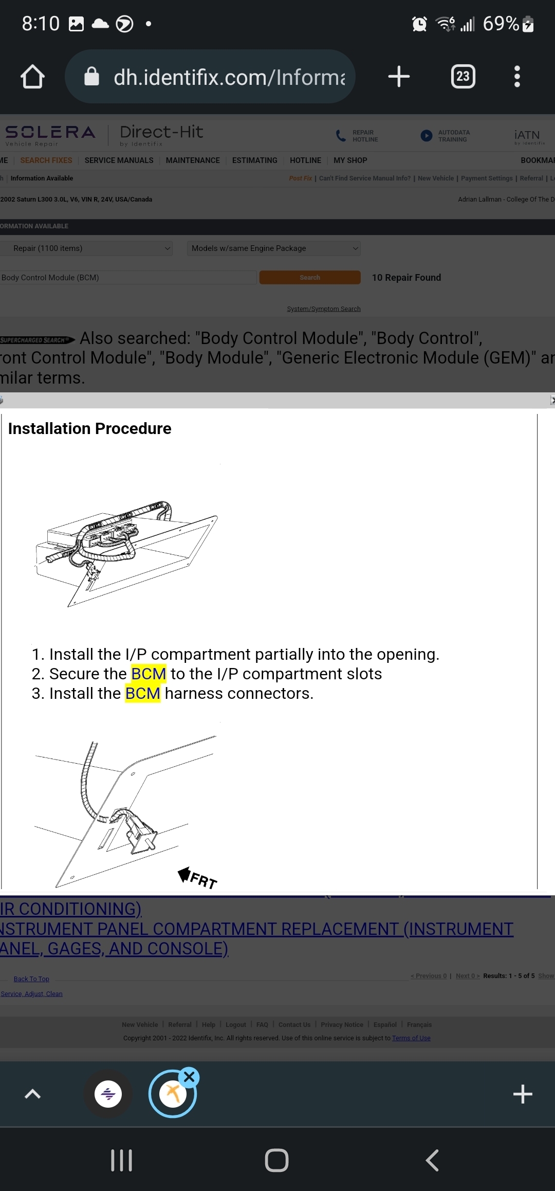

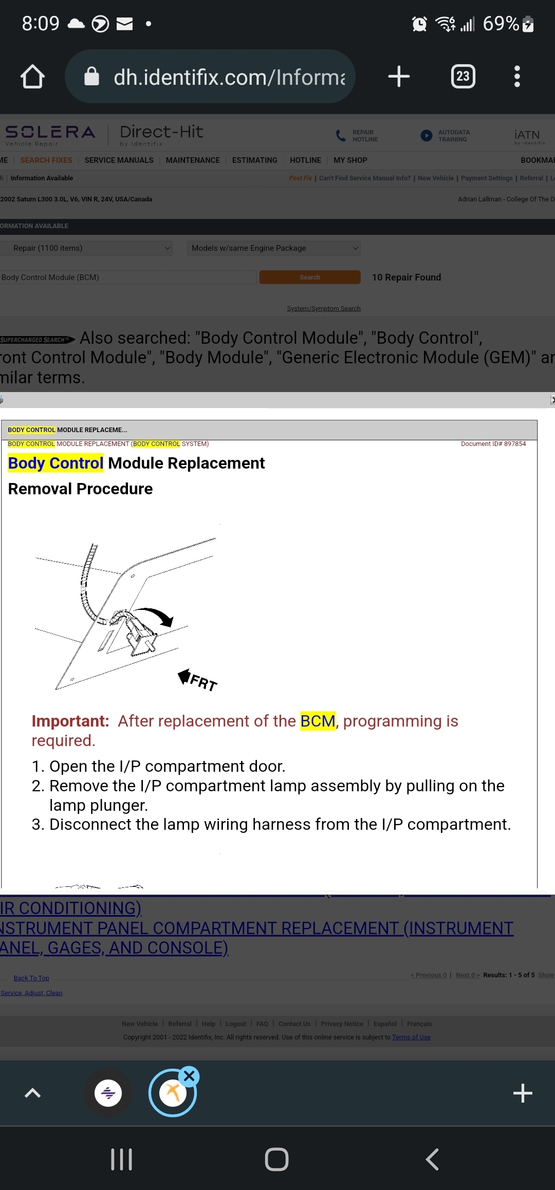

I received the BCM from G7 yesterday evening and today I installed it. Went to start the engine, fuel gauge read properly, and the engine started. I let it idle, then shut it off to load the car for work, when I tried to re-start, the fuel gauge read empty, and the engine would not start. I tried several times -- no start. While there is an outside chance that the BCM was not the problem (since the car was previously most likely to start after sitting overnight) I suspect G7 was right in warning me to look for shorts, etc. that could have caused the BCM to fail. Looks like I damaged the repaired BCM.
Dec 13, 2022 at 10:18 AM
SUBWAT
  • 33 POSTS
At this point I'll have to either find the short(s), re-repair the BCM or junk the car. To find the short I'll need a correct wiring diagram and what values I should test for on the pins of the connectors, any ideas will be much appreciated. I also plan to tell G7 what happened and see if they can make suggestions.
Dec 13, 2022 at 10:25 AM

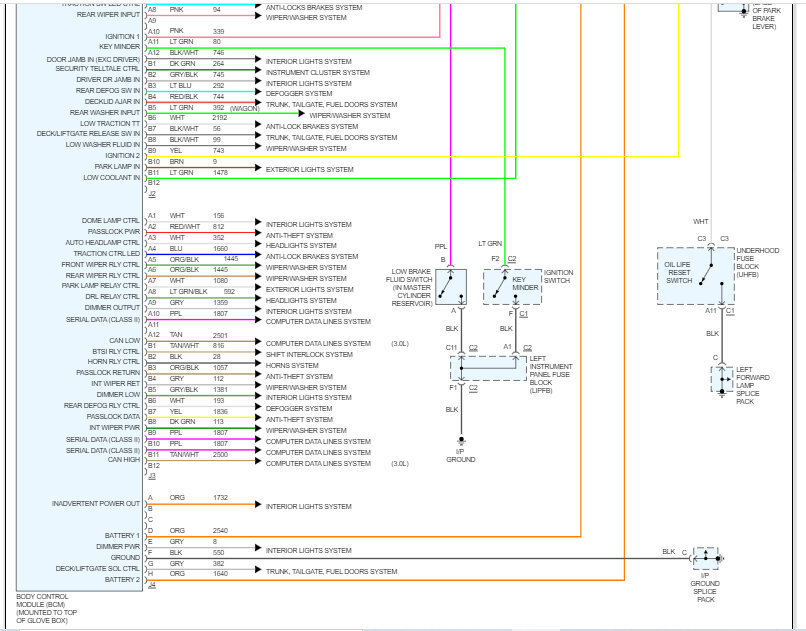

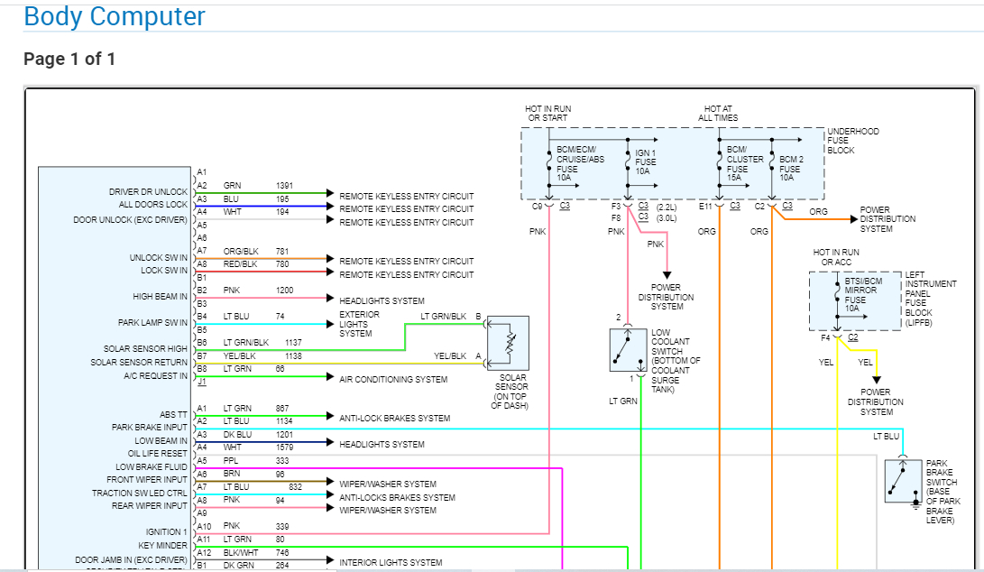

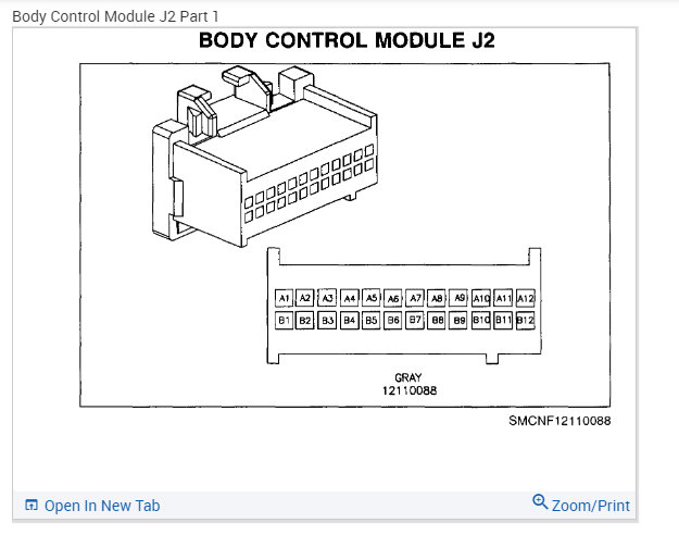

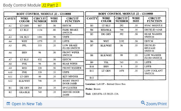

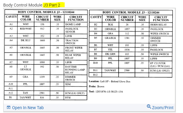

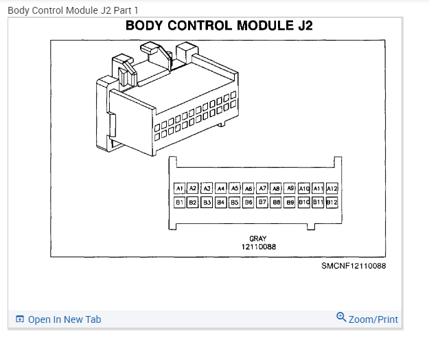

  • 110,248 POSTS

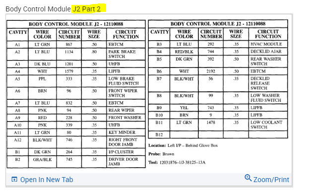

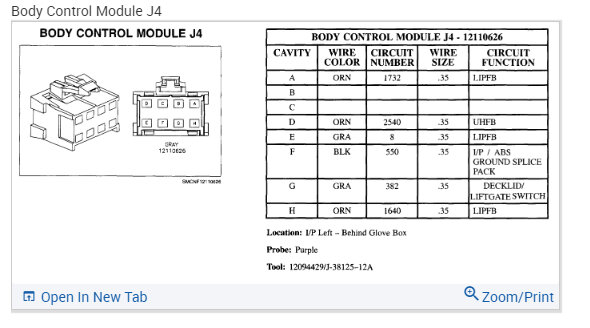

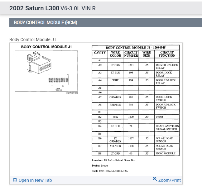

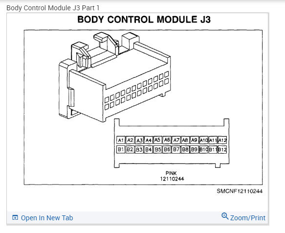

Yep, I understand. What we can try is this. First, I attached the connectors for the BCM pinout below. Next to the pin number, you will find what each wire is for.
Next, I attached the wiring schematic for the BCM. I had to cut it in half to make it readable for you.
Let's try it this way. Let me know the wires/connectors/pins in which you have an interest. I will try to determine what you should find at those wires.
I wish I had an easier answer. I understand what you are asking for, I've never seen one in a manual. There is always a focus on one or more specific circuits that are checked. They don't have a schematic covering all wires and their values. It would be a good idea, but that has never shown up in my manuals.
Let me know your thoughts. Let me know if you feel this will help.
Dec 17, 2022 at 2:07 PM
SUBWAT
  • 33 POSTS
Hi Joe,
You guys are incredibly helpful and much appreciated! I will get to this and report back asap. I have looked over the pics, but nothing is obvious related to my problem. I plan to check with G7 next to see if they can shed some light on this (such as what component(s) they fixed and any suggestions they might have. BTW, I hope you got paid a commission for referring me to G7, you deserve it.
