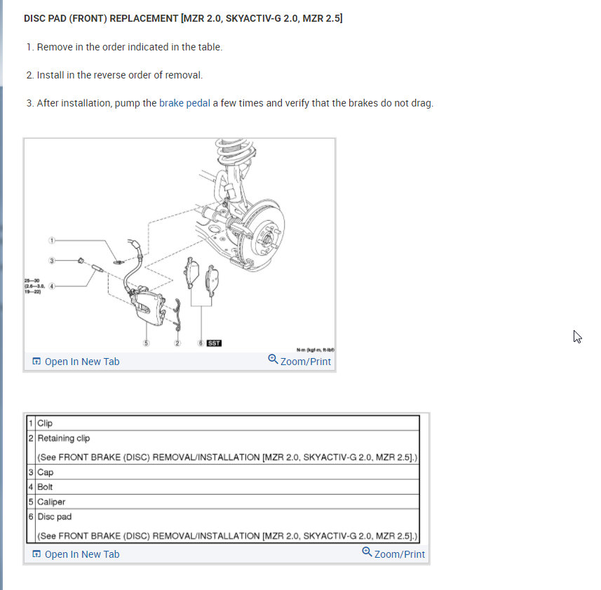

The brake is soft when I step on the pedal. There is no leaking fluid. The pedal does not sink all the way, but quite a bit. My wife's car brake became soft about a year ago after the car was sliding down the driveway when it was snowing and the anti-lock brakes came on. It was not as bad then as it have been in the past few months. Thanks in advance.

Sounds like you either have an issue in the master cylinder or the pads are just worn.
Here is a guide that will help with this:
https://www.2carpros.com/articles/brake-pedal-goes-to-the-floor
Also, here is a guide that will help with replacing the pads and rotors as this is where I would start: This video shows the job being done on a similar car but the process is the same.
https://youtu.be/UnYZUNnG8mw
and
Below is the process from the manual on how to replace these as well.
Please run through this material and let us know if you have other questions. Thanks
