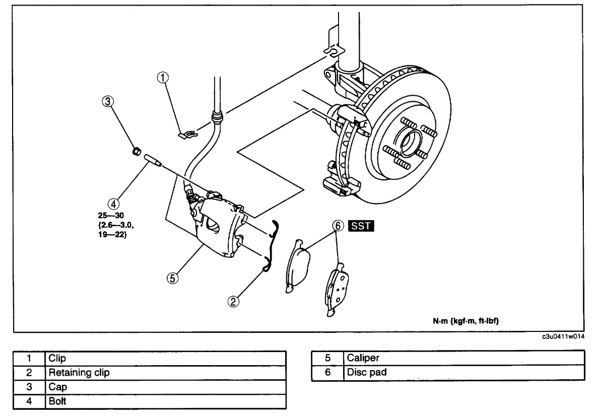

Can you tell me the torque specs for the front caliper bolts and the caliper bridge bolts for the 2007 Mazda 3i? So far,my web search is drawing a blank. Also, can you recommend a good DYI repair manual for this model? Haynes does have one and I haven't found a Chilton's one for sale, either. Mazda Owner in Atlanta.

Here is a guide that will walk you through the steps and a diagrams below to help you with the job on your car. The bolts are 25 to 30 foot pounds
Minimum front disc pad thickness .................... 2.0 mm (0.079 in) min.
