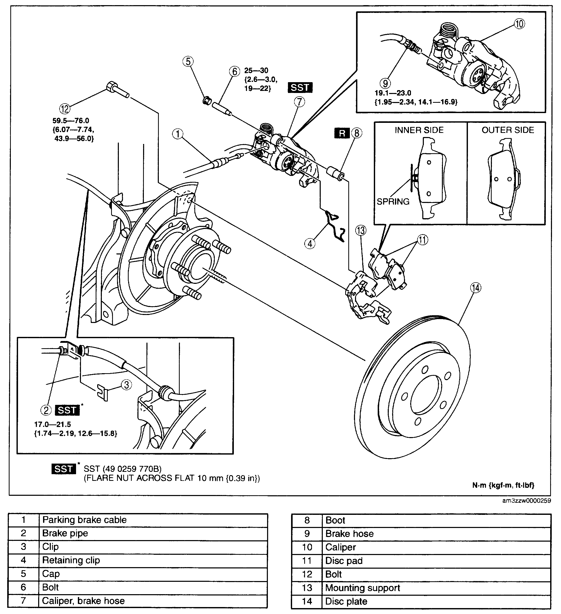

Was on the motorway yesterday and the car would make noise from the rear I think I need brakes?

Replacing rear brakes isn't too hard to do. You can expect to get approximately 25,000 miles from a set of pads, but that is based on the driver.
First, here is a link that shows how to replace brakes and rotors in general. You can use this as a guide.
https://www.2carpros.com/articles/how-to-replace-rear-brake-pads-and-rotors
_________________________________
Here are the directions specific to your vehicle. The attached pics correlate with the directions.
2007 Mazda 3 L4-2.3L
Rear
Vehicle Brakes and Traction Control Disc Brake System Brake Pad Service and Repair Removal and Replacement Rear
REAR
DISC PAD (REAR) REPLACEMENT
1. Remove in the order indicated in the table.
2. Install in the reverse order of removal.
3. After installation, pump the brake pedal a few times and inspect the following:
- Parking brake lever stroke
- Brake drag
pic 1

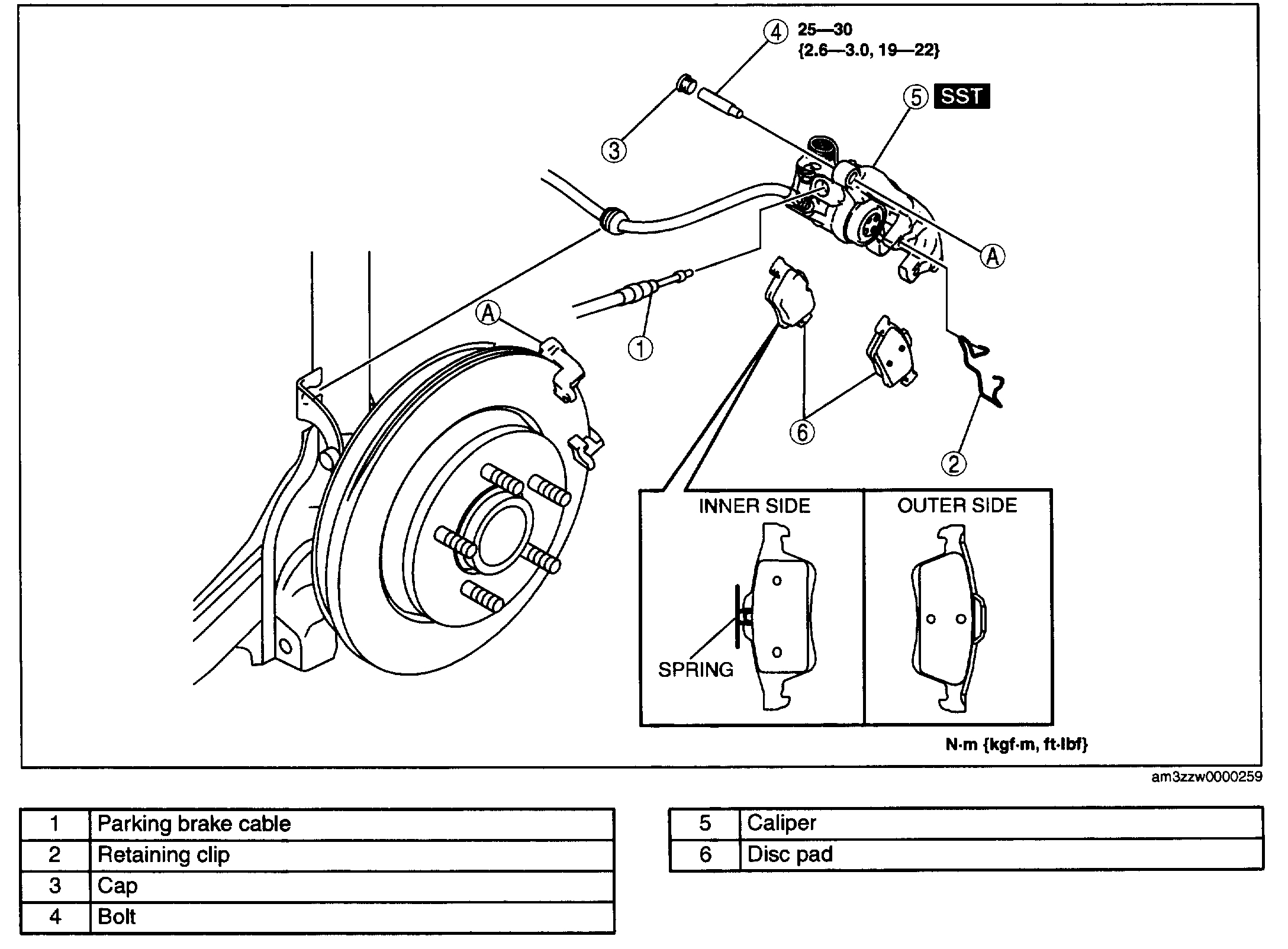

______________________________________________
Brake Rotor Replacement
Rear
Vehicle Brakes and Traction Control Disc Brake System Brake Rotor/Disc Service and Repair Removal and Replacement Rear
REAR
REAR BRAKE (DISC) REMOVAL/INSTALLATION
- Brake drag
Pic 2
