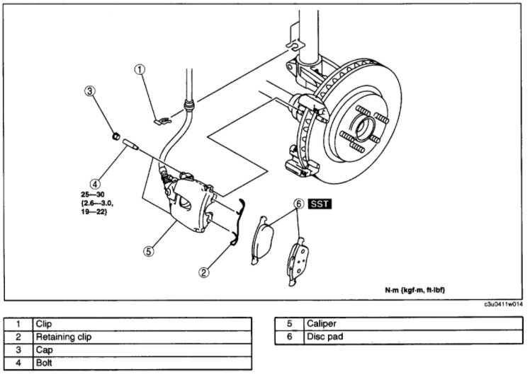

Replacing brakes isn't too hard to do. First, here is a link that explains in general how it's done. You can use these as a guide:
Here are the directions specific to your vehicle. The attached pics correlate with the directions.
_________________________________________________________

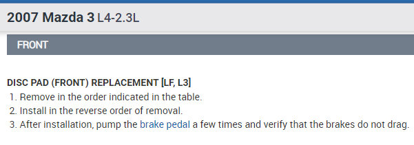

2007 Mazda 3 L4-2.0L
Front
Vehicle Brakes and Traction Control Disc Brake System Brake Pad Service and Repair Removal and Replacement Front
FRONT
DISC PAD (FRONT) REPLACEMENT [LF, L3]
1. Remove in the order indicated in the table.
2. Install in the reverse order of removal.
3. After installation, pump the brake pedal a few times and verify that the brakes do not drag.
See pic 1

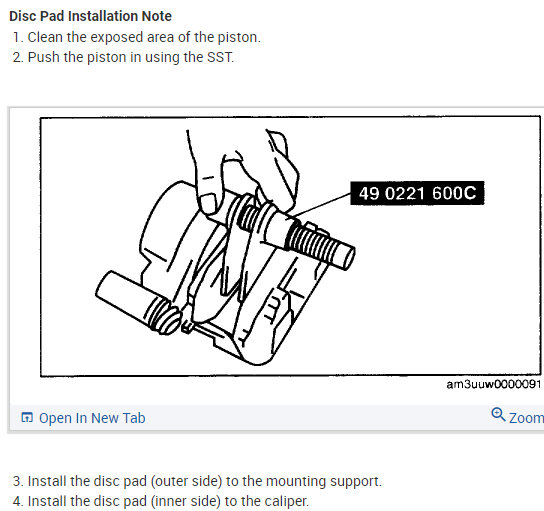

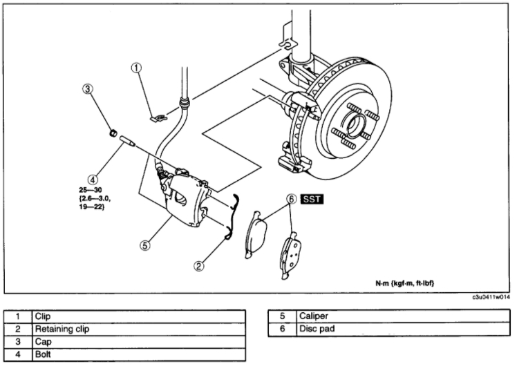

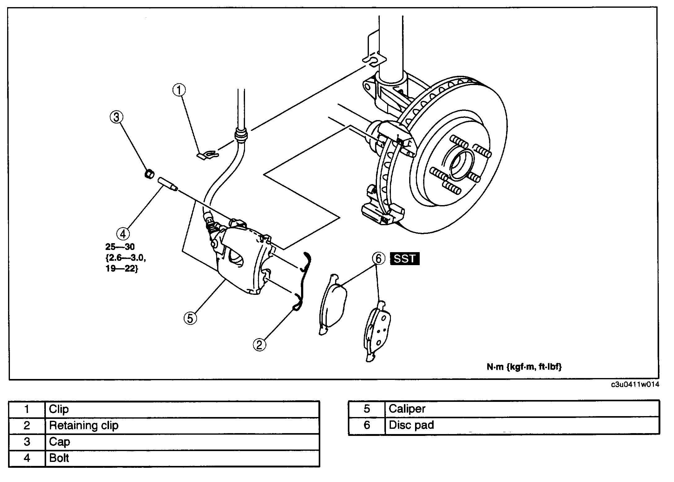

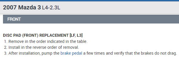

Hello, I'm Danny.
To answer your question. yes, you always perform brake repairs and brake pad changes as a pair. It's not good to do repairs singularly to promote even wear. Here is a tutorial for you to view on how to change front brake pads and rotors:
I've attached picture steps below on how to change the front brake pads and rotors on your car. Hope this helps and thanks for using 2CarPros.
