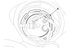

After the car has sat idle for several hours, it becomes hard to start. When you turn the key the cranking is not slowed down and the battery has tested good. I was told to let the car sit for a while and then on the next start attempt to turn the key forward to the aux position, wait 3 seconds and then back to off, turn forward to the aux position, wait 3 second, then back to off, then to try cranking it. It started on the first crank. I was told this indicated an issue with either the fuel filter or fuel pump. I am unsure where either are on this vehicle and how easy/difficult they might be to change?
Dec 9, 2019 at 12:06 PM
JONNYB1963
  • 263 POSTS

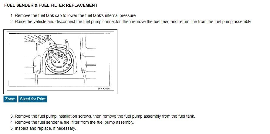

Both are located in the fuel tank. And If I'm not mistaken they are sold together.
You will need a special tool for removing the locking ring that holds the pump into the tank.(see link below)
and
https://www.2carpros.com/articles/how-to-change-a-fuel-filter
What you need to do release the fuel pressure in the system before proceeding. To do this make sure the car is off, then on top of the engine where the fuel injector rail is, you will find a small valve stem that looks much like a bicycle valve stem. remove the cap and depress the center of that valve slowly to release the pressure.

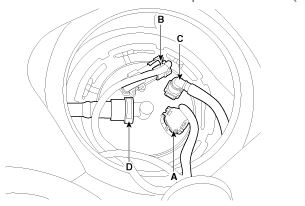

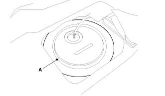

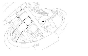

Afterwards follow this procedure to replace the fuel pump and filter assembly:
1. Take out the back seat of the vehicle.
2. Look for a removable cover in the floor pan of the car.
3. Remove that cover. (under it you will see the top of the fuel pump.
4. Disconnect the electrical connector
5. disconnect all the lines (vapor and fuel line)
6. Using the special tool rotate the retaining ring 1/8th of a turn and it will pop off.
7. Remove the pump
8. Install the new pump in the reverse order.
Regards,
Jon
Dec 9, 2019 at 12:34 PM
STEVE W.
  • 15,200 POSTS
Okay, to clarify this in my head. You turn the key and the engine turns over just fine but does not star if the car has sat a while. However if you turn the key on and off a few times it will then start on the first try, correct?
If so that means that there is likely an issue with either the in tank fuel pump or the regulator. What is happening is that when the car is setting the fuel pressure in the system bleeds down far enough that the normal 2 second fuel pump prime isn't enough to restore full pressure up to the high pressure pump.
There are a few causes for that, a bad pressure regulator or the return check valve in the pump has failed or stuck open being the common ones. However on your engine it could also be caused by leakage in the high pressure pump on the engine. There is a recall for the high pressure line leaking fuel that came out in March. (#19-01-001H)
The first thing I would do is connect a pressure gauge to the line coming into the high pressure pump. For that you need a special adapter shown in the first pic. With it connected you turn the key on off a few times and then start the engine. You want to see between 70 and 75 psi with the engine running. Low pressure shows a leak or plugged filter. High pressure is a bad regulator. Now shut the engine off while watching the pressure. It should hold the pressure it shows for at least 5 minutes, longer is better. If the pressure drops off very slowly you have a bad injector or a small leak. If it drops off almost instantly there is a fault in the main pump or regulator.
The main fuel pump is in the tank with the pressure regulator. To get to it you need to remove the rearward most seat assembly first. Then you will see an access panel. That gets removed and under it are the fuel lines and connections. Remove the connectors and then the ring and the pump lifts out. Be sure you have something to set it into and don't tip it when you remove it, otherwise you will spill gas inside the vehicle.
I would however see if this would be covered under the power-train warranty if you bought it new.

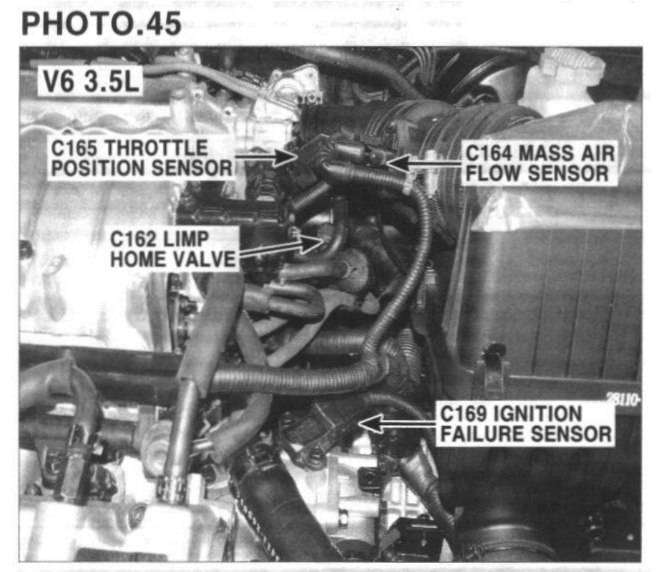

So my vehicle is starting to become very temperamental so here’s the facts if anyone can help point me in the right direction:
• Starts first time every time when cold or when it’s left to cool down for approximately 30 minutes.
•Cold or warm it’s idle randomly jumps from 800 rpm's to anywhere up to 1,800 rpm's and will drop back down again at any time.
•After starting and driving for maybe 10 minutes, once the engine is warm, if you stop the engine and run into a shop for 5 minutes and come out again it will turn over and over without igniting.
•When it’s turning over like this, if you pump the throttle pedal it will slowing shudder and ignite after maybe 10-15 seconds of trying.
•Or alternatively if you put the key in and turn on the ignition and wait until the airbag light goes off (almost like glowing a diesel) it will ignite right away like normal (only twice has this not worked and we just had to wait until it cooled down).
•Even when driving the RPM's will rise so as it’s automatic, if you’re at traffic lights or a junction it can just jump in revs and the car will jerk forward so you have to keep your foot firmly on the brakes or if your coasting down a hill off the throttle completely it will still cruise at the higher RPM's so you have to use the brakes again to slow down, but again this just happens randomly without any warning.

This sounds like a common problem due to a dirty throttle bore. here is a guide to help you fix the problem we should run the codes as well:

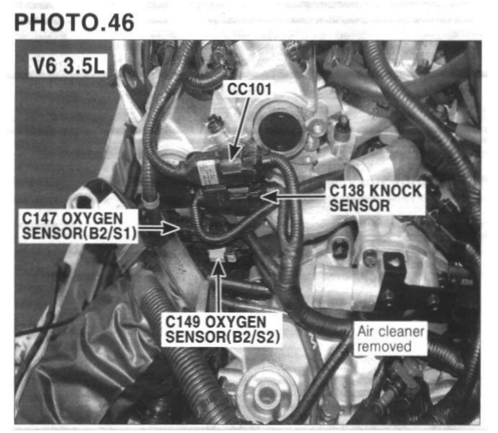

JONNY-63

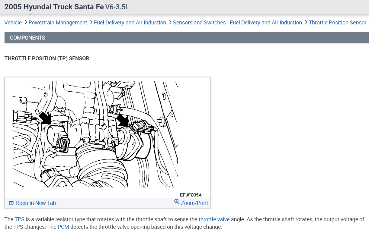

I got the codes checked and they are:
•P0122 - Throttle position sensor/ Throttle pedal position - Low Input
•P0123 - Throttle position sensor/ Throttle pedal position - High Input
•P0130 - Heated oxygen sensor 1, Bank 1 - Circuit Malfunction.
I haven’t had a chance to clean the throttle bore yet but the mechanic said to start with replacing the TPS and another sensor that are on the throttle body first to rule them out but I’d rather rule out cheaper solutions first like this.
The car has gradually got worse, now it won’t start at all when hot and idle is jumping from 700 rpm's to over 3,000 rpm's sporadically without touching the throttle pedal. it’s also starting to stall when put into Drive or Reverse gears when the revs drop.
When unplugging either sensor on the throttle body it will stop certain symptoms like the stalling or high revs but will create new symptoms.
Jan 4, 2021 at 1:54 PM (Merged)
  • 54,840 POSTS
I would replace the TPS sensor and clean throttle bore first and replace the oxygen sensor. here is a guide to help walk you through the steps and the sensor locations below:

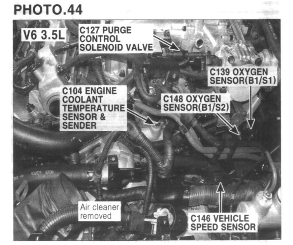

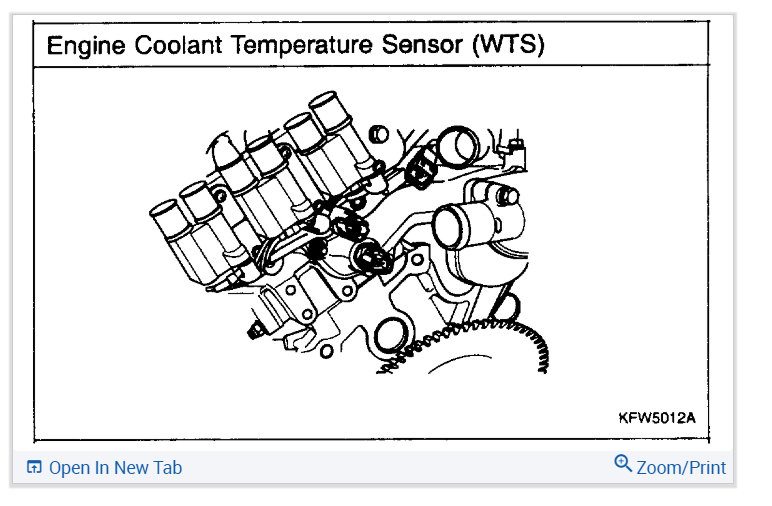

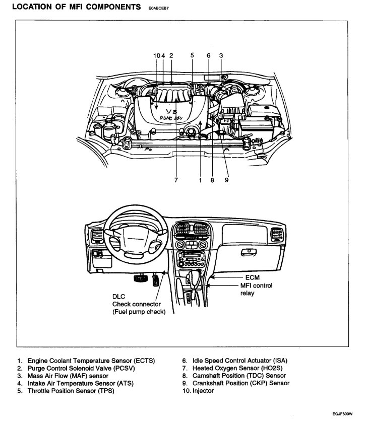

I have seen the engine coolant temperature sensor cause this issue. Here is the location so you can change it out. Check out the diagrams (below). Please let us know what happens.
JONNY-63
So the mechanic done a great job and sorted the car for us. Reading what the coolant temperature sensor was doing he found it was jumping from around 70degree to -20degrees which was why the revs were rising so a coolant temperature sensor fixed that. It still had the hot start problem which he finally traced back to the air temperature sensor in the intake manifold. Turns out whoever was the last person to take the manifold off, plugged two plugs in the wrong way around! The plug for the temperature sensor and the plug for the purge valve in the throttle bore are beside each other at the back of the manifold and both are the same fittings so after switching plugs and getting a new air temp sensor (as it runs off 5v and it was getting a 12v feed off the other plug it fried the sensor) the car is running great! Hope the thread helps someone in the future!
