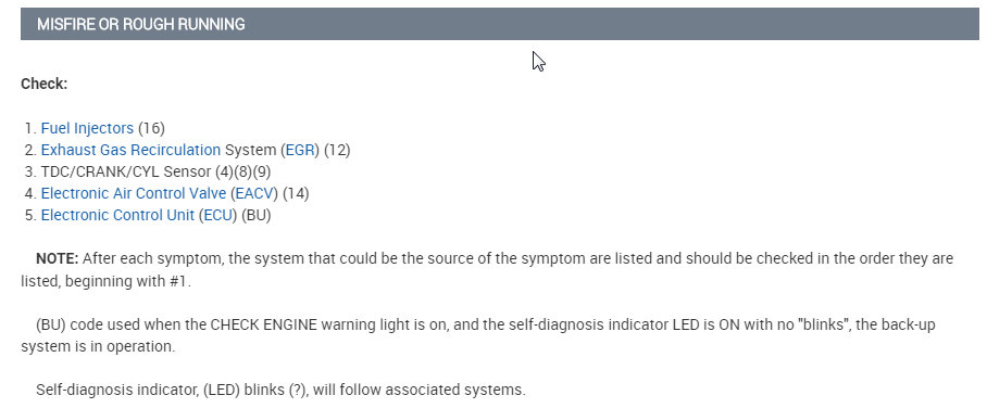

Sorry. You are correct. I am just used to dealing with OBDII vehicles. At this point lets assume the spark is ok but we may need to come back to it and check for weak/inconsistent spark.
Let's check and make sure the fuel pump is not loosing pressure after it warms up. This is much easier and less intrusive then digging into the ignition. Clearly if the fuel pump checks out then we can move on. If not, it is good when didn't go into ignition first. Hook up a fuel pressure gauge and just tape it to the windshield so you can see what it is doing when this is misfiring.
If fuel checks out then we can get into ignition. This is the idea of what we are going to need to look at. This is not exactly your issue but we need to verify a good consistent spark.

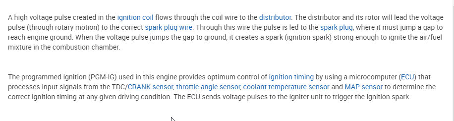

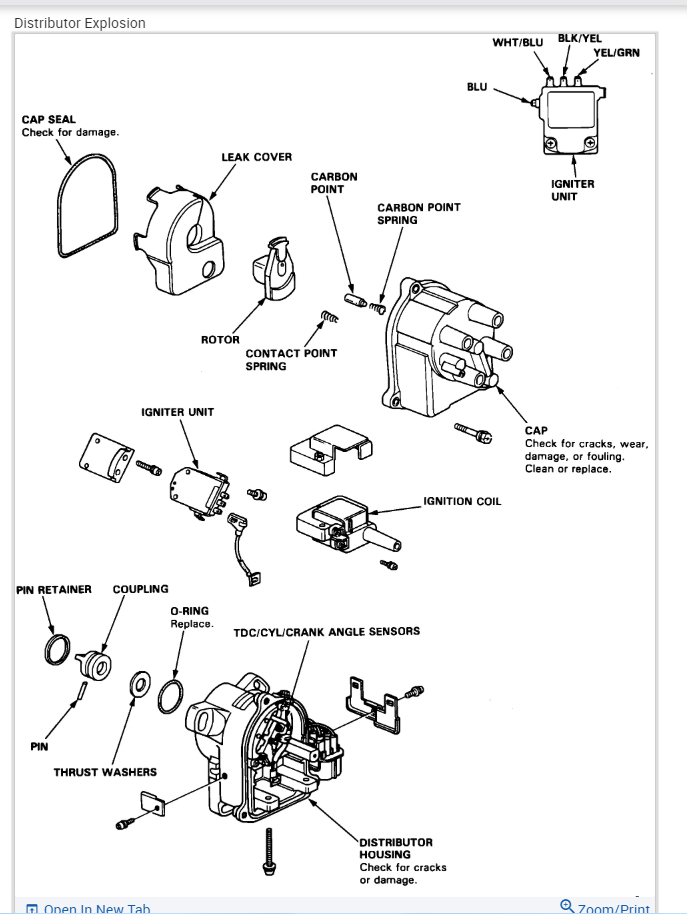

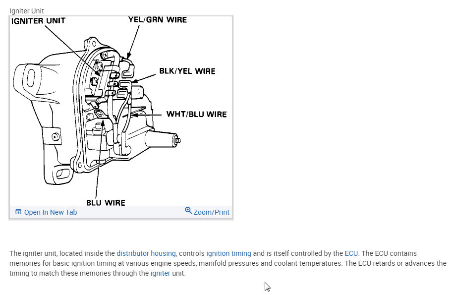

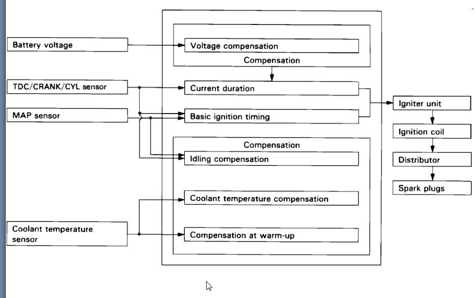

I don't disagree with your thinking about the ignition. I attached a lot of material about the igniter that will explain it in more detail.
If you can get a vacuum gauge connected to the engine, just tape it to the windshield so you can see it while driving down the road.
However, I may have forgotten that this only does it during highway driving because a vacuum leak is unlikely to do that.
I think doing the coil and igniter may be a good idea for the reason you stated that they are breaking down when they get hot.

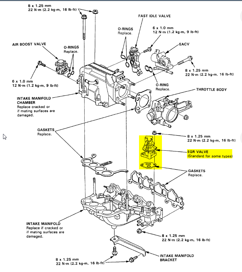

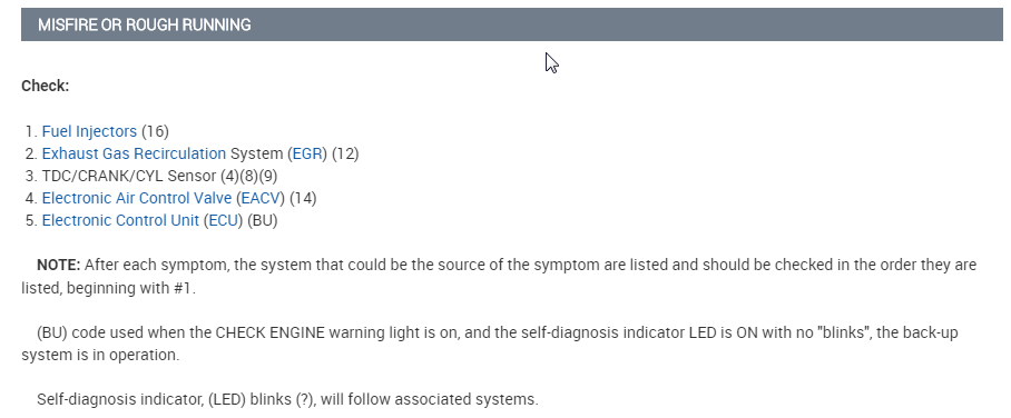

I don't think the actual temp is what is related. I think it just acts up when it is hot. That means it is most like electrical related because these are the components that are sensitive to heat. At this point, I suspect one of these components that we talked about but there is no proof so it would be a guess.
Before you do that, I would recommend cleaning the EGR valve and port. There is a chance that if this is sticking that you are getting a lean misfire at cruise because that is when the EGR is open allowing flow to reduce emissions and improve fuel economy. If this is not functioning then it will cause a slight misfire. Also this will go away when you step on the throttle because you are opening the throttle and closing EGR. Seems to fit your issue.
You want to clean it using carburetor cleaner or they may make an EGR cleaner chemical so that would be fine. Clean the valve and the ports on the engine side or just replace the valve if you are not sure you can get it clean.

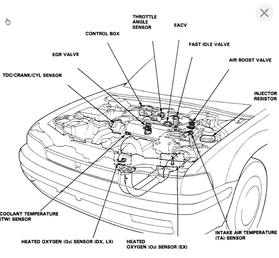

Oct 15, 2019 at 11:08 AM
No. The EGR not EACV. The EACV is used for controlling idle speed and not used during highway cruising.
The EGR is opened based on engine temp, engine load, and NOx output. EGR is opened primarily at steady throttle and speed. So if your issue starts at a certain temp this could still apply because the PCM is using it when it gets to operating temp.
Those items that you listed are just the most common symptoms of an EGR valve. It is not limited to just those things and you do not have a common issue so I wouldn't expect just a common repair to correct this.
The ports that I am talking about are the ports for the valve and on the intake.
Here is a video that gives more detail. Clearly this is a different vehicle so ignore his operation discussion because yours is different so you can jump to the 4:40 mark if you want. However he shows the EGR port on the intake and then on the valve and how to clean it.
https://youtu.be/iT8Iww44nZM
If it were me, I would clean it and retest. I get you have spent a bit of money and time on this and it is frustrating but all I can do is give you the best advice I have based on my knowledge and what you are describing. Cleaning the valve and looking in the intake port for build up doesn't cost anything other than the cost of a spray cleaner if you don't already have it.

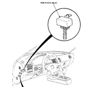

the car starts up just fine. after running for a short period of time it starts to misfire and sometimes stalls out. after waiting about 5 min. it will resart and run just fine with no misfire. after the initial start it runs pretty much great the rest of the day, even after turning off the engine and resarting ?
Jan 11, 2021 at 10:16 AM (Merged)
KHLOW2008
  • 41,812 POSTS
Hi frank1235, Thank you for the donation. The symptoms are consistent with an intermittently failing PGM-FI main relay. I would suggest removing it and resoldering the circuit board, this is a known issue.
