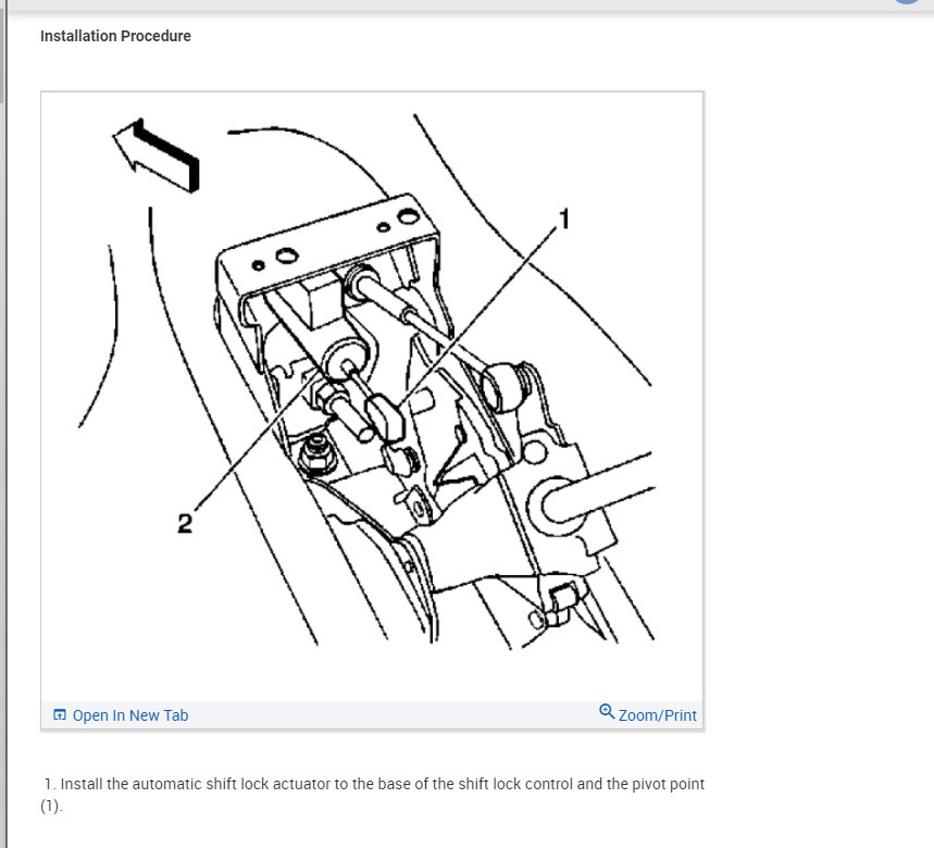

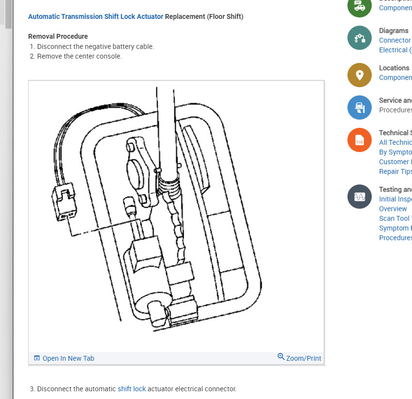

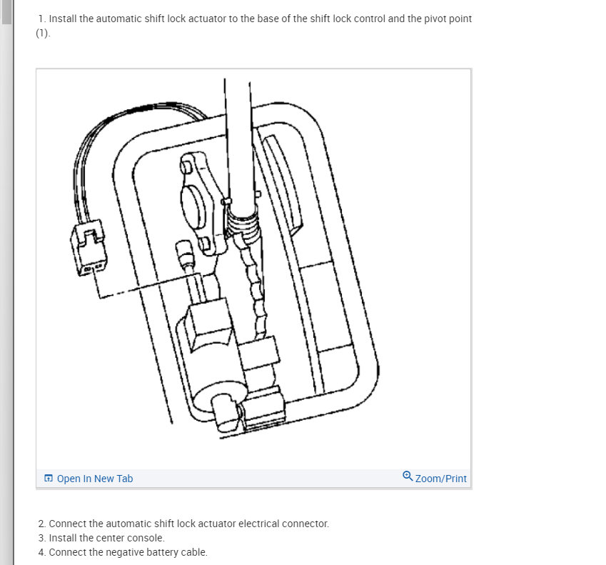

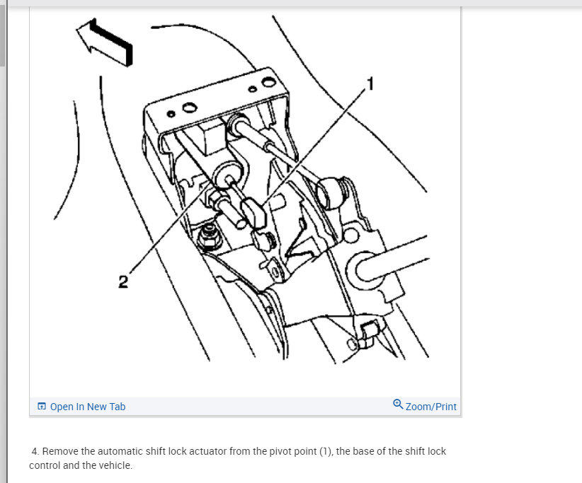

I am not sure how this happened, but this shifter has what is called a shift interlock and it is what tells the vehicle that it is in park, and it is okay to start. Also, it will prevent the key from being removed if the vehicle is not in park.
So, I suspect this is broken and we need to check it or replace it.
Please run through this replacement and access the interlock and see what it looks like. There are pictures below of what it should look like.
Let me know if you can get a picture of this and we can go from there.
Thanks

You are correct. Also, I missed a fuse. Thank you for letting me pick your brain.
