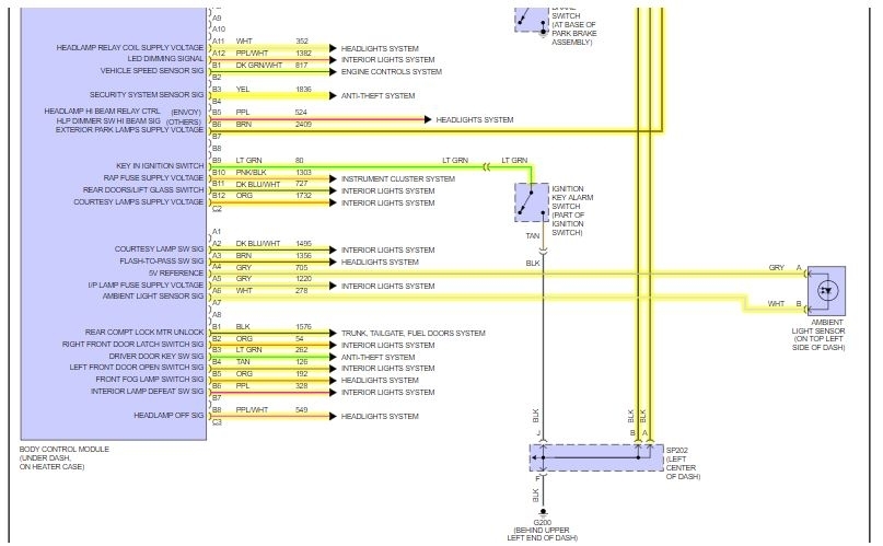

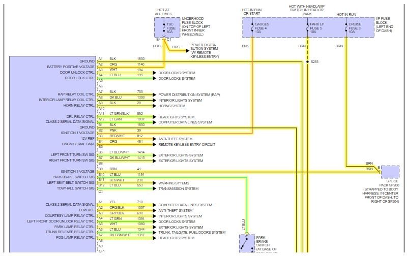

Honestly, I'm thinking it's a body control module issue. Looking at the diagrams, I see no connection between the clock spring and the turn signals. The only connection between the horn and turn signals that I see is the BCM. If you'll look at these images, you'll see that it's all tied in to the BCM. I'll do some more digging in a bit to figure out a diagnostic procedure. But if you have a donor truck that you can borrow one from that would make things easier. I once bought a BCM off of eBay for $25.00 for a 1999 Buick when I didn't have a reliable test method at my disposal. The car wouldn't crank at all. BCM solved the issue, as it was related to the security function of the BCM.
