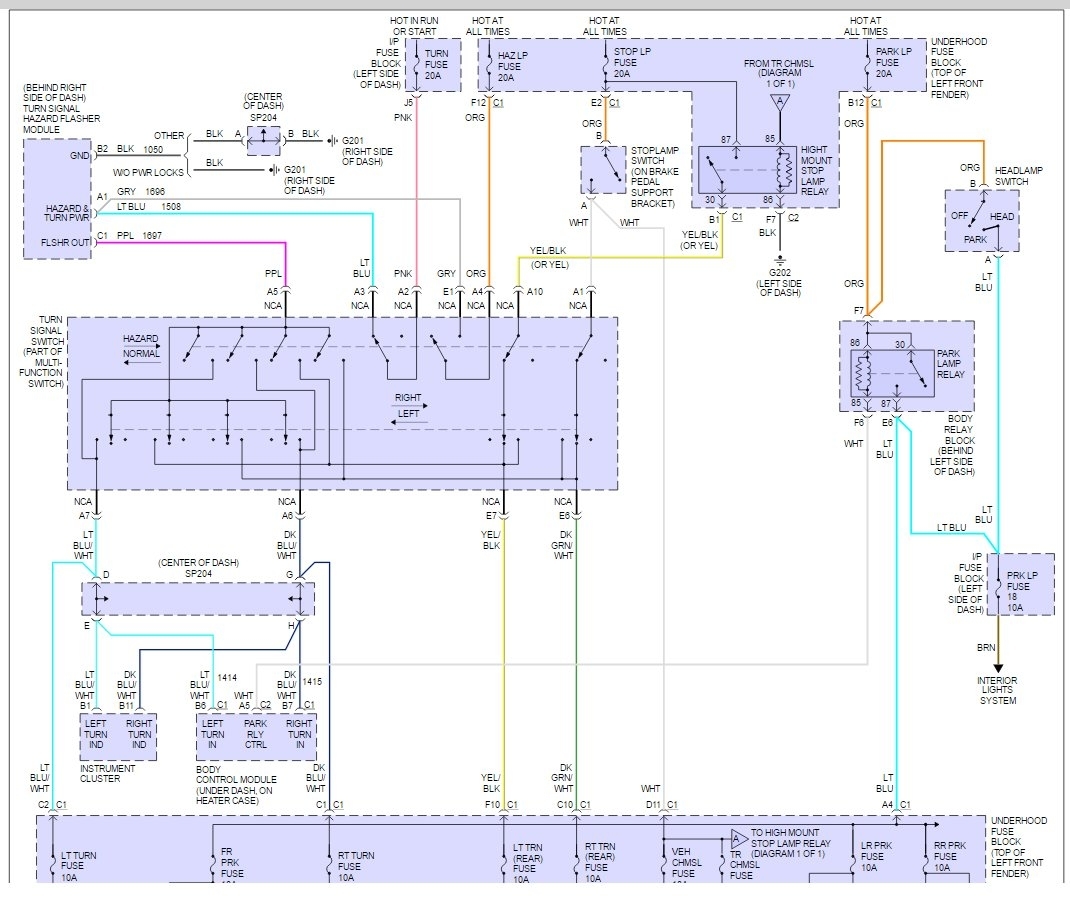

The turn signals in my truck do not work, but the lights light up when i hit the brake pedal. what could cause this?

Blown fuse, bad flasher, turn signal switch. The flasher in your truck should be the standard, reliable, inexpensive thermal flasher. Those do not fail real often, but it is the easiest thing to start with. If you do not find a blown fuse, I will dig up a wiring diagram and figure out where to start testing. If you do have a blown fuse, start by checking for a damaged trailer wiring harness.

Do they light up but not flash? or do they do nothing? Rear only or both front and rear? What happens when you turn on the hazard switch?
Fuse wise it is a 20 amp in the fuse panel in the end of the dash.
If they turn on but do not flash, and you do not hear any clicking, the turn/hazard module is mounted behind the dash to the right of the radio.
A rather common failure on these is the actual contacts in the hazard switch. Not a hard item to replace if it is the problem.

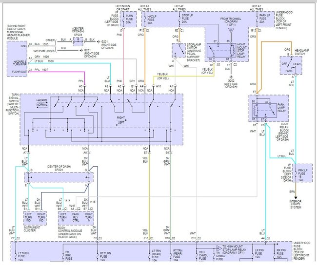

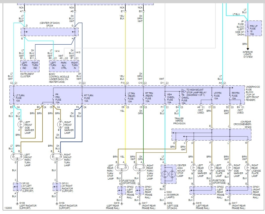

Hey WESLEY,
Can you remove the rear bulbs to see if the terminals of the bulbs are melted together? Here is a wiring diagram so you can do some testing.

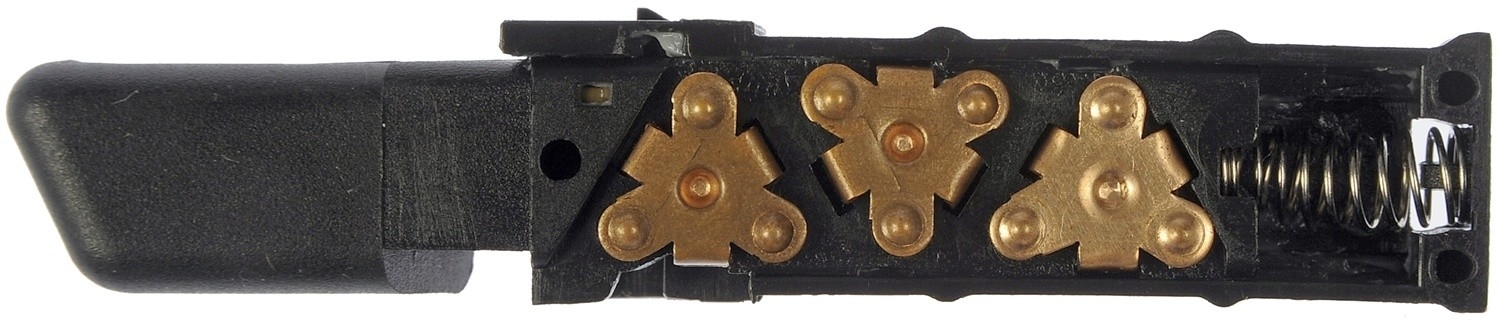

OK, one of the issues with that vintage S series was a hazard switch problem where the contacts would melt and cause loss of turn signals or brake lights. Or the switch breaks and the hazard lights stay on.The way to tell if this is the issue is simple. You pull the hazard switch actuator out of the switch and see if the contact carrier is melted/deformed.
It just pulls out of the column. I have seen the carrier melted but have also seen the switch in the column fail as well. That means a new switch assembly.
