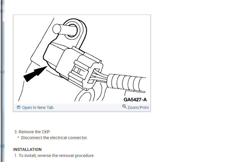

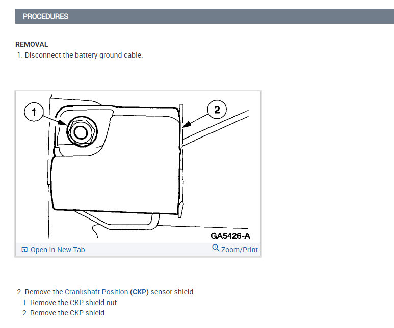

My van cuts off after it warms up try starting back up and it wont start until after it cooled down.
Jan 19, 2021 at 9:48 AM
This is most always a crank sensor issue. Clearly it could be other things like a fuel issue but normally it is a crank sensor. Here is a guide about this issue that will give more detail:
Also, below is the process from the manual on how to replace this sensor. I would go ahead and replace it and go from there. Thanks
