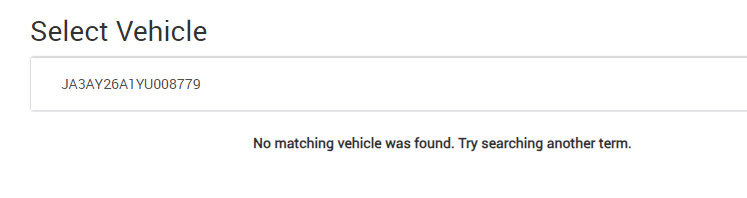

Eh. Try JA3AY26A1YU008779 stupid copy and paste picked up the 1 as an L.9th character error. Sigh. LOL
Saturday, January 27th, 2024 AT 9:44 PM
  • 109,885 POSTS
No problem whatsoever. I tried this one and got the same response. See pic below. I suspect it is because of the location.
+1
Sunday, January 28th, 2024 AT 7:40 PM

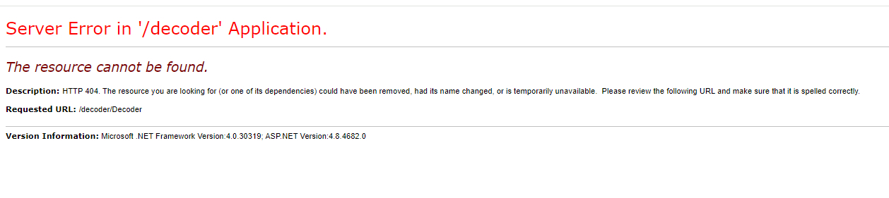

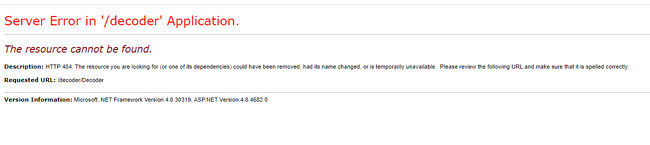

Odd, this link works okay for the VIN:
https://vpic.nhtsa.dot.gov/decoder/Decoder
Monday, January 29th, 2024 AT 11:25 AM
TF43
  • 99 POSTS
Same for Kelly Blue Book. Weird.
Monday, January 29th, 2024 AT 11:34 AM
  • 109,885 POSTS
Joe,
I tried clicking the link and got an error code. LOL See pic below. I have no idea why.
Monday, January 29th, 2024 AT 6:52 PM

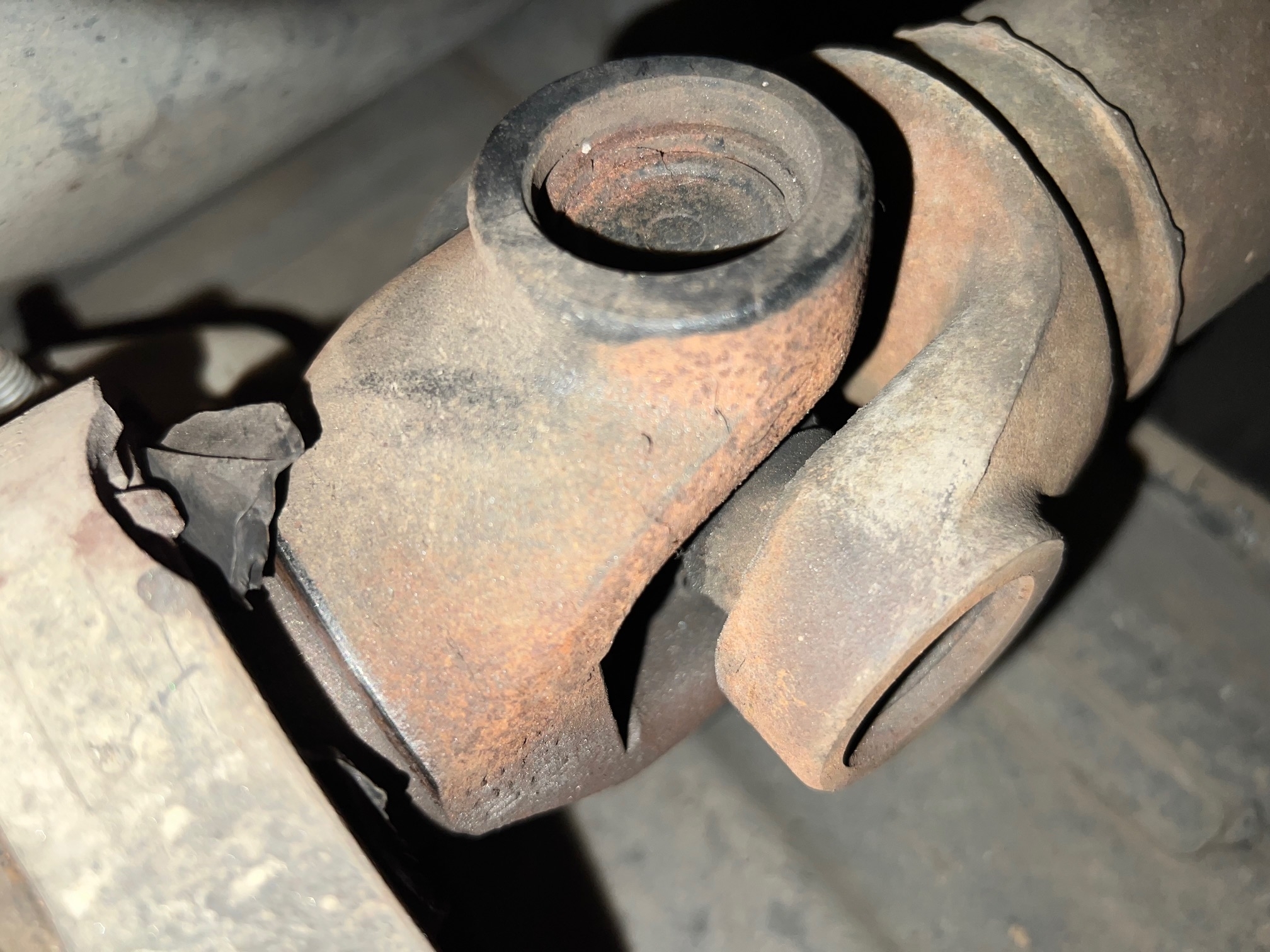

  • 109,885 POSTS
I'm confused. The pic is a cracked U-joint or yoke. Is that correct?
Thursday, February 8th, 2024 AT 1:35 PM

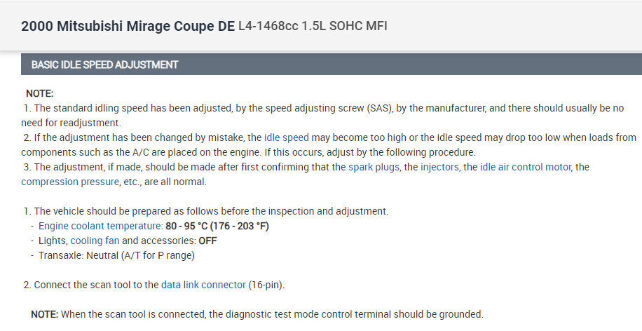

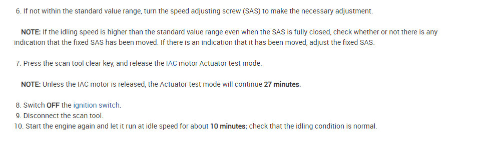

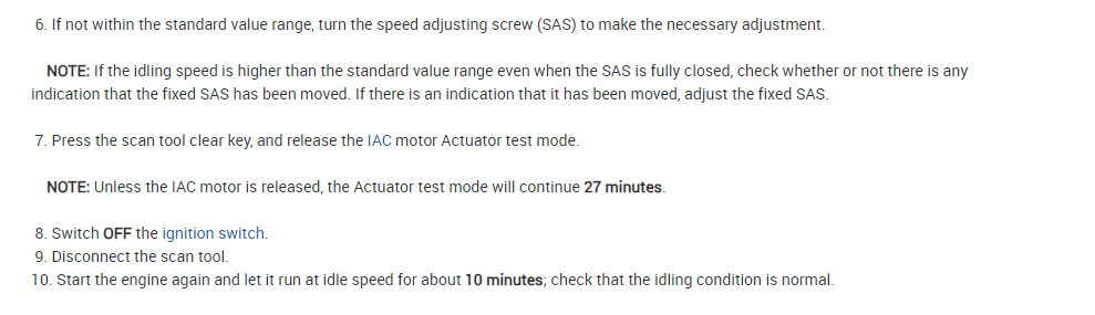

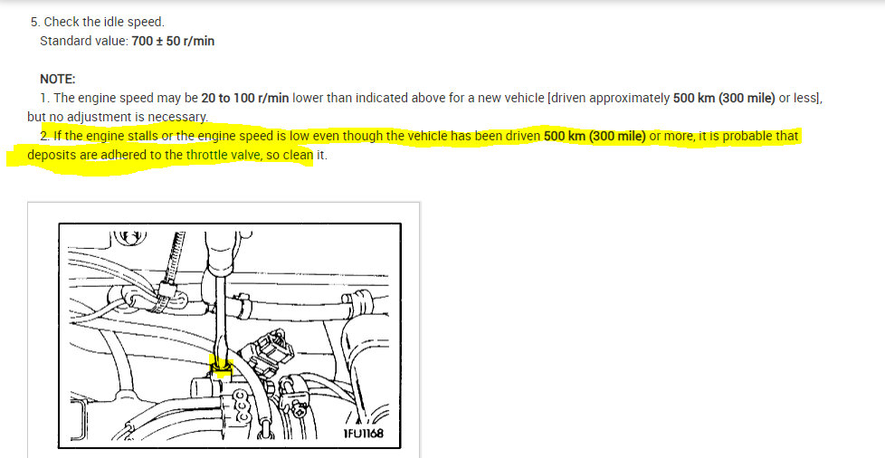

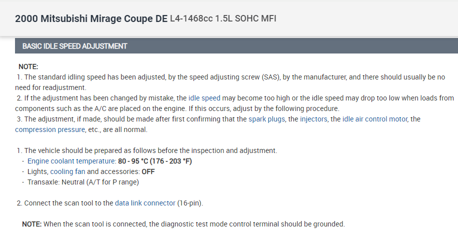

  • 109,885 POSTS
Hi Terry,
I attached directions below for setting the idle speed. Take a look through them and let me know if you feel they are helpful.
+1
Saturday, March 9th, 2024 AT 5:19 PM
