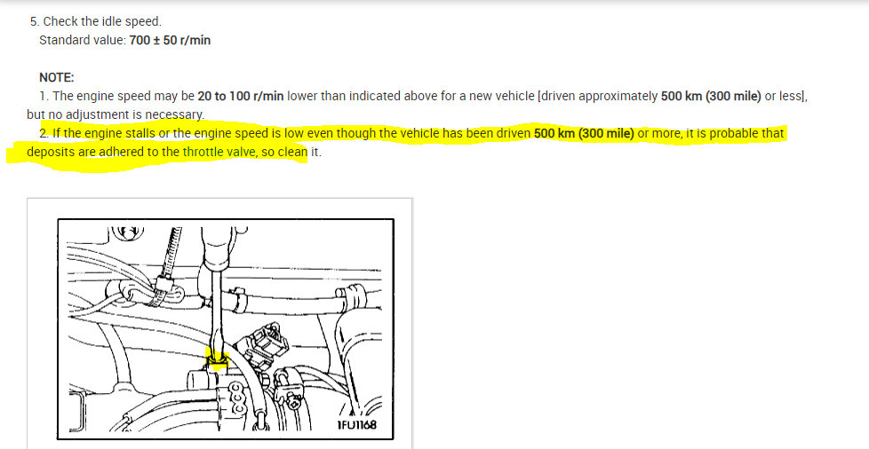

Before we suspect a crankshaft position sensor, take a look through this link, and let me know if it seems to mirror what you experience. I want to be sure the sensor is bad before trying to replace it. The timing belt cover needs removed to access it.

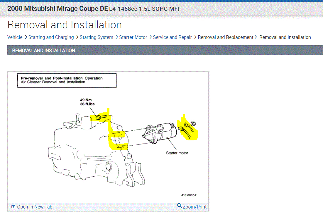

Now the starter is not hard to replace. I just looked at my manual's directions and they are extremely vague. So first, take a look through this link. It explains in general how the procedure is done.
If you look at the pic below, those are the directions I have. LOL There isn't much to go on. However, what you will need to do is this. First and very important, disconnect the negative battery terminal before working on the starter.
Next, you will need to remove the air filter and filter box. The starter is below it. Once you get that removed, disconnect the wires to the starter (carefully) and then remove the two bolts holding the starter in place. When you reinstall, it is basically the reverse procedure. However, when you connect the wires to the new starter, make sure they are not in any way touching each other. If they are, the starter will engage as soon as you connect the battery and not turn off until the battery is disconnected.
I hope this helps. Please let me know what I can do to help.
See pic below.

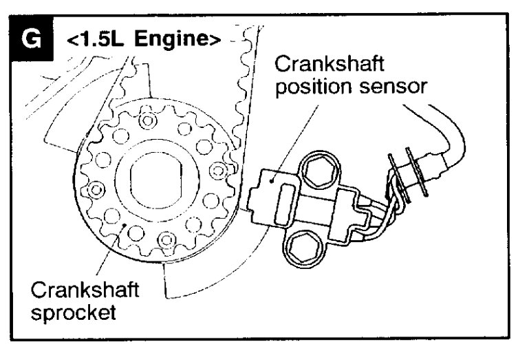

You have anything that shows what I need to remove to replace that thing?
the service manuals I have are pretty sad in that area.
Thanks
Dec 27, 2023 at 3:55 PM
  • 110,240 POSTS

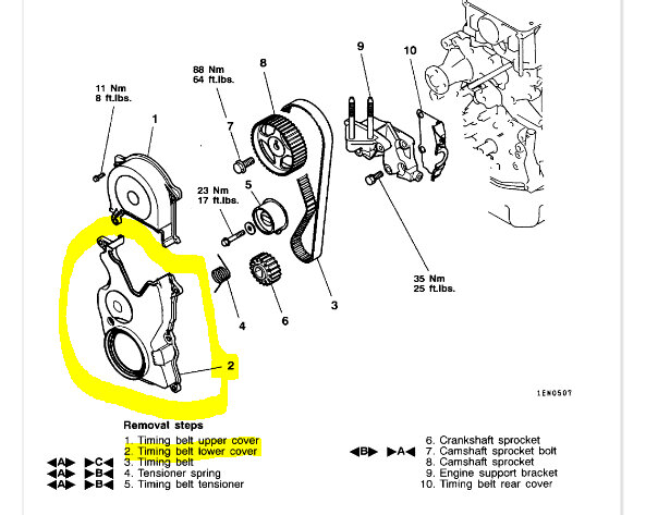

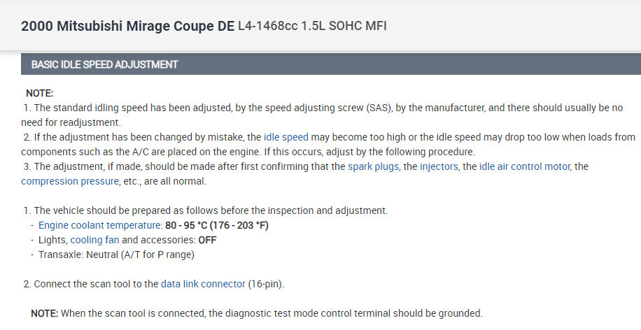

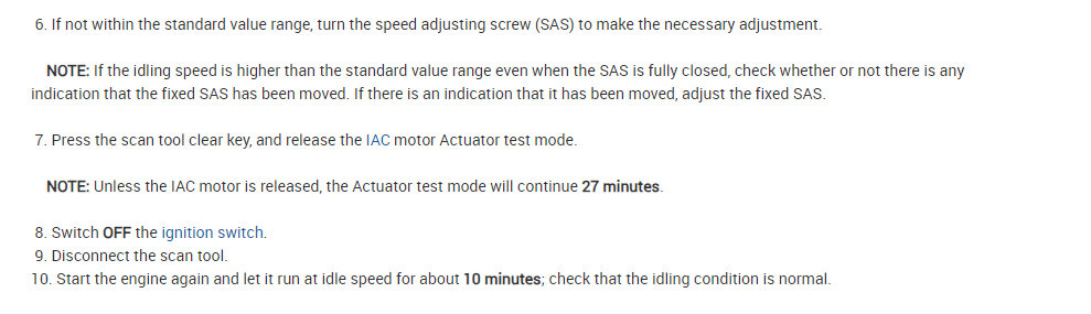

My manual is the same on this vehicle. If I am looking at it correctly, the lower timing belt cover needs to be removed. See pic 1 below.
Pic 2, shows the lower cover I am referring to. If that needs to be removed, the crankshaft pulley needs removed first.
Before you remove the cover, confirm it is required. The labor is showing nearly 2 hours if it has AC, so that sounds like it needs to be removed.
Let me know if this helps.

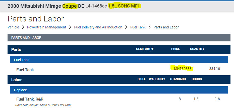

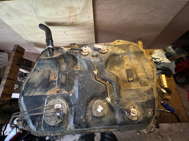

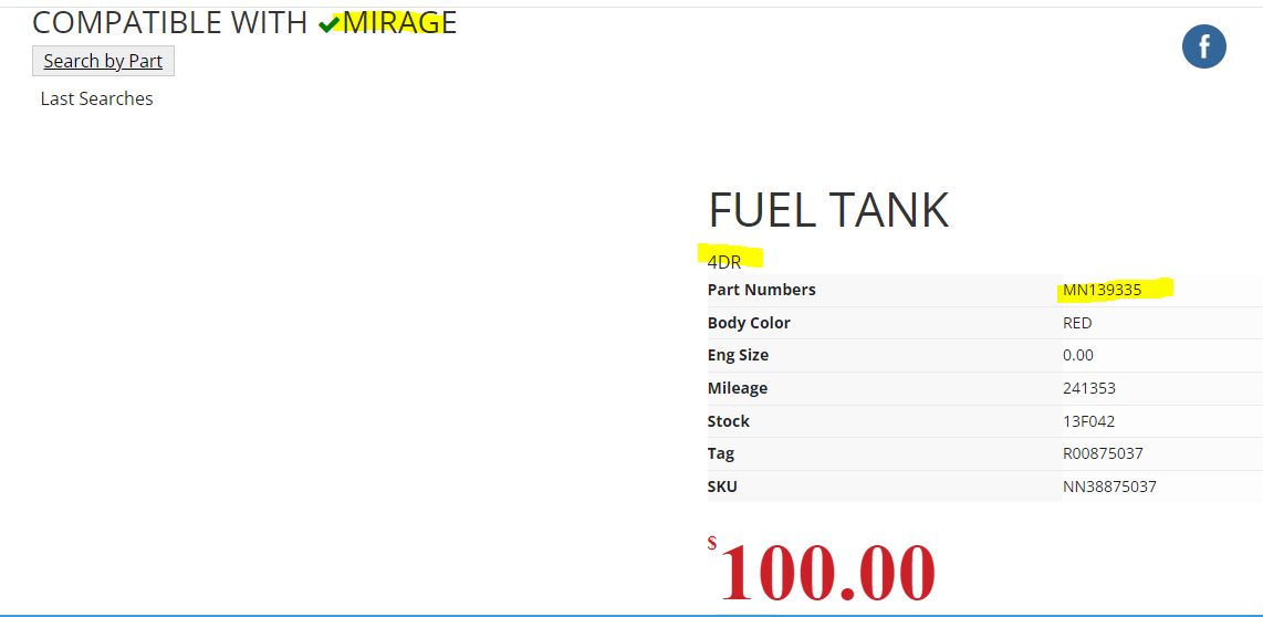

Pulled the tank out today, Sat 1/27/24 again and I am going to test it before putting it back in this time. I was pretty confident it was sealed last time, but as mentioned...forgot to do a step...oh well...so it goes huh...LOL
Anyway, would you have a part number for this tank, see pic.
2000 Mitsubishi Mirage DE 4Dr Sedan, 1.5L
It has more smog connections than the tanks I find online. and I could use a filler neck as well. Naturally all are discontinued items - go figure. Dorman shows a tank, but not one like this.
Anyway, patching the holes again with some Permatex putty, will let that sit for a day, then think I'll cover it all with some JB Weld Metal epoxy that says fuel resistant.
Will try that before going after it with a torch and brazing rod.

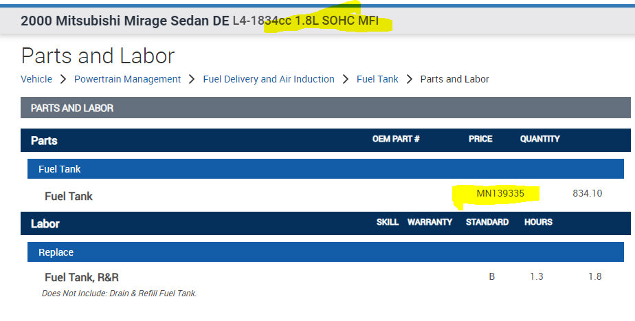

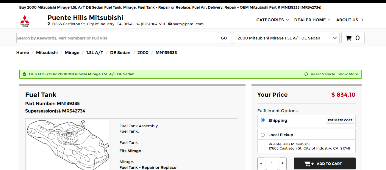

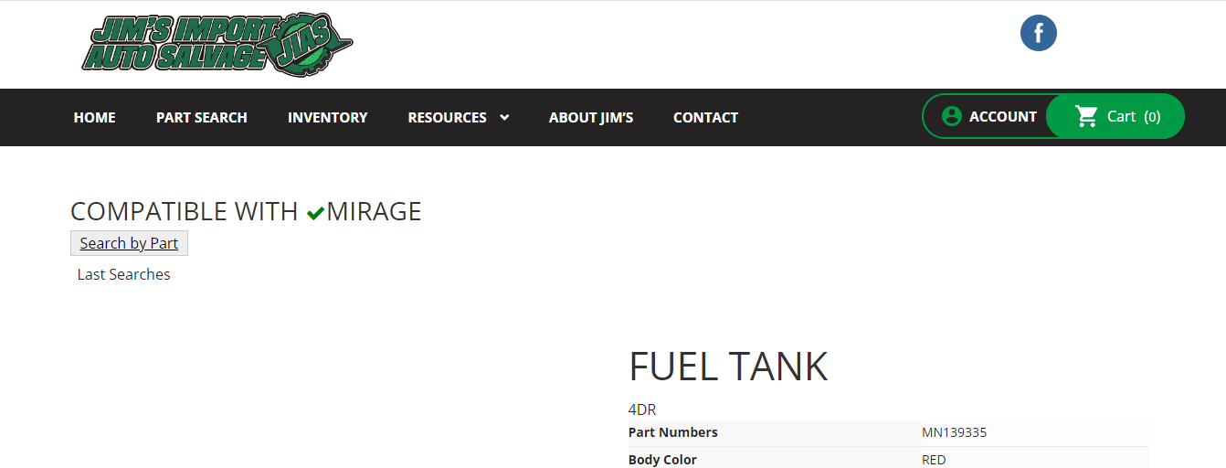

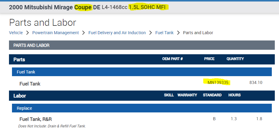

I attached two pics below. In my manual, the 1.5L is only used in a 2-door coupe. The 4-door sedan indicates a 1.8L engine. However, both appear to use the same fuel tank. And I looked up the part number from a dealership, and it indicates your vehicle and engine size, so I'm not sure which one is correct.
The only problem is the cost of the new one. The used one, if you can get them to ship it, would be a great price, $100.00. See the last three pics.
See pics below. Pics 3 and 4 are from the same website. I couldn't fit it on one pic.

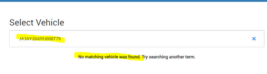

Here is the VIN:
JA3AY26AlYU008779
1.5L 4dr sedan DE
Jan 27, 2024 at 12:26 PM
  • 110,240 POSTS

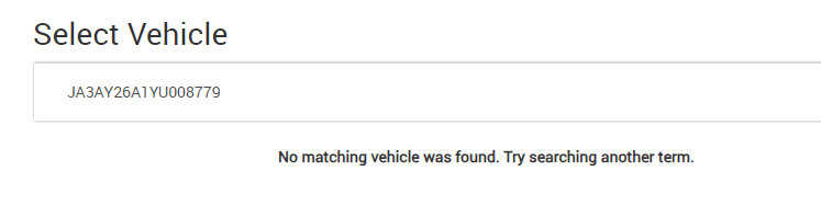

I tried using the VIN, but the system says there is no matching vehicle. If I had to guess, it is likely because they offered different models where you are located. See pic below.
The best thing to do is contact a seller and have him send pictures for you to verify it will fit.
I wish I could be of more help.
See pic below.

Eh....try JA3AY26A1YU008779 stupid copy and paste picked up the 1 as an L...9th character error...sigh...LOL
Jan 27, 2024 at 1:44 PM
  • 110,240 POSTS
No problem whatsoever. I tried this one and got the same response. See pic below. I suspect it is because of the location.

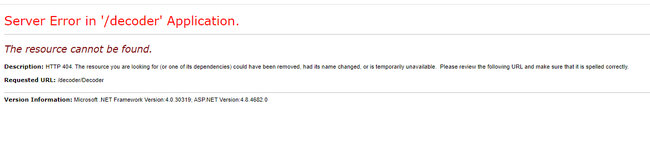

Odd, this link works okay for the VIN:
https://vpic.nhtsa.dot.gov/decoder/Decoder
Jan 29, 2024 at 3:25 AM

  • 110,240 POSTS
Joe,
I tried clicking the link and got an error code. LOL See pic below. I have no idea why.
Jan 29, 2024 at 10:52 AM

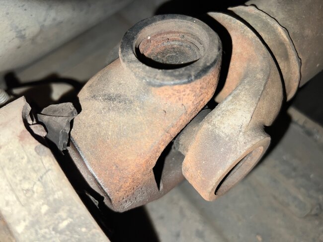

Feb 7, 2024 at 1:37 PM
  • 110,240 POSTS
I'm confused. The pic is a cracked U-joint or yoke. Is that correct?

Back to the 2000 Mirage. I'm not sure if I covered it or not, but the crank sensor is installed.
Not too bad of a job overall, but not something I'd do every day, LOL.
I should have spent a little more time on it and given the timing belt a good look over, but from what I could see of it, it looked fair enough. No cracking or signs of stress in it.
Guess the 1.5L has a camshaft sensor in the distributor. So, some posts have mentioned, and the 1.8L is outside on the head. I certainly cannot find one on this thing.

If you don't notice a change in the idle speed, remove and service the idle air control valve. In addition to the part, make sure the air passage it sets into is clear and not carboned. Keep in mind, a vacuum leak can also cause a rough idle, check that as well.
Here are a couple of links you may find helpful:
https://www.2carpros.com/articles/idle-air-control-valve-service
Let me know,
Feb 17, 2024 at 11:38 AM

Hi Terry,
I attached directions below for setting the idle speed. Take a look through them and let me know if you feel they are helpful.
