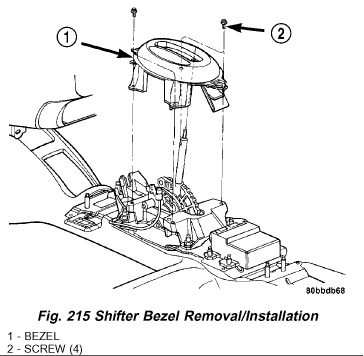

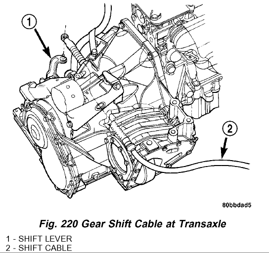

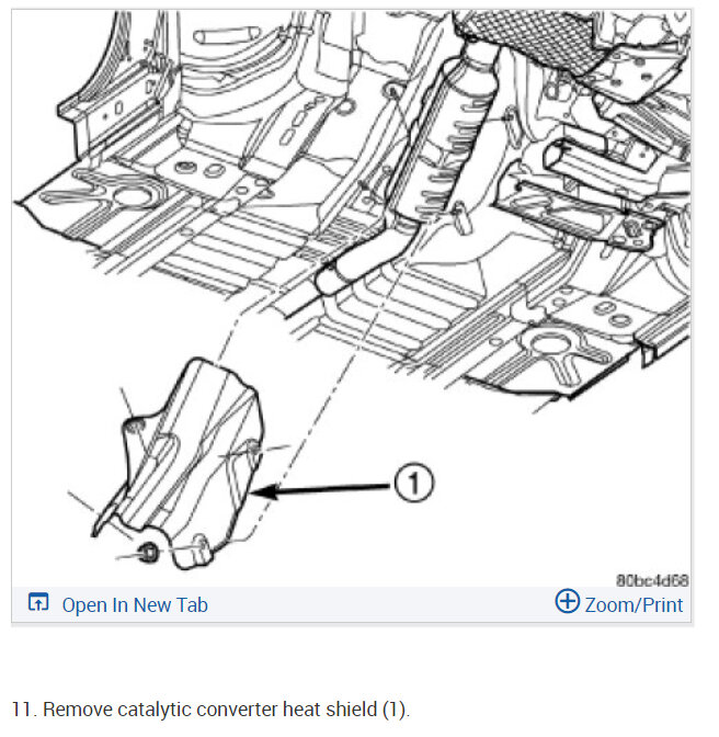

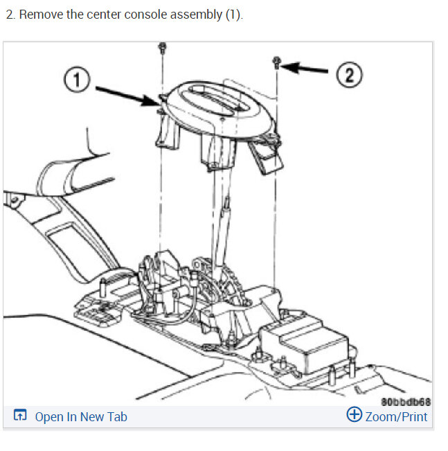

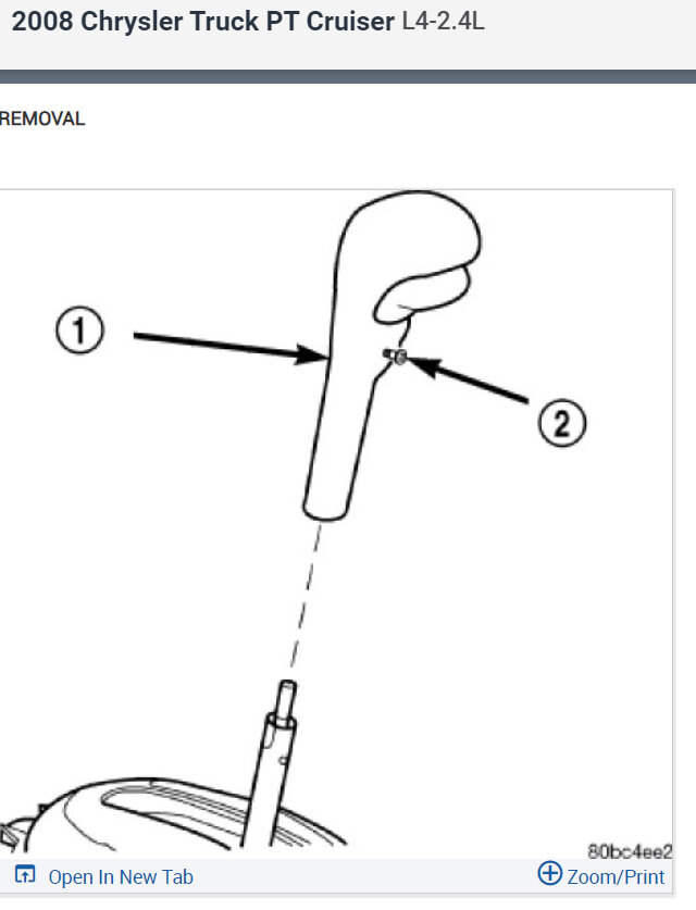

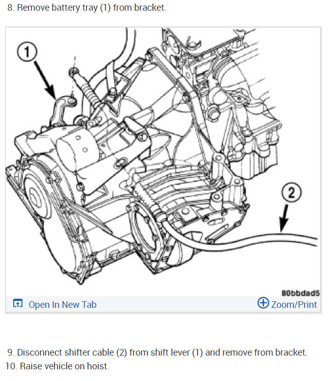

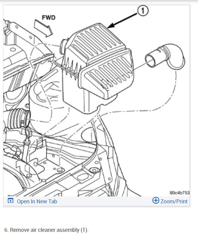

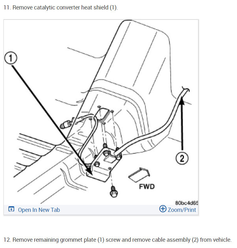

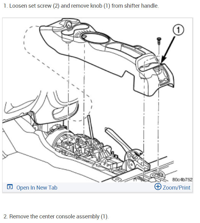

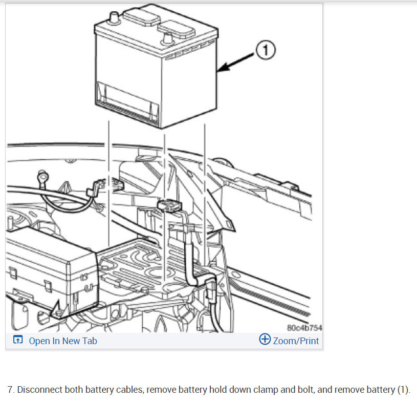

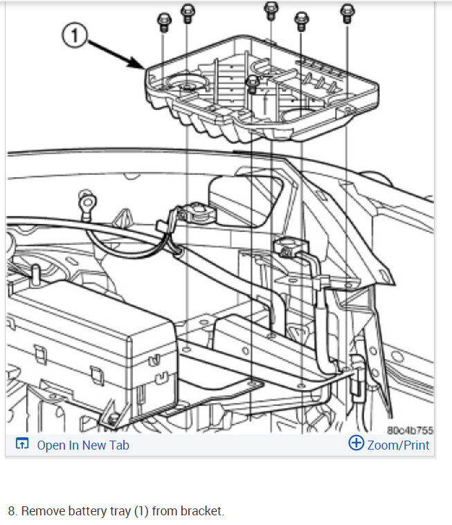

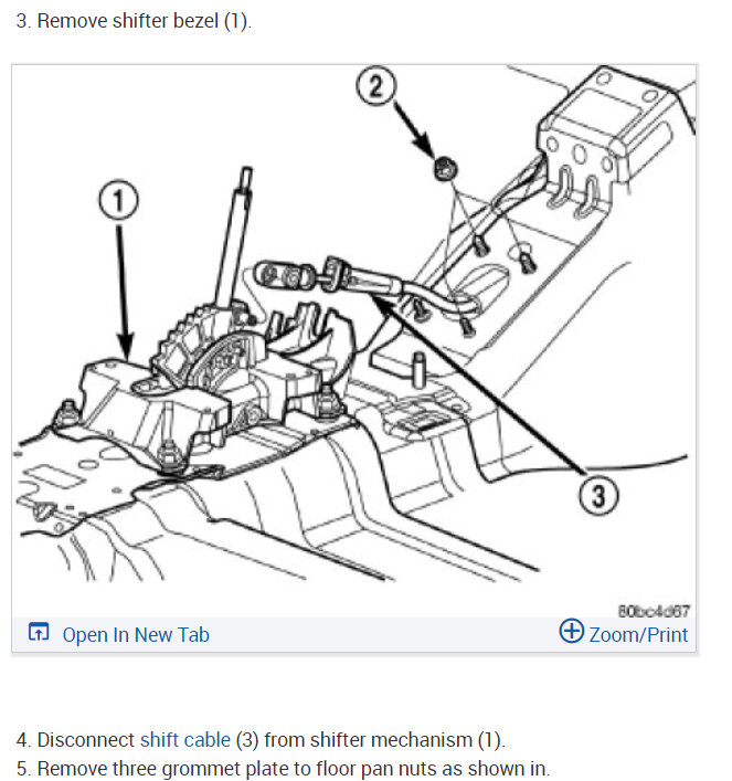

Did the cable break or just become disconnected (very common due to the plastic bushings failing, you can get just the bushings if the cable is still okay)?

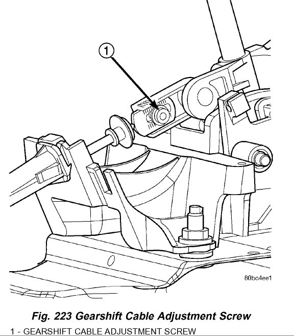

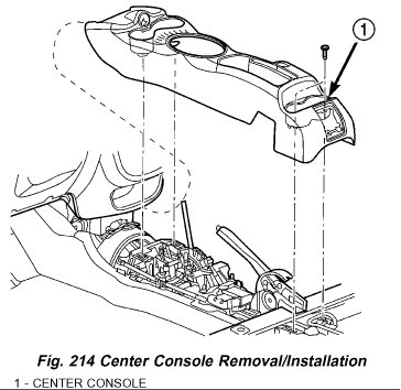

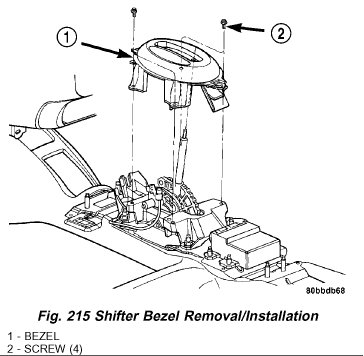

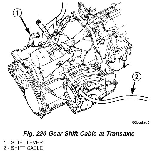

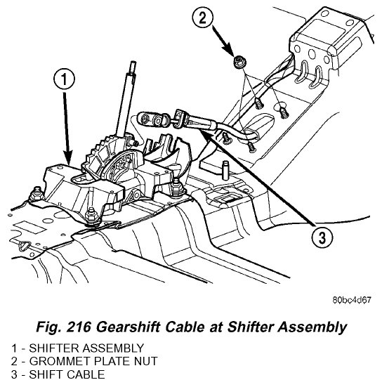

Remove the set screw that retains the shift knob, then remove the console assembly. Now remove the four screws that secure the trans bezel. Now you can see the cable end. The cable just snaps onto the pin on the side of the lever. Remove the nuts that hold the grommet cover in place. Now open the hood, remove the air box, the battery and battery tray. Release the ball socket on the transmission end of the cable and release the cable from the bracket. Now you need to jack up and secure the vehicle and remove the converter heat shield from the tunnel area (the cable runs behind it). Drop the cable out of the chassis and remove it. Replacement is the reverse with the exception that you have to adjust the new cable. You do that by loosening the adjuster screw on the shift lever. Then after making sure the transmission is in park and the shift lever is in park you tighten the adjuster screw back down.

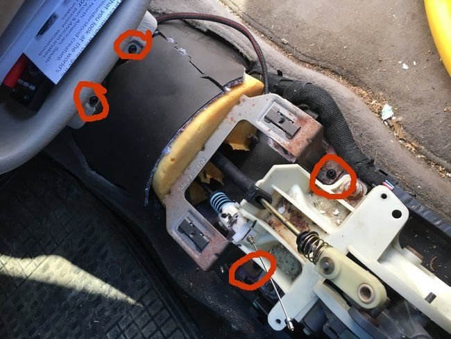

I have a 2002 pt cruiser and i cannot find the grommet cover even looking at the photos i can send photos when i get home
Mar 19, 2019 at 12:38 AM
  • 55,746 POSTS
Please do so we can see what the problem is
Mar 19, 2019 at 4:01 AM
TRISTANW
So here is what I got
Mar 19, 2019 at 7:27 AM
STEVE W.
  • 15,418 POSTS
Yours is slightly different. If you remove the four circled screws you should be able to access the cable.

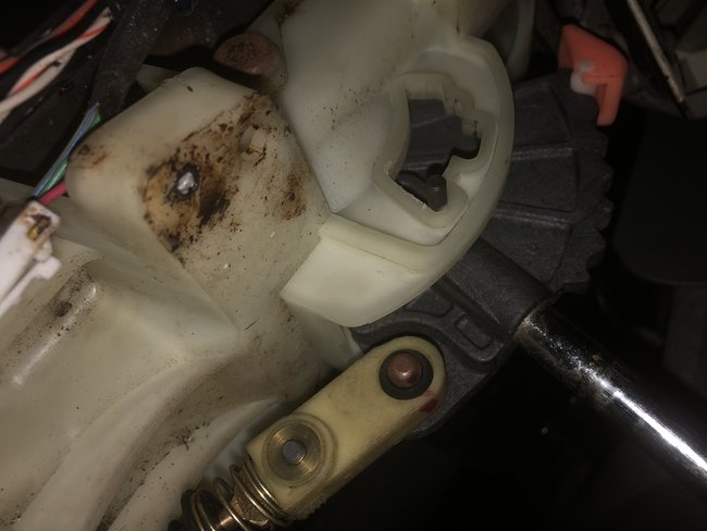

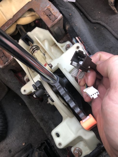

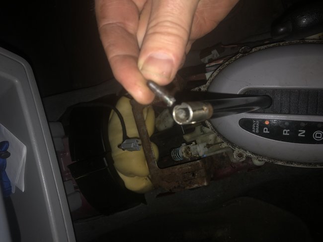

Hello, I have a similar question except I’m just replacing the shifter assembly. My situation looks like Tristan’s pic above. So how does the cable detach from the assembly? My rod within the shifter handle is what’s busted from underneath the shifter ball so do I have to take the whole assembly out? Or maybe just super glue this piece back on?
Dec 29, 2021 at 10:27 AM
STEVE W.
  • 15,418 POSTS
If you mean the white connector for the cable to the stud it will depend on which cable you have the early version has a bolt that goes through the white piece with the red paint mark and attaches it to the cable, the later version the white plastic has a socket in it that just snaps into place over the stud that it mounts to. I have seen a couple that had snap rings on them as well to retain it but that were later models.

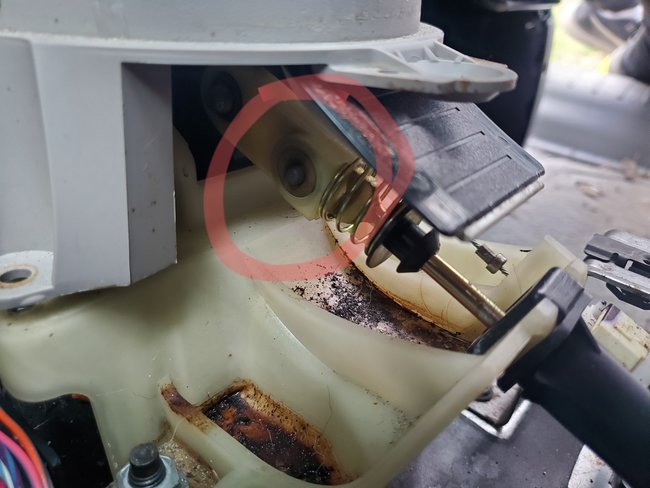

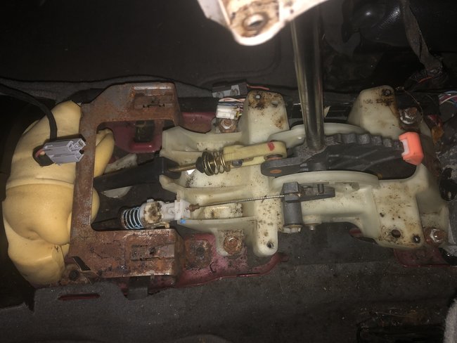

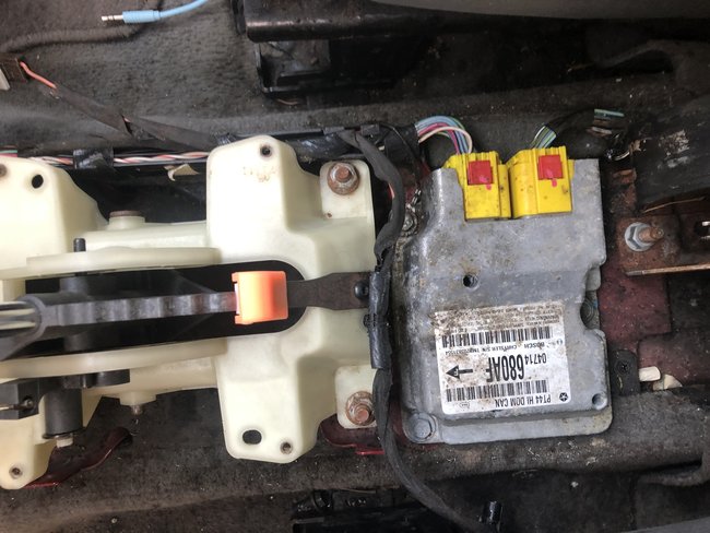

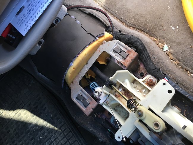

Thanks for the quick reply, Steve. This Pic shows what’s on the other side. Is that just snapped on then? And then can I just snap it back on easily or will I have to loosen the cable then tighten back up with a torque wrench?
Dec 29, 2021 at 12:42 PM
STEVE W.
  • 15,418 POSTS
That one is a snap on type. They sort of pop on and off, but if you have a lot of miles on it, they can get brittle so be gentle.

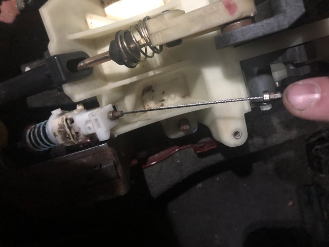

Okay, Steve. crazy question at the end (or help in getting it right): the cable on the left (in pic) that controls the ignition box I’m guessing…when I connect it just as it was, it freezes the ignition where I can’t get the key out. I’ve tried uninstalling and reinstalling the assembly with the same result. The circuit is not completing to pull the key all the way back in park and come out. The ignition works and the key comes out when not stretched in its grooves like it’s supposed to be. Crazy question part—can I just leave it unattached? It seems to be only there to mess with the ignition port. Or how else can I get this thing right?
Dec 30, 2021 at 9:59 AM
STEVE W.
  • 15,418 POSTS
That is the interlock cable. It should only allow the key to be shut off and removed with the car in park. It's adjustable, look at the area that is dirty in the picture and you should have a clip that goes around the cable. Use a small pick or screwdriver to pull that up. Now attach the cable and hold it in place while you move the shifter a few times and then once it's in park, be sure the key release works, now push the clip back down. Test it a couple times and it should work.

Bingo Steve! I just found that little clip and fell upon this fix just before you wrote this Ha ha! But I appreciate you writing back it confirms that I did it right! I made a video just now to help others because I didn't find this answer anywhere except help from you and me fumbling around. Hopefully it'll help others with this explanation. I gave you thanks in the description part too:) Thanks again! https://www.youtube.com/watch?v=p0wbMx9bYpM

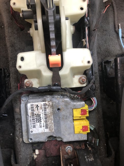

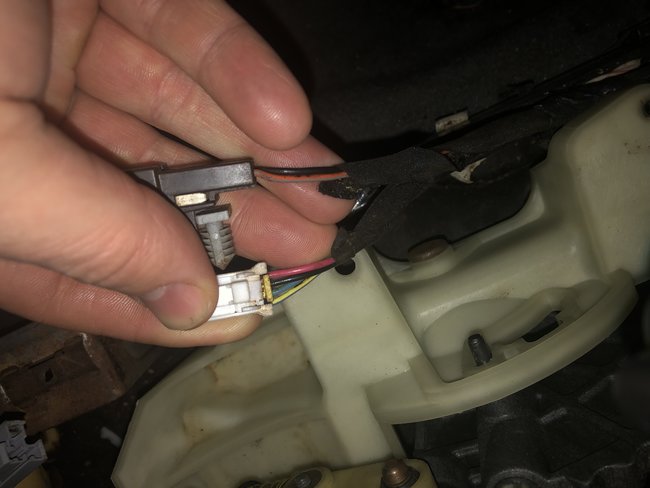

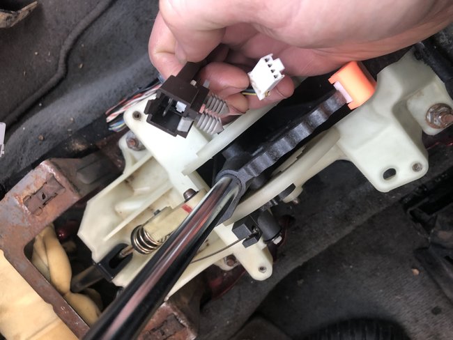

But now another question about cables I found: (pic)? Where do these go to and what are for? It’s not the bulb under the shifter and not the cig lighter. They weren’t plugged in before so not sure where they go or what they’re for. Laying on the right side.

Now I'm just trying to figure out these cords on the left side now too lol. They weren't plugged in to begin with so not sure where they go or they're extra from the manufacturer to add features later?
Jan 1, 2022 at 8:56 AM
STEVE W.
  • 15,418 POSTS
Good job, figured you would realize it but never hurts to know you got it.

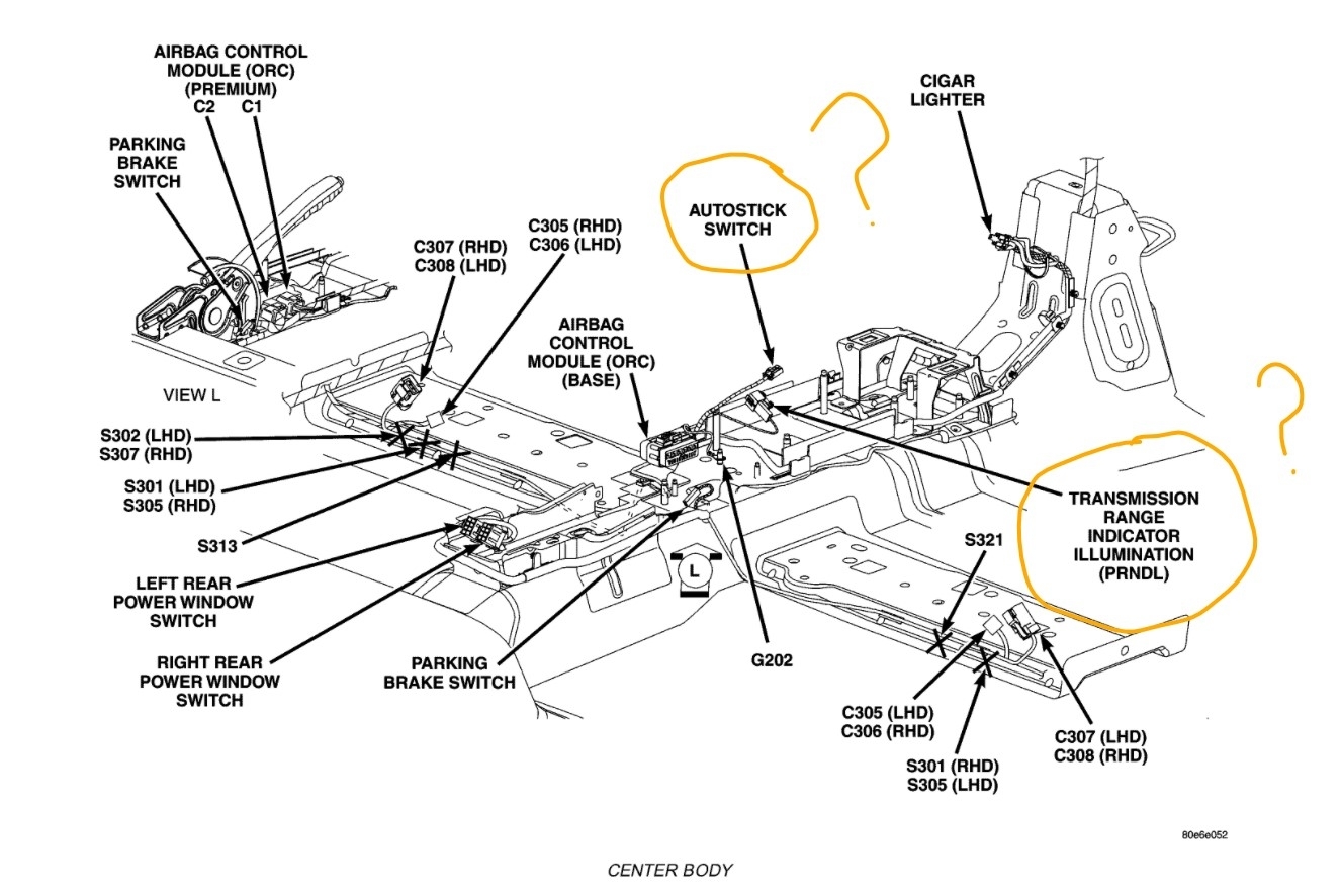

Tell me the wire colors and I'll look them up, I suspect they may be for the other transmissions they used but wire colors should show that.

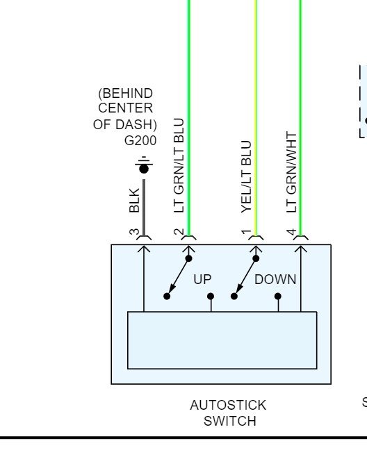

Does yours have an auto stick transmission shifter? That 4 pin connector could be for that option if you don't have it. Do the wires match the ones in the attached diagram?
The other one looks like it could be for the PRNDL light.
Jan 1, 2022 at 11:13 AM

Not the PRND light because I’m replacing the bulb for that so I got that one covered. Attached is a better pic maybe to check colors. Not sure if it’s the ones in your schematic or not. I don’t have the auto stick option either.

Going by the colors it is for the control for the other transmission option. They used 2 sticks as well as 2 automatics so planned for them all in one harness.

If it's the bolted area that came undone, you will need to apply a bit of Loctite to it so it cannot back out again. Next stiff and sticky is usually at the other end of the cable where they can corrode. However, it looks like soda or coffee spilled into that area from those brown stains. If that is the case the best option would be to replace the cable. You might be able to clean that out of it but not without a lot more work than just replacement. For a temperature test to see if that is the case you can get some graphite lubricant and spray it into the end of the cable while shifting it to work it in, it might free up enough that you can live with it.

Help, that shift cable is done and needs replacement to fix the problem here is how to the job in the images below. Check out the images (below). Please upload pictures or videos in your response of any problems so we can see what to help you with.
