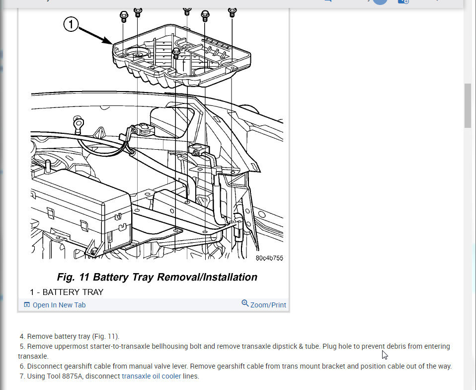

I can drive to the store or where ever I am going and it changes gears like it should. But if I stop and turn it off and then I start it up and leave it wont change gears at all.
Nov 29, 2016 at 1:23 PM

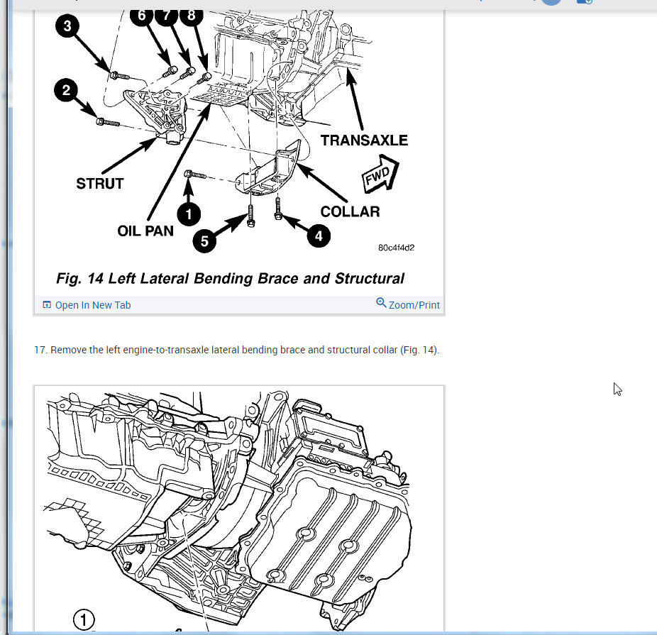

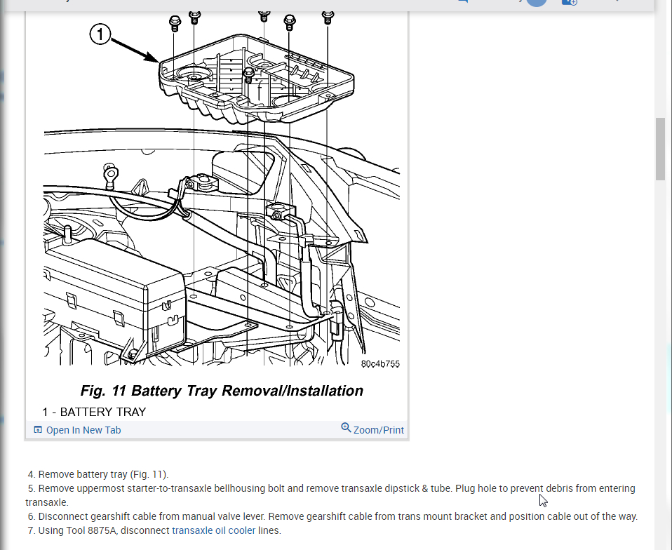

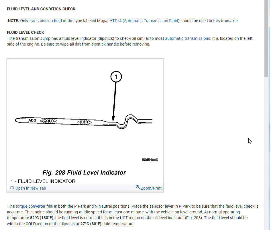

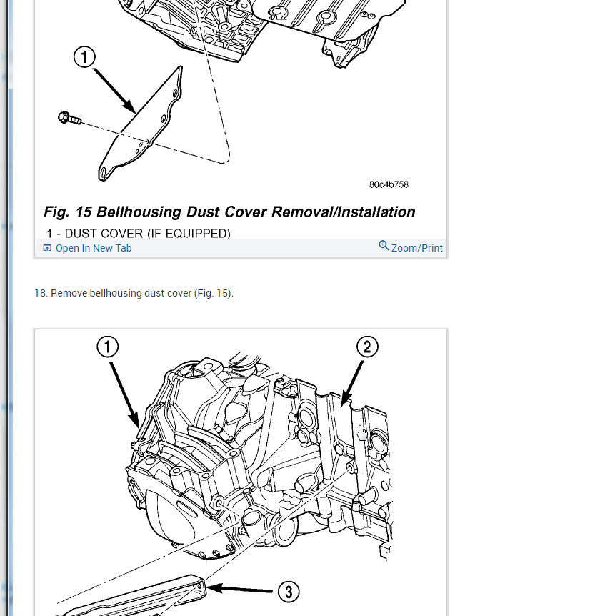

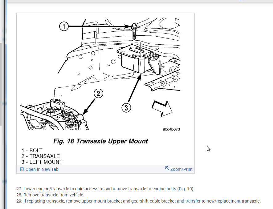

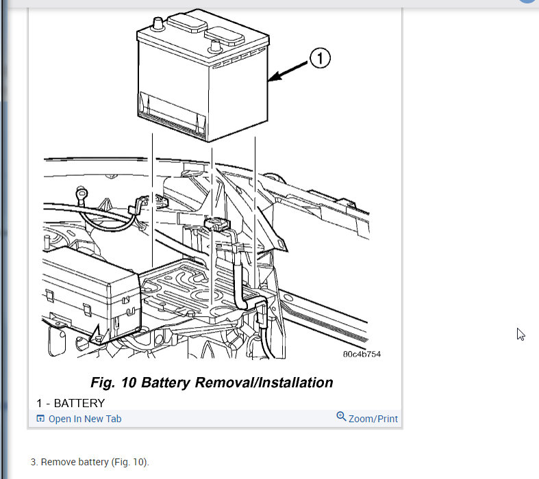

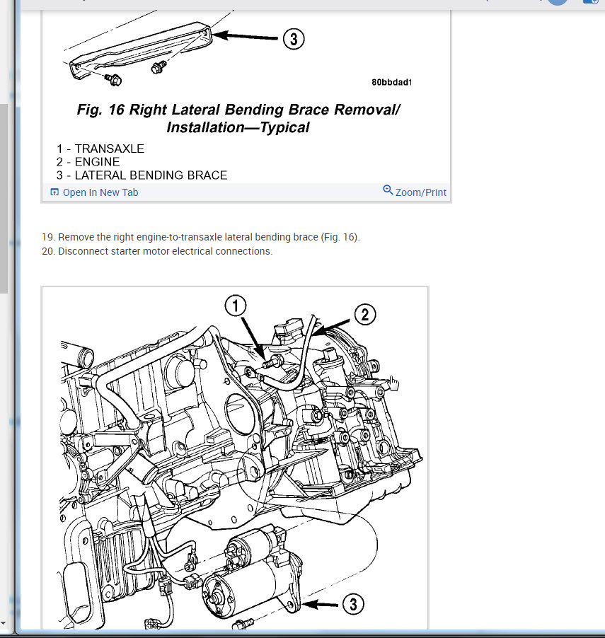

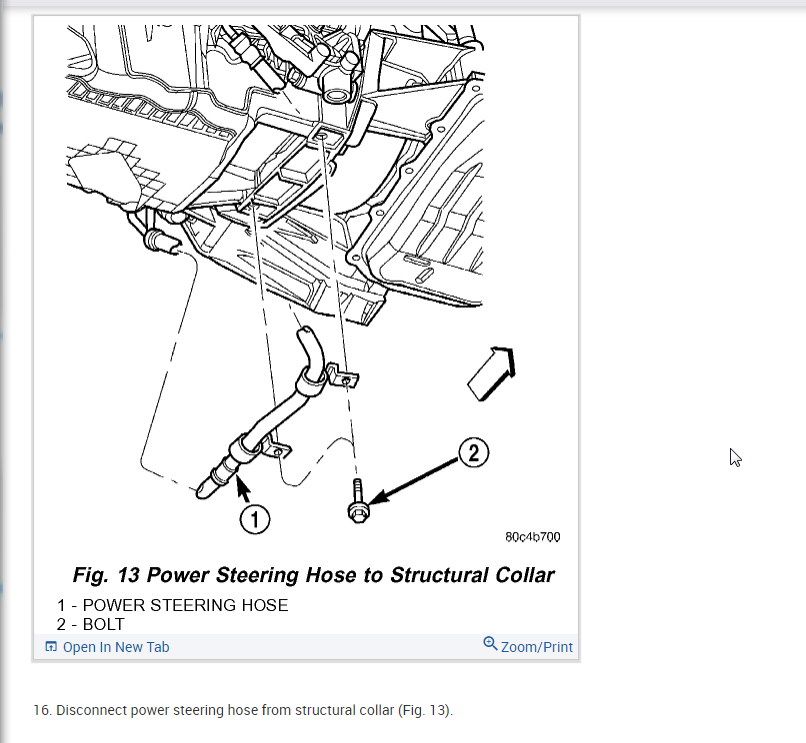

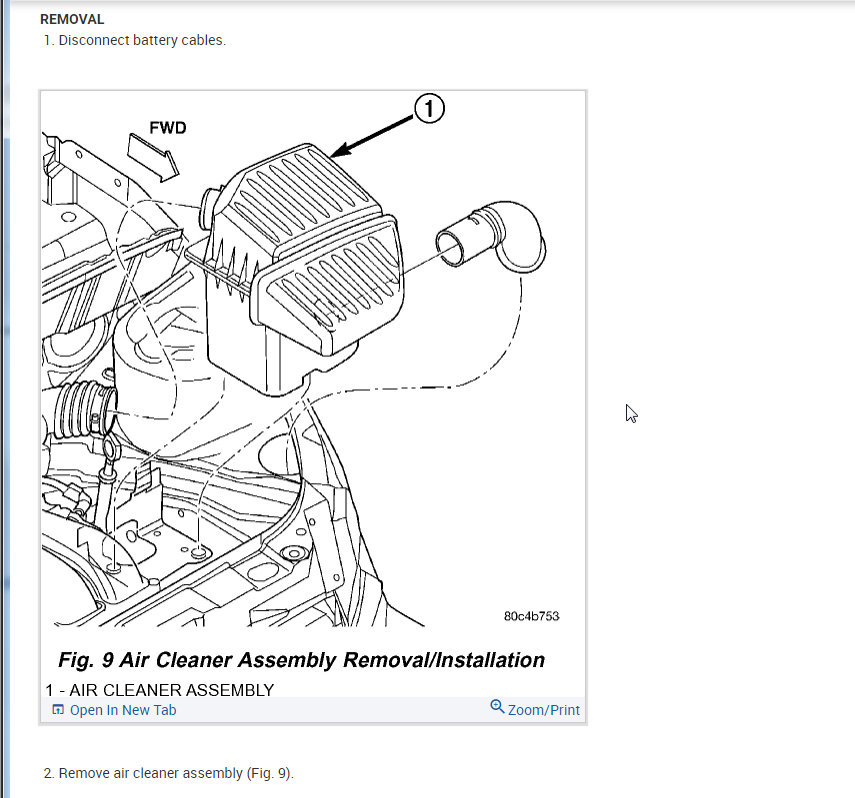

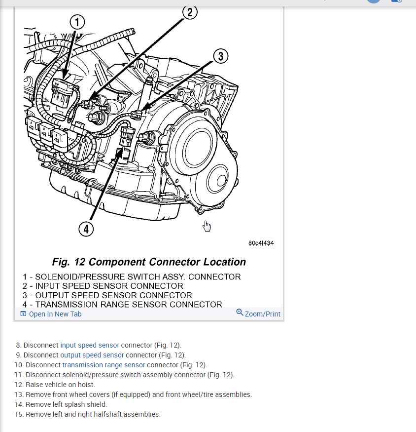

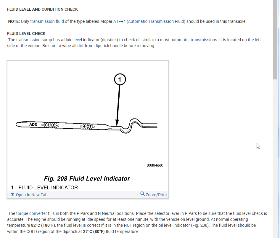

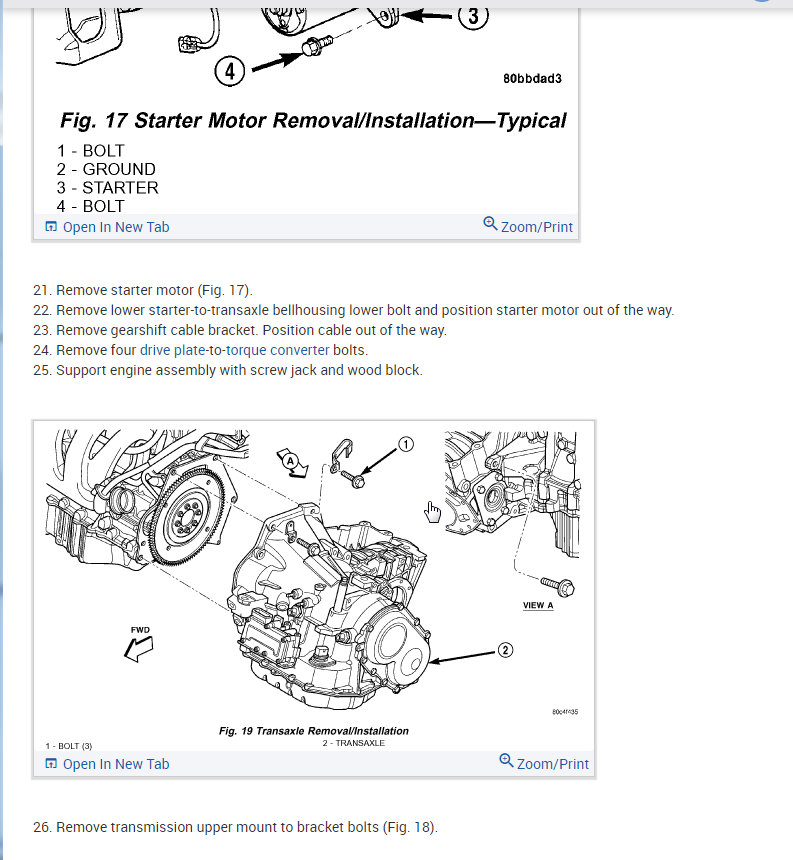

We need to start with checking the transmission fluid. Depending on what you find we can go in a different direction but I suspect you are going to need to replace the transmission. These vehicle have what is called a 41TE transmission and this is a pretty common issue. Basically the pump inside the unit is not able to build the pressure and it doesn't move.
Here is a guide that will help with replacing the unit but let's start with the fluid condition and go from there:
https://youtu.be/3vJAojsrfuU
Below is the process from the manual on how to check the fluid and replace the unit if you need it. Thanks
