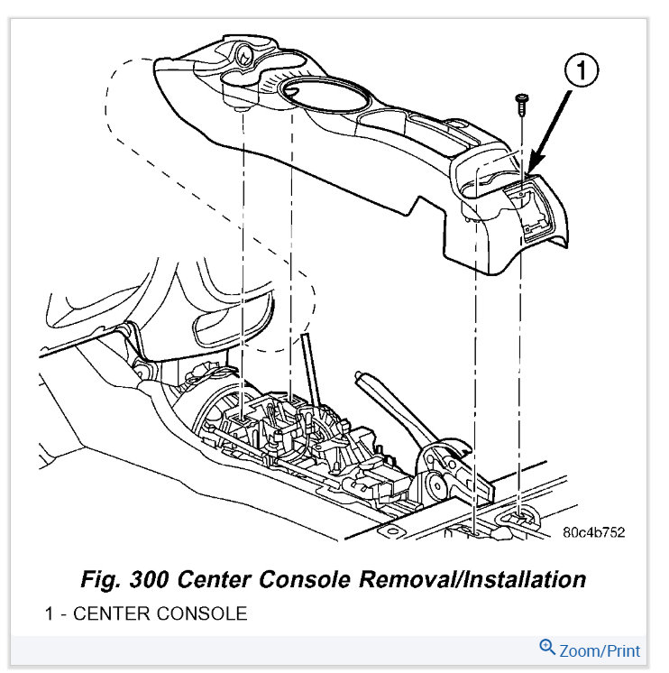

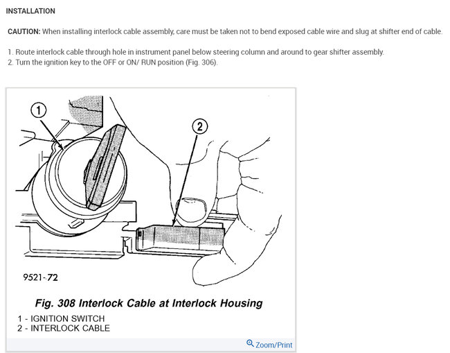

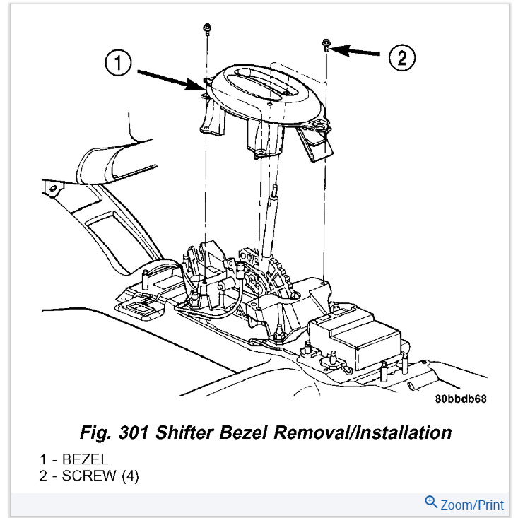

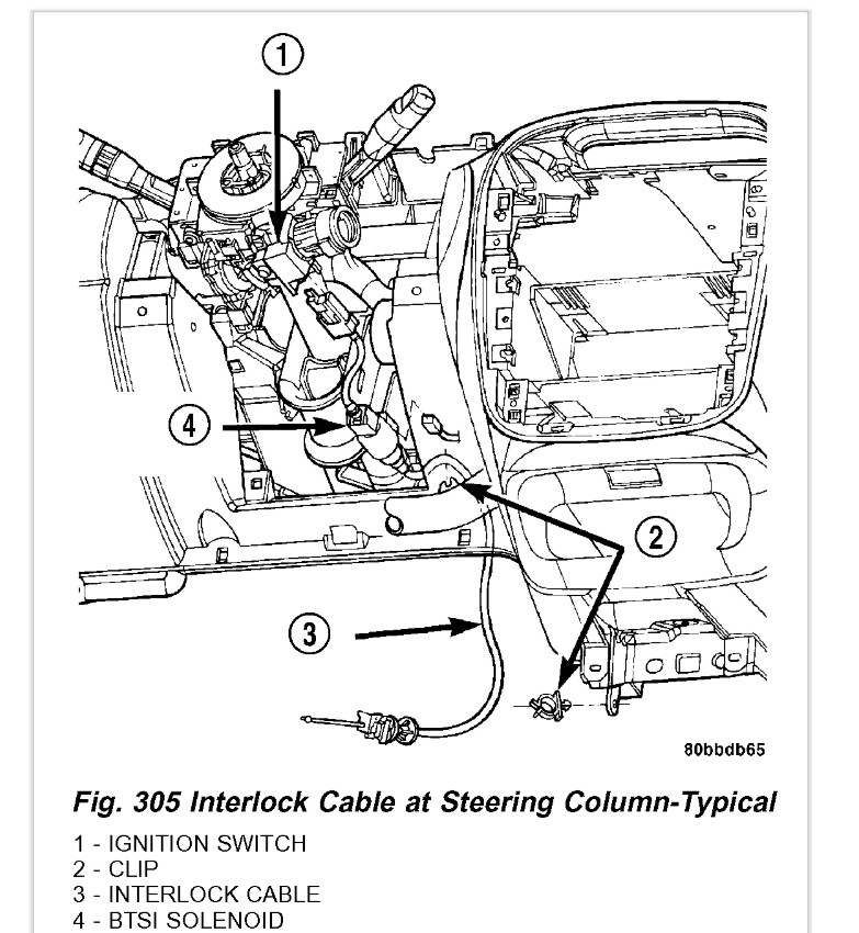

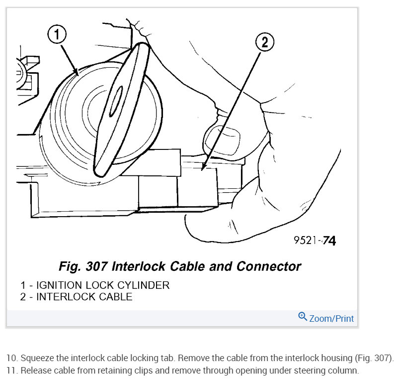

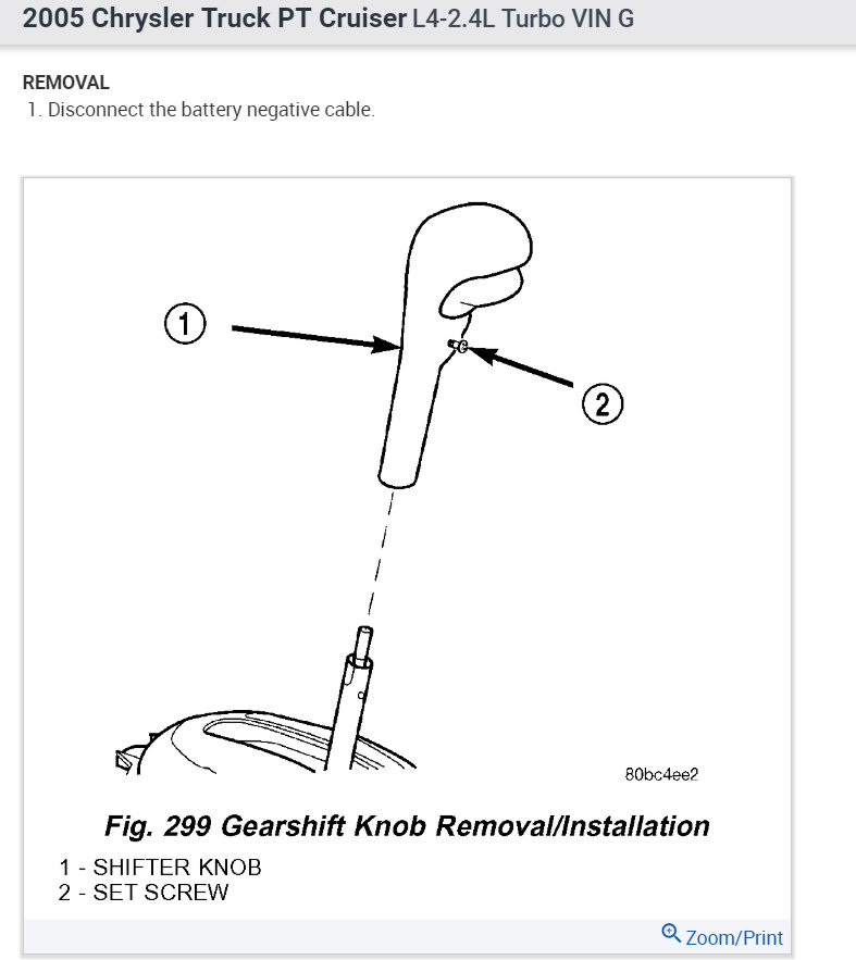

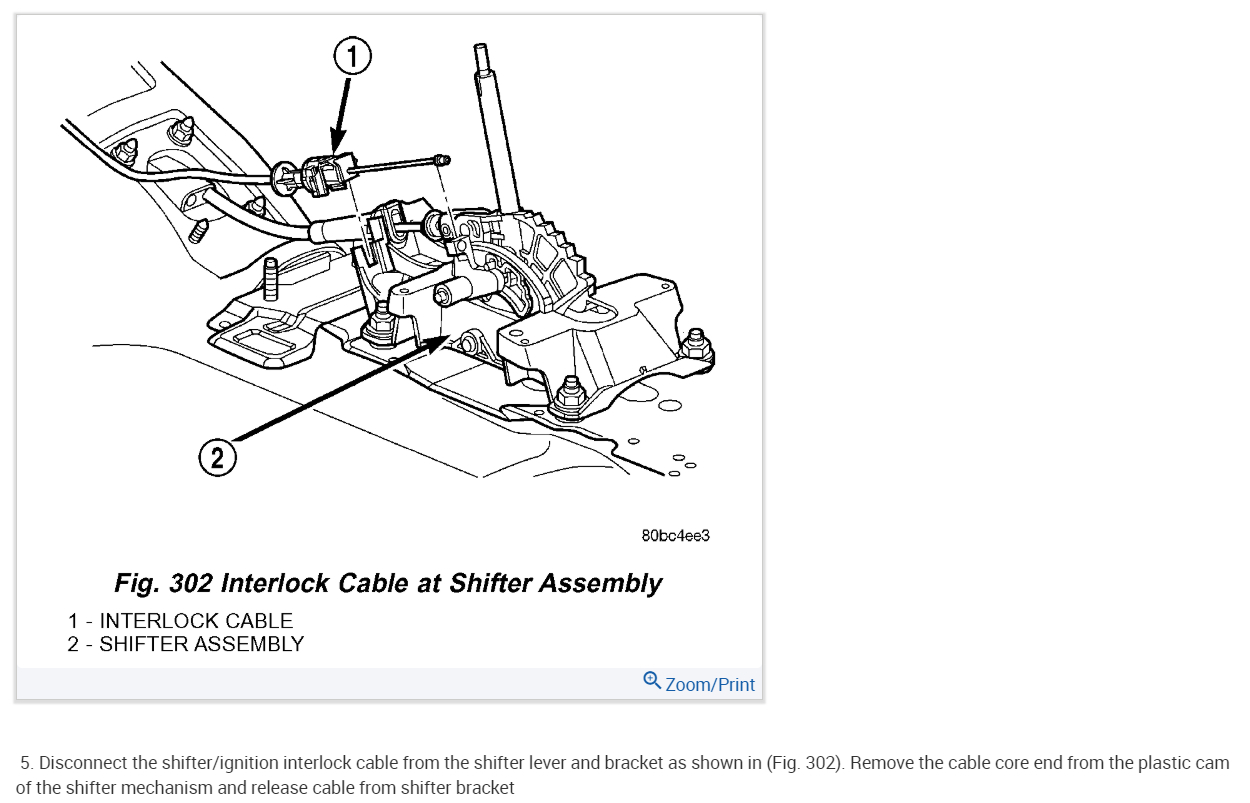

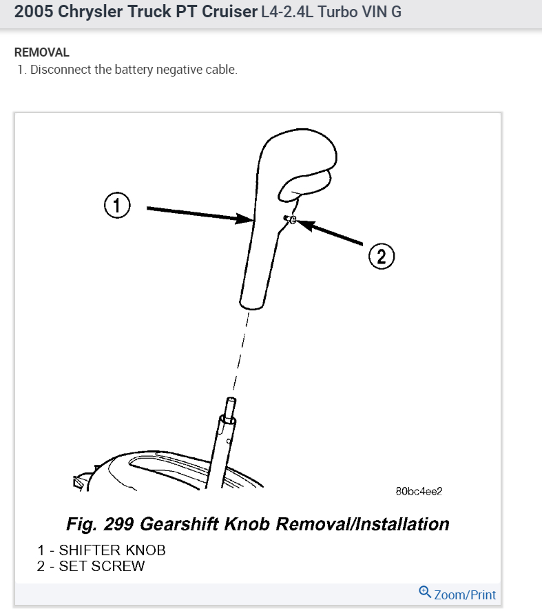

I cannot get my PT Cruiser to shift out of park?
Apr 11, 2008 at 2:14 PM
  • 75,992 POSTS

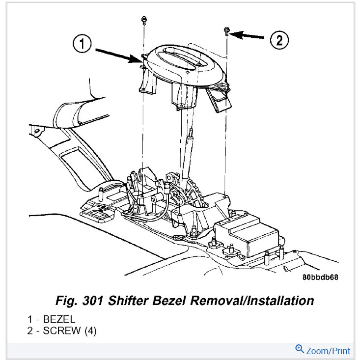

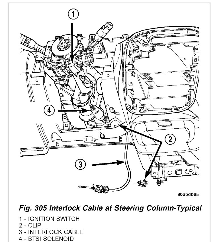

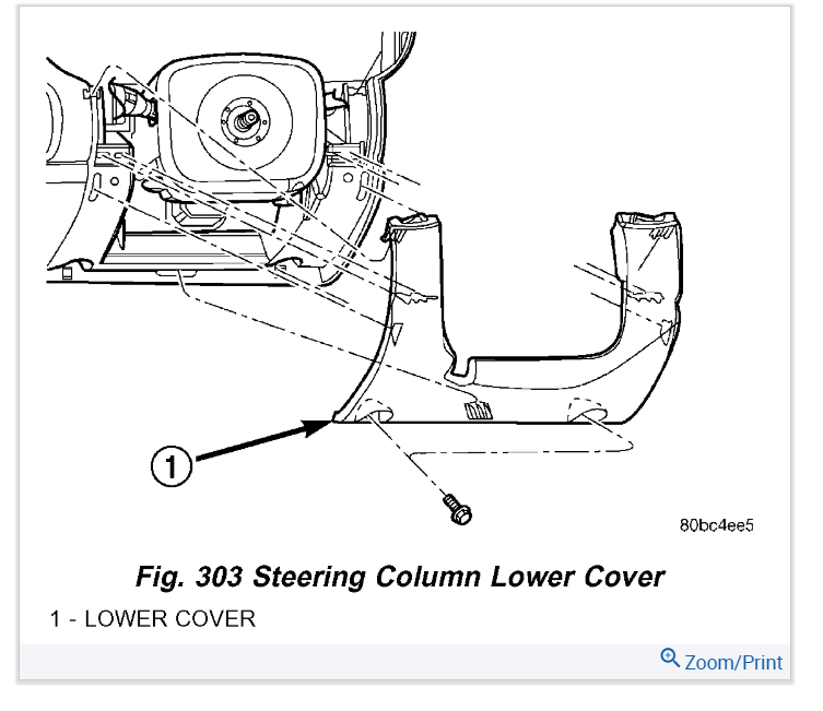

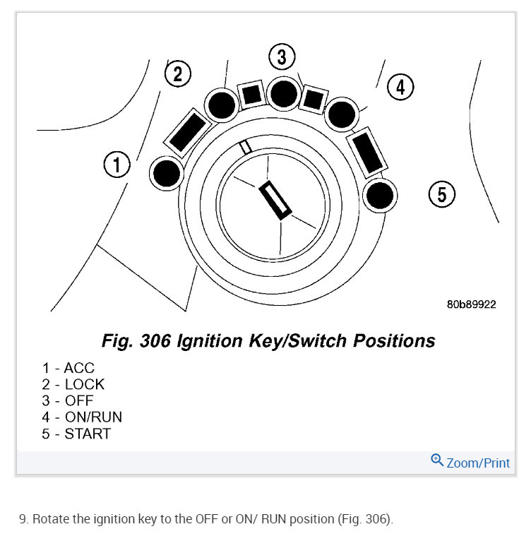

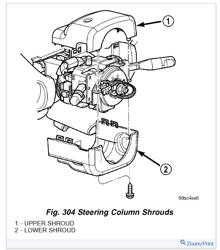

There is an interlock shift cable that sound like it broke or came out of adjustment. Here are diagrams below to help you see what to do to remove tor adjust the cable.
