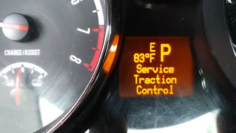

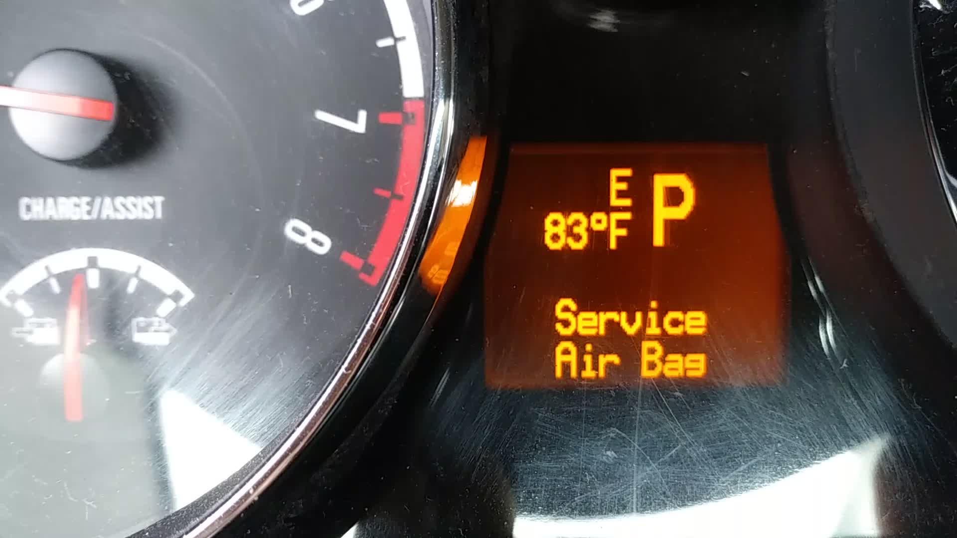

GINO09
  • 11 POSTS
Here is my dashboard dimming, you have stare at it to see it, thanks.
Mar 25, 2019 at 6:51 AM
STEVE W.
  • 15,295 POSTS
That is a power regulation issue. Not caused by the battery itself, but it can damage a battery if it continues. Plus it is still happening after the battery was changed. A scan tool that shows live data would allow you to look at the charging system and see if it is an issue on the 12 or 36 volt side of the system as they are somewhat interconnected.
