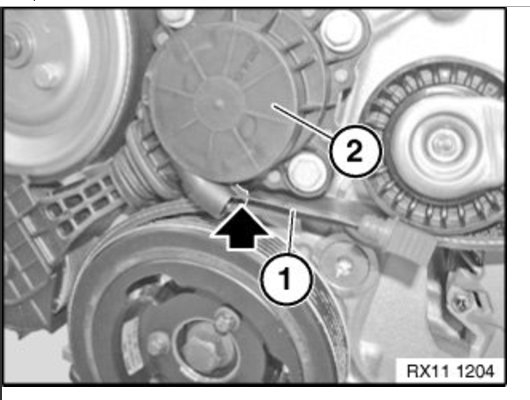

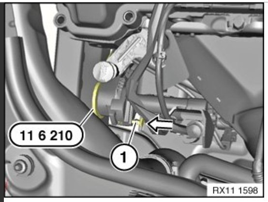

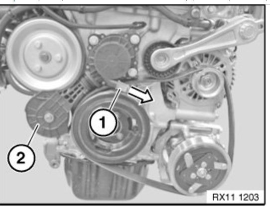

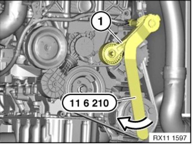

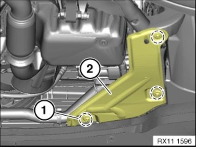

How do I replace my serpentine belt on my car?
Jun 21, 2017 at 6:44 AM
  • 55,433 POSTS
Its not to bad replacing the serpentine belt on your car, here is a guide that will show you what you are in for when doing the job.
Here are some diagrams on what its like on your car. (below)
It says you need a special tool but it looks like a 1/2 inch ratchet will work.
