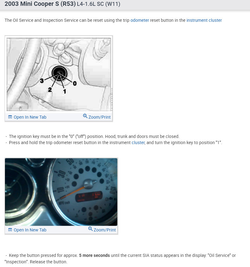

How do I reset the oil change count down meter after I have changed the synthetic oil?
Sep 23, 2009 at 10:19 PM
SQM
  • 6,383 POSTS

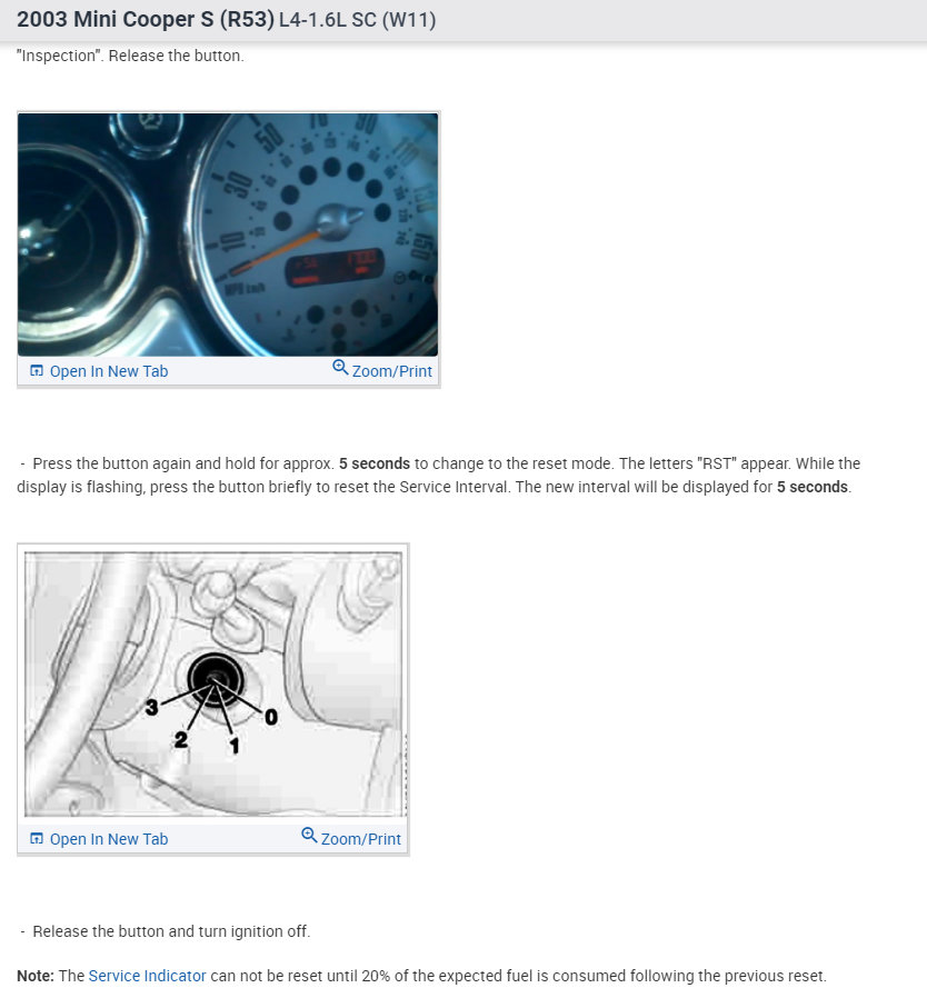

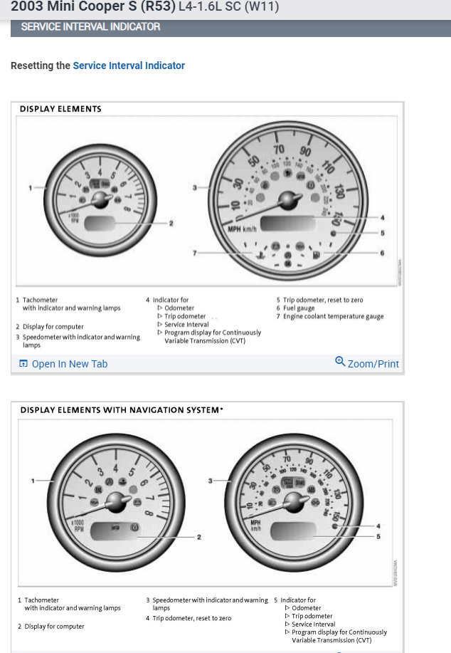

Follow these steps to reset the oil change/service light:
With the ignition to the off position, press and hold the trip odometer reset button in the instrument cluster, turn the key to the 1 position (while keeping the button pressed).
Keep the button pressed for 5 more seconds.
The current SIA status will appear on the display.
Press the button and hold for 5 more seconds to ender the reset mode.
The letters RST will appear.
With the display flashing press the button to reset the service interval.
Release the button and turn ignition off.
