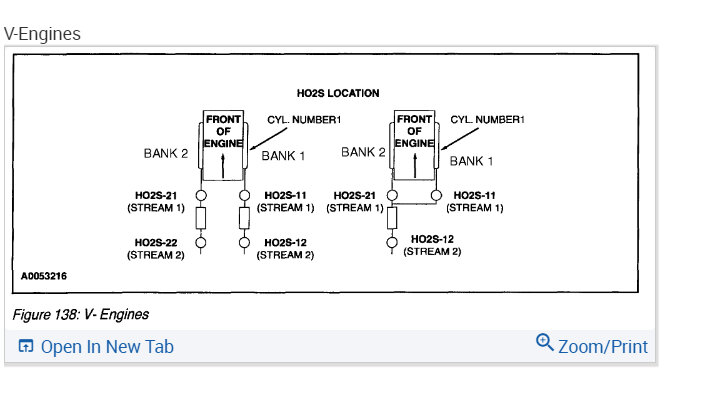

I am having a hard time figuring out were the bank 1 sensor 2 is located. I need to change the oxygen sensor.
Mar 1, 2018 at 12:31 AM
Good afternoon.

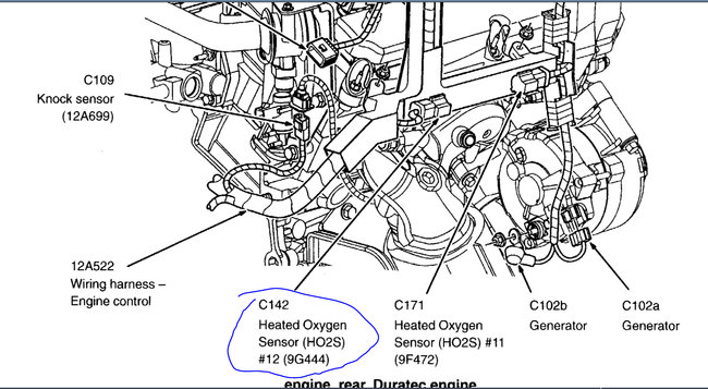

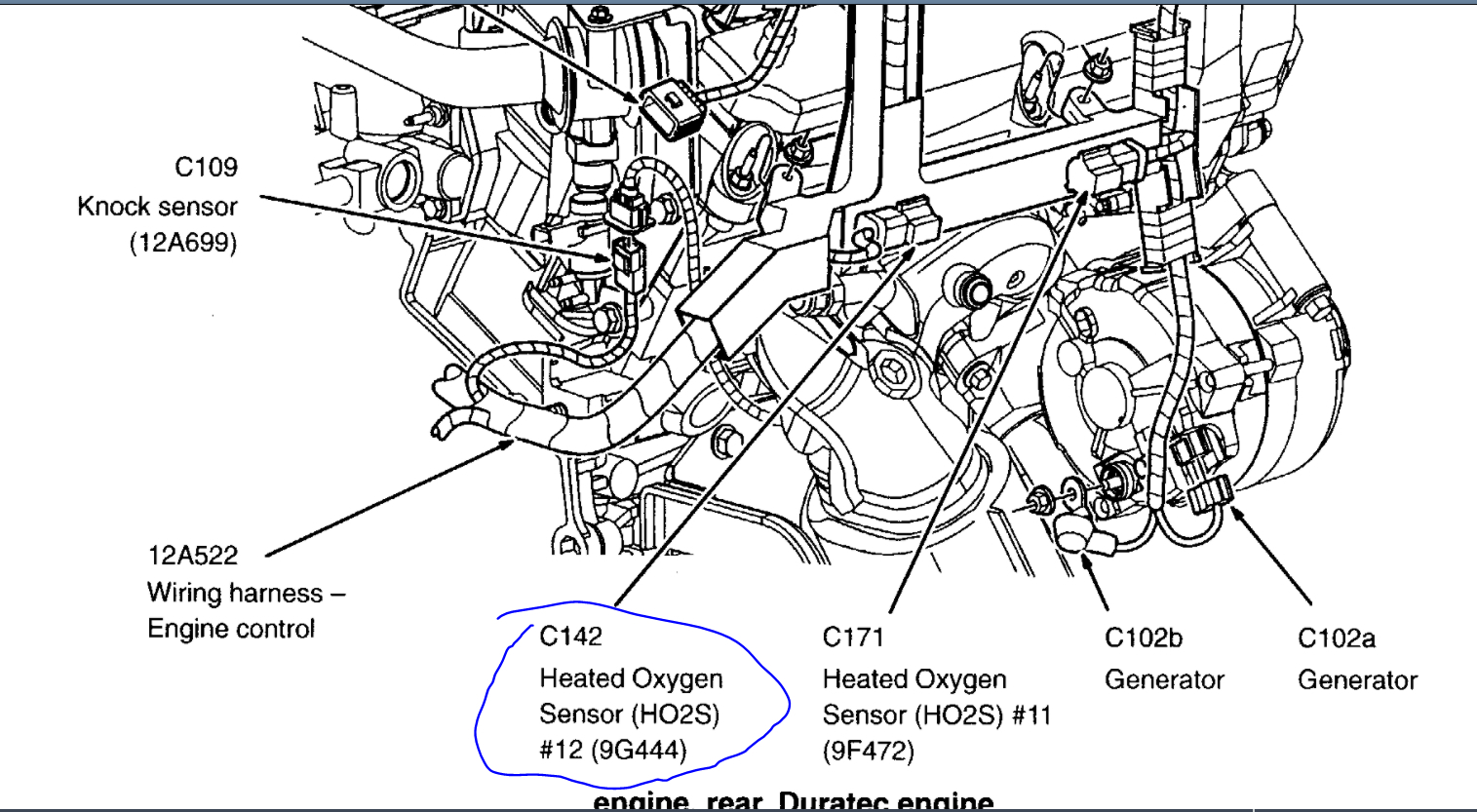

The passenger side of the engine is bank 1. Sensor 2 is the O2 sensor after the catalytic converter.
Check out the images (Below)

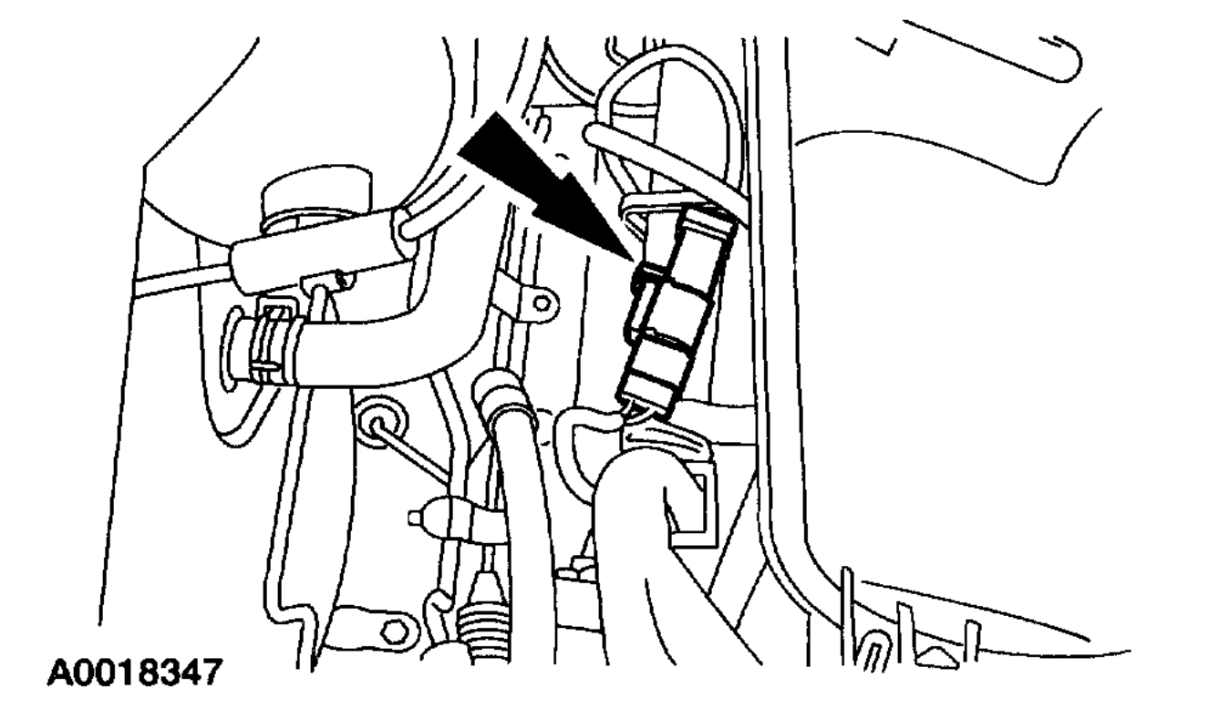

Attached is the procedure for you to view. I also added some pictures of the sensor location.

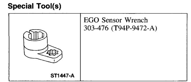

SPECIAL TOOL(S)
REMOVAL
1. Disconnect the Heated Oxygen Sensor (HO2S) electrical connector.
2. Raise and support the vehicle.

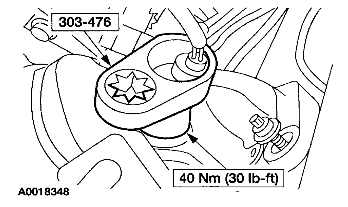

3. Using the special tool, remove the HO2S.
NOTE: If necessary, lubricate the HO2S with Penetrating and Lock Lubricant E8AZ-19A501-B or equivalent to aid in removal.
INSTALLATION
1. To install, reverse the removal procedure.
NOTE: Apply a light coat of High Temperature Nickel Anti-Seize Lubricant F6AZ-9L494-AA or equivalent meeting Ford specification ESE-M12A4-A to the threads of the HO2S to aid in installation.
