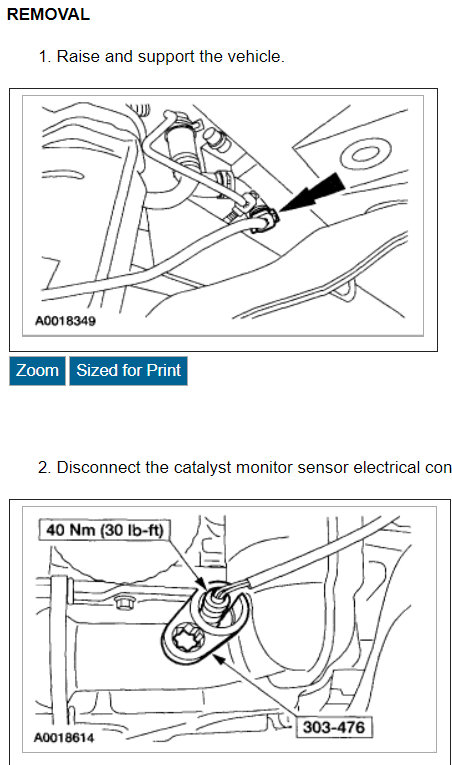

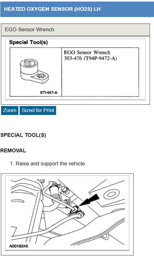

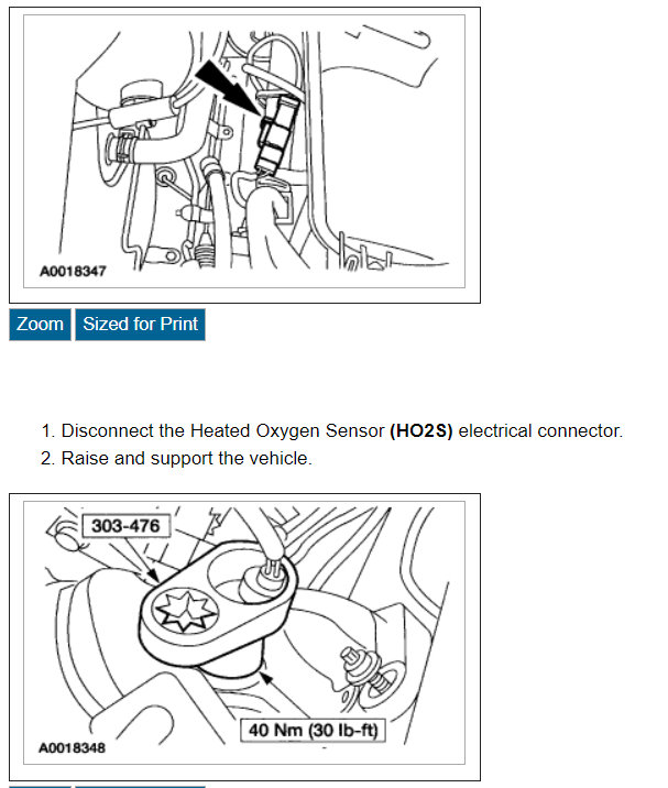

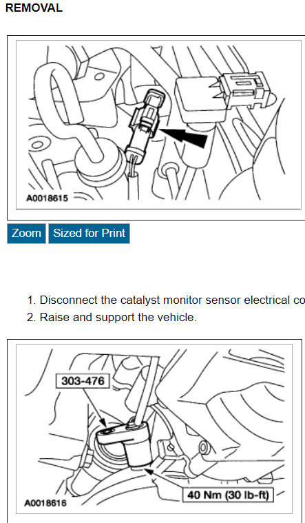

Where is "Bank 2 Sensor 1" (O2 sensor) on my 2001 ford escape V6?
Feb 8, 2009 at 2:15 AM
OBXAUTOMEDIC
  • 3,711 POSTS
Here is a guide that will help you replace the oxygen sensor in your car. The number one cylinder which is bank one is the left side of the engine if you are looking straight onto it. (right side of engine)
https://www.2carpros.com/articles/how-to-replace-an-oxygen-sensor
You may need to jack the car up.
Here are the locations to all of the o2 sensors
Cheers

Which sensor are you looking for and why? Do you have a code or something? The sensor is rarely at fault.
Read the guide below on oxygen sensor replacement..
Most of the time the oxygen sensor codes are consequential of other issues.. vacuum leaks are a big one
The upstream sensors are located in the exhaust before the catalytic converters... the downstream are after the cats
Just because they are inexpensive, don't just throw parts at the vehicle, it may not fix it

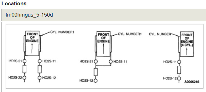

Received code 1130 from mechanic. Came up catalytic exhaust performing below threshold. Saying bank 2 sensor bad. Where is this and does this mean a catalytic converter is bad or just the sensor?
Oct 26, 2018 at 11:23 AM (Merged)
CARADIODOC
  • 34,380 POSTS
Fault codes never say a part is bad or needs to be replaced. They only indicate the circuit or system that needs further diagnosis. While it's true you will find the sensor in question to be defective about 50 percent of the time, there are a lot of other possible causes for codes to set.
Bank two is on the passenger side. Most systems have an upstream, (closest to the engine), and a downstream, (behind the catalytic converter) oxygen sensor on each bank. The downstream one is just for monitoring the efficiency of the converter.
The code description I have is more informative.
P1130 – Lack Of HO2S-11, Fuel Trim At Limit.
It suggests the Engine Computer is trying to correct the fuel / air mixture and doesn't have enough adjustment capability to reach the correct ratio. That suggests the oxygen sensor is not defective; it's just reporting what it sees.

I have a trouble code P0136 on my daughters 2003 Ford Escape 3.0L. O'Reilly's said "Downstream Heated Oxygen Sensor HO2S 12 Circuit Malfunction Bank 1. Where is Bank 1, by firewall or radiator? Also want to check wire from HO2S to PCM connector to make sure it is OK. Which pin on PCM is it and what is color code of wire? Could you give me the Pinout chart for this model? That would be most helpful. Thanks
HMAC300
  • 48,601 POSTS
possible problems are damaged wire or harness, exaust system leak prior to O2, crossed wires, and most likely problem contaminated or faulty O2 sensor. if you have a single exaust it is the senosr behind the converter if you have dual exaust it's the sensor behind right converter. you really sholdn't try messing aroudn with pcm connections nor O2 connections. you will need a scanner to erase the code when you are finished.
