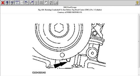

need the timing marks chart
May 19, 2010 at 8:46 AM
  • 110,240 POSTS

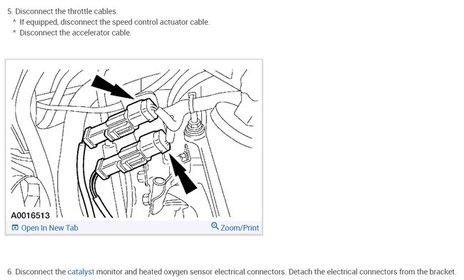

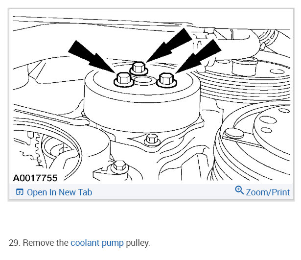

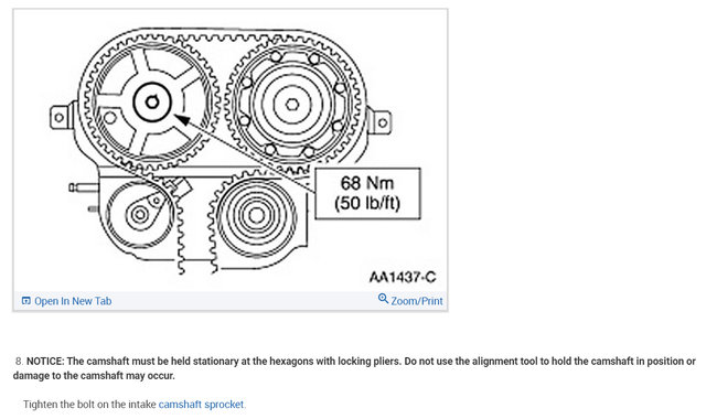

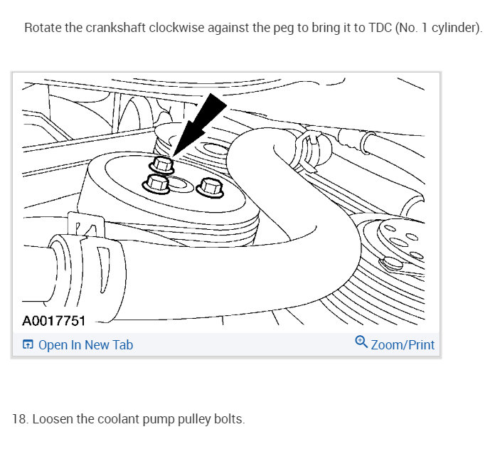

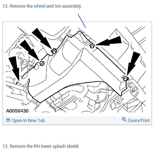

Refer to the timing belt routing diagrams site listed on this page and use the diagrams below.
https://www.2carpros.com/diagrams/ford/escape/2002
Check out the diagrams (Below). Please let us know if you need anything else to get the problem fixed. Joe

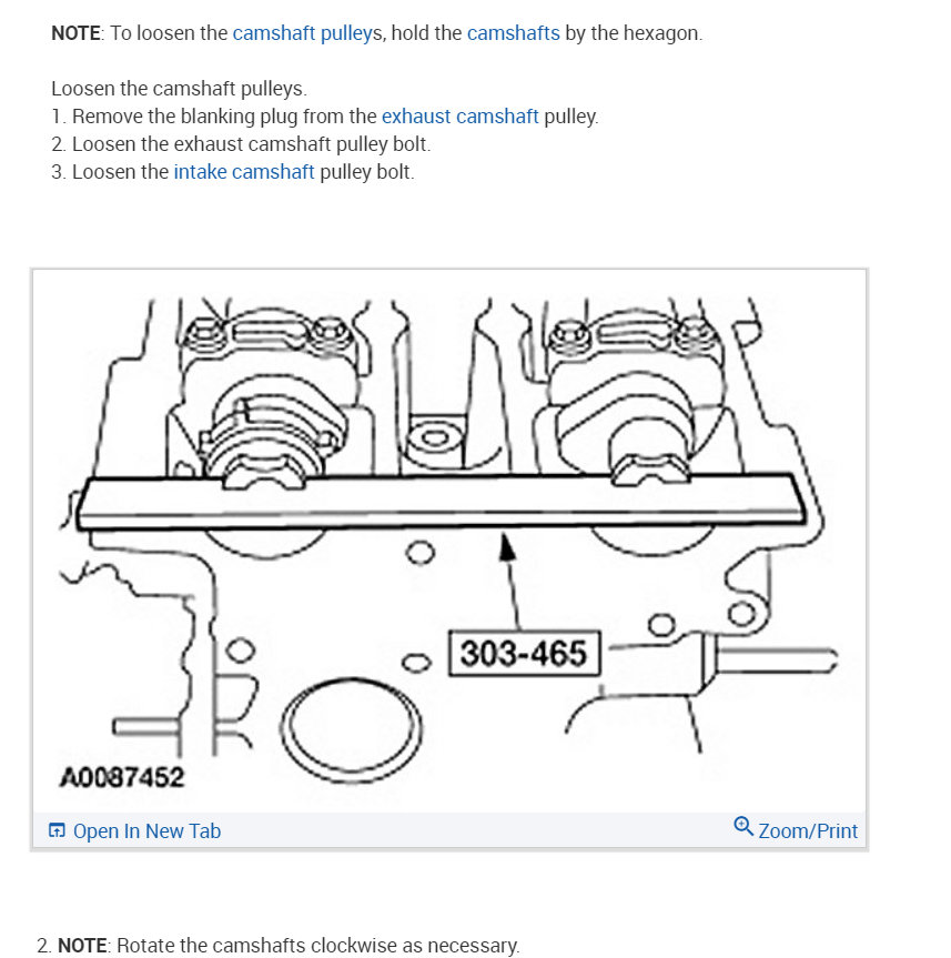

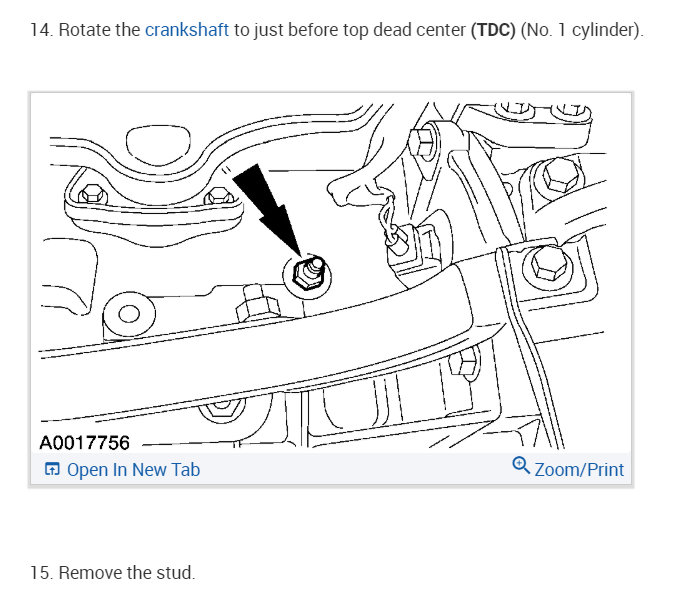

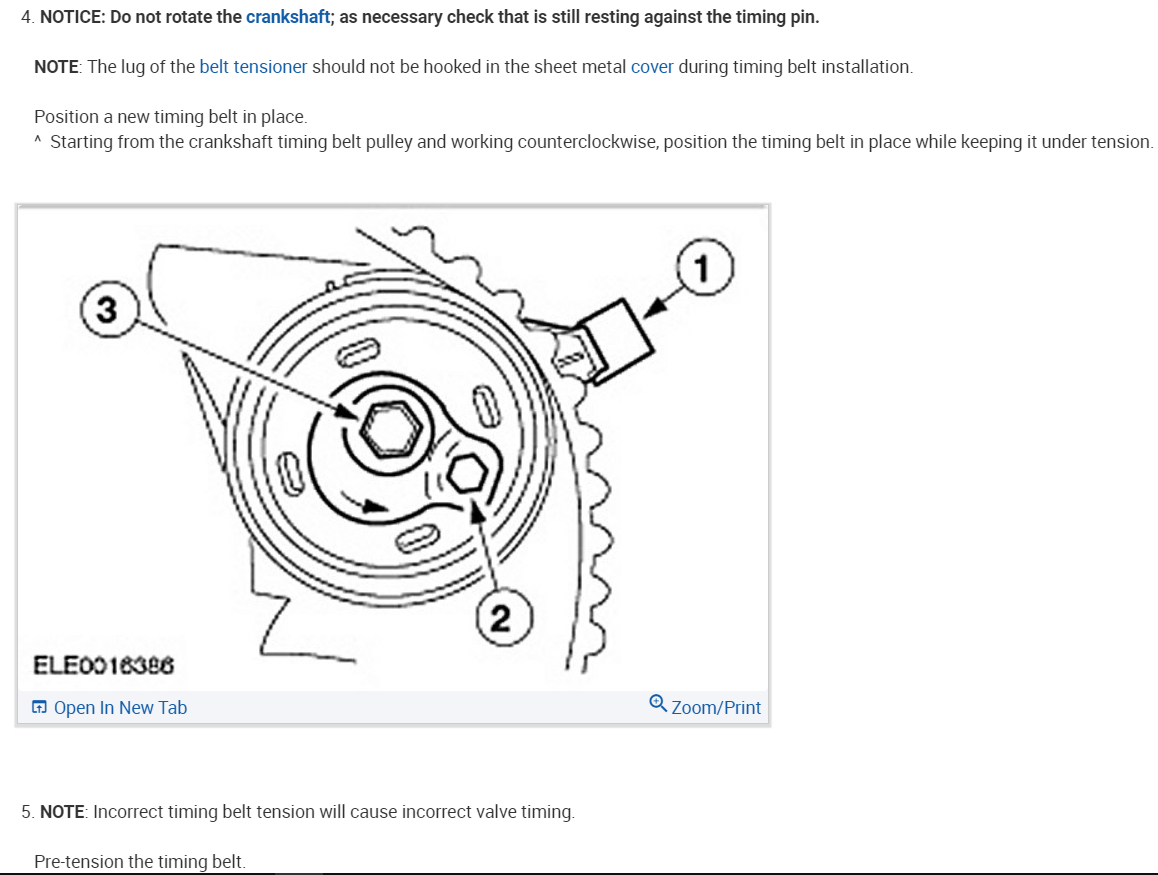

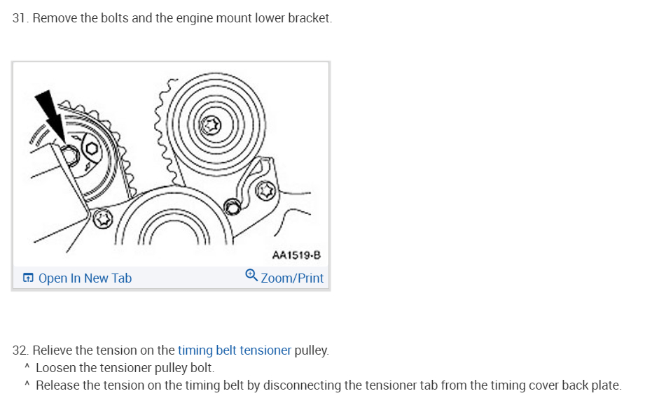

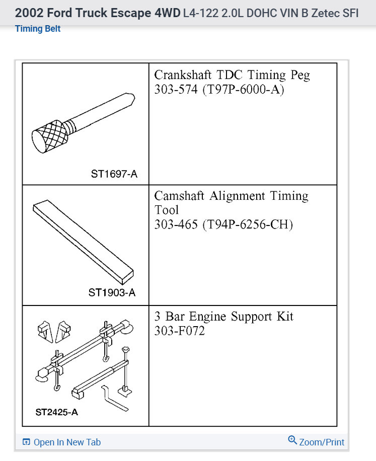

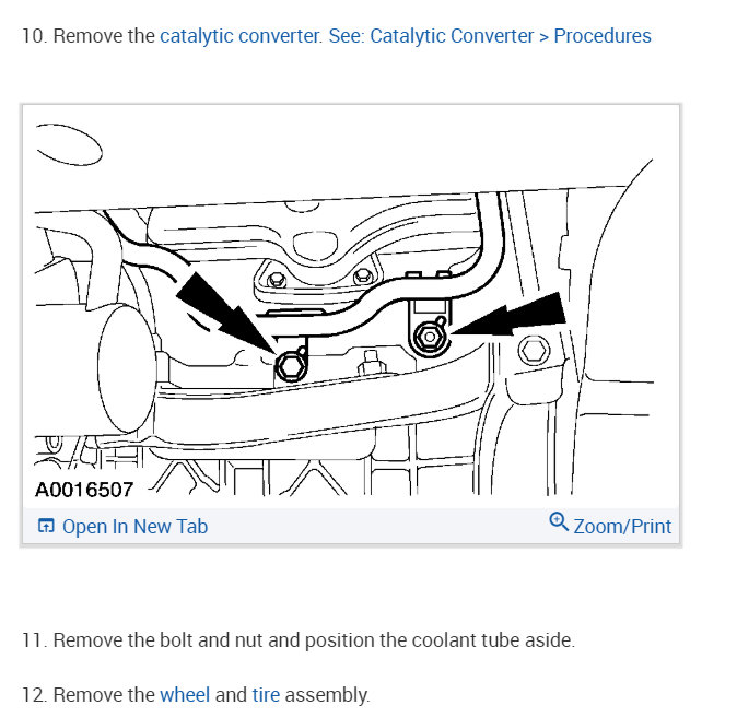

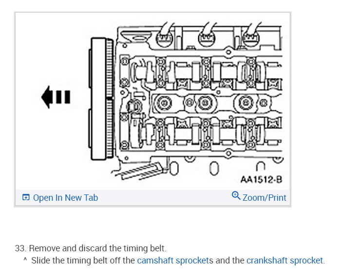

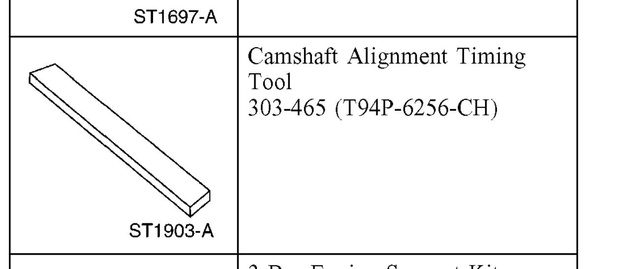

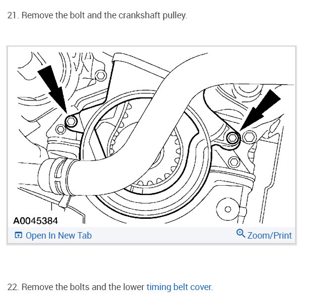

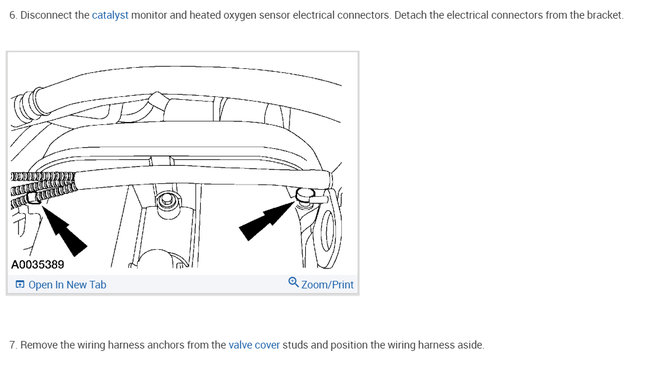

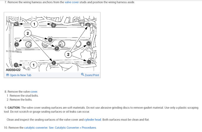

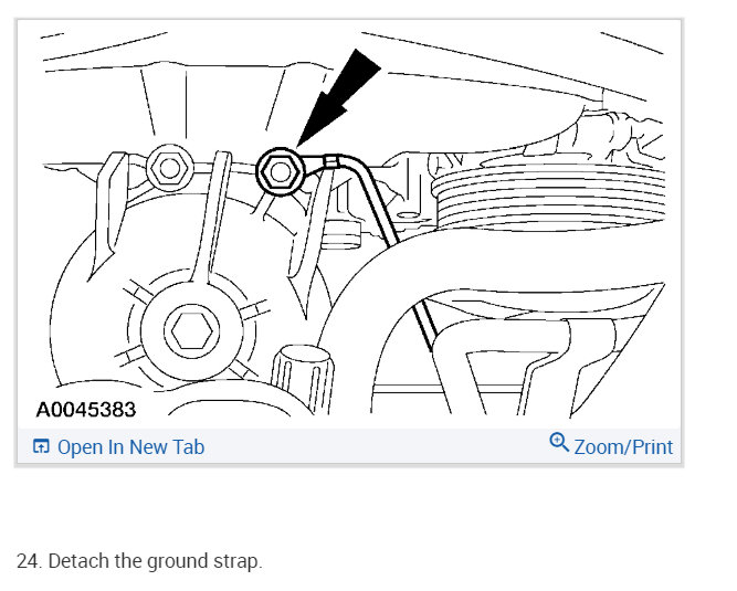

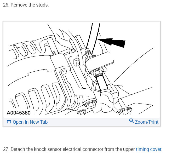

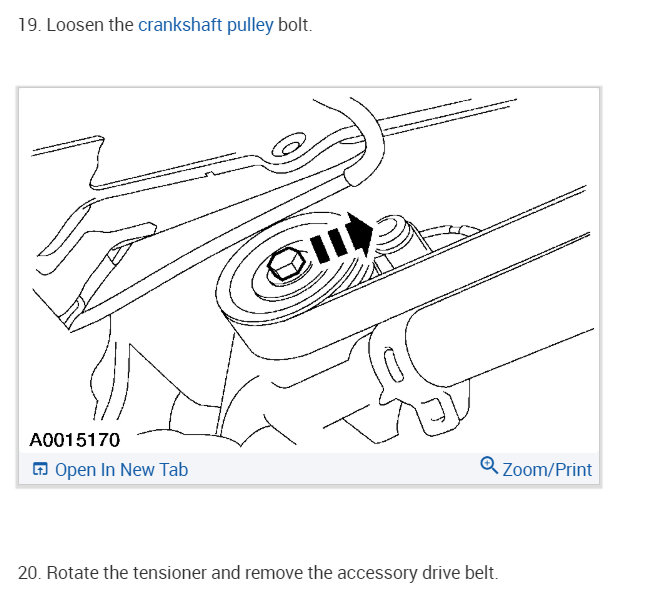

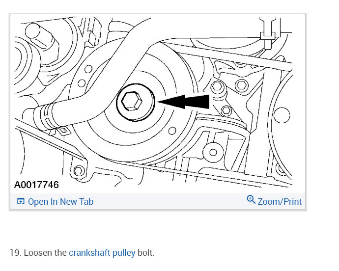

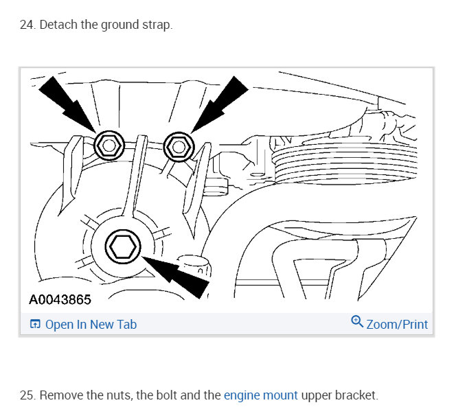

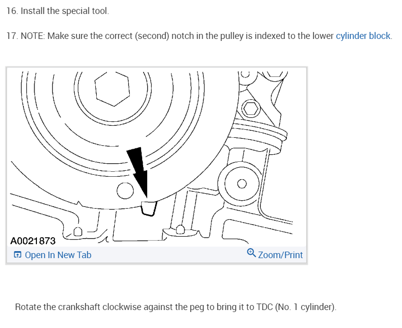

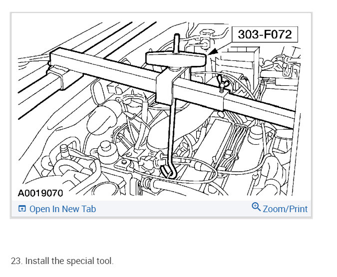

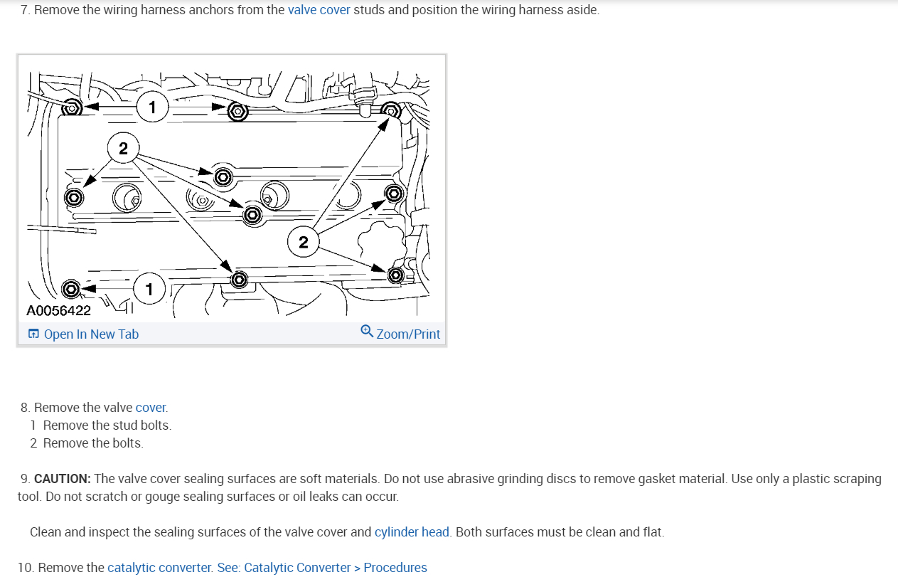

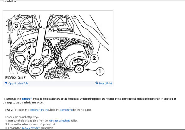

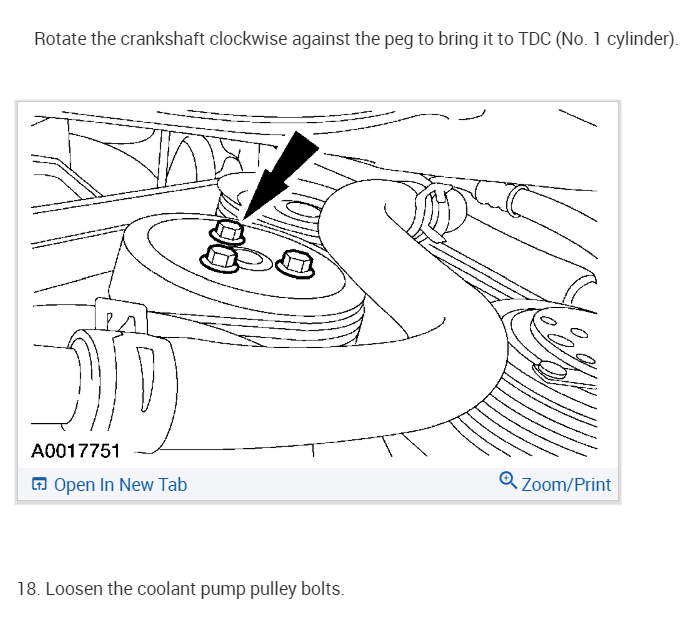

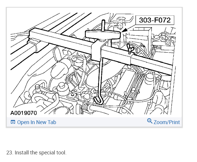

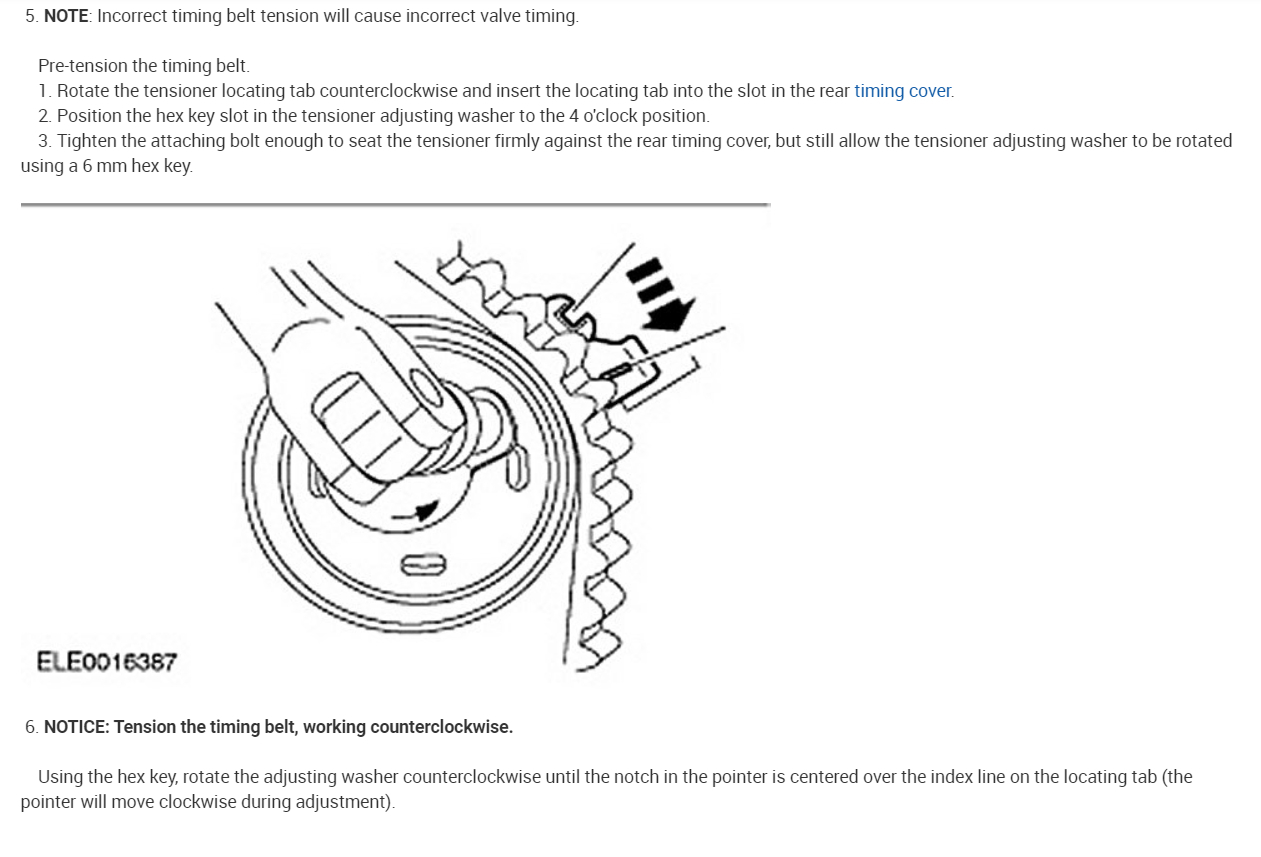

2002 Ford Escape 4 cyl Two Wheel Drive Manual

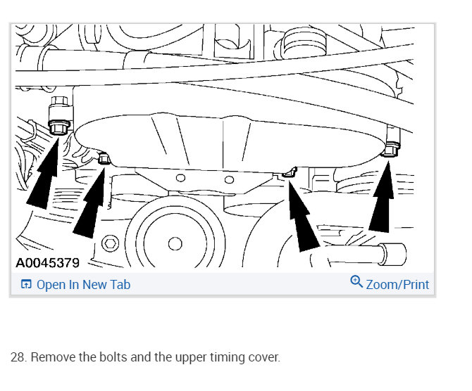

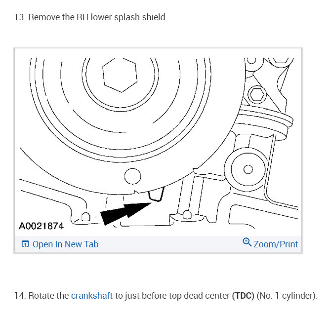

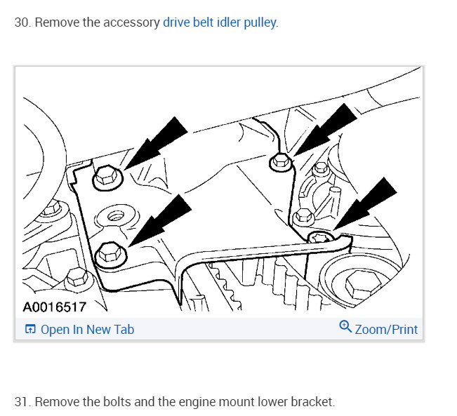

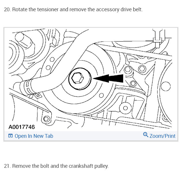

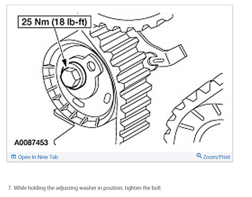

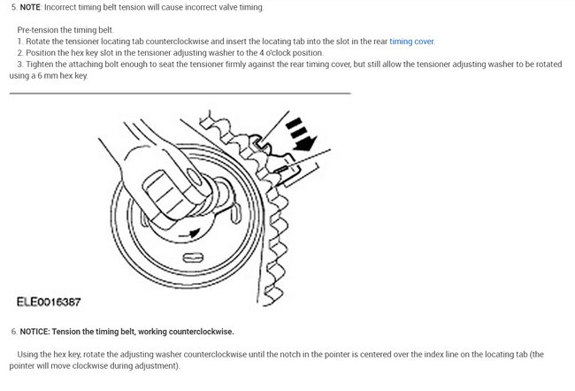

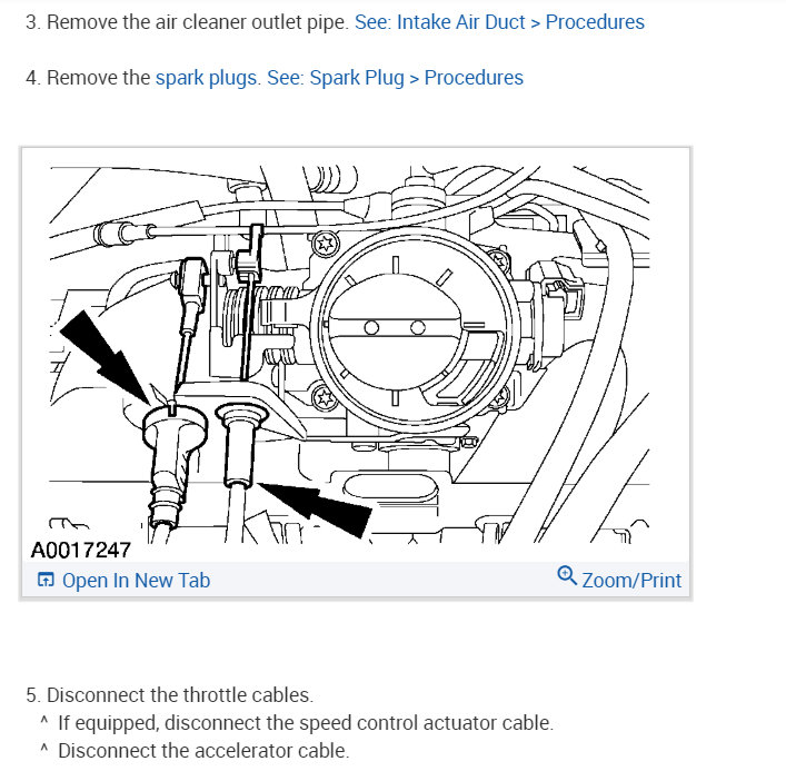

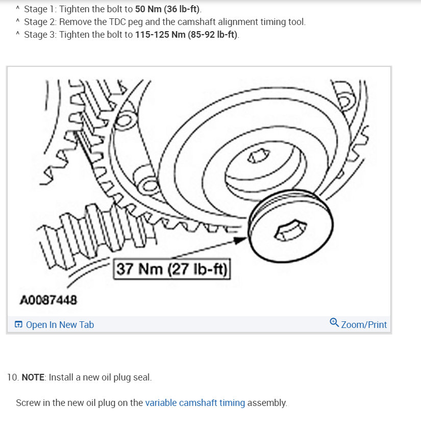

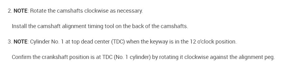

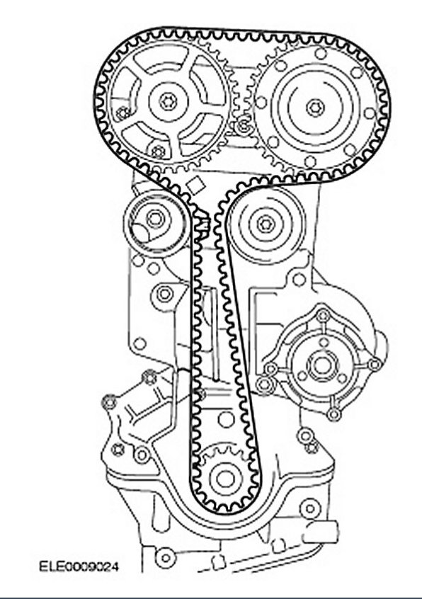

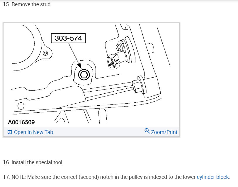

where do i find the timing mark on this 2.0L dohc for installing the timing belt
Apr 22, 2019 at 10:58 AM (Merged)
BMRFIXIT
  • 19,053 POSTS
find all you need at this link if need more let me know also u need this tool
https://images.2carpros.com/forum/automotive_pictures/99387_Untitled1_8.jpg
  • 75,992 POSTS
https://images.2carpros.com/forum/automotive_pictures/12900_timing_22.jpg
