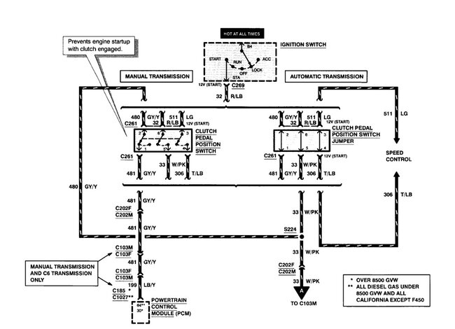

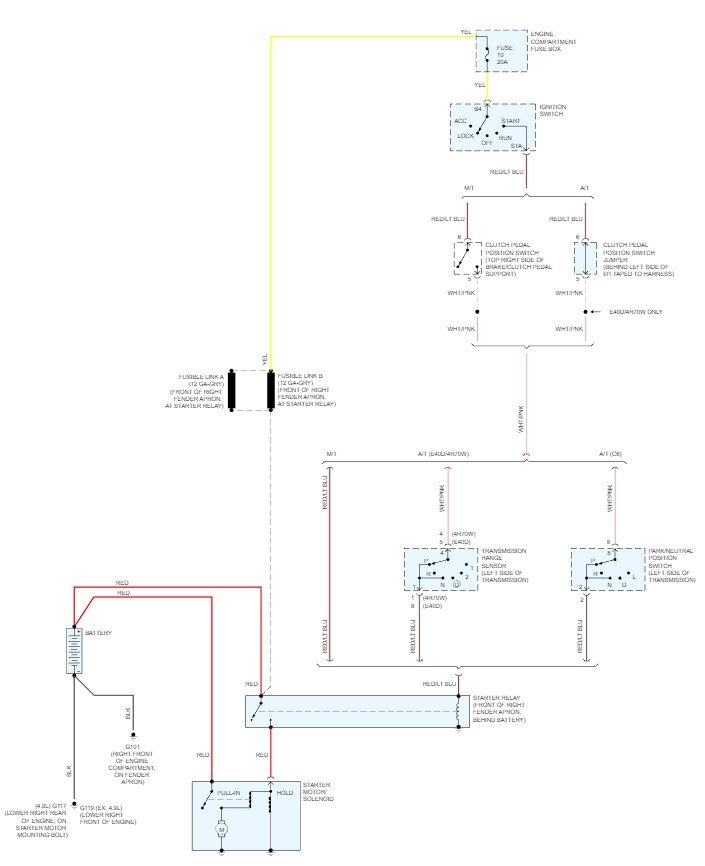

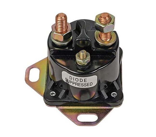

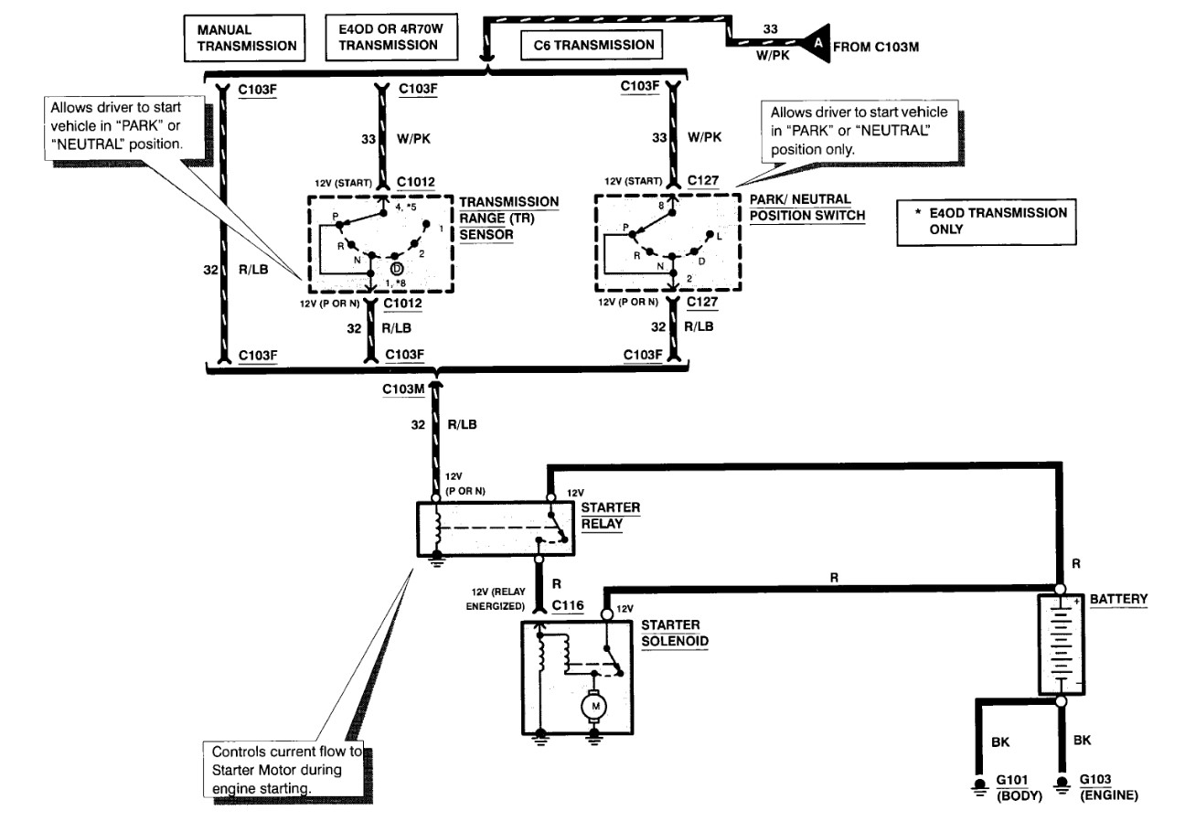

The 1996 didn't have a starter disable relay, so if you turn the key and hear nothing it isn't the PATS system preventing it from starting. From the description it sounds like the starter relay or the switch not sending the start signal. The relay is on the right inner fender and looks like the last picture. It has to be grounded to the fender and the small terminal is the one that gets voltage from the ignition switch. To test if it's the relay is simple. Make sure the truck is in park, now take a piece of wire and jump from the battery feed on the relay to the small screw terminal. If the starter engages and the engine turns over the relay, battery and starter are good. If nothing happens or you only hear a click and no starter, then the relay is likely the problem. A way to test the rest of the parts is to use a solid piece of metal across the two large terminals. If the starter now turns but the relay didn't trigger it, the relay is bad.

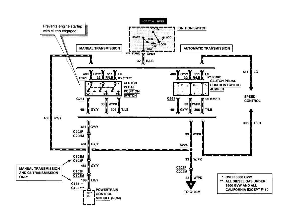

Now if testing here shows that the relay and the rest are good then we need to test the wiring from the relay back to the ignition switch. There are a couple of interlock switches in the circuit that can stop the starter from cranking. What type they are depends on if it's an automatic or a standard shift. On an auto it would be the park neutral switch, on a manual it would be the clutch interlock switch. The attached wiring diagrams show the wires that control the starting system. Testing them is simple, for all of the various switches you can just use a jumper wire to bypass the switches. So, if you bypass the park neutral switch and it now starts, the PN switch is bad. Same with the other interlock switches.
