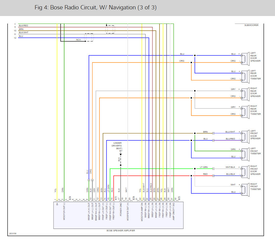

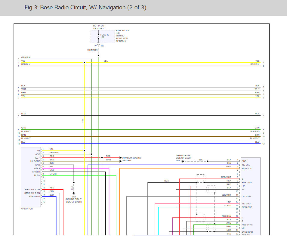

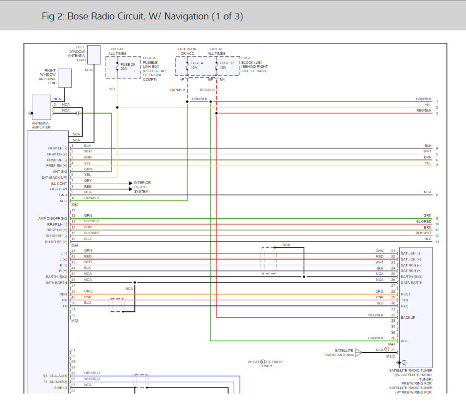

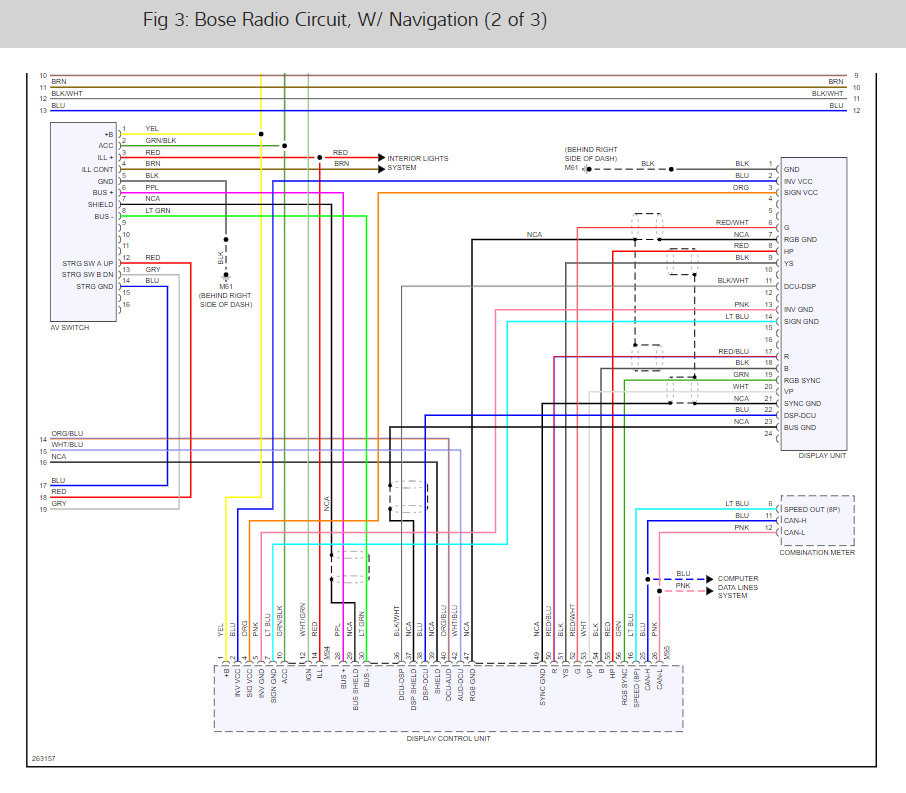

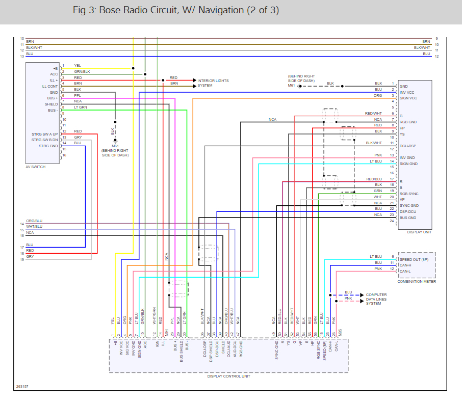

My screen is blank on my vehicle. I have checked all fuses and all are fine. There is power to the plug for screen at the bottom left of plug, but nothing at all happening. Have tried another screen but no luck. The CD part still tries to load CD but that's all.
Nov 14, 2019 at 8:00 PM
  • 55,402 POSTS

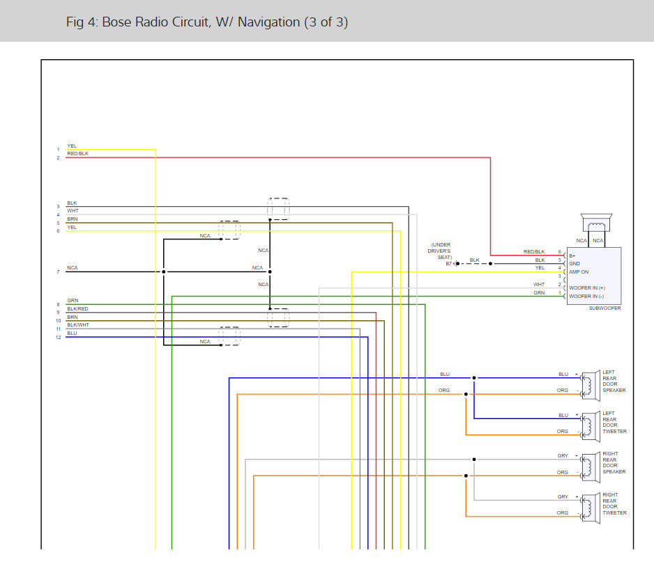

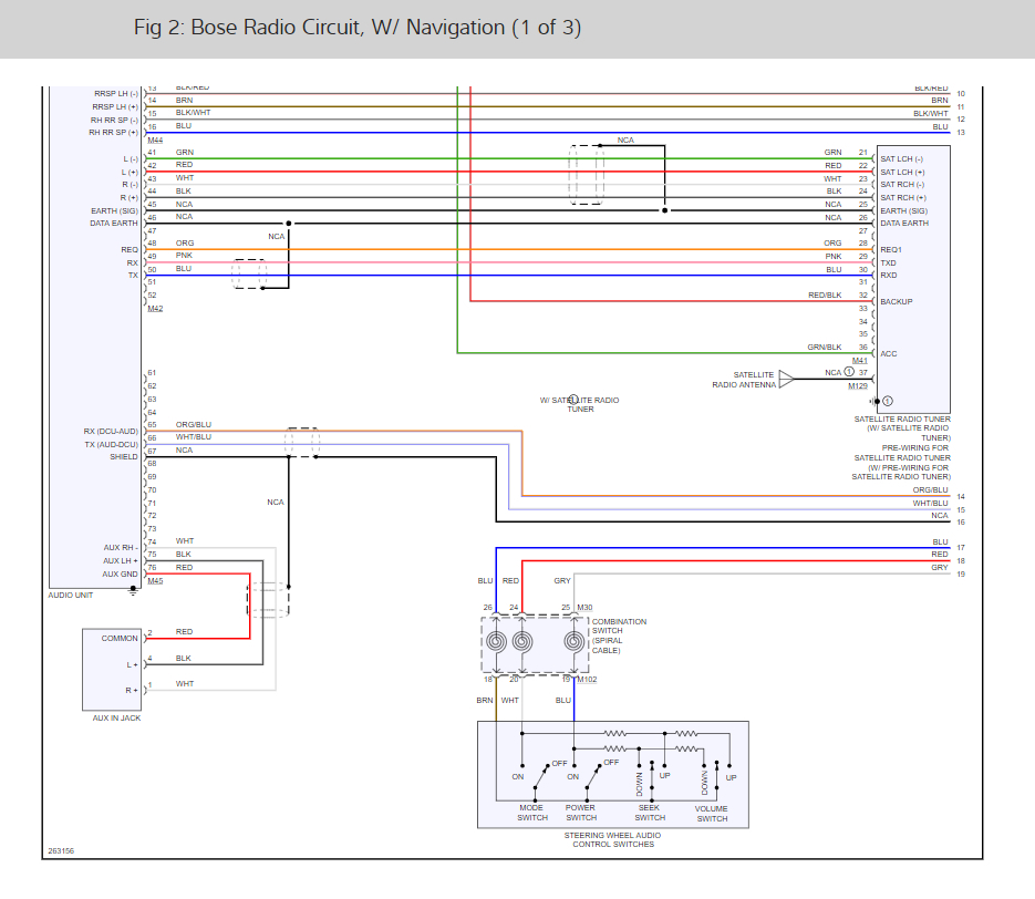

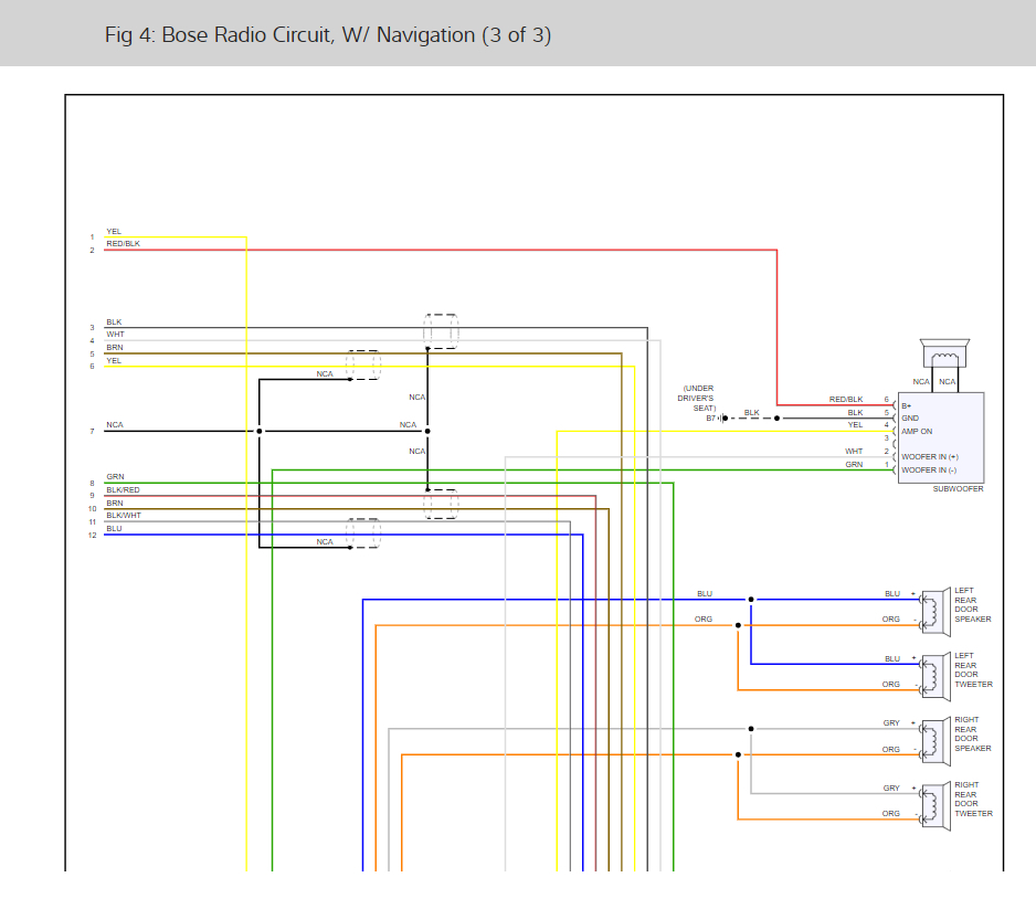

It sounds like the radio has gone out. To be sure here is a guide to help you check for power and grounds using the radio wiring diagrams below I have also included a video to show you how to replace it with an aftermarket unit: (done in a similar car)
and
