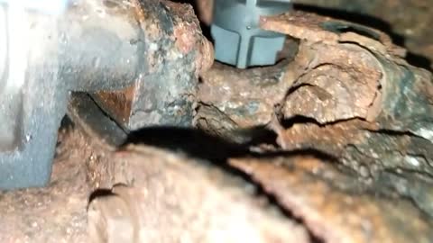

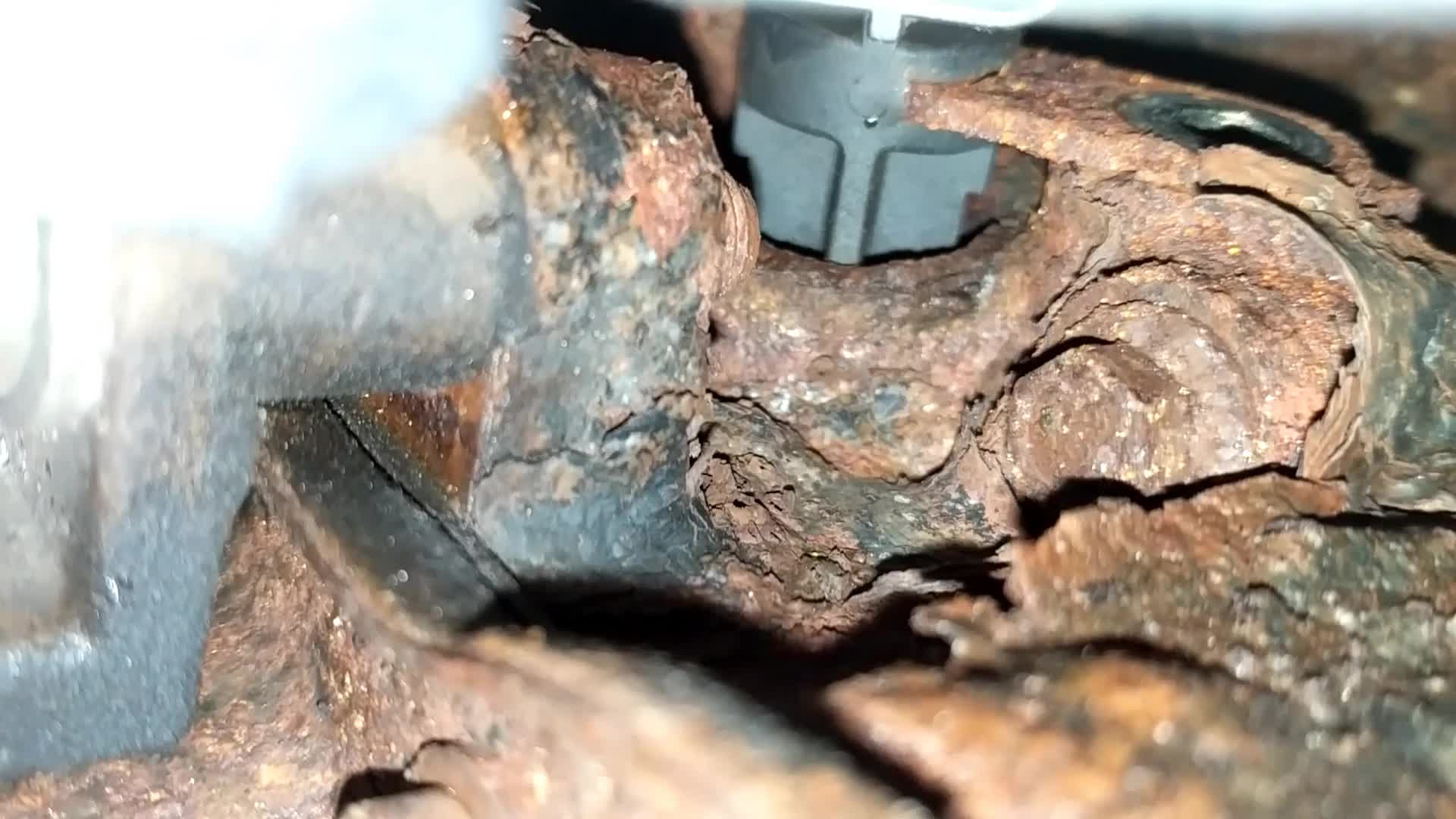

On my long list of repairs needed before I can go home, I am starting with this crankshaft sensor since I have it already.
Bolt came out easily, unclamped easily from the wiring connector as well. But, its oddly rusted on the limb that is held by the bolt.
I have PB Blaster and WD40, but I don't want to spray there if it's going to mess with electrical components.
What can I do?
Thank you guys.

If you are going to replace the Crankshaft Position Sensor [CKP], then I wouldn't worry about hurting the old one. Keep the electrical connector away from the PB Blaster and douse where it is rusted at.The main thing that you want to preserve are the threads in the bolt hole. The CKP, once free from the rust, should just pull out, it's the bolt, obviously, that secures it in place. Please get back to us with how everything turns out.

I have been working on it for about a week with PB Blaster and a set of pliers. I got it twisting and rocking slightly, but the black plastic is still really stuck in there. Any tips or tricks? I need to get this thing out. And yes, my car is currently broken down and this is a code I am getting. I just want to go back home.

The o-rings can get really stuck in there. I've used a few things to get them out over the years. What is the code you are getting? I have seen a bad cam position sensor trigger a false crankshaft code before on them. How did you test the sensor?
As for getting them out, I've used heat on the block to bake the o-ring and melt the outer case of the sensor enough it comes free. I've also sprayed lithium grease in there and pried on the parts outside the block. I've even got ticked off and smashed the outer part off so I could get into the hole and clean the rust out. To do that requires that you drill a hole into the sensor and put a long screw into it, then cut or smash the outer part off and go after the rust. I've also known of folks who just snapped them off, then dug them out with a die grinder.
Where are you stuck?

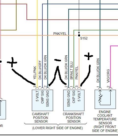

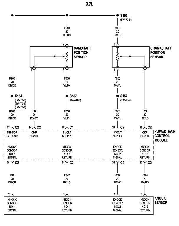

So I tested the wiring that goes into my crankshaft sensor and got a voltage of 3.5. Does that mean my wiring is okay?

3.5 is very low. That could be the entire problem. You should be able to measure 5 volts or very close to it. Measure between the Dark Blue wire with a Dark Green trace and the Pink with Yellow trace wire with the key on. You want to see 5 volts. Then go to the cam sensor and check between the Dk Blue w green trace and the Yellow wire with pink trace That should also show 5 volts. If not you have a problem. The Dk Blue wgreen wire is the ground side, the others are 5 volt reference feeds from two different connection pins. The other wire on each sensor is the signal output. If you find 5 volts at the cam sensor but still 3.5 at the crank sensor, take the negative probe and put it on the negative battery terminal and then measure the crank signal voltage again. If it's still 3.5 then the ground side is OK and the problem is on the feed side.

As far as the wiring, It would depend on what it actually is. If you measured the voltages and found one is 5 volts and one is 3.5 then it may be just a corroded connection at the PCM. Or it may be internal to the PCM. That was one reason I wanted you to measure them both and to ground as well.

Still struggling over here with my sensor! I got my hands on a nice scanner tool, my buddy let me borrow it. It's a CPR 123. I used the scan tool on the Chrysler setting and tested the Cam Crank difference with the car running. It was jumping between 3.8 and 4.2 ish and it jumped to 4.6 when I revved the engine. Does that sound good? My father said he's confident it's the sensor. Because it is an intermittent code, he said he is confident it's the sensor stalling out on me. I know you're confident it's a wiring issue, what does that difference value mean to you?
I know I told you I got a 3.5 V reading on the connector and you said that it was low, but maybe it was inaccurate? Curious to hear your input on this, and this CPR 123 is new to me. I see a few other cam / crank options to test. Let me know if anything else would be useful to test. Thanks!

Intermittent codes can be wiring or part, that is why you test both. In this case I would say it's the wiring simply because of the readings you are getting and it being a Jeep that are known for wiring and ground issues. If you think the voltage was wrong, test it again. You should have real close to 5 volts there, low voltage will cause the sensors to work intermittently if they work at all.

You're welcome. Don't give up on removing the sensor though, if you already have it so it will move a bit it would be a good idea to remove it, clean out the hole and replace it just because the poking and prodding may have caused a glue seam or seal to break loose. Beyond that keep us informed of what you find.

So I finally got it out, and then got the new one in. I lubed it well with oil and I got some sand paper and smoother out the rust in the hole as well.

You said you smoothed out the rust, Did you chip away the thicker rust that was under the sensor? If not pull it out, plug the hole and use a chisel or similar to knock the rust off. Then put the sensor back in and see if it will go past 2000 rpm. For the pan you can Heli-coil it, or as the rest of the engine looks that rusted you could try a pair of self-tapping hex bolts in the next size up.
