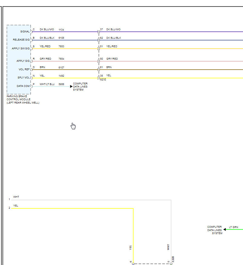

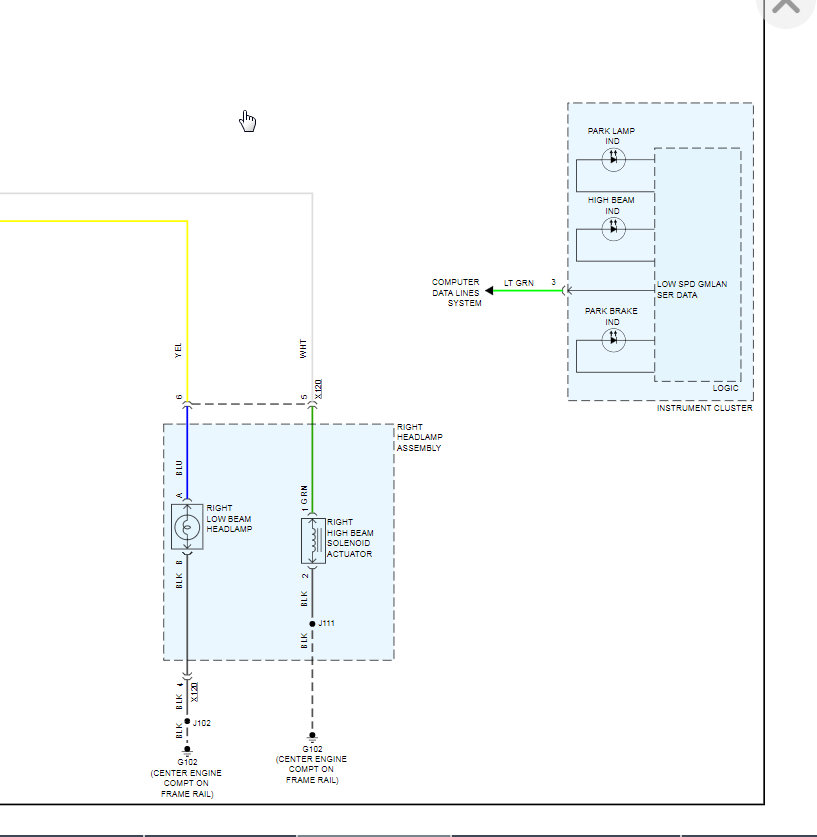

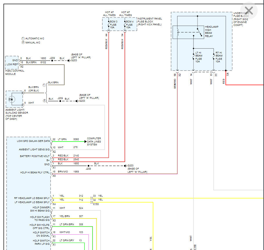

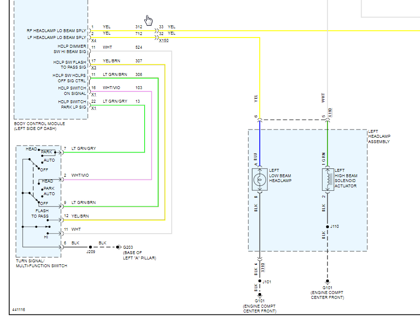

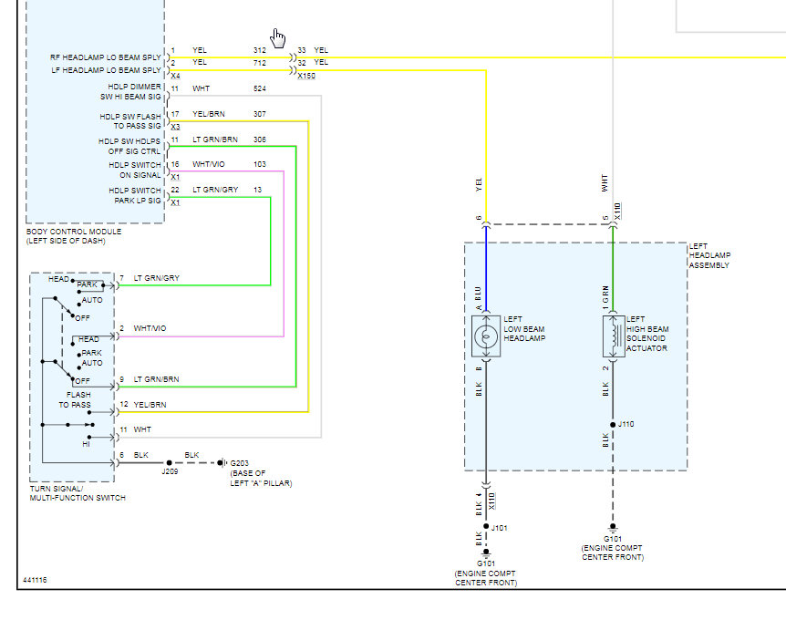

Replaced the bulb and still does not work. Does anybody have wiring schematic so I can troubleshoot this problem?
Mar 3, 2020 at 9:33 AM
Here are the wiring diagrams. I am assuming that you have non HID headlights meaning you have regular halogen bulbs. If you have HID let me know and I will send those diagrams but you said you replaced the bulb and the HID lights normally come as an assembly.
