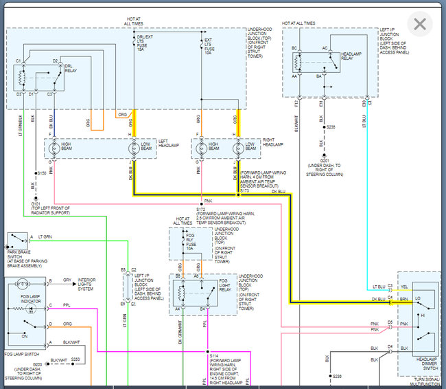

I have an '04 Impala and the low beams stopped working. I have high beams, only when I hold down the dimmer switch. Also, when I use the remote entry to lock/unlock the car I only have reverse lights come on. Is the a relay somewhere or do I need to replace the dimmer switch? Please Help, I work nights and it's losing me $$$$$$$

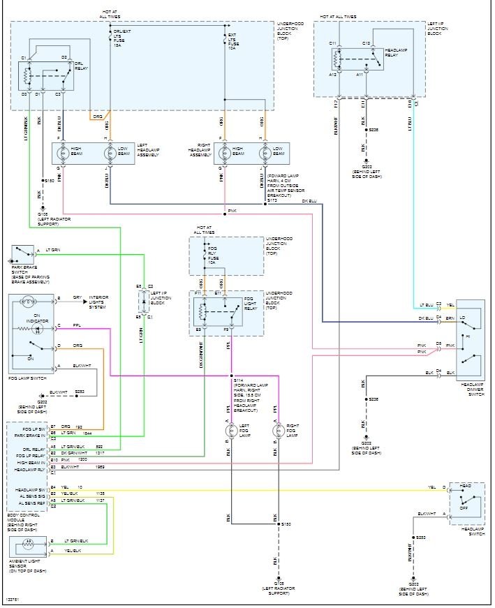

This problem sound like it is a headlight relay has gone out, here is a diagram (BELOW) and a guide to help you get the problem fixed. Also check the system fuses.
and
Please run some tests and get back to us so we can continue helping you.

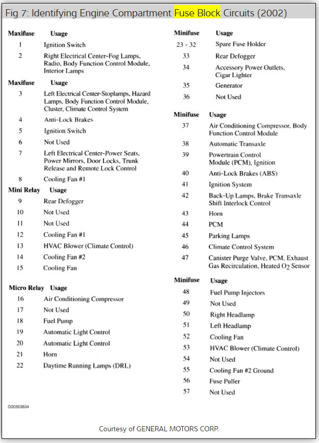

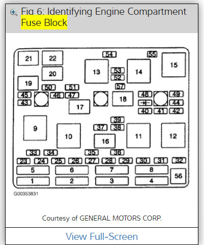

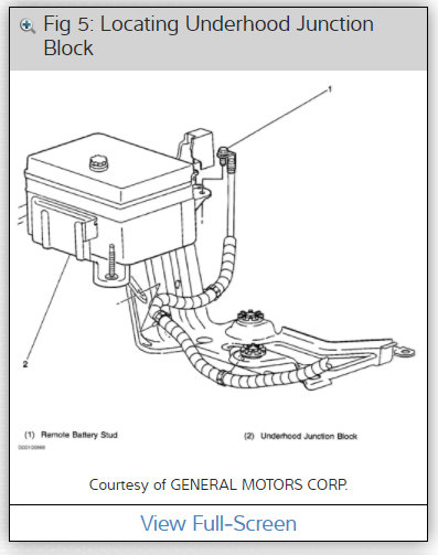

The headlight fuses are in teh underhood fuse box it should be marked on inside cover.

Welcome to the forum, the quickest way, may be to have all trouble codes checked, manufacturer specific, everything. See if the codes point to anything? When you check a fuse, you also need to use a testlite, see if fuse circuit is hot. Even if the fuse is good, if there is no voltage, the circuit is dead.
On and off, bright and dim are controled on the headlamp ground circuit. There is a headlamp relay in the left instrument panel junction block. When the relay is energized, it completes the ground circuit for the headlamp. There is voltage to coil side of relay, not sure if that is battery voltage, didn't track the circuit, use a dmm. The BCM grounds the coil side of relay. The headlamp switch grounds a signal from the BCM, that is how the bcm knows the switch was turned on. Just speaking for myself, without a code or something to point us in the right direction, it's hunt and peck the wiring circuits.

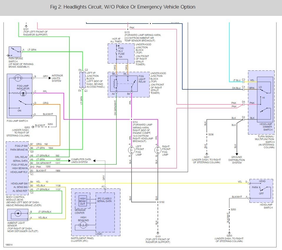

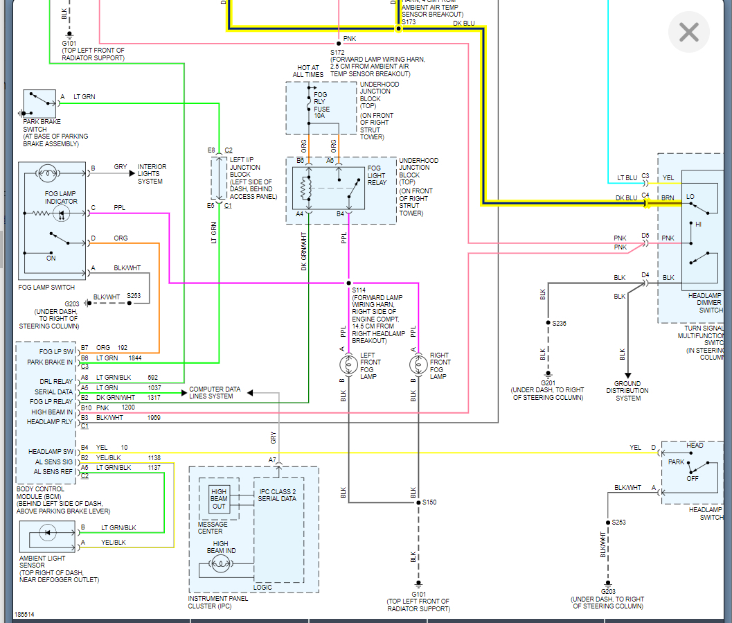

More then likely your issue is the multi function switch because these low beams actually run through this switch as well as the control for the high beams.
We need to check for ground from the lamps as these are all ground side controlled. So basically turn them on and check for ground by putting your meter on battery positive and then touch the ground terminal in the socket.
If the meter shows 12 volts then the switch and ground is good.
However, I suspect you will not find this so we need to then test the switch the same way.
Please see the wiring diagram below that will help with this. However, we need to move past the switch and check the BCM as this is ultimately what grounds the lamps.
Please let us know what you find and what questions you have. Thanks

There is a headlight relay and dimmer switch you can see form the wiring diagrams above.
Here is a guide that help help us go step by step until we have it fixed
and
Relay 19 and 20
Here is the relay location, check out the wiring diagram above lets see where you are loosing power. We can fix this ourselves.

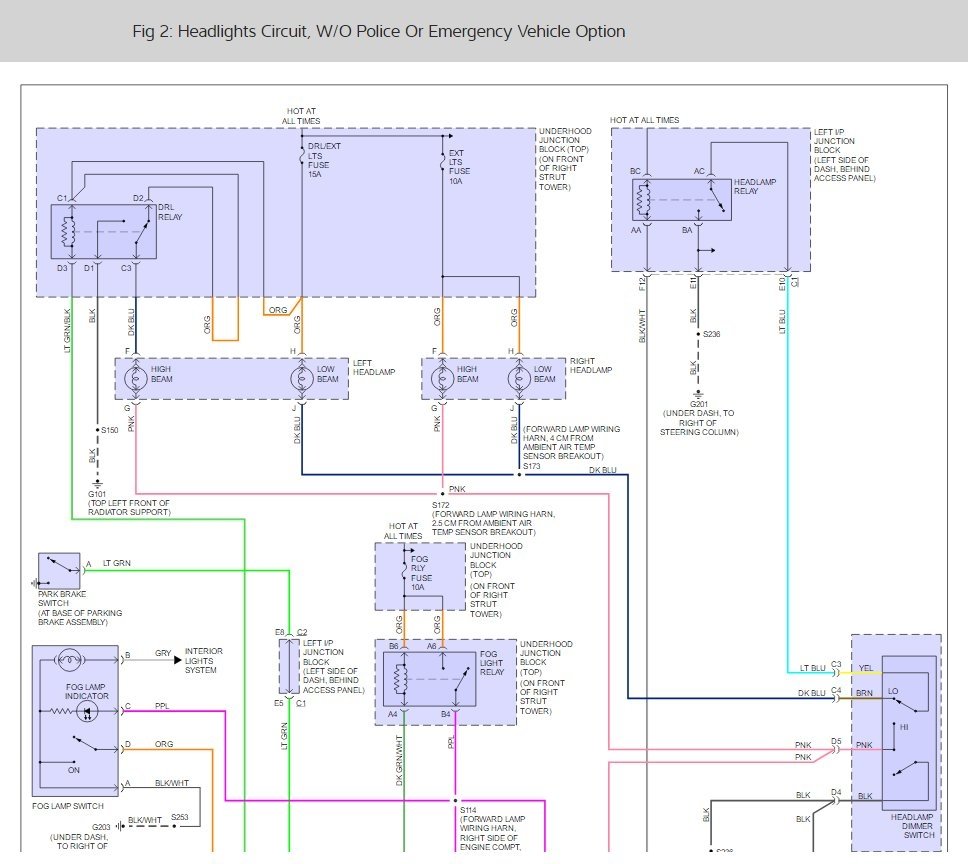

Voltage to the headlamps is hot all the time. On and off, high and low beam is controlled by the headlamp ground circuit. Ground for the low beam is through the headlamp relay. Ground for the high beam is through the dimmer switch. When they decommission these cars they will cut out the light controls for the emergency lights and sometimes they dont get it put back correctly. I have seen this a thousand times with P71 Crown Vics.
Attached below is the wiring diagram for the headlights, be sure everything is hooked up correctly and test the relays to be sure they are good
