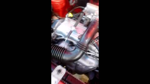

Is it possible for you to record what it's doing and upload it for me to hear?
Dec 17, 2020 at 11:58 AM
JIMB2020
  • 106 POSTS

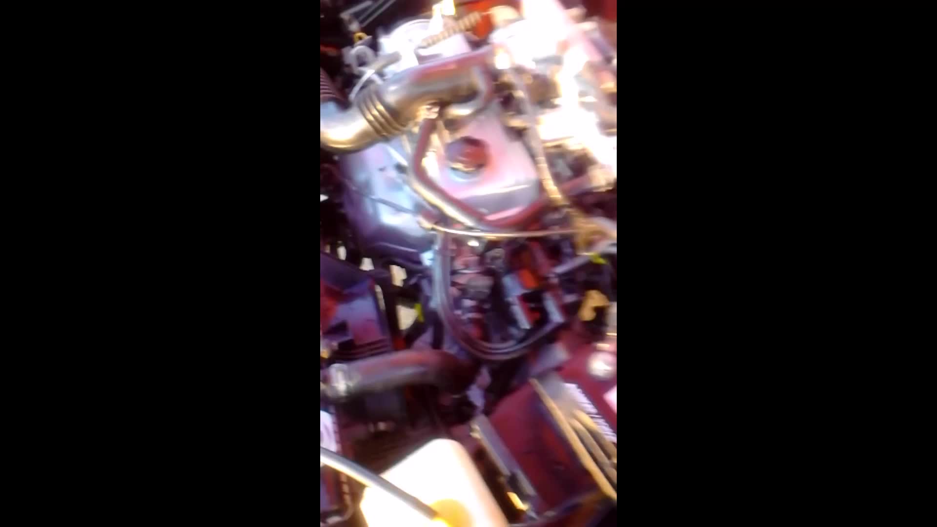

So, I know this does not sound great- worse than a "sewing machine" (what can I say sister wants it fixed, honestly I am trying). Here is a break down of the video clip:
AT the beginning: combination of idling and throttle
AT 40 seconds: easy start up (engine already warm) but at 53 seconds engine idle grows weak but never shuts off or hesitates and continues at 740-800 RPM's.
AT 142 seconds is a clip of the engine being started on cold. 2 or 4 cranks and it starts but also never shuts off despite being noisy and weird.

Here is the video clip.

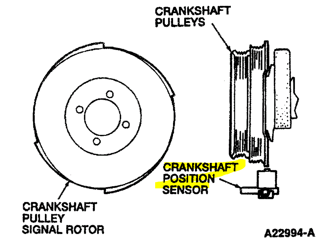

As far as the CKP, there is no relearn on this vehicle. Have you found an issue with it? By the way, here are the directions. See pic 1 for location.
1996 Ford Aspire L4-81 1.3L SOHC
Procedures
Vehicle Powertrain Management Sensors and Switches - Powertrain Management Sensors and Switches - Computers and Control Systems Crankshaft Position Sensor Service and Repair Procedures
PROCEDURES
1. Disconnect the battery ground cable.
2. Disconnect the electrical connector from the Crankshaft Position (CKP) sensor.
3. Raise and support the vehicle.
4. Remove the right hand front splash shield.
5. Remove the retaining bolt and the CKP sensor. If necessary, remove the CKP sensor bracket.
6. Reverse the removal procedure to install. Tighten the CKP sensor to 6 Nm (51 lb in). Tighten the CKP sensor bracket to 3 Nm (15 lb in).

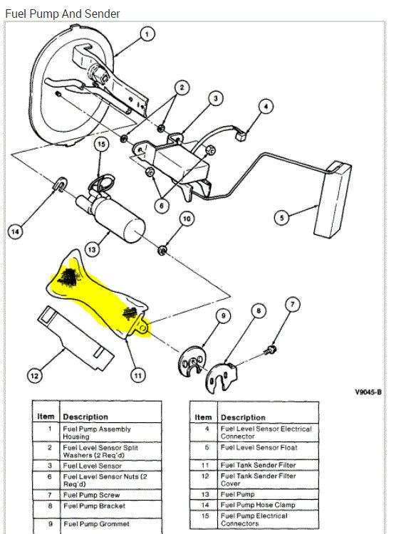

After changing the CKP sensor, the P0335 code cleared. But I am still getting the same rough idle or fuel system fault, stft 25% and very low fuel pressure 20-23psi. When I tried to do fuel pressure regulator test by unplugging the vacuum line, nothing happened (the pressure should've surged up a little but it didn't as if the fuel pressure regulator isn't there. The fuel gauge never moves out of its 22 PSI position). The injectors are receiving voltage and are ticking (audible test, never listened to them before but they go tick-tick-tick-tick-tick very fast?), the resistance is amazingly consistent among all 4 (13.8 ohms each). Continuity is excellent. When I unplug the connectors, turn the circuit on (without starting the car-ignition on) and DMM - probe to one terminal and DMM + probe to the other, I get erratic voltage readings (the DMM reads 10+ volts immediately, then it drops to 6 to 5 to 4 to 3 to 2 to 1 until it 0s out. The same happens with subsequent injectors). I can't seem to get 12 volts even after I made sure grounds are all okay and injectors are doing their function when the engine is running. The issue I was facing was low fuel pressure (22 psi as opposed to the specified range 35 to 45 PSI. I mean it is always below 25 and never changes no matter.. What is wrong? by the way, after the engine is first started on cold (as I said before 2-4 crankings), the idle RPM is almost 1,100 and the fuel fault clears, the stft constantly changes between 7% to 21% and O2 sensor voltage 0.5V, but as soon as the engine warms up and or if I throttle while idling, the rpm drops to an average of 750 RPM'S, it begins to idle rough, O2 sensor back to low 0.12V and stft 25% fixed causing fuel fault OL.. I mean, it sounds like throttle and or fuel pressure have everything to do with what's happening? or combustion being quenched in one or more cylinders but not all (could that be it?) any advice on whether this is a fuel pump issue, regulator, filter, injectors..before I replace them? voltage? throttle? internal invisible leak without compression effects?I could throw parts at it? what do you think?
Dec 25, 2020 at 4:31 AM
  • 110,244 POSTS

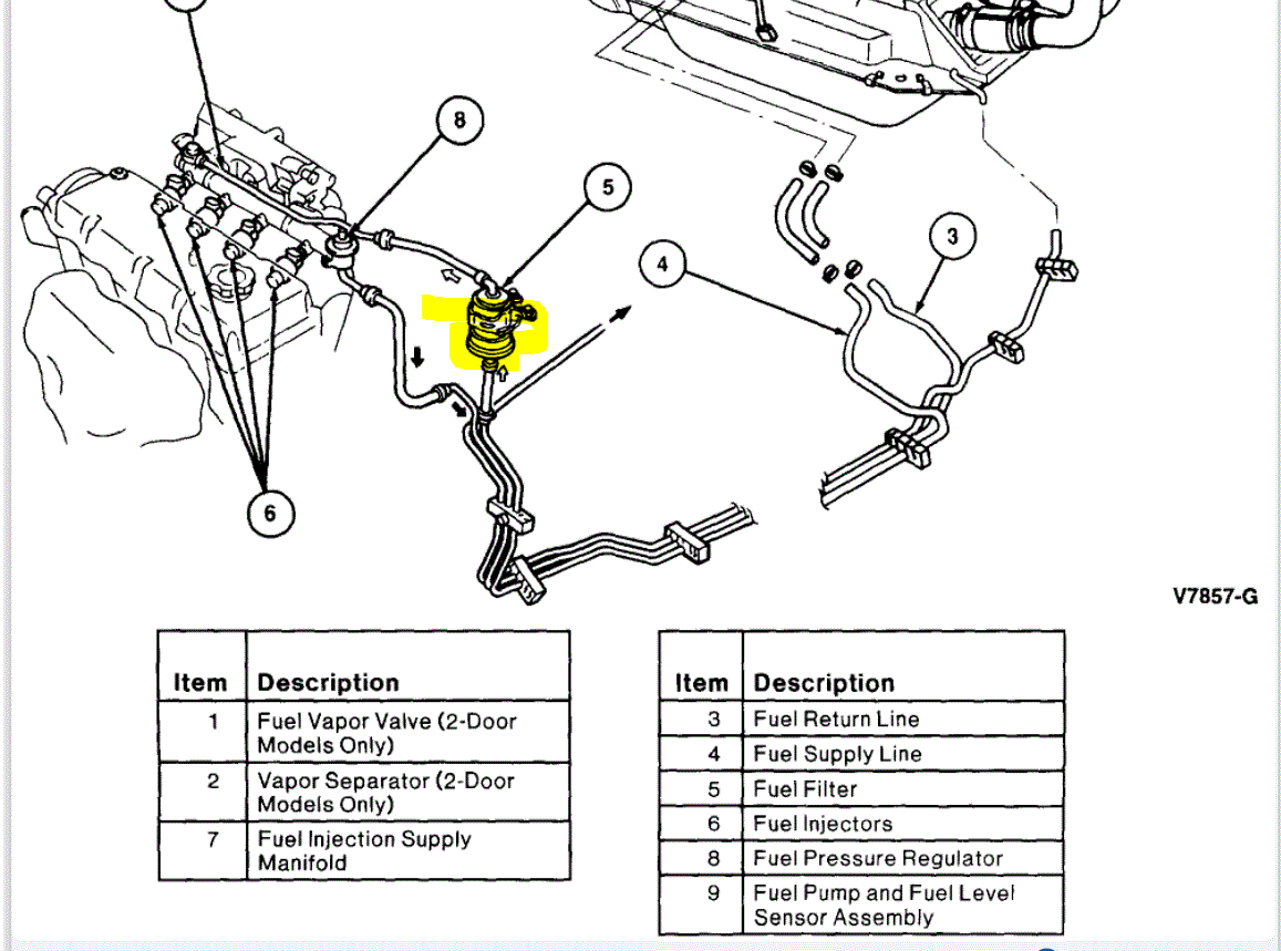

The pressure is a bit below the manufacturer's specs. That could cause a lean mixture which in turn shows the +25 on trims. The computer is trying to add fuel that may not be there.

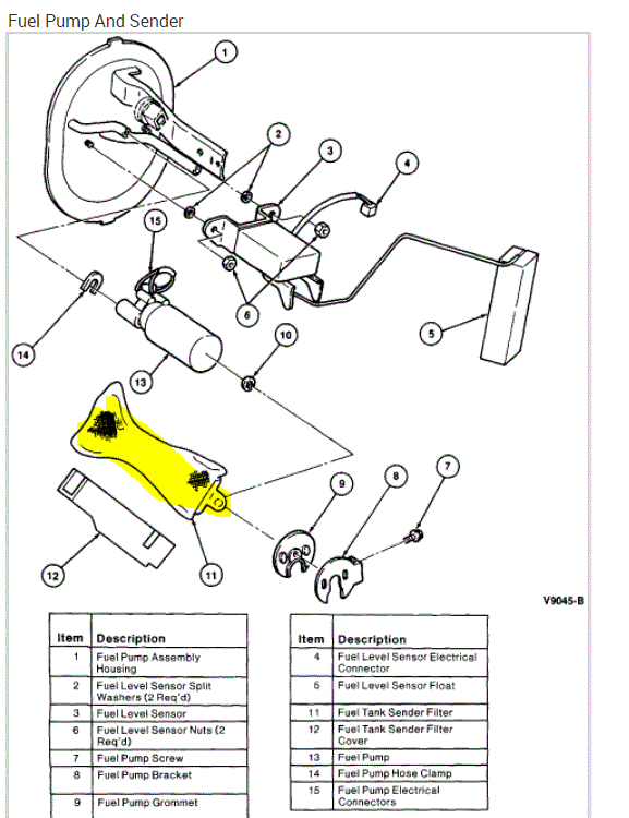

There is an inline fuel filter that I would suggest replacing if you haven't already. I attached a pic below showing it's location. If that filter is new or known to be good, then there could be an issue with the pickup filter in the tank (I call it a sock). (see pic 2) It is at the bottom of the fuel pump and filters the fuel in the tank before going into the pump.
Here is a link that explains in general how to replace the fuel filter:
https://www.2carpros.com/articles/how-to-change-a-fuel-filter
__________________________________
When you checked fuel pressure, if you disconnected and connected the fuel pressure regulator vacuum supply, did the pressure change?

JIMB2020
  • 106 POSTS
Exactly Joe, I didn't get any fuel pressure change at all (the gauge is fixated solid on 22 psi (drops to 9 or so over night). I examined its vacuum tube for fuel leakage and none was detectable but the vacuum in the tube is present- meaning there is vacuum on top of the regulator).
I reviewed the car's record, it looks like shops have changed the filter three times in the past 15 years. I can change it again
what about the injectors I described above- any thoughts on why I got such an erratic voltage readings despite successful resistance and wiring tests?
I will go a head and replace fuel pump and screen, run a voltage drop test and report back to you.
Dec 25, 2020 at 10:18 AM
  • 110,244 POSTS
If the pressure doesn't change with disconnecting the fuel pressure regulator and remains low at all times, pull the pump. Chances are either something is plugged or the pump is worn out and causing low pressure.
Dec 25, 2020 at 10:26 AM
JIMB2020
  • 106 POSTS
Yes okay, I will check the fuel tank out and pull out the pump and replace the entire assembly including the screen. Let me know if you think the injector test I did was sufficient.
thanks
Dec 25, 2020 at 10:37 AM
  • 110,244 POSTS
As far as the injectors, let's see what happens when we get the right fuel pressure. I have a feeling that is going to eliminate the issue.
Dec 25, 2020 at 11:11 AM
JIMB2020
  • 106 POSTS
Thank you for all your help. I just finished up replacing the fuel pump assembly and filter. As it turns out you were right. The strainer, the nozzle and the insulating seal had come unplugged and were laying on the bottom of the fuel compartment while the pump barely bolted to the assembly. The in-line fuel filter had the sole task of filtering the fuel in the past 15 years (no wonder my sister tells me they changed it several times in the past). The fuel pressure is reading 35 PSI up from 22 PSI and many of the numbers are back to normal. Enjoy the Holiday and Happy New Year. Thanks again.

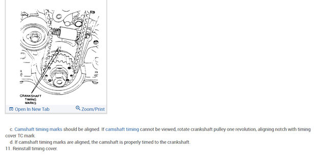

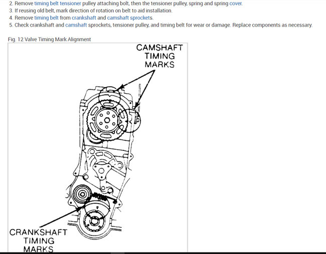

I was getting ready to follow a Triple cycle procedure (aka PCM relearn which results in monitoring data for misfire, components and catalyst) after the rebuild, but the Innova 3130 Lat is giving me a couple of things I need answers to. The first is straight forward: P0335 which is CKP sensor malfunction and the second Open Loop- Fuel System 1 Fault with the following associated data: STFT 25% and O2 sensor at B1S1 is 0.13V and TPS of 9.8% while the O2 sensor at B1S2 is 0.06V and STFT at 99.2% the data is at idle (740 to 802 RPM fluctuation). When I throttle the pedal, the fuel system fault clears to CL, then returns to fault. The engine is able to idle at load between 16 and 21%. I let it idle for a long time over the past few days and the results were always the same. I also drove it few times to check alignment after overhauling the steering (I kept the speed to 10 MPH to 35 MPH only), and when I returned, the scanner gave me the same results each time. I inspected the spark plugs which I had cleaned good before installing and they were covered with soot, so I recleaned a different set of spark plugs and installed them with dielectric grease and the engine improved its starting with little to no hesitation- previously on cold I had to crank three times and once on warm). I also inspected the CKP sensor and found metal shavings on its magnet and some silver engine paint (I had done some drilling and figured some got on the sensor). I cleaned it, however the code P0335 returned and the cleaning didn't change the results. This car's CKP sensor is supposed to be pointing at the crankshaft reluctor via a bolt on a bracket. When I cleaned it, it looked like the sensor's round magnet was not pointing accurately at the teeth of the crankshaft; it looked like it was pointing in between the oil pan and the pulley. I could not change the direction. It goes on the bracket in only one way, but also its distance seems to be too far from the crankshaft. I looked at many sensors of different cars and they all seem to "hug" the crankshaft or the flywheel. Should I bend the bracket to get the magnet to point at center of the pulley? Or is the magnet able to pick up the location within its current location? Should I follow the triple cycle procedure (which necessitates driving and stopping and highway speed etc.) and then rescan for CKP sensor? Or should I change the CKP sensor first? Do you advise looking into fuel pressure (fuel filter, rail, regulator, injection or pump or screen problems- the fuel sat in the tank well over a year on 1/4 full which I could not siphon out but treated and filled up to full tank) or look at the distributor/coil plugs voltage weakness (the scanner gave me spark advance in the range of 7 to 13 degrees), the alternator at 14.66 and the battery at 12.8V (brand new battery but I have been cranking the engine a lot and idling a lot as well). It has no problem cranking, nor does it turn off when the fuel fault appears.
Dec 28, 2020 at 2:32 AM (Merged)
  • 55,433 POSTS

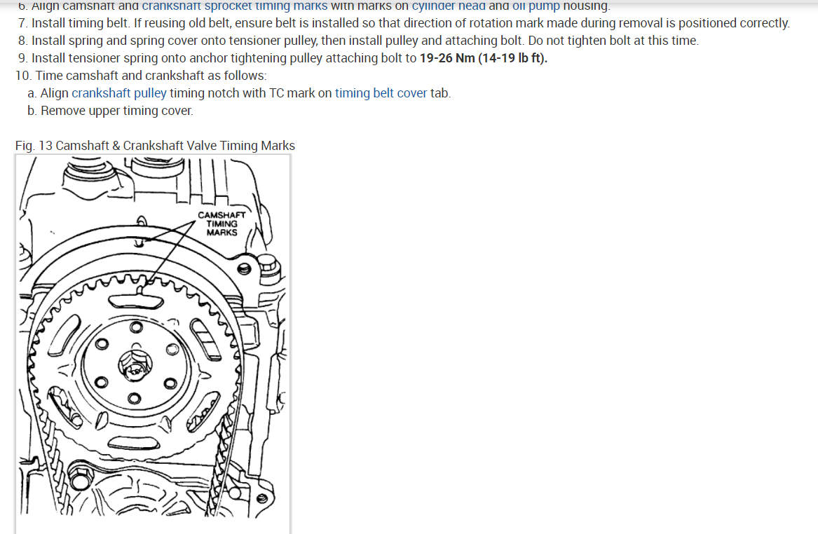

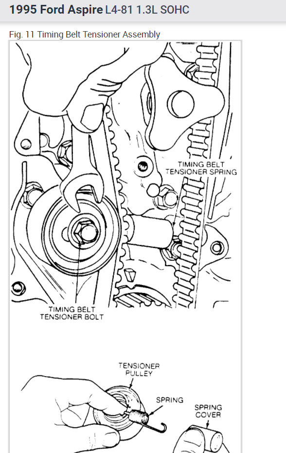

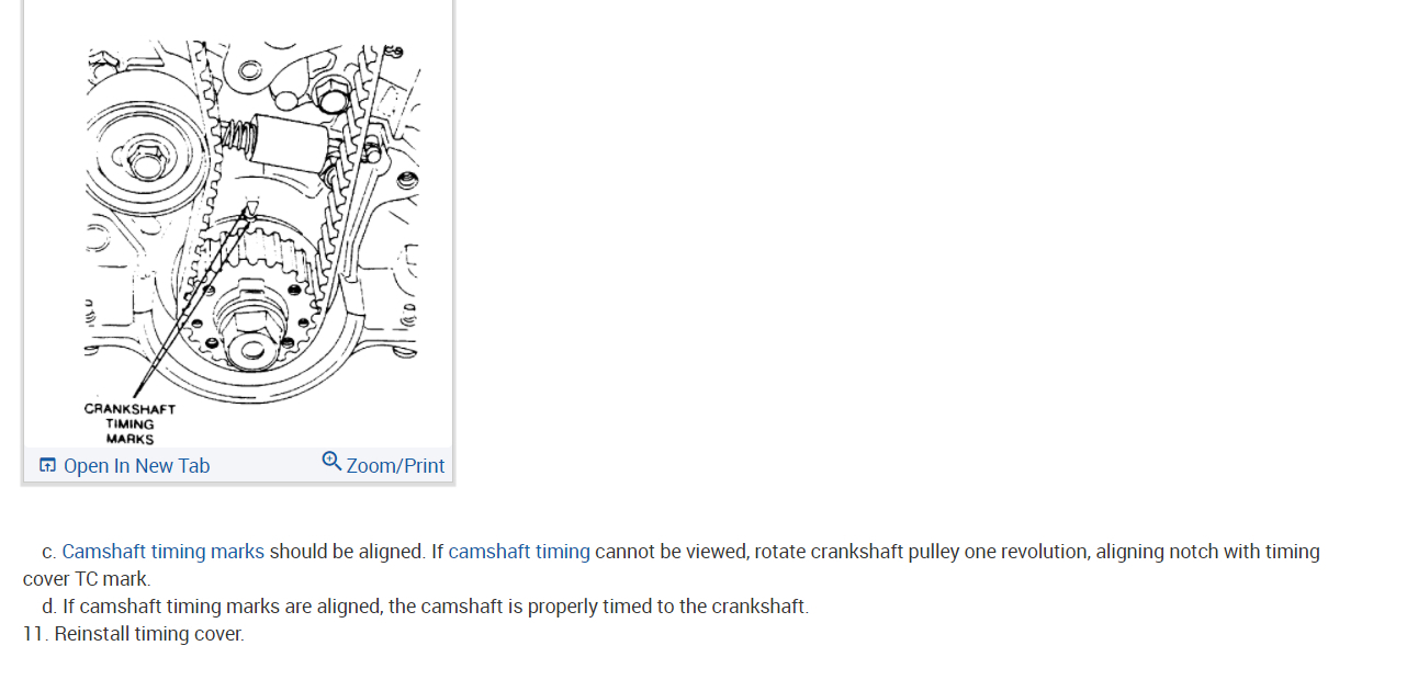

It sounds like you have a timing belt that is off one or more teeth. how is the power of the engine? These guides can help us confirm the issue. Check out the diagrams (below). Please let us know what happens.
JIMB2020
  • 106 POSTS
So, I am pretty sure the timing belt is right where it should be. Power? Yes, no problem. Last night, I throttled the engine multiple times to 4,500 and 3,500 RPM's four times and to 2,000 RPM's for 20 seconds while I ran an alternator test. No issues. It does sound much better when throttled. It never shuts off no matter how long I let it idle and the idle RPM's never deviates from the 740-800 range. I did an exhaust tail pipe test where a paper is placed at the exhaust tail pipe exit and found that the paper flutters towards and away from the exhaust gases as if being sucked into the exhaust periodically (some kind of vacuum is causing the paper to be drawn back towards the pipe instead of away). Catalytic converter blockage maybe? Stuck open exhaust valve? but what does that have to do with the P0335? I am not sure if a compression test will confirm open exhaust valve? The bottom line is the system has some kind of fuel related issue when at idle. The scanner gives me no other codes besides the P0335 open loop fuel system fault (which clears upon throttle).

All done! Thanks to you and all of your experts. When I opened up the fuel tank and looked, I was shocked. The fuel pump barely bolted, its seals, nozzle and strainer were all at the bottom of the fuel container. The pump was pumping despite all this mess and obviously the in-line fuel filter had to bear the responsibility for filtering (it was changed many times in the past several years my sister tells me). After replacing the assembly altogether, I replaced the in-line filter and did voltage drop, resistance and continuity tests on all components. This morning (haven't gone to bed yet), I hooked up everything (well almost) and started the engine: The fuel pressure: 35 PSI and spec! (up from 22 PSI). Fuel system fault: Clear. Have a good one and Happy New Year . James
