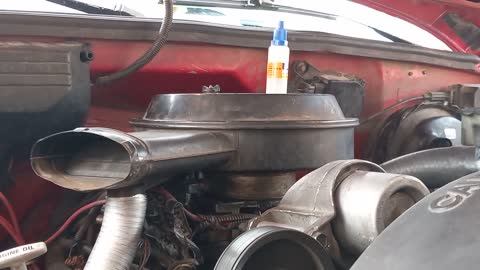

I have a 92 Chevrolet Scottsdale 4.3l TBI
I recently put a new engine in it, remanufactured unit. Old lost compression bad.
I have a similar issue with the new engine that I had with old and that's when it's warmed up it idles rough and shakes. Timing has been rechecked a dozen times. Fuel pressure is solid. Motor and trans mounts are new. Basically straight pipe past 02 sensor, no cat just muffler.
What's new in the new engine
Temperature sensors
Thermostat
Knock sensor
oil pressure sensor
EGR valve (old one had diagram issue)
I've tried replacing
TPS
Idle air control
Swapped injectors on TBI including the diagram portion of TBI
MAF.
I replaced all grounds and moved main ground to block stead of intake.
If I unhook EGR hose from its control unit and also off TBI it performs better but still rough idle.
I'm kind of lost for ideas. Anything helps. Thanks.

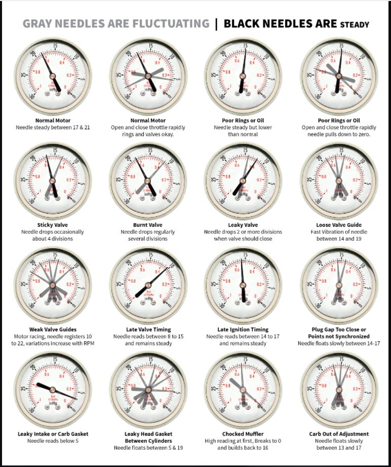

The next thing we need to do is look for an intake valve leaking or hanging open. That needs to be done with a vacuum gauge hooked to an intake manifold vacuum line.
I am attaching a chart that will help with figuring out if this is an issue.

No dollar bill suckage on exhaust, and did the intake valve test, everything was in normal range.

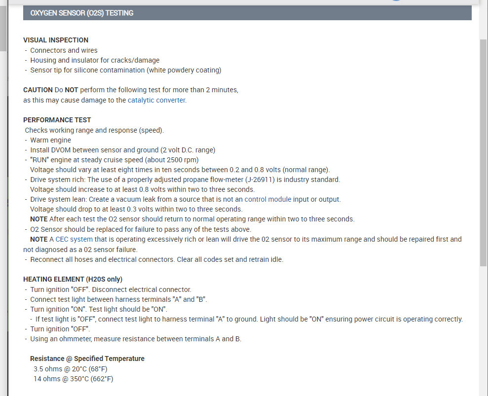

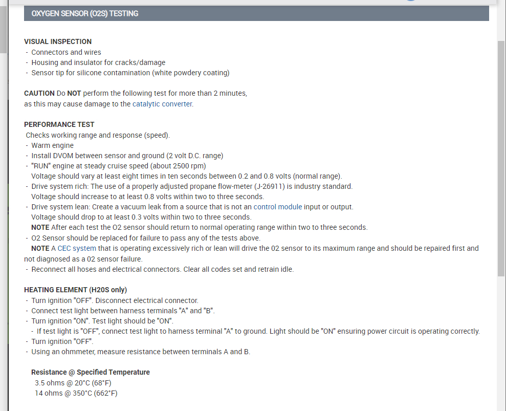

Can you get a recording of the engine running? Also do you have a scan tool that can monitor the o2 sensor data? or let's just monitor the voltage on each sensor while this is running poorly.
Also, these systems are basically different input systems to get the engine to run more efficiently and with lower emissions. So I am thinking that we may have an issue with the sensors telling the PCM that it is running differently then it actually is. You said there is a straight pipe past the o2 sensor which I assume means you have no converter but the o2 sensors are still there?

Great thanks. A quick test would be to just unplug o2 sensor and if the engine runs better then it needs more testing.
Clearly this is not definitive but could be more evidence that we at least have an issue there. That will force the PCM to run off a program and not an actual input data.

WALKINGTOOLBOX
  • 45 POSTS

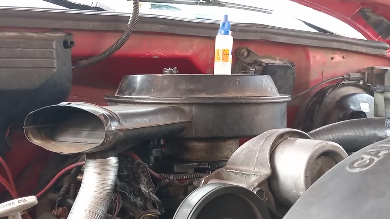

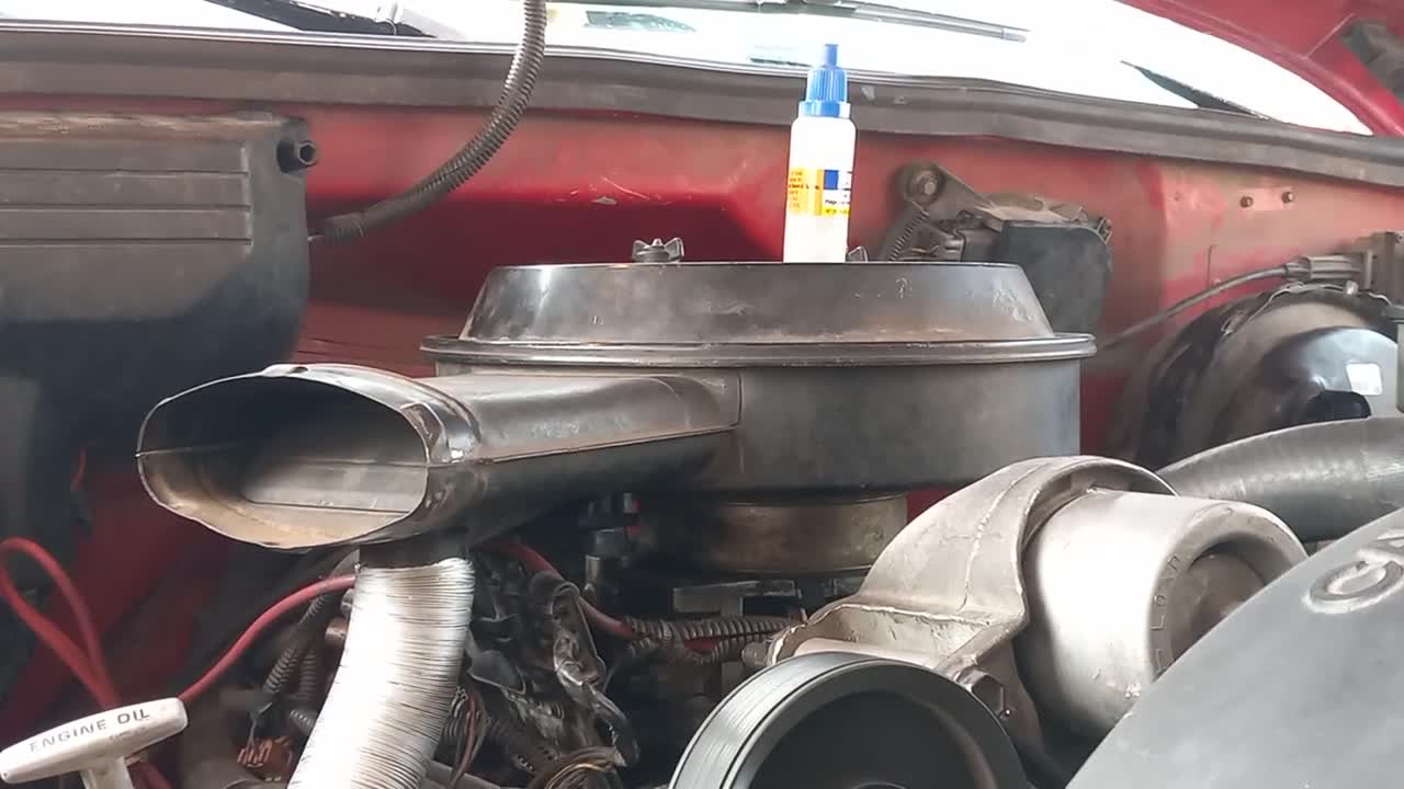

hope these give some insight, looks worse in person. ones with o2 plugged in and the other unplugged.
unplugged o2 sensor seems either worse or the same. haven't used obd reader yet, i don't have a obd1 reader. will go to parts house and borrow to get readings.
Sep 1, 2021 at 3:32 AM
Yeah. That second video with the o2 unplugged does seem worse.
How does this drive? Does it have all the power it should have? The only reason I ask, is I am not sure you are going to get it much better. The fact that the bottle stays on the air cleaner (good idea on how to illustrate it by the way), shows that this is just an unstable idle.
However, if you have some performance issues then we are missing something but just not sure what it is at this point.
See what the o2 sensor data is when this is happening would help. Thanks

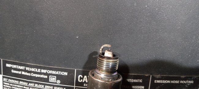

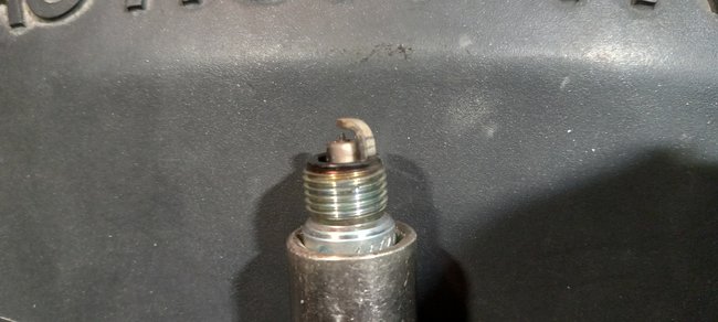

just pulled spark plugs, 3-400 miles on new, they indicate lean to me.
Sep 1, 2021 at 12:09 PM
Yep. Basically this chart shows the same thing. Overheating is caused by lean misfires or just a lean mixture. So the one that says overheating matches this. You can see on the electrode where you have the signs of it.
So we are on the right path with a fuel starvation issue when the engine is hot. That means we have two paths.
First get the engine temperature down as you stated and it should be fine.
Second, find out why the engine seems to be running hotter. 210 is a bit high.
Do you know what degree thermostat you have in it? Looks like it should be a 190 so you may try a lower degree and the other things you mentioned just to try and keep the engine from getting hotter.

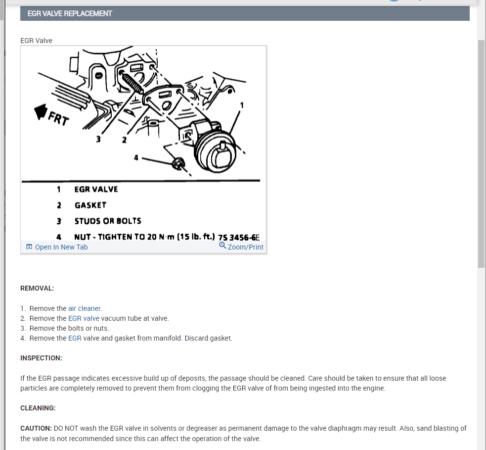

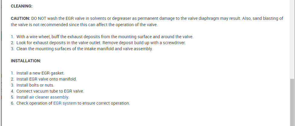

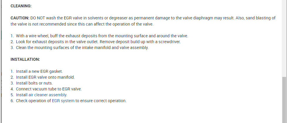

update on things: got time to work on it today, decided to put all emission hoses back and with that i have learned it will not run with the EGR hose hooked up. it will idle just fine but as you start to go it acts like it's running out of fuel, pedal to floor to keep it going while in gear. not sure what to think.
Sep 16, 2021 at 10:47 AM
So if everything is hooked up and it doesn't run well but you unhook the EGR and it runs fine?
If so and that EGR is new, was the old one doing the same thing?
Sounds like we may have an issue with the new EGR.
Sep 16, 2021 at 12:29 PM
WALKINGTOOLBOX
  • 45 POSTS
is a new EGR valve, it will not go with out pedal to floor with EGR hose hooked, but will go without hose hooked up. the old EGR had a collapsed diaphragm and was doing nothing.
Sep 16, 2021 at 12:53 PM
Okay. Holding the throttle wide open is just introducing more air so it sounds like with the EGR hooked up it is running way to rich. A stuck open EGR will cause rough running and stalling at idle.
If it were me, I would take that one back and swap it out for another one then retest.
