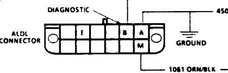

You might want to read the codes if the service engine light is on. it will point you in the right direction. Cross these two"A" and "B" terminals as shown, then turn the key on. Count the flashes, a 22 will flash as two flashes then a short pause, then two flashes, if more than one code is stored, the pause will be longer. The codes will display three times and end with twelve. Write them down and post here. This connector is right under the middle of the dash.
https://images.2carpros.com/forum/automotive_pictures/62217_GM_ALDL95_Older_3.jpg
